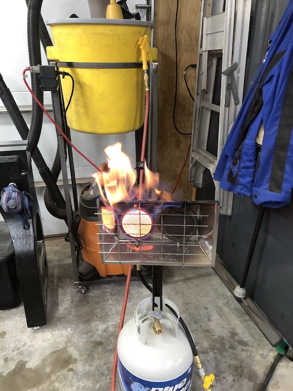

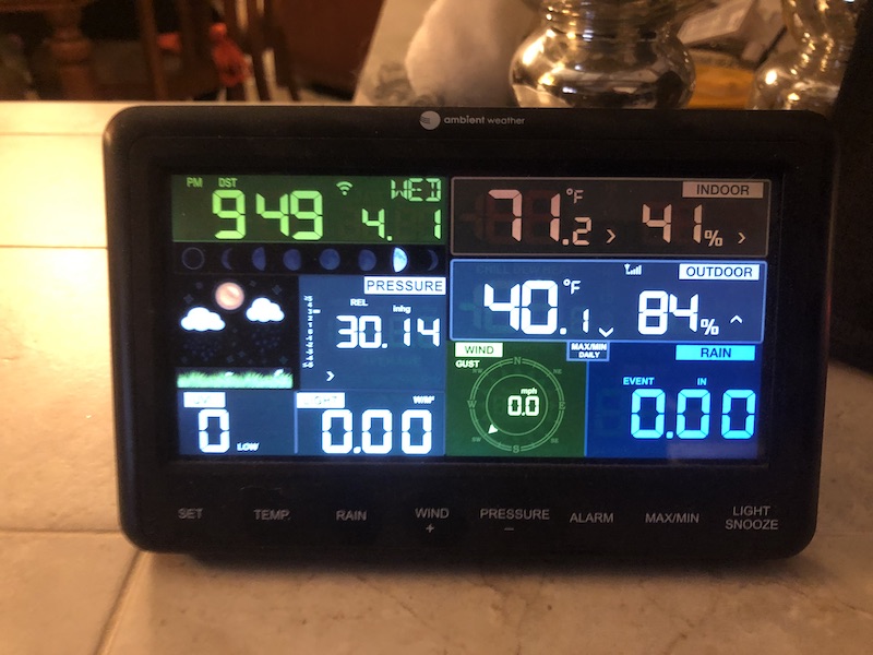

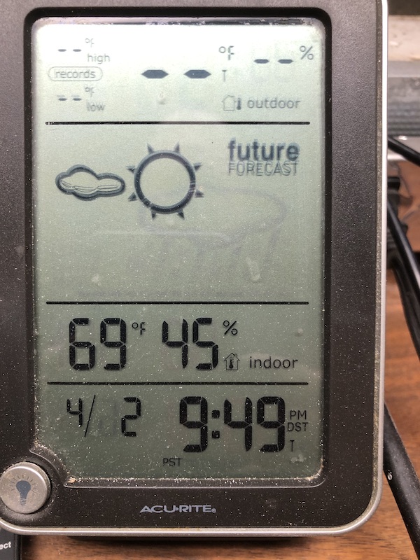

Pumped up the shop temp to see how humidity would respond. A balmy 69degF and 45% RH inside. 40degF and 84% RH outside reading from my PWS (Personal Weather Station). This should solve my tool moisture and rust issues by drying the air while heating it. My Mr. Heater dumped a bunch of moisture in the air and I couldn't get below about 66% RH. Was getting a lot of condensation especially inside tool chests and cabinets.

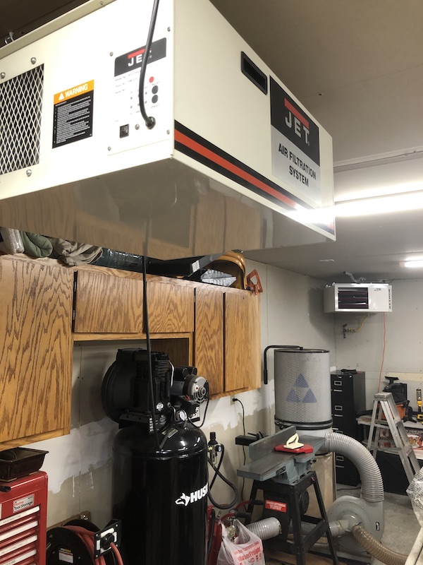

And wow... when I turn on my Jet Air Filtration unit my shop is warmed up quickly! I think I did this right.
The heater is quiet but blows a lot of air. Glad I put it in my far corner. Thermostat is at the opposite corner where I spend most of my time. Happy camper!
