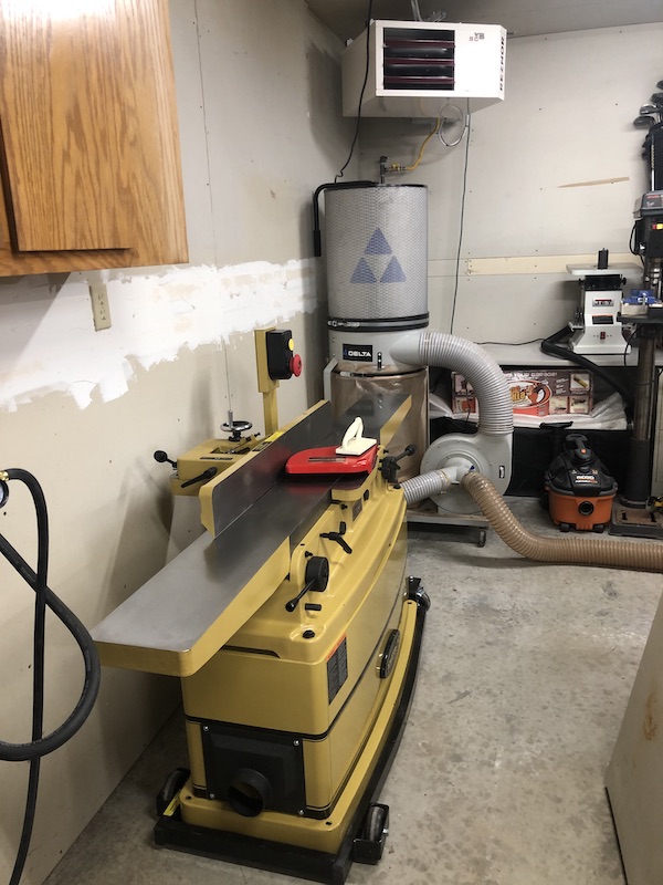

Never dreamed this thread would be so long. Sorry guys.
Steve, the flame extinguishes immediately after the igniter quits. I'm convinced the problem is that it doesn't detect the flame... because:
1. The igniter continues for the full 16sec regardless of flame present
2. The Yellow LED on the circuit board never lights
3. Gas pressure at the inlet and outlet are well within spec... purged the system again and didn't blow myself up.
All connections seem good. Worried the circuit board is faulty unless flame sensor is bad.
Gonna pull and inspect the flame sensor and reinstall.
   / My Garage/Shop Heater Install #145
If you look at the flame rod BEFORE trying to clean it (usually not necessary, if so a gray scotchbrite pad) you should see a darkened section of the rod; this is where the flame actually TOUCHES the rod. If that's not there (it should be by now, but not overly obvious) then there's something REALLY wrong (like a loose piece of metal deflecting the flame, or ???
If you have the flame rod out (and NOT shorted out against something) an inspection mirror should show you the flame that would've been hitting the rod - in most cases the flame should be mostly blue(ish) with a few yellow tips (yellow may NOT be there, newer regs want lean burn and yellow is unburned carbon)
You still haven't said whether you have a DMM you think might work, sooner or later that test is gonna get done (whether by you or a $150/hr tech) - let me know if my description a few pages back needs more detail.
