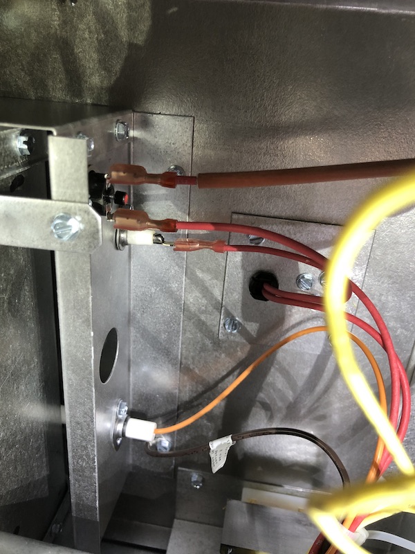

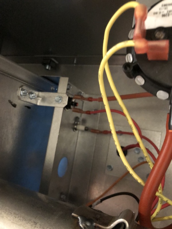

Steve, I have a flame sensor AND a flame rod. The flame rod may also include a sensor but see pic. The sensor is several inches above the flame rod. You can see them both along with the rollout switch. See the blue flame during ignition. That is best indirect view I have. No access to actually see it.

OK, the furthest away item (white insulator showing, single wire) is the flame rod.
The closer item (little black and red button in middle, 2 wires) is what the manual calls "flame rollout" (AKA "overtemp" in MY world :=) Not really a flame "sensor", just a HEAT sensor. That little button is the RESET, should the unit go overtemp.
Can't see from the angle the pics were taken, does the white insulator on the flame rod extend far enough to ALSO insulate the rod from the burner tube?
Also, if the blue light in the pic is the flame, I'm not seeing any obvious problem unless it's in "excess air" (very lean flame) but that might be normal for "greenie" stuff...

Missed this the first time; there's ALSO a "limit control", it's the small sensor near the center of the first pic (2 wires, 1 goes to the flame rod) this is essentially a "thermal fuse", normally would OPEN on a higher temp than the "rollout". If that one is OPEN, you buy a NEW one. If it IS open (bad) you'd most likely NEVER see a flame rod signal at the control board. Can't tell if that's wired with spade lugs; if so, you can pull one side and check continuity. Should be nearly a dead short.
Usually the two sensors in a clothes dryer are the same; the one on the back plane is resettable, and (at least on older ones) controls the heating elements - the one in the exhaust path is DONE if it overheats... Steve
OK, ignore MOST of this post; got a better look at othe pics, flame rod signal does NOT go thru those temp sensors - sorry...
