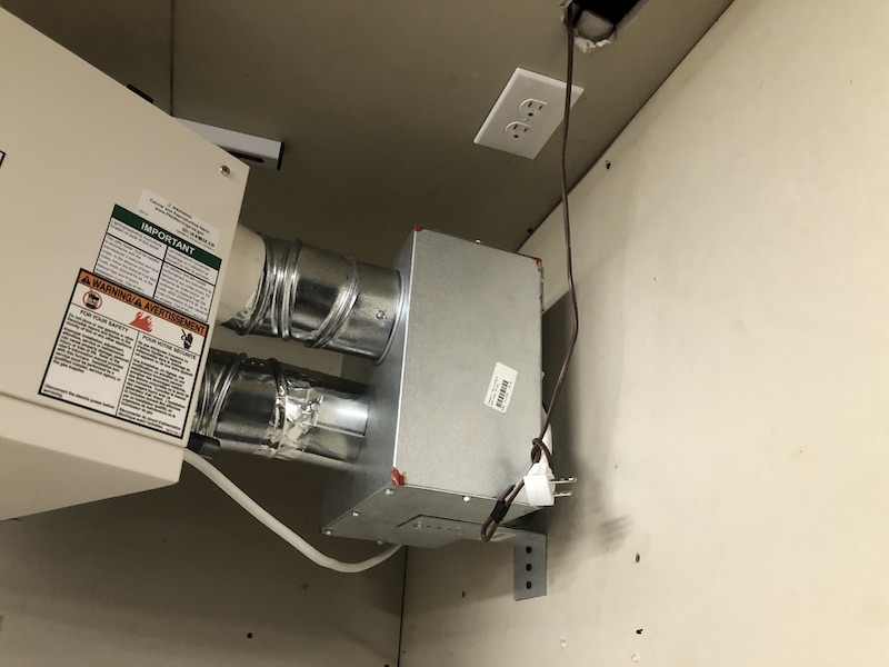

Mark, what is the gray box between the heater and the wall?
   / My Garage/Shop Heater Install
#26
Good question... I will call it a separator or maybe a combiner box. Being that this is a sealed cumbustion unit, it draws combustion air from the outside as well as exhausts to the outside. So, rather than have two penetrations through the exterior wall, a single 6in intake pipe connects to the box, and 4in pipe runs inside of it connecting directly to the exhaust port of the heater. The combustion air is routed inside the box to the heater via another 4in pipe. Hope that makes sense.

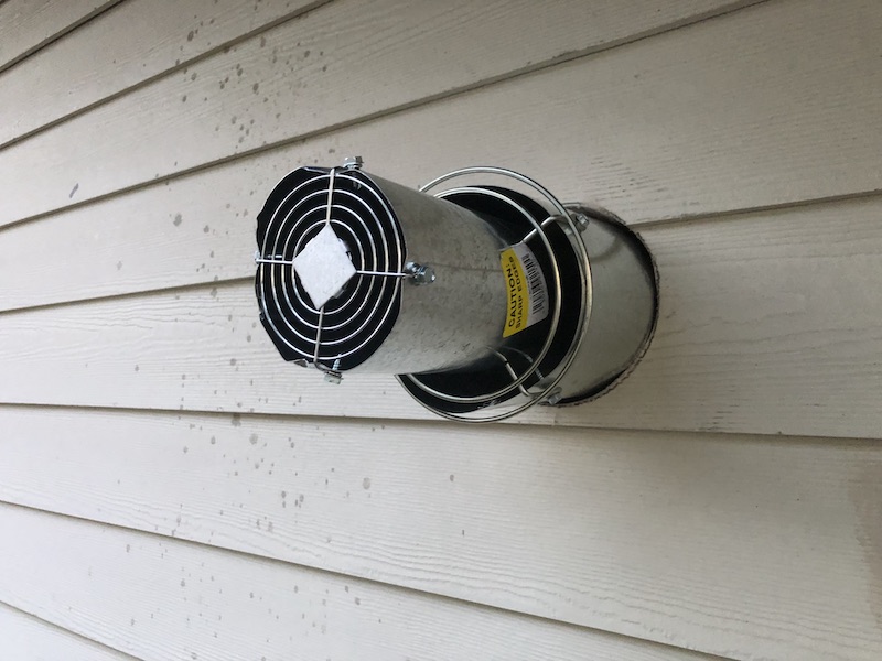

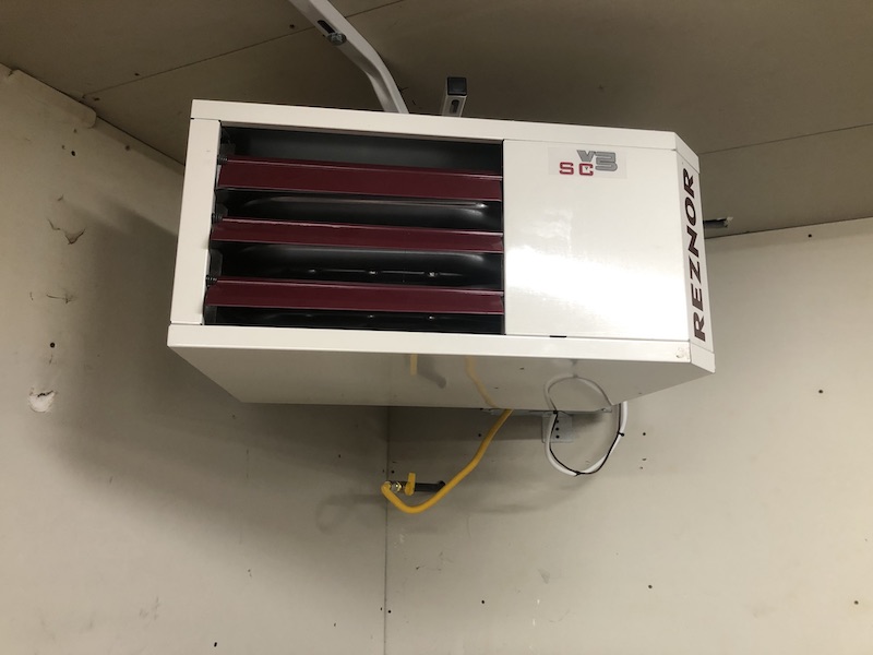

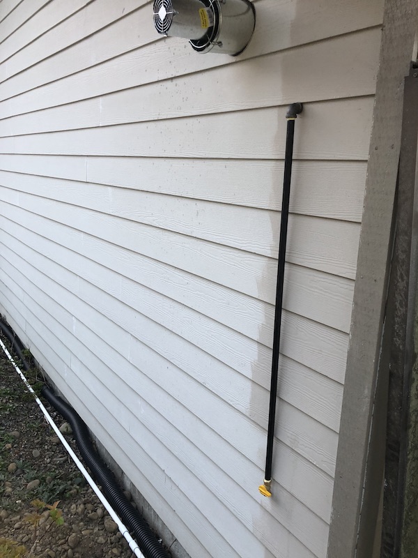

I did finish everything last night with the gas line install stubbed out. Now just waiting for the tank to be delivered (Tuesday). Then I can do the leak and pressure tests and water column measurement/adjustment. Oh and some sealant at the two penetrations.
   / My Garage/Shop Heater Install #30
Checking the gas pressure is not that hard. The new electronic gauges make it a lot easier, especially in tight spots. Adjustment will be needed as you had to do the conversion from Nat to LP. Otherwise 90 out of 100 times the factory setting is OK for us close to sea level.
