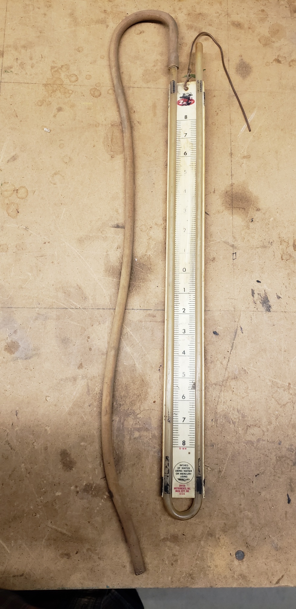

Here is a cheaper style of manometer that I worked with back in the 80's. It had so much dust on it I couldn't read the scale. And the stretchy tubing is really brittle. I don't know if anyone makes this type anymore.
I used water in the tube. It was a little hard to see but a good flashlight made it easier.

That is a good old fashion manometer! No worries about digital electronics failing! WYSIWYG.

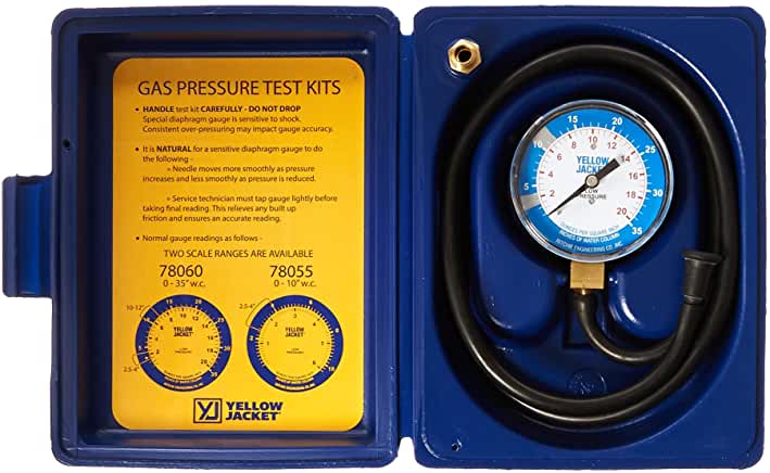

My guage is not digital.....less than $50, works great 64E37105-0318-4F17-965E-C9B06C4185ED.jpeg

I bought one of those back in the 50s when AC&R techs worked on gas appliances and furnaces. Also used it to check static pressures in ductwork. Worked great with a little coloring in the water. More reliable than electronics even though cumbersome at times. Carried it in the service truck for years.
Ron
