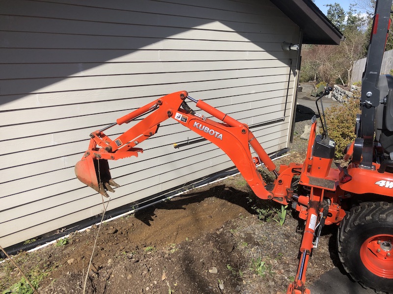

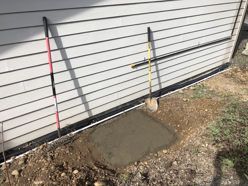

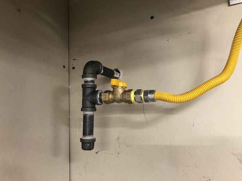

Replumbed the gas to hopefully bring it up to code. Added a debri trap near the heater. Ran a 10ft section to get the propane tank to get 10ft from the combustion air intake. Carved out a flat spot, threw some sand down to level off and now ready for the tank on Tuesday. I think the gas company places some pavers down for the tank to rest on.

Hate to tell you this; but normally LP you use galv pipe not black like Nat Gas. Propane contains moisture and other corroding elements. Copper tube instead of aluminum as used on Nat gas also. When years ago I was a service tech we carried both in the truck. Don't overlook the drip legs at all low spots and connection drops to the control valve.
Ron
