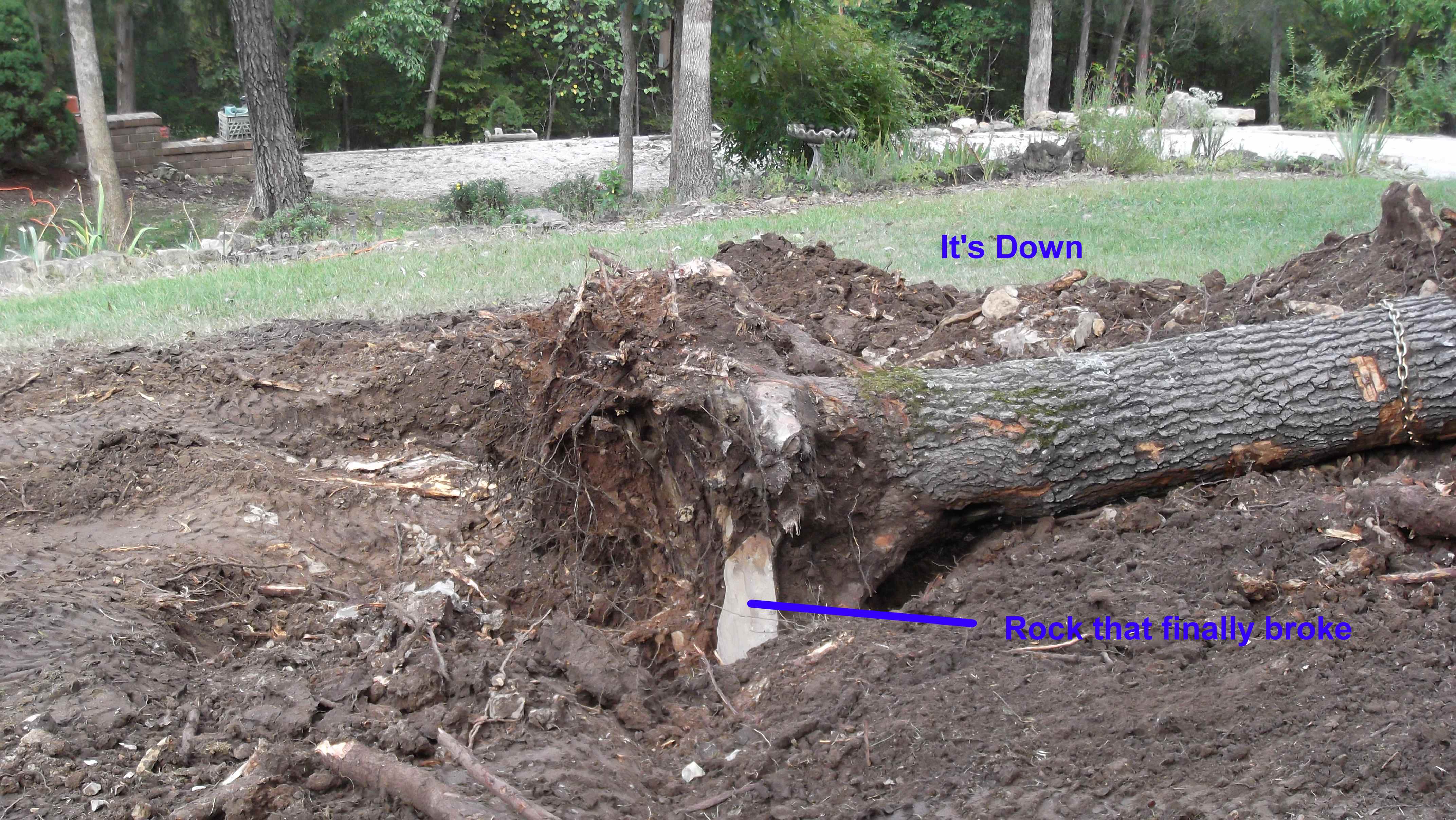

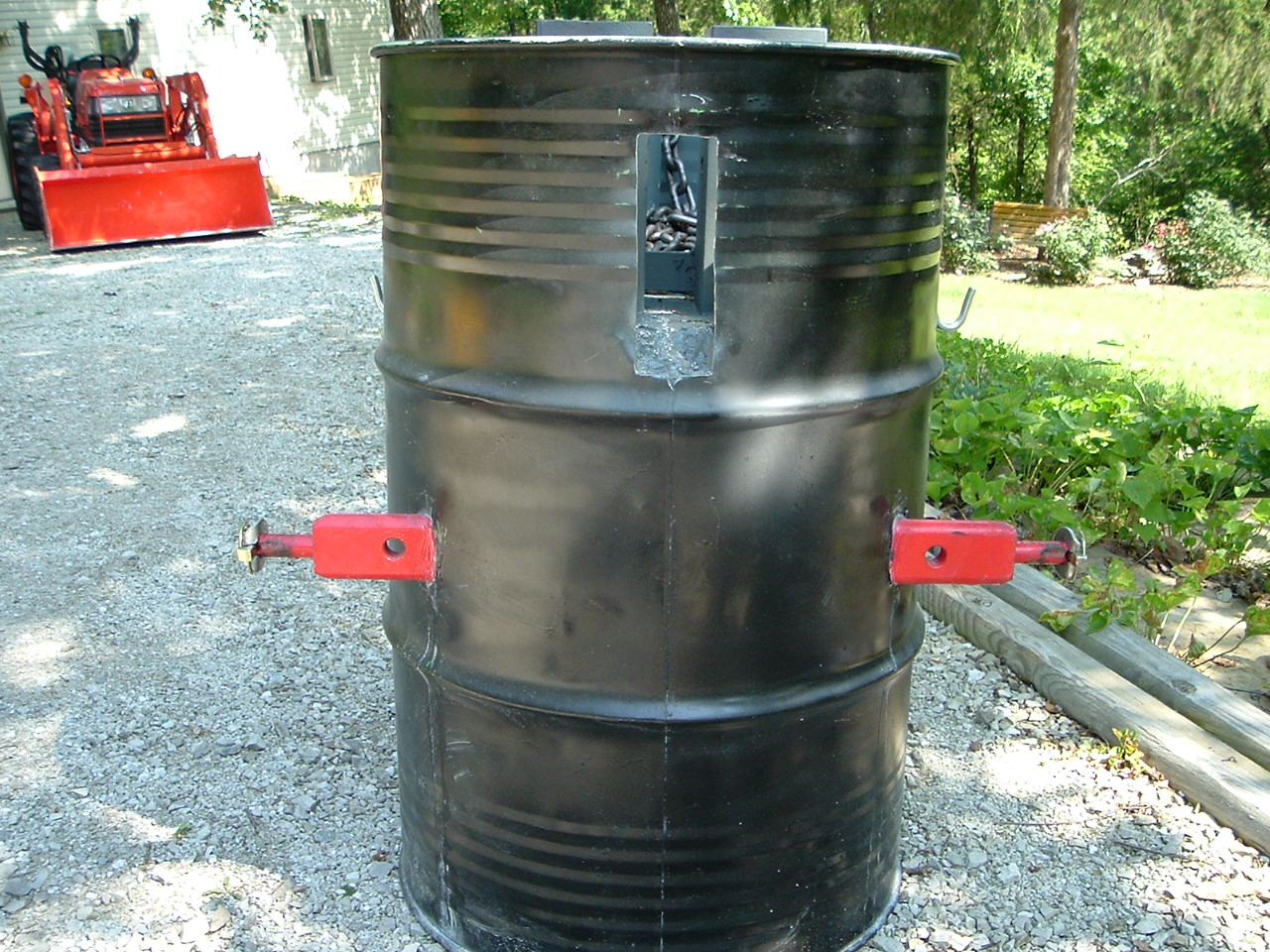

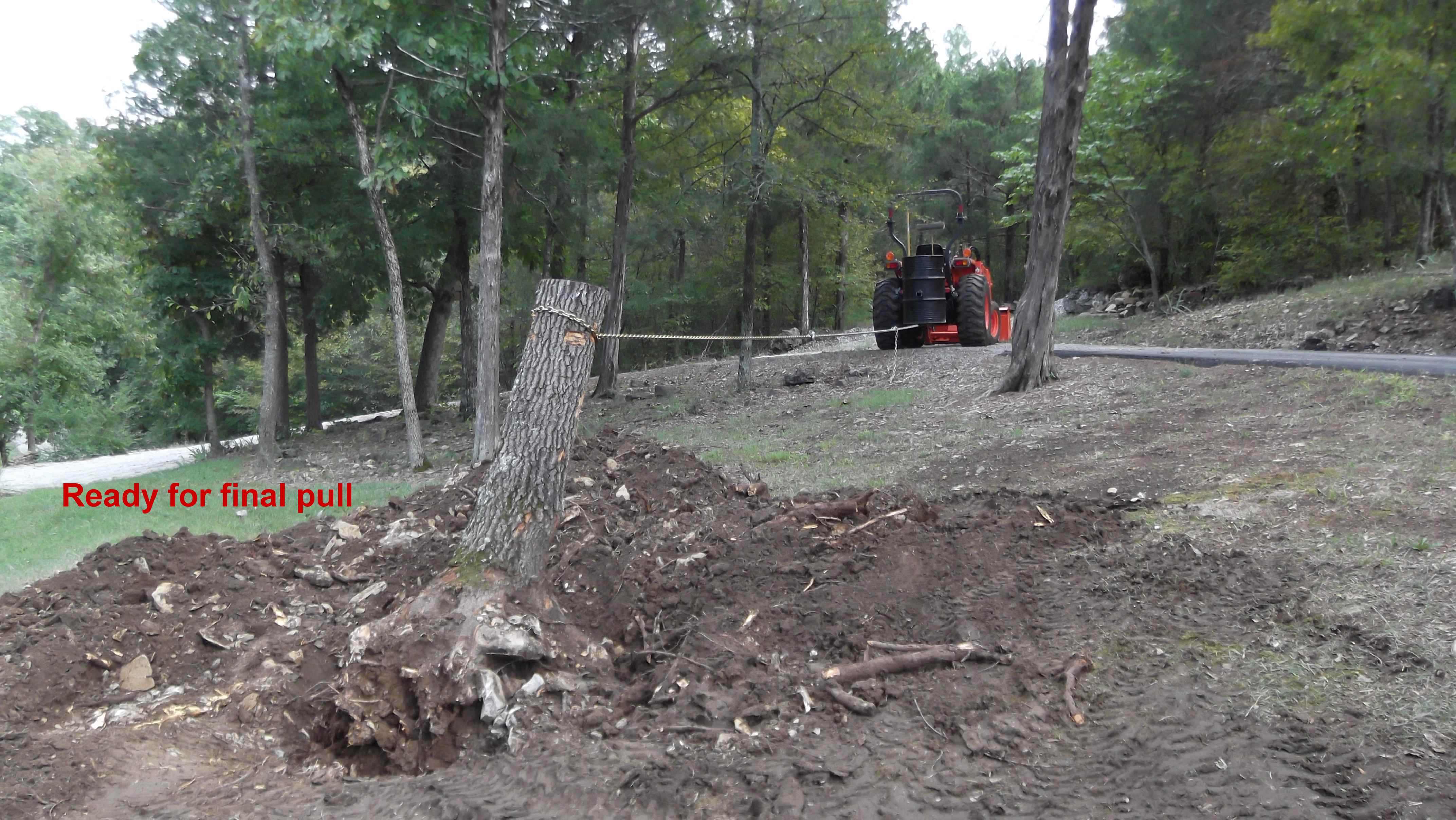

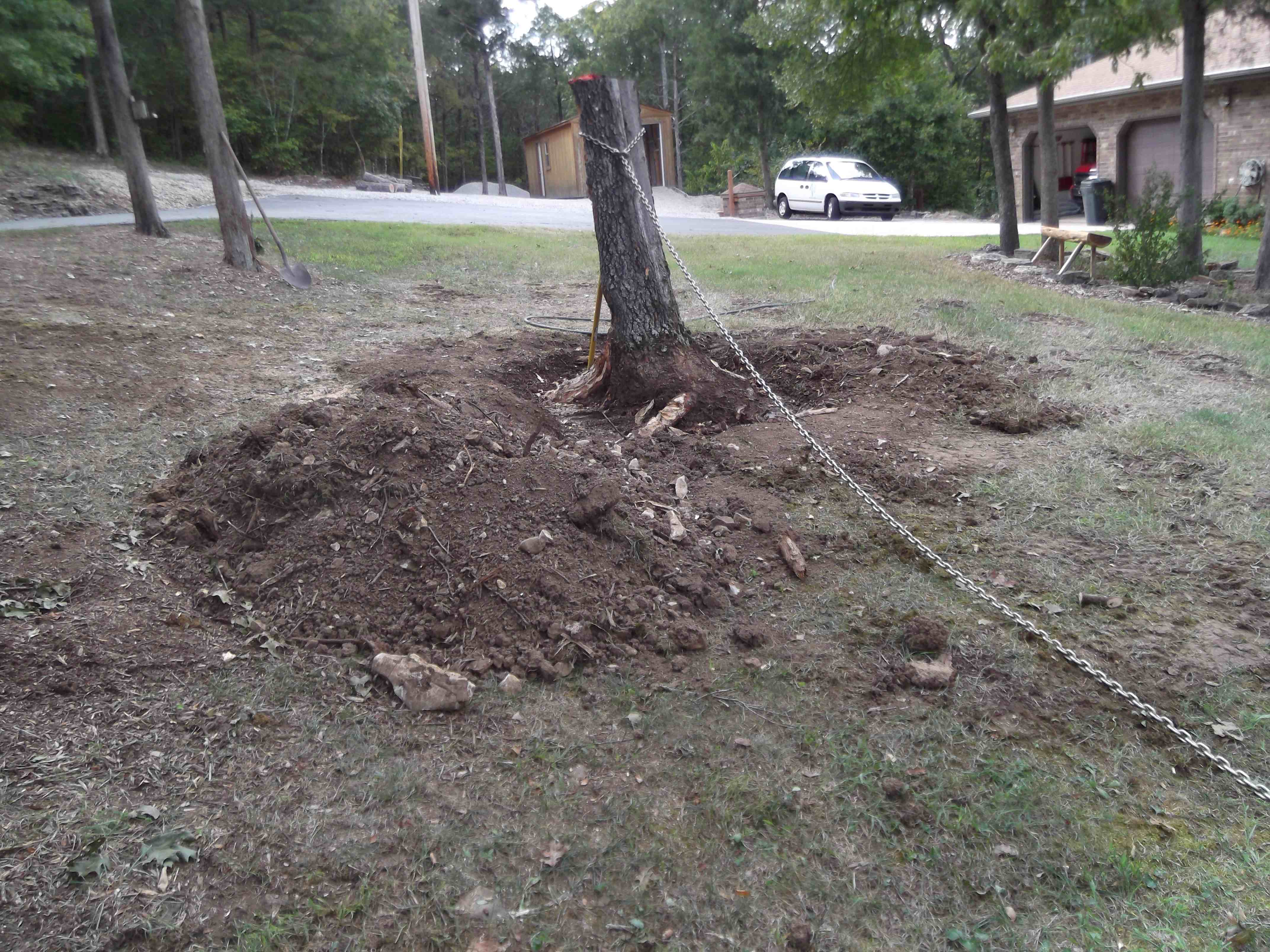

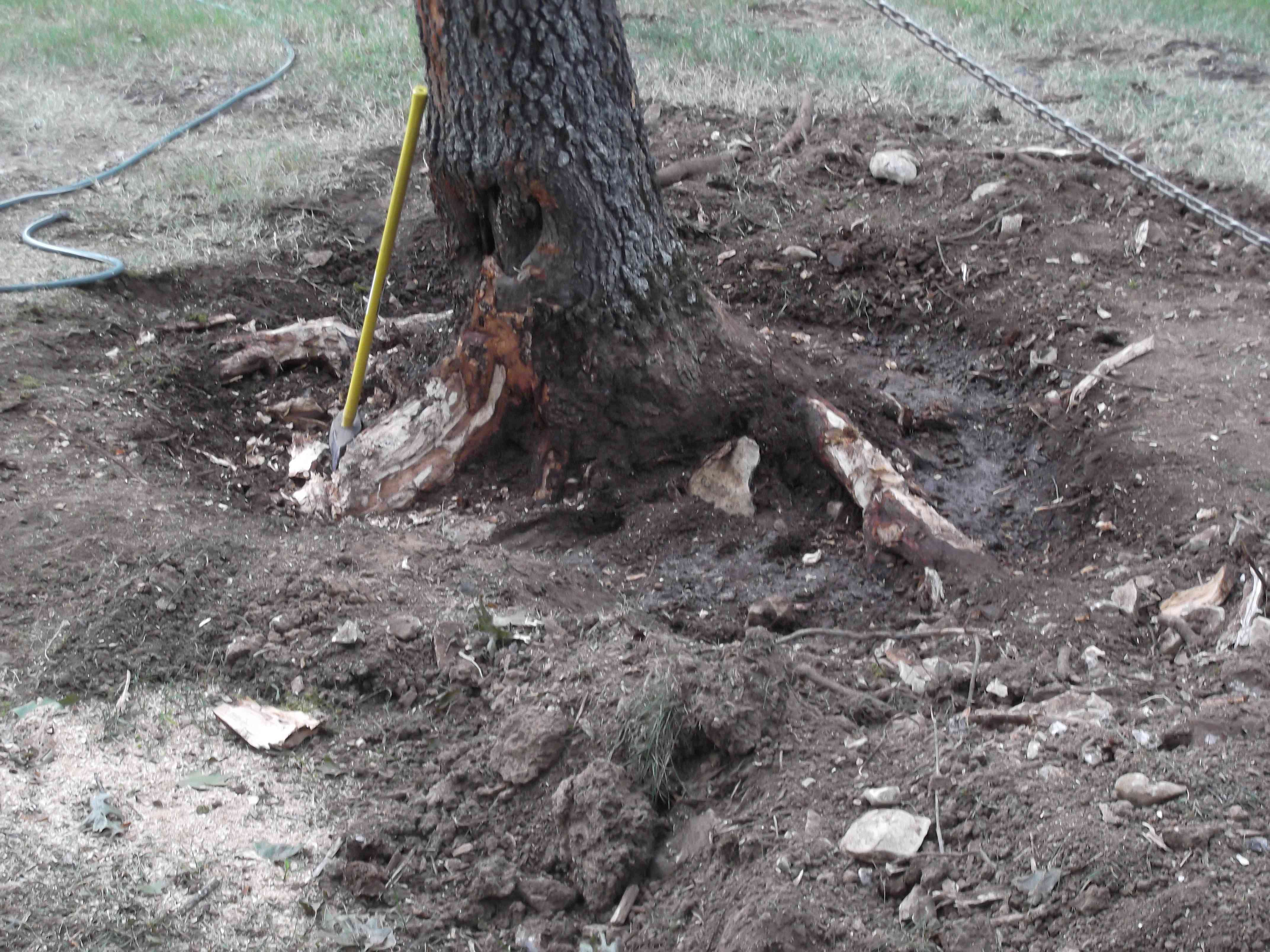

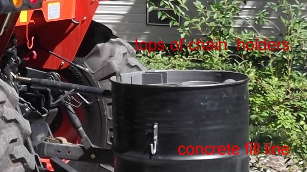

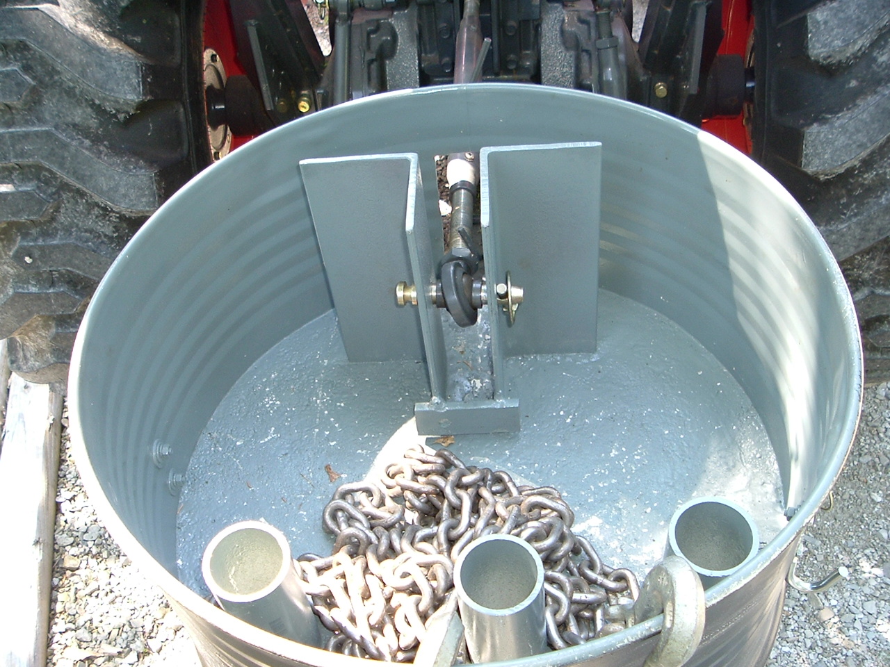

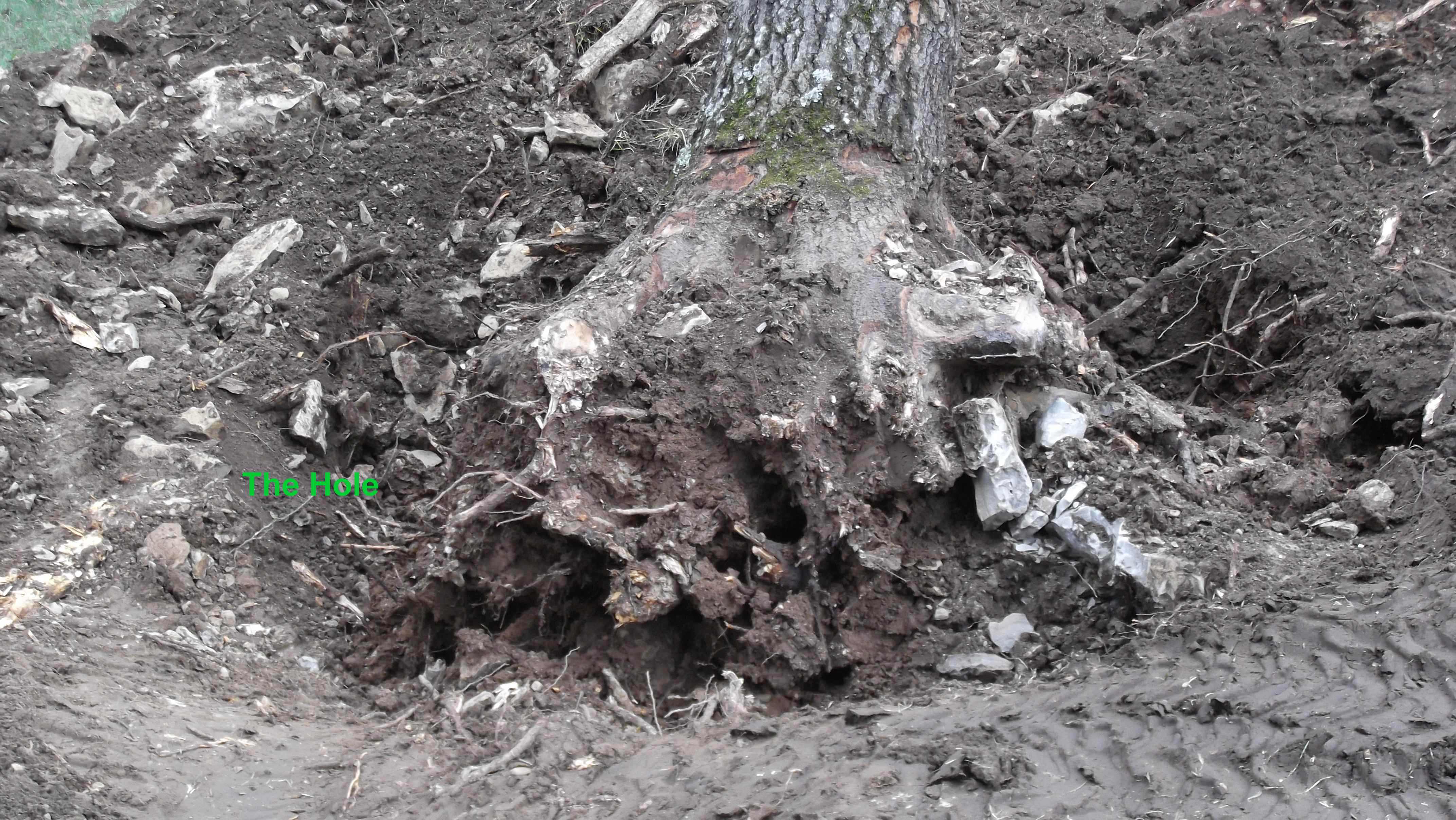

You can make one cheap like mine out of a 55 gal drum 3/4 filled with concrete. Put in some 2 inch PVC for tool holders. Real handy. I store my log chains in the top. I put a 2 inch reciever out the back. pretty handy too. Here is also a stump I went to war with. I won eventually.

I really like that idea, will be looking for barrels for sale now!

They are rather sturdy. One thing to be careful of is that if you raise a drawbar on the 3pt up too high, you run some risk of a backward flip if your pulled log hangs up. Something has to give, wheel slip on the ground, fine, but if the tractor front end comes up and you rotate around the back axle, It all happens in a heartbeat. A lot of guys do it and get away with it, but keep it in your mind, especially going uphill which makes your front end light to begin with. It is safer to pull with the fixed drawbar that is under your back axle. Less chance of testing out the ROPS that way. Notice in the photo of my final pull on the tree trunk, I pulled from the fixed drawbar with a clevis under the rear axle.
