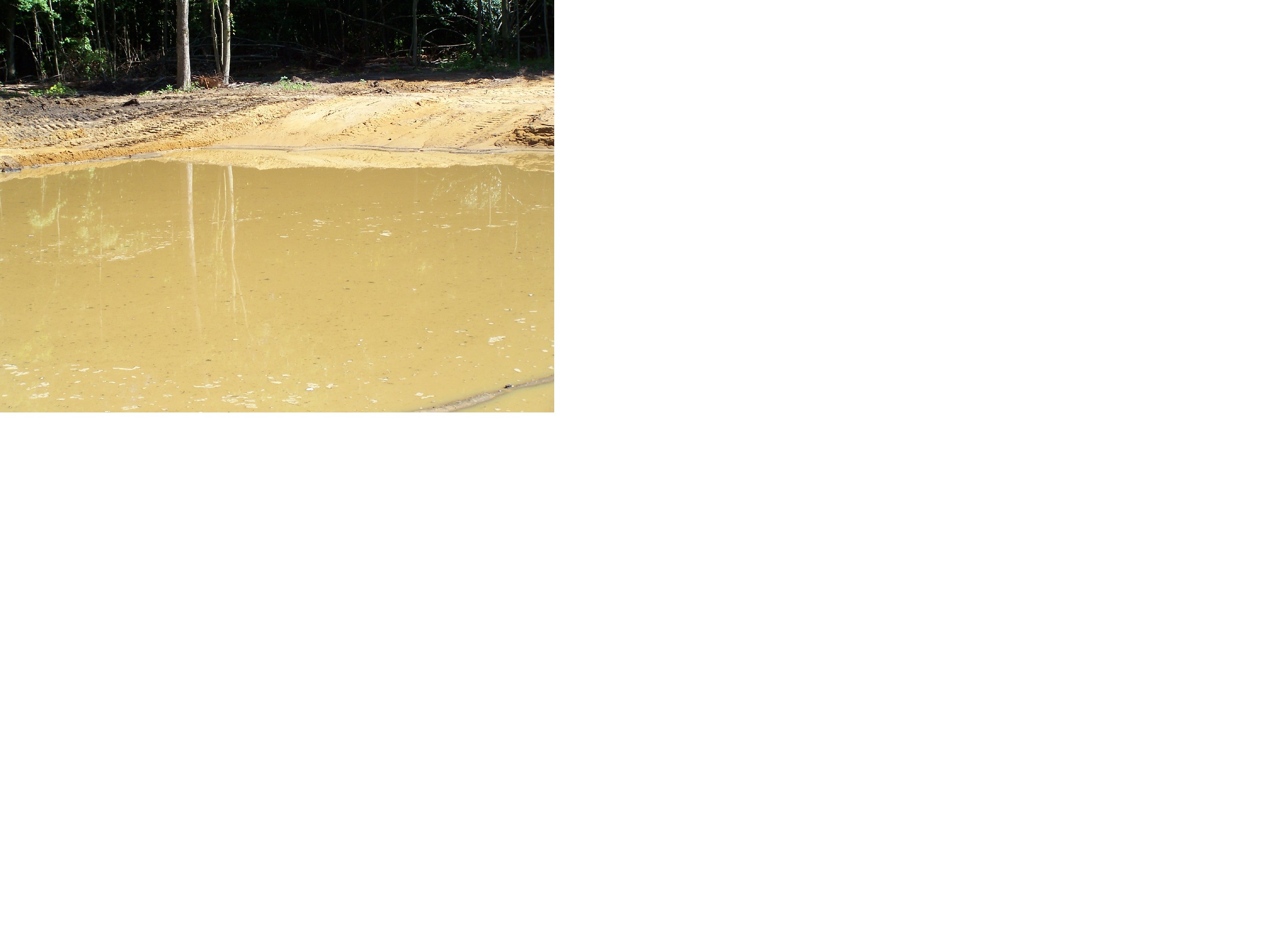

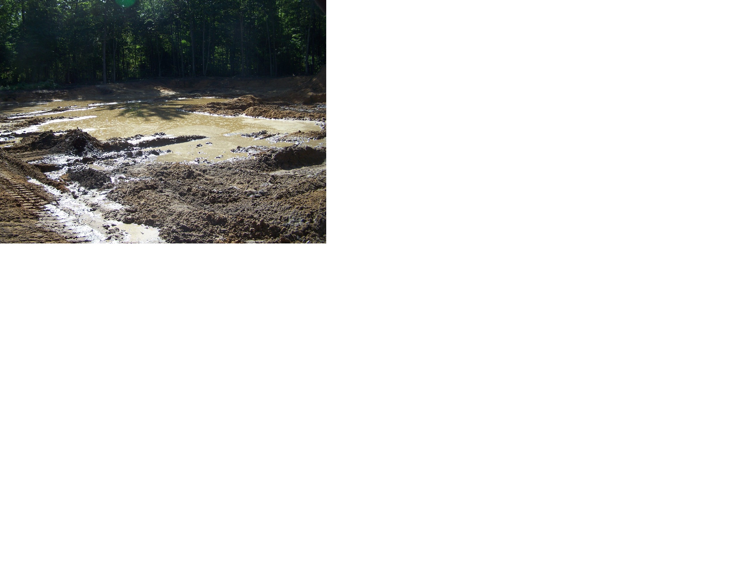

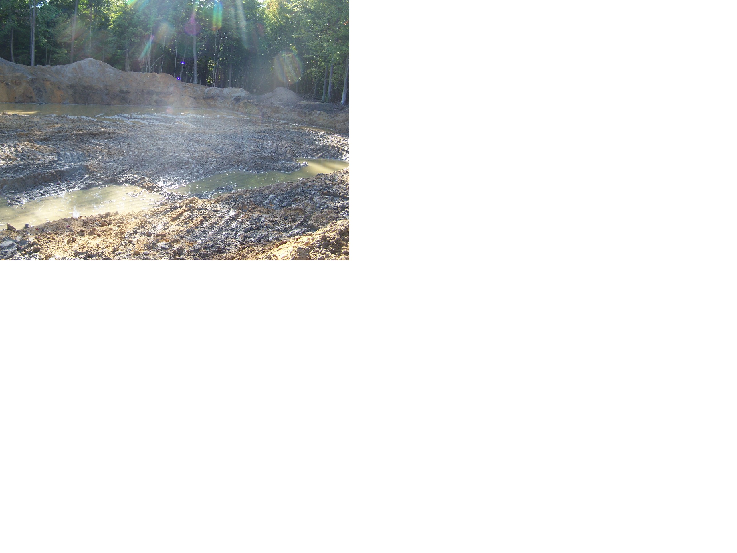

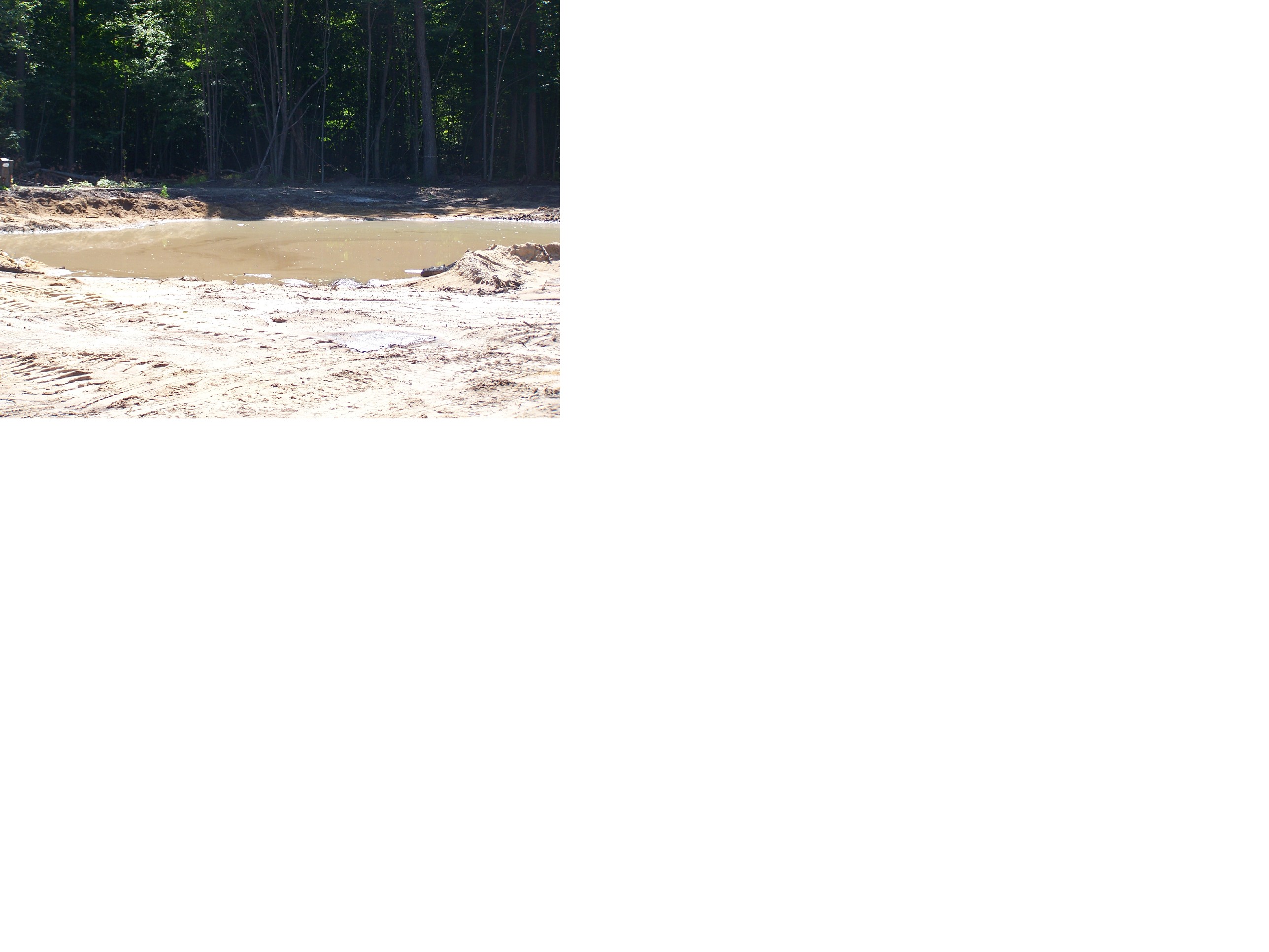

Because of certain government agencies I had to move all the sand with my equipment instead of just digging the pond first like a person normally would. So by August I had moved about 1500-2000 yards of sand myself with just a dozer, backhoe, and 5 yard dump truck.
Finally in August I got the last permit I needed and the friend that loaned me the dozer came in and dug out my pond with his 320C Caterpillar excavator. Its not really a huge excavator for pond digging but it dig a fine job.
Here are some pics of what the pond was like after just pushing sand out with the dozer. Some are after recent rains and it became pretty sloppy

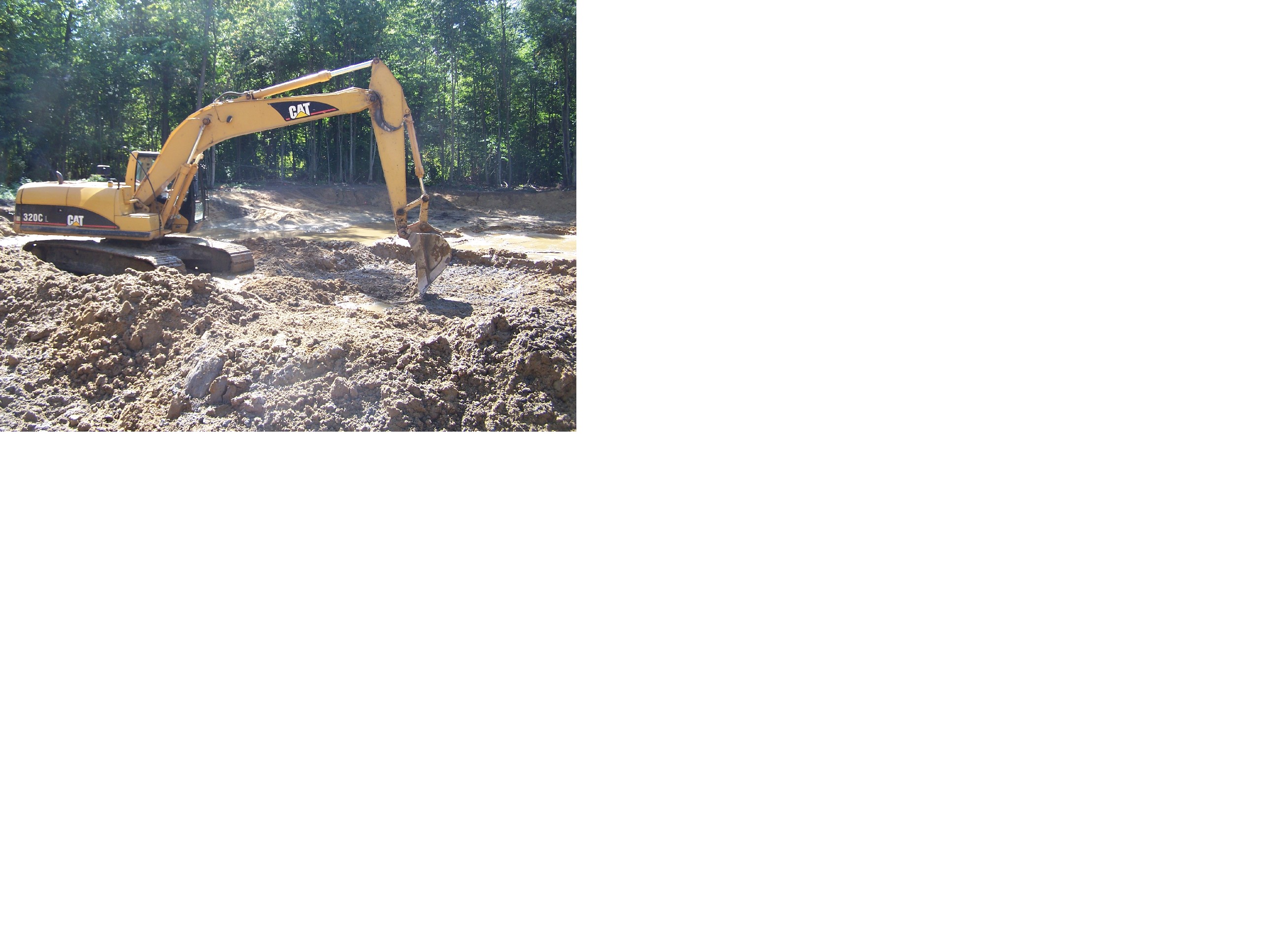

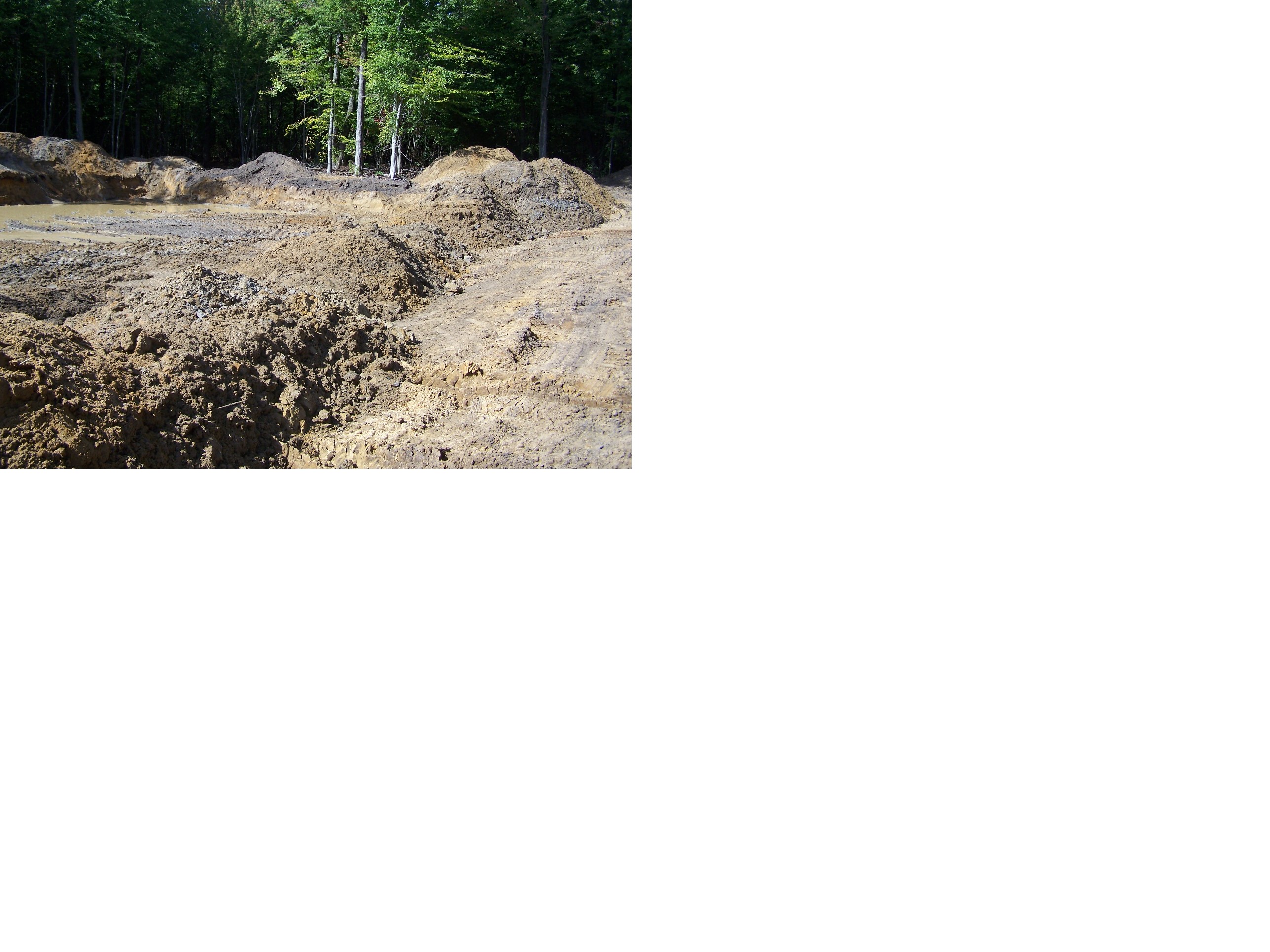

Once we got the excavator out there I had sand coming out of my ears, and eventually, clay. My property has about 6 feet of sand and then pure clay as far down as we could dig.
I thought we would hit another layer of something else but nothing but endless clay. I had to get rid of it somewhere wo I used it for driveway and landscaping base and then put sand and dirt on top. It is almost like cement when dry, but really messy and slick when wet.
We didnt start digging the pond until October, which caused a few problems with my deer hunting.
Chopper (my buddy) started by excavating an area bigger than the 150x120 size of of the pond to a depth of about five feet, and windrowed all the sand to the side. This way he could windrow the next piles of sand to the edge of the pond and keep it separate from the clay. The entire time he was digging I was hauling dirt with the dump truck also to help give him room to work.

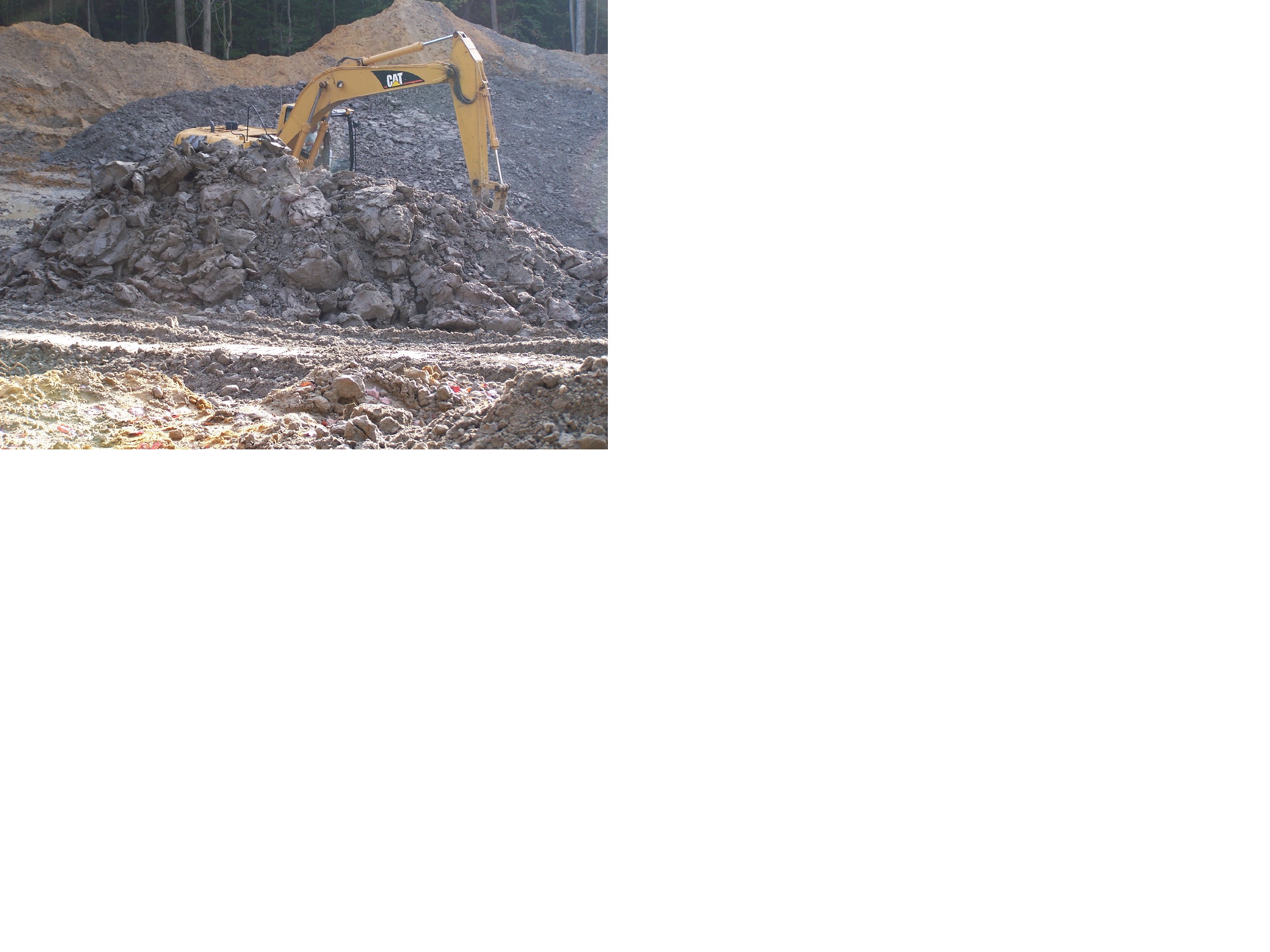

Well getting back to the pond, here's a not so good pic I took as he was digging deeper. After opening the whole pond area he has gone along the back side of the pond and dug as deep as he could. On the back side of the pond there wasn't much room for sand so dug along the back real steep and then did all the rest of the digging from the front and kept windrowing the dirt and clay forward.
Notice the huge chunks of pure clay. For those of you planning to dig a pond with a backhoe, you will never get through this stuff with a backhoe, you need a 25 ton excavator to get through this junk.

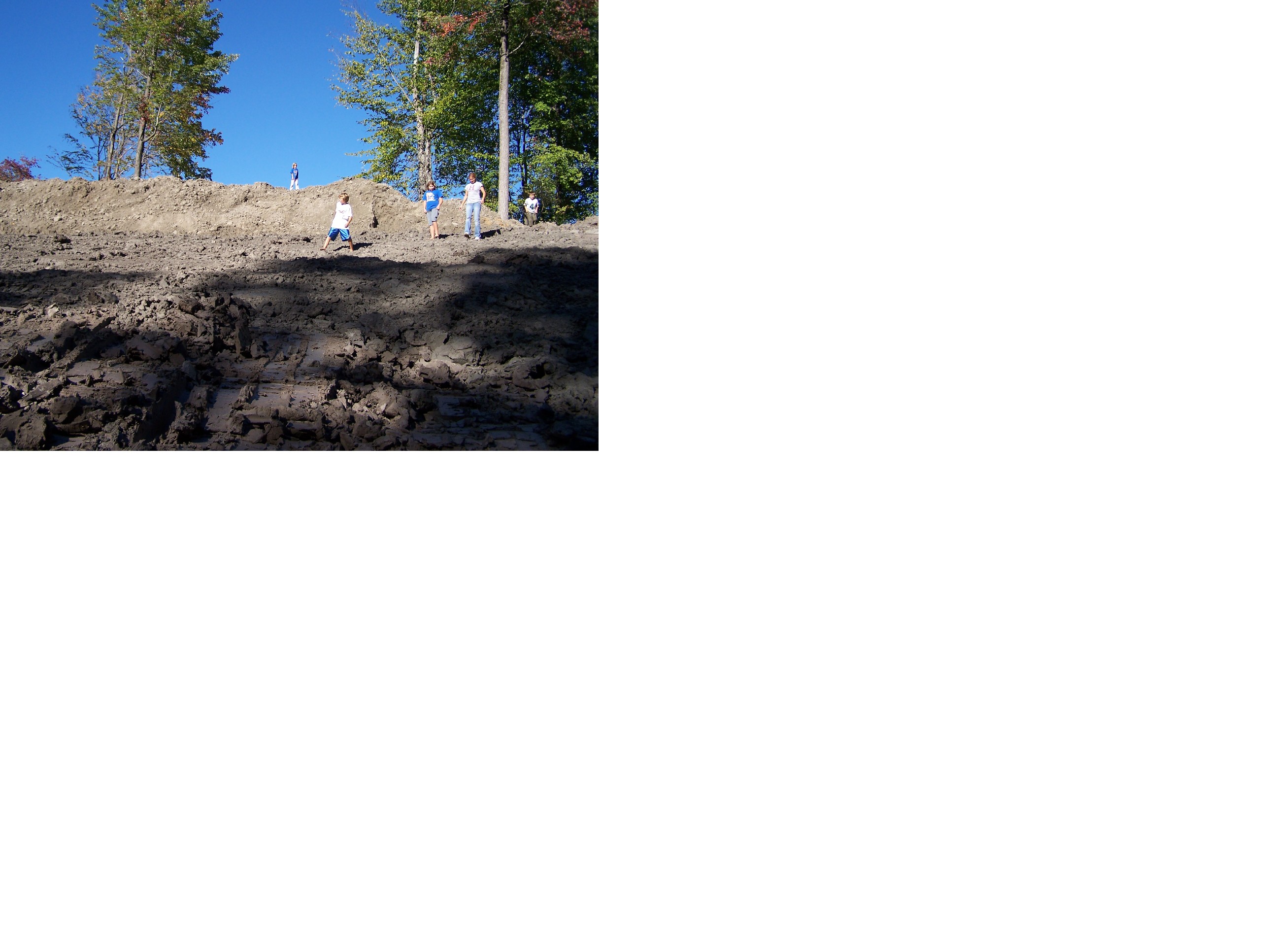

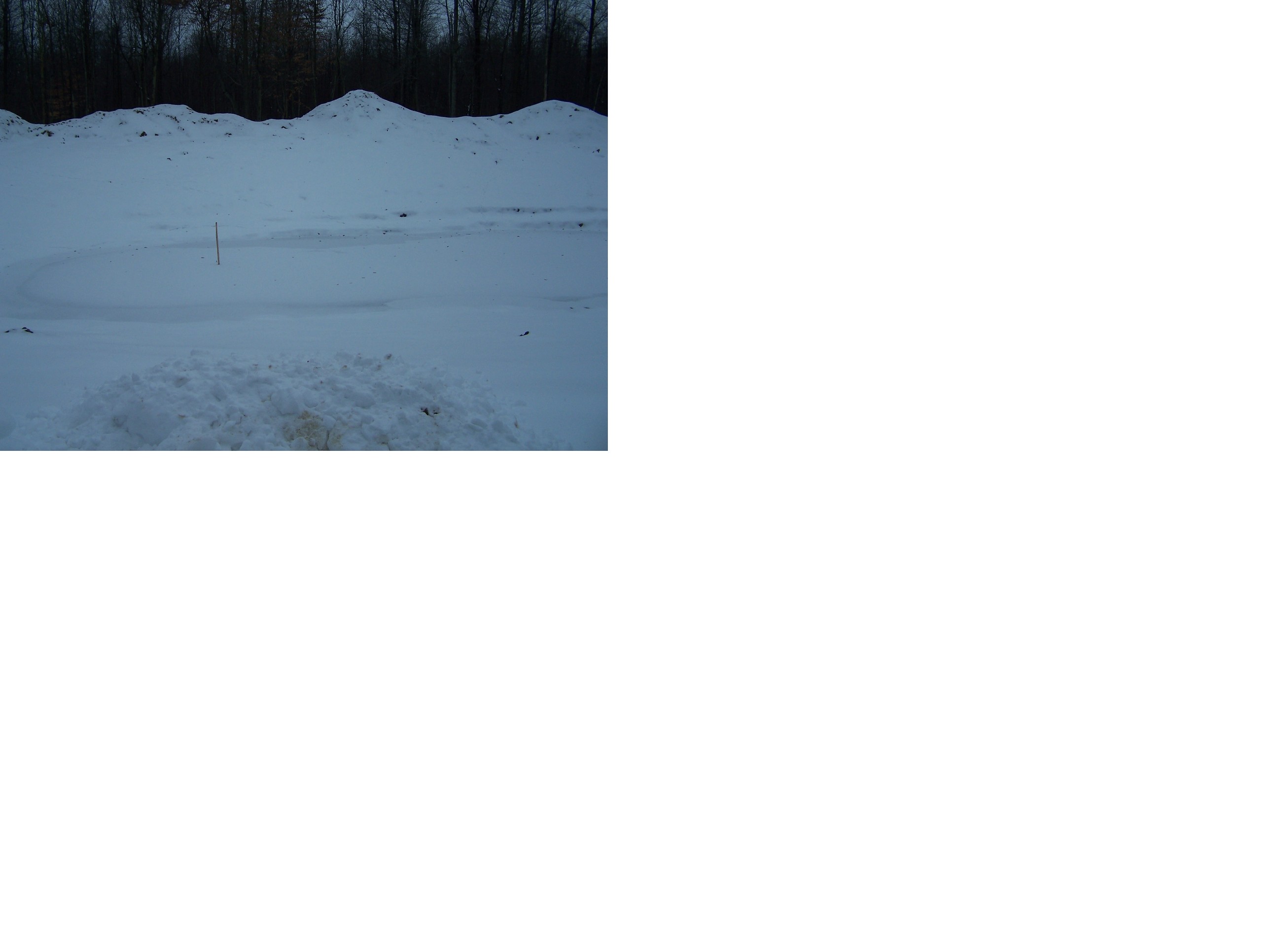

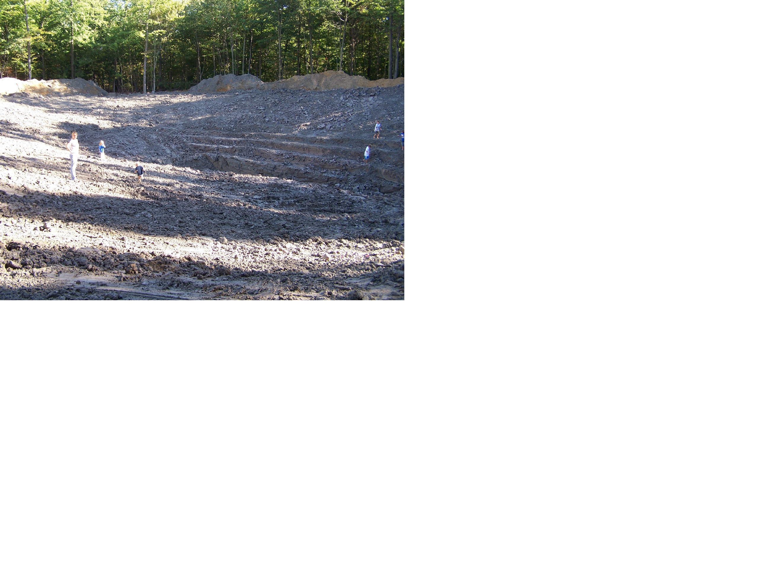

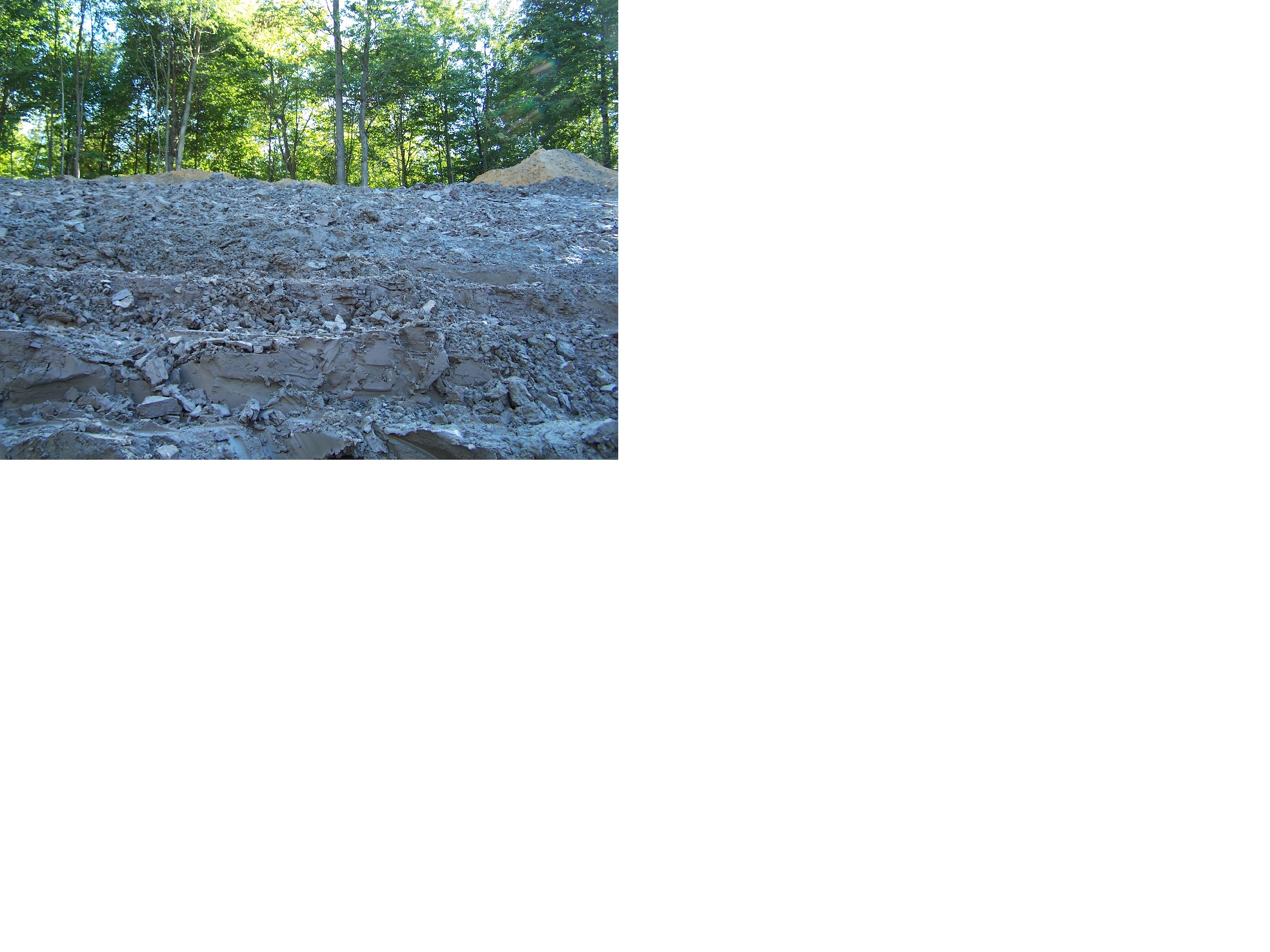

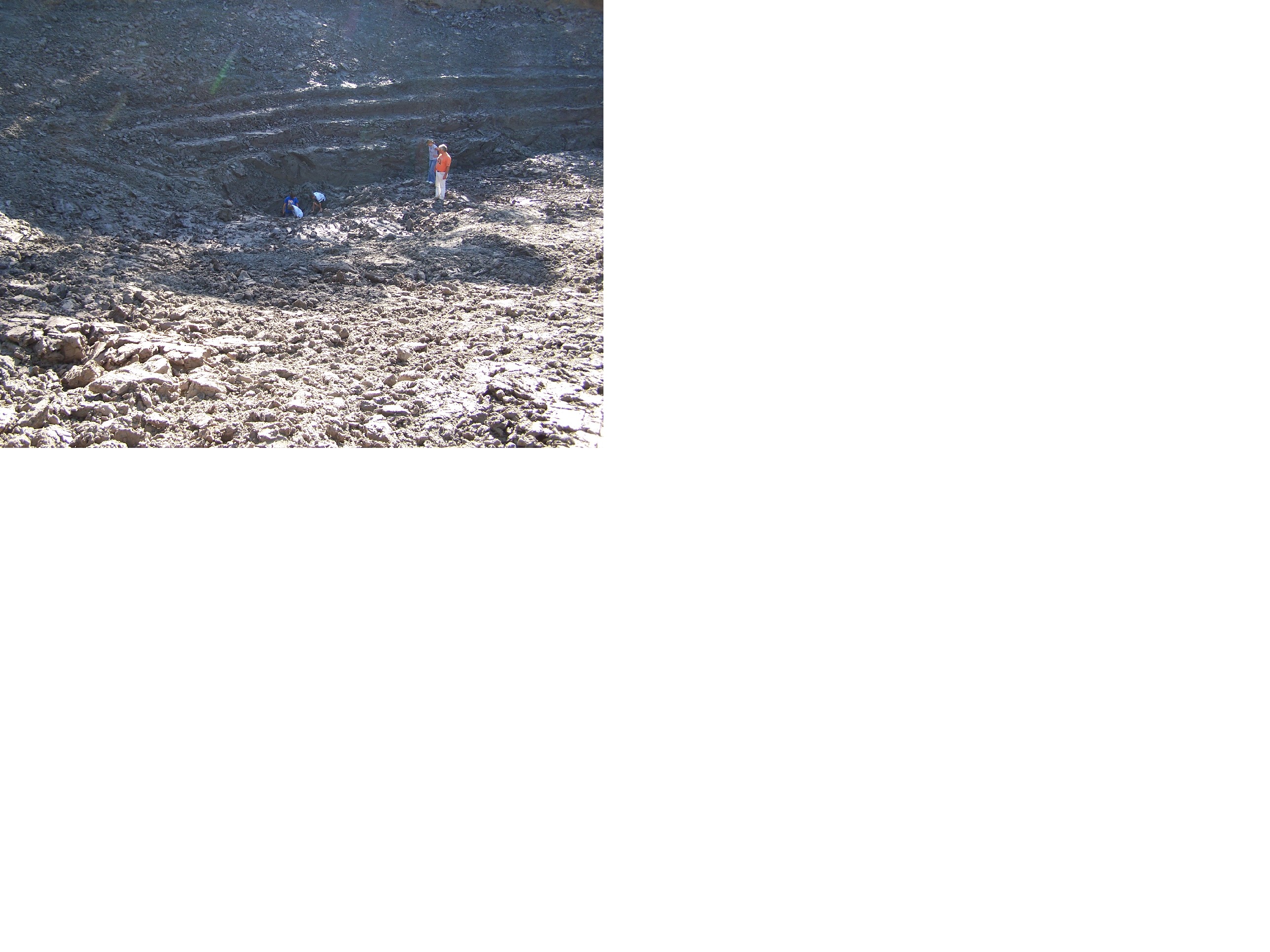

This is when he was done digging. On the third day he brought in a 850G dozer and had another guy spend all day going up and down the pond, pushing clay up and at the same time packing clay down with the dozer tracks. This worked very well, as at this time my pond is only about 12 feet deep but we have had some heavy rains and the pond sides have retained their shape very well with almost no collapsing.
I stuck a 16' 2x4 in the middle of the pond for perspective and thought I had a picture of it but I guess I don't. You will see it in the last pond pic of what it looks like now, with only about 4 feet of it sticking up.
The first couple are from the bottom of the pond looking up. The final size of the pond is about a half acre and the deepest hole is 25'

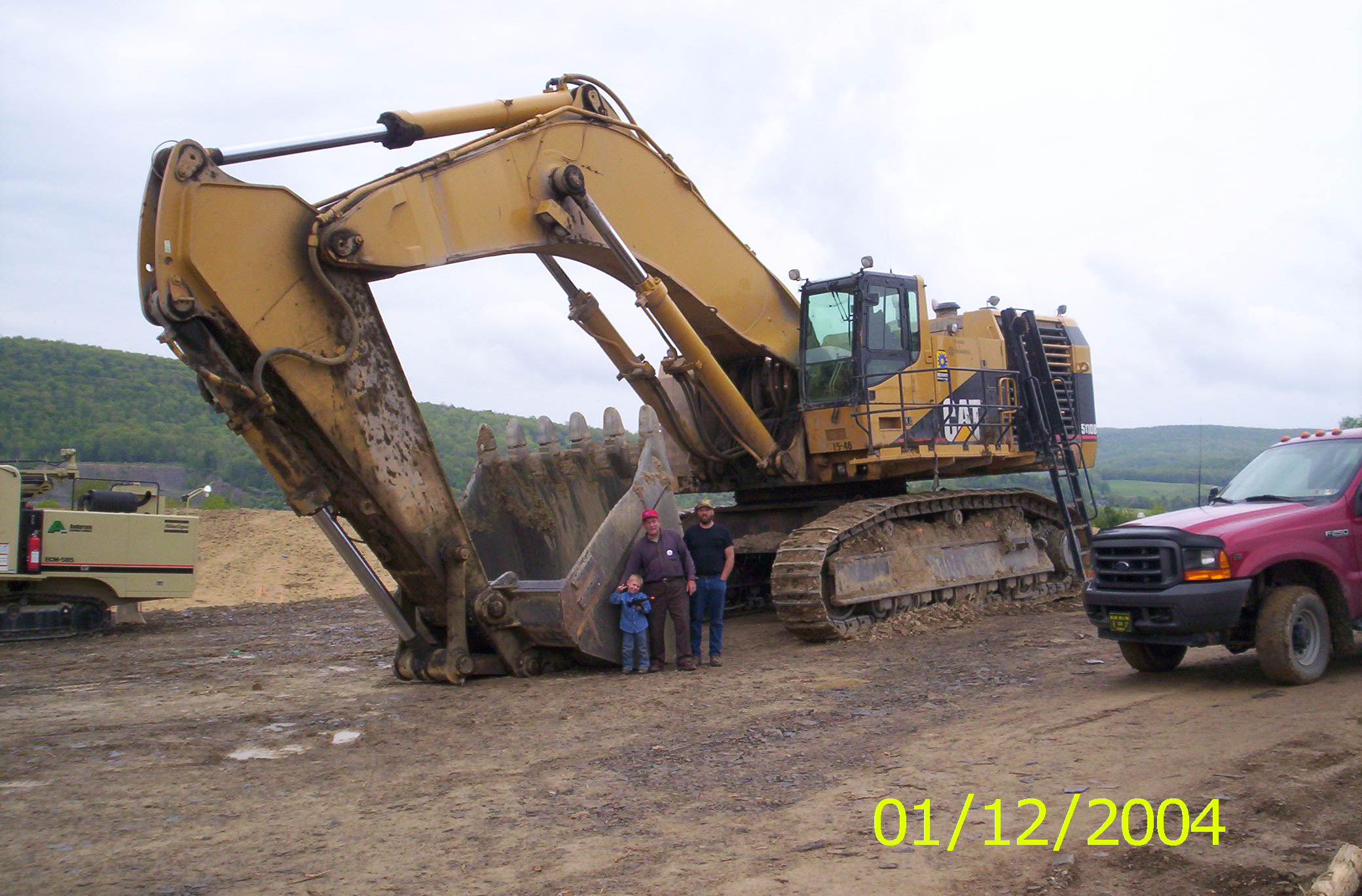

here is what u need.
   / My house, barn and pond project
#19
Now that is a pond digging machine. Is that a five yard bucket?
   / My house, barn and pond project #20
not sure of yards. but from cab scale 20+ ton in one scoop depending on material. have to guess 12-14 yrd.
