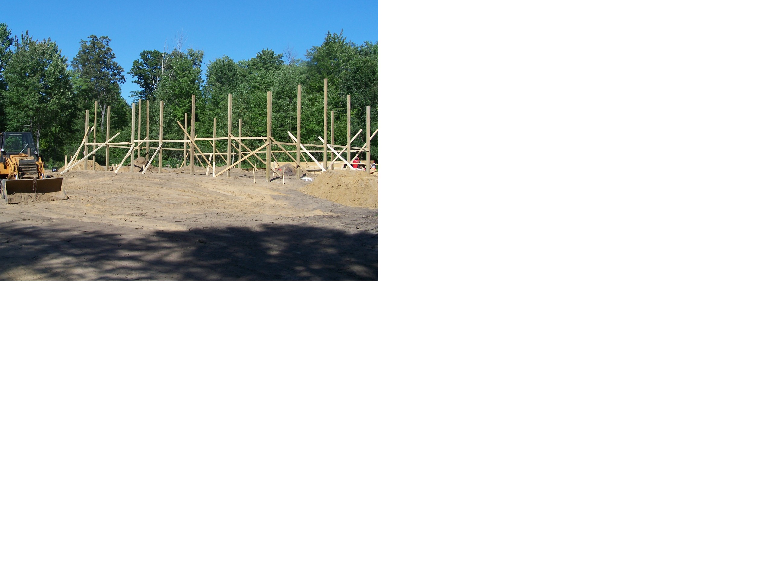

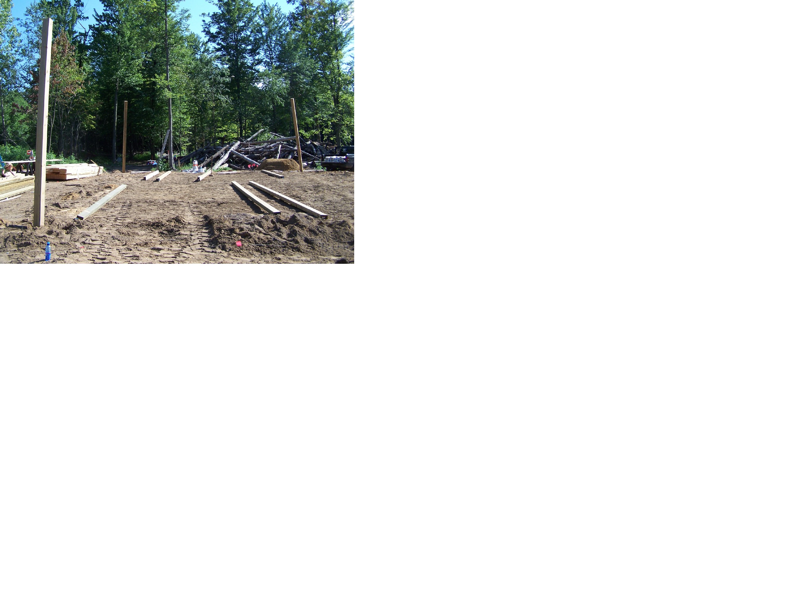

Well since I tore ligaments in my knee Friday working on my barn I now have a lot of time to post more pics for everyone.
Here are the pics of the barn when we prepared the area and were setting the poles. The barn is a 32x48 with 12' walls. I needed tall enough walls so I could get my backhoe, dozer, and dump truck in if necessary.
