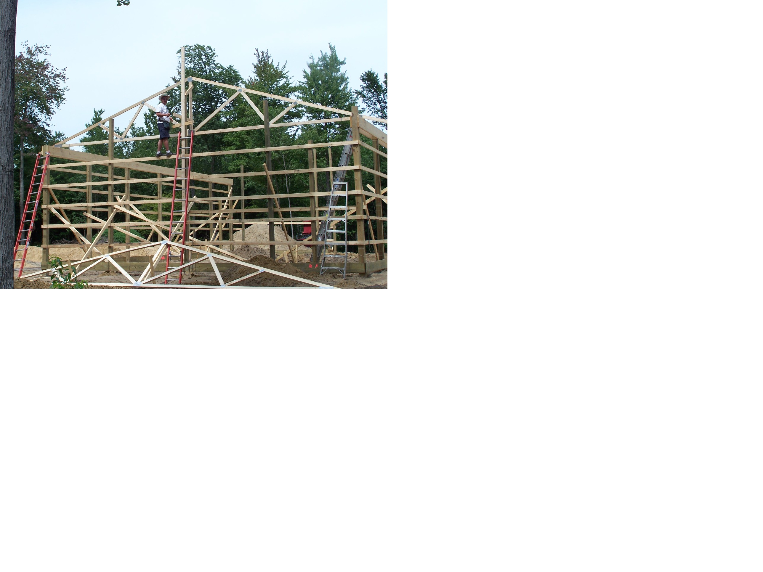

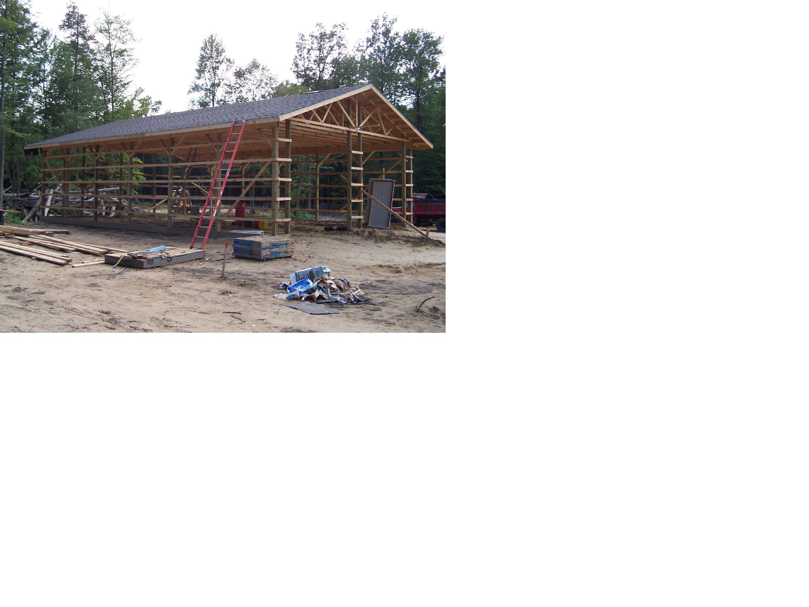

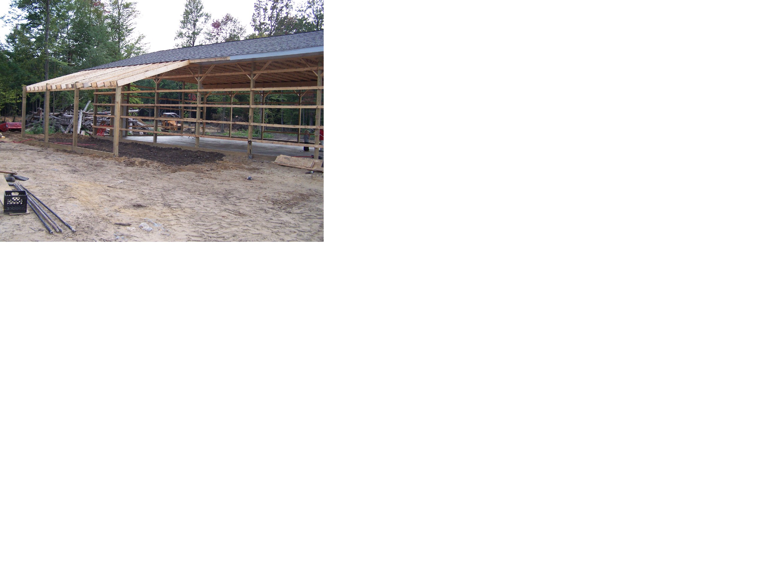

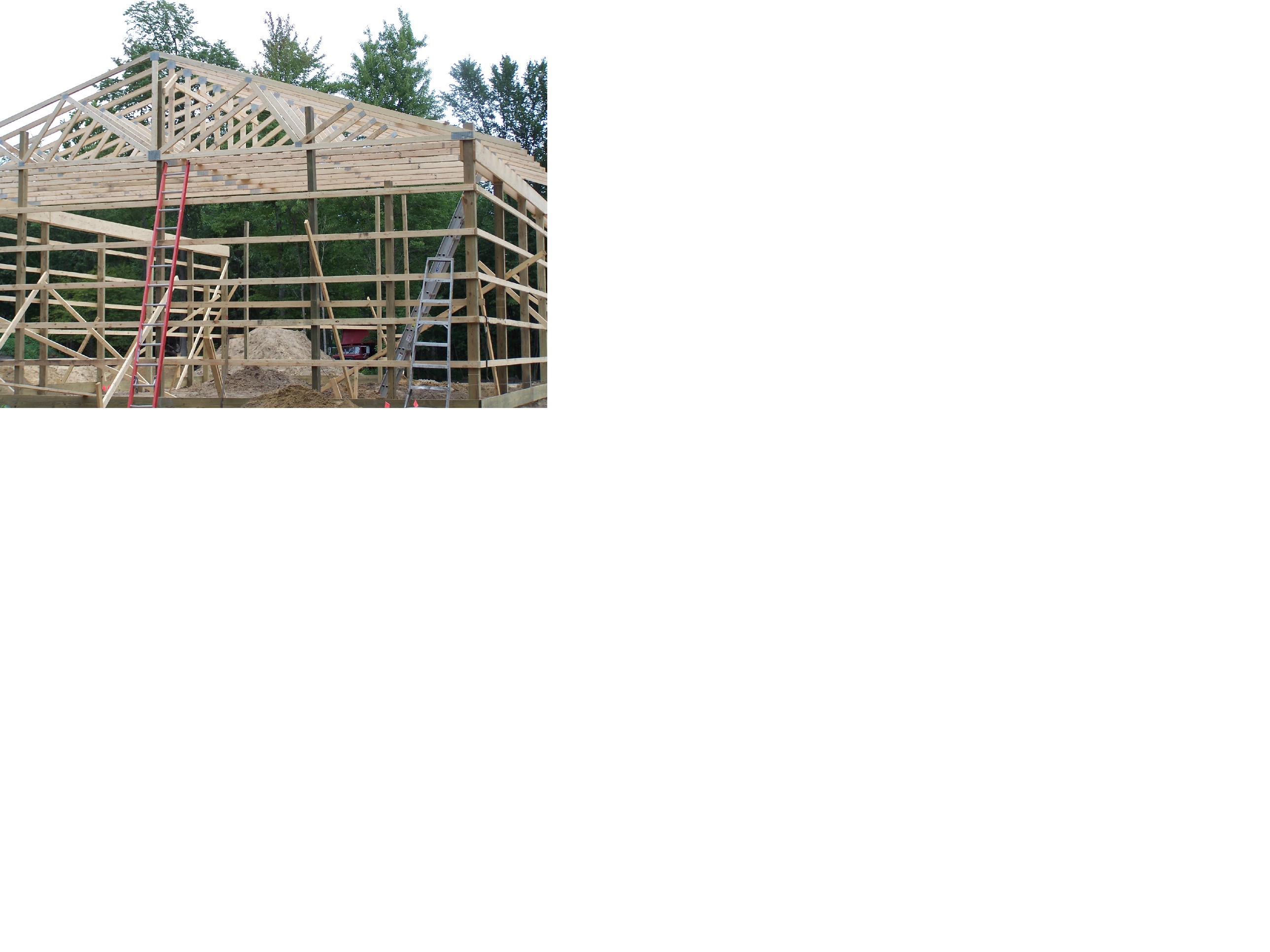

Here is me putting on the first truss and the rest of the trusses as we go. I wish I had taken a picture of my backhoe with the boom on it and lifting up the trusses onto the headers.

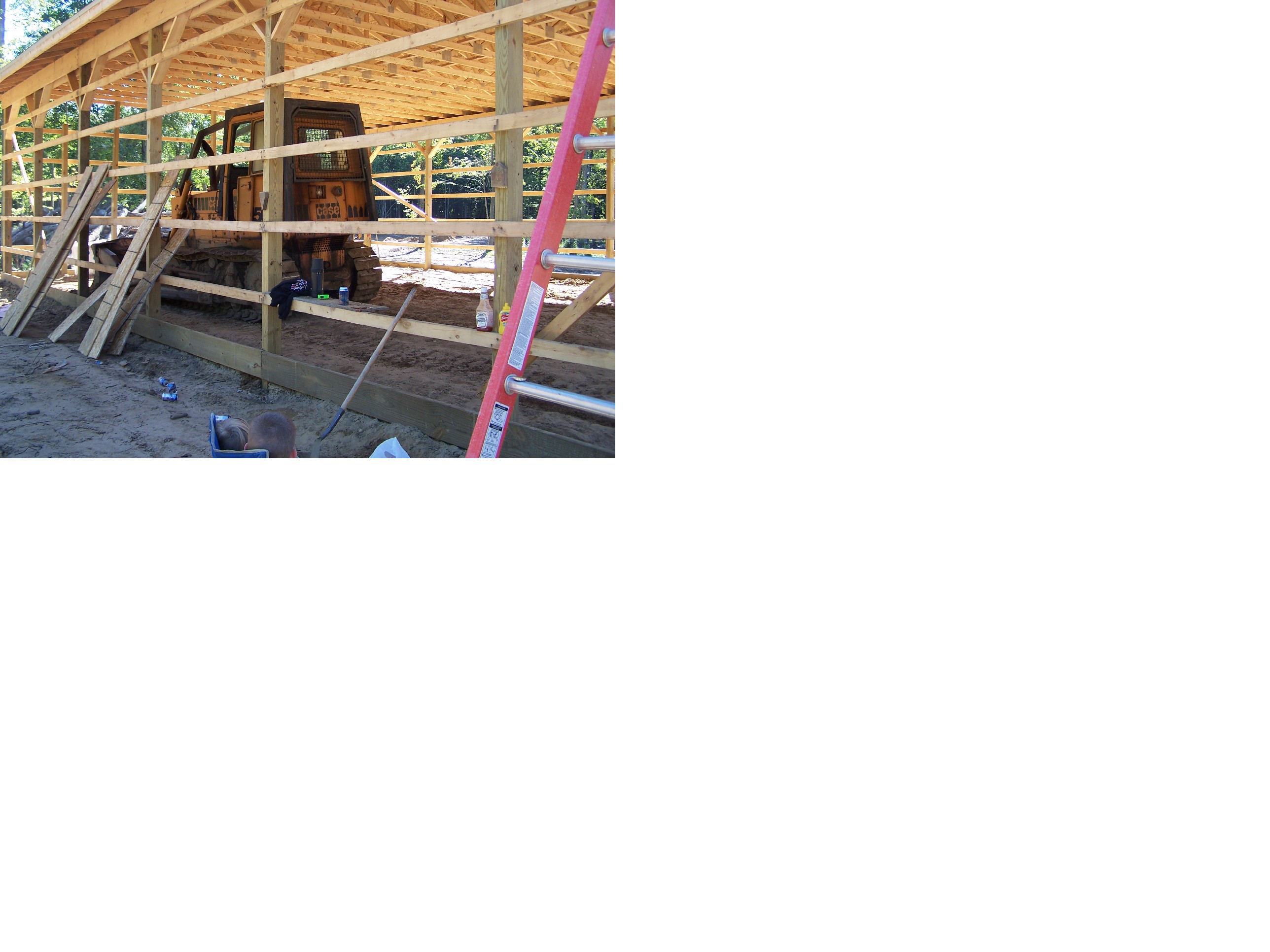

Nothing like using a 25000# dozer with a 10' blade to grade the new floor!

Great pics. Love to see the trusses going up, and how the building comes alive!!!
My shop is 12 ft at the walls, and I really like that height. It gives me allot of wall space for storage, but also plenty of overhead height for working on things. After spending my life working in an 8ft garage, the change to 12 foot was, and still is, AMAZING!!!!!!!

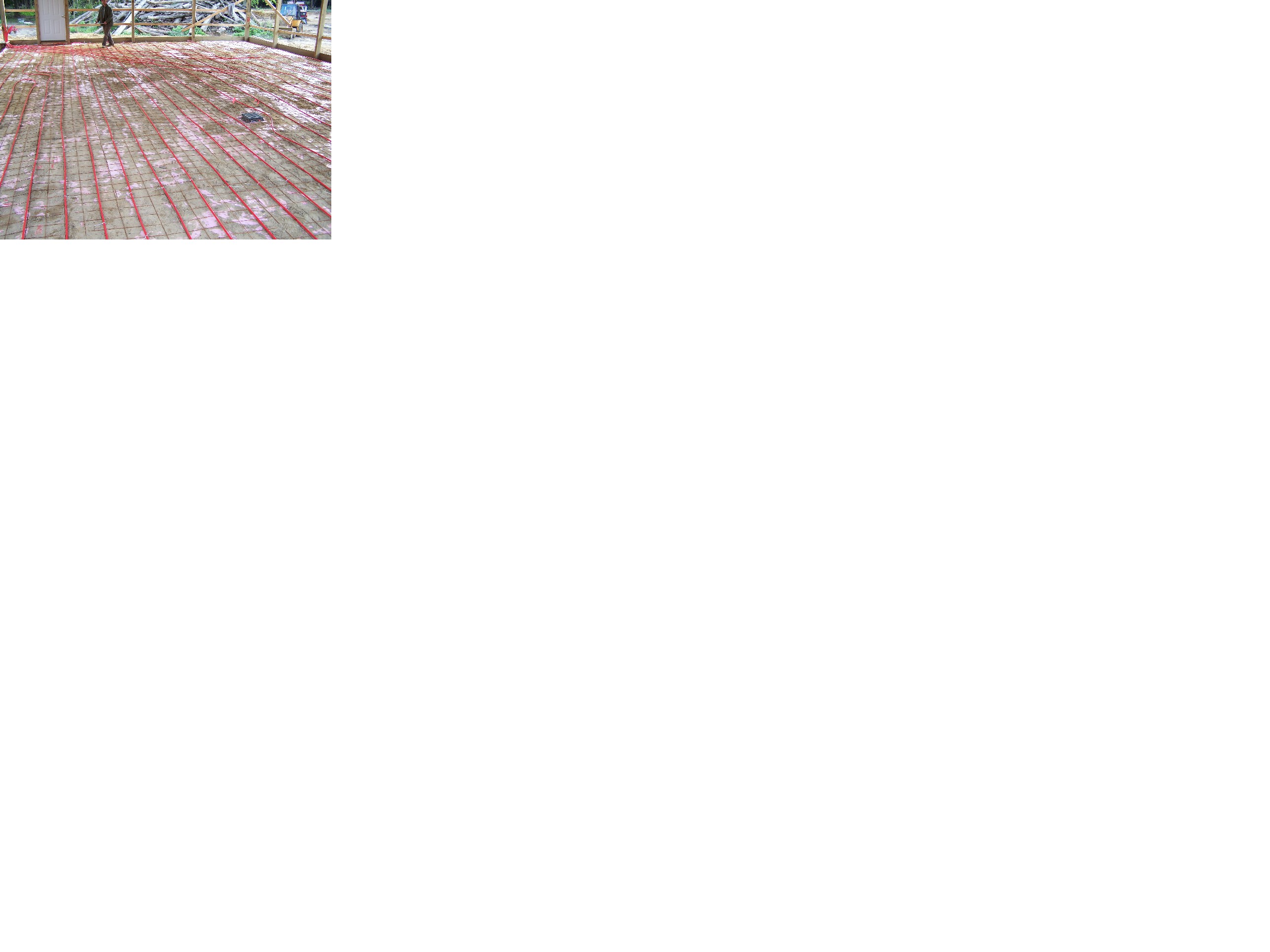

This is the floor after we spent all day laying 1/2" pex and zip tying it to the wire mesh.

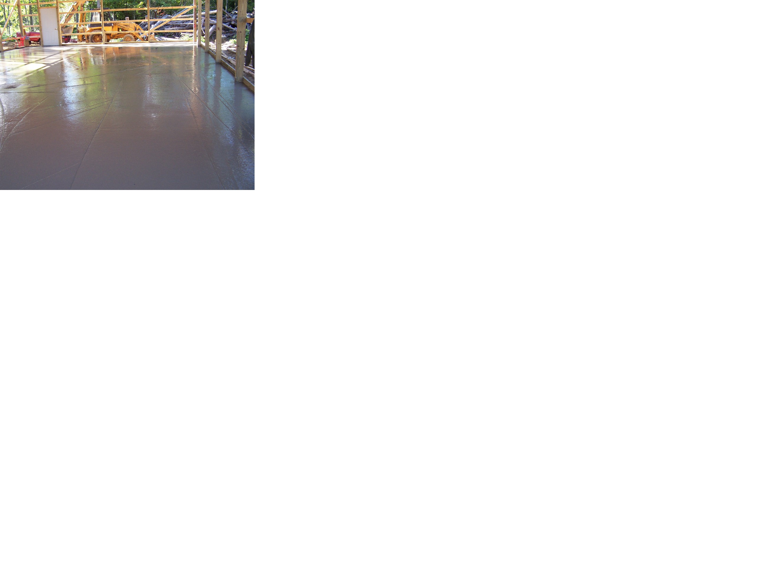

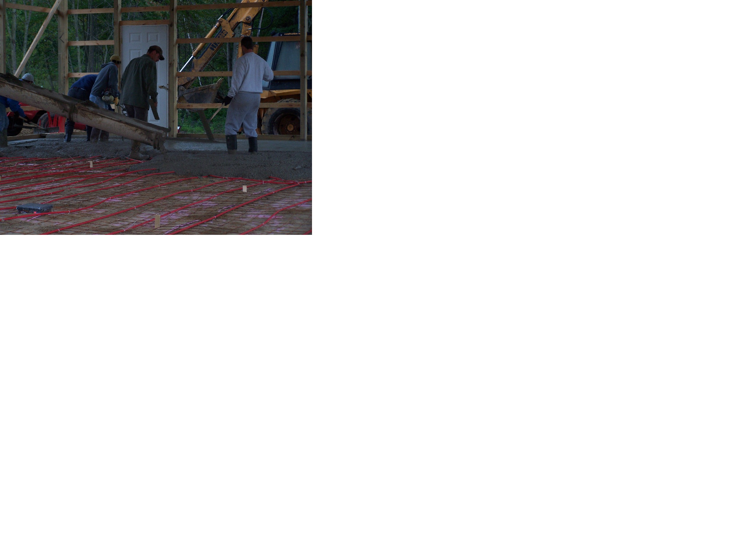

Here we are pouring the cement, 29 yards total, 6" thick.
The power screet was a life saver... until it broke halfway
this is how it looked by 11am

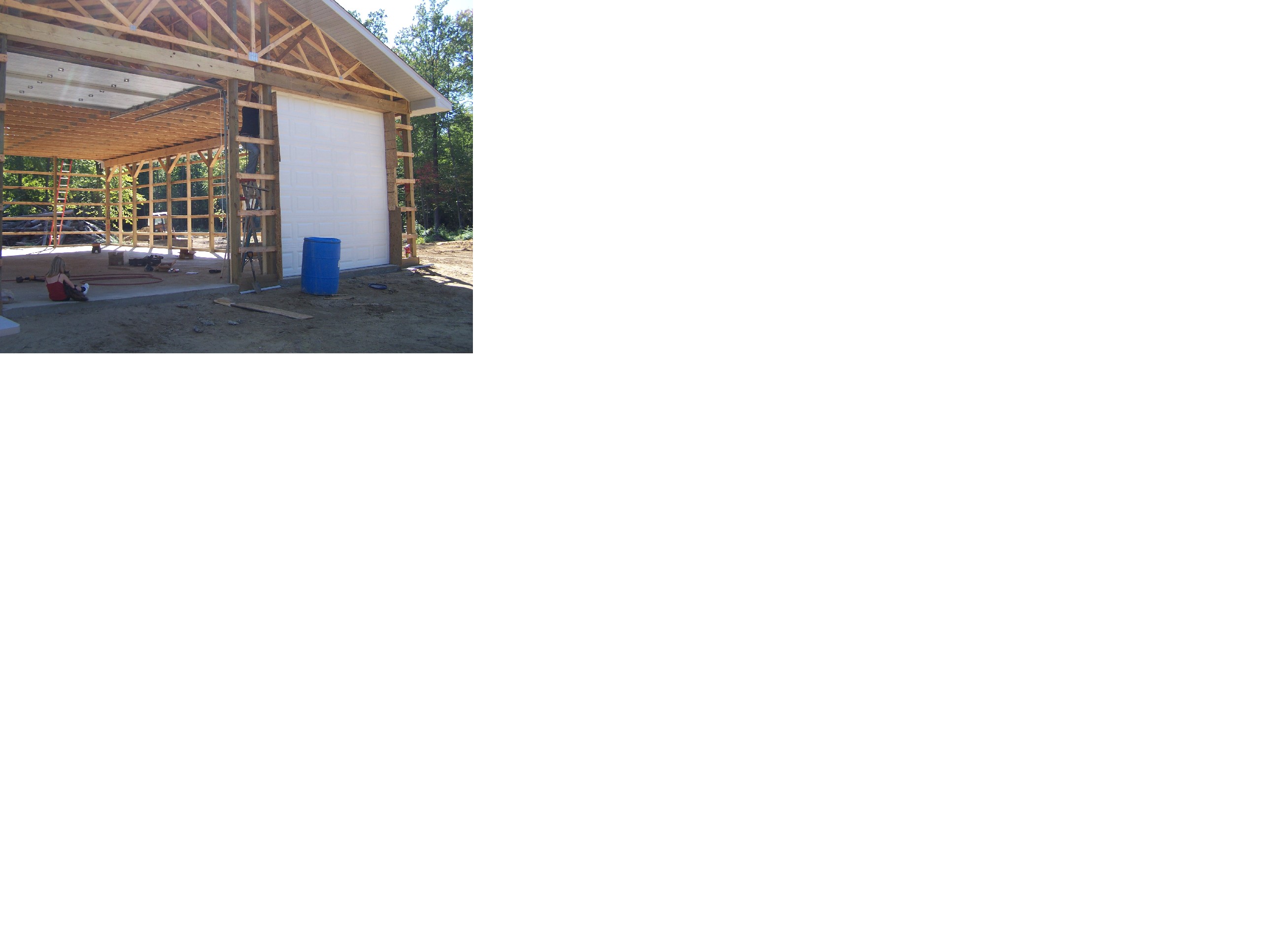

This is the 12' wide x11' tall insulated doors. Winding the springs 12 times each was a blast

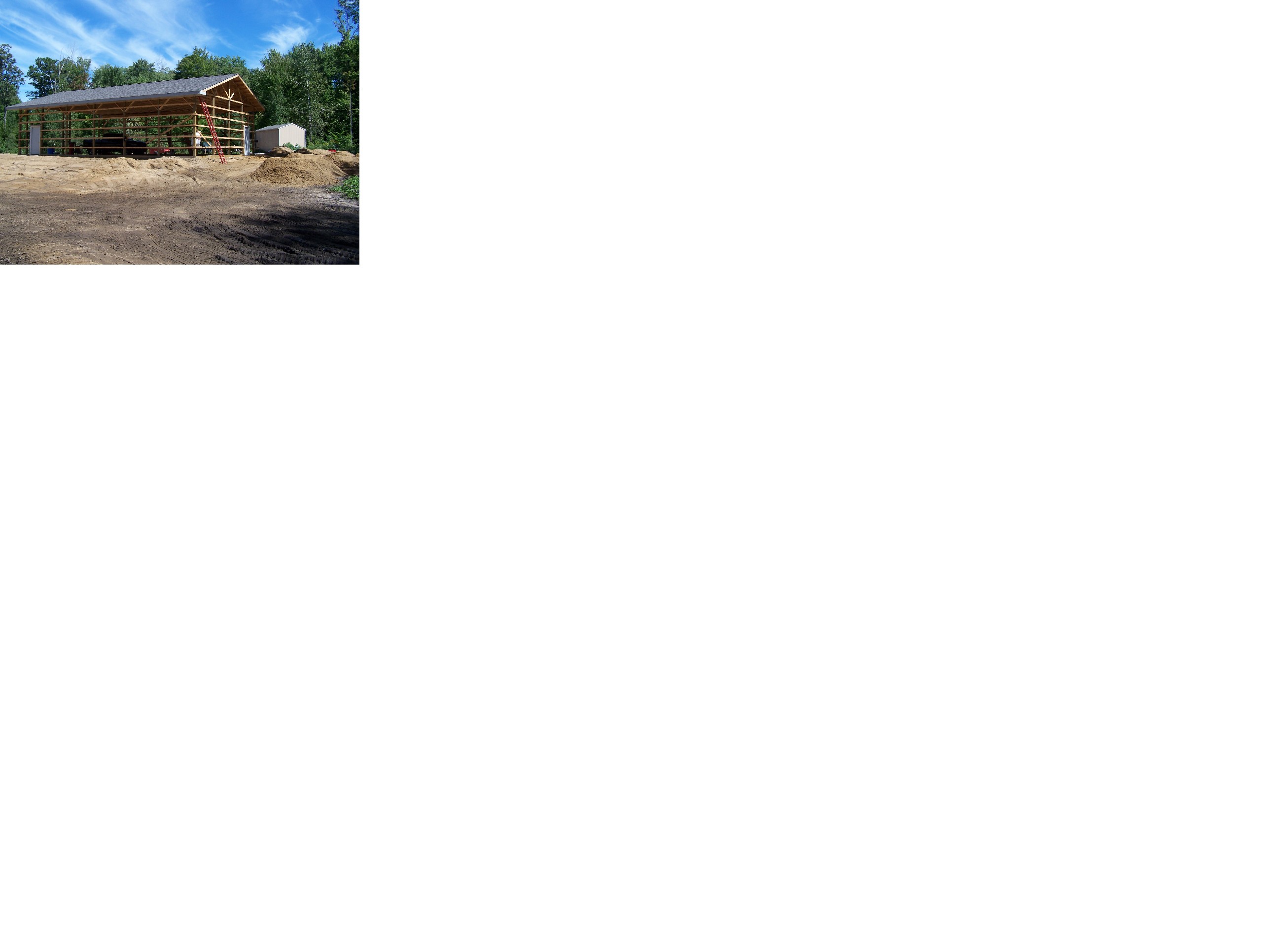

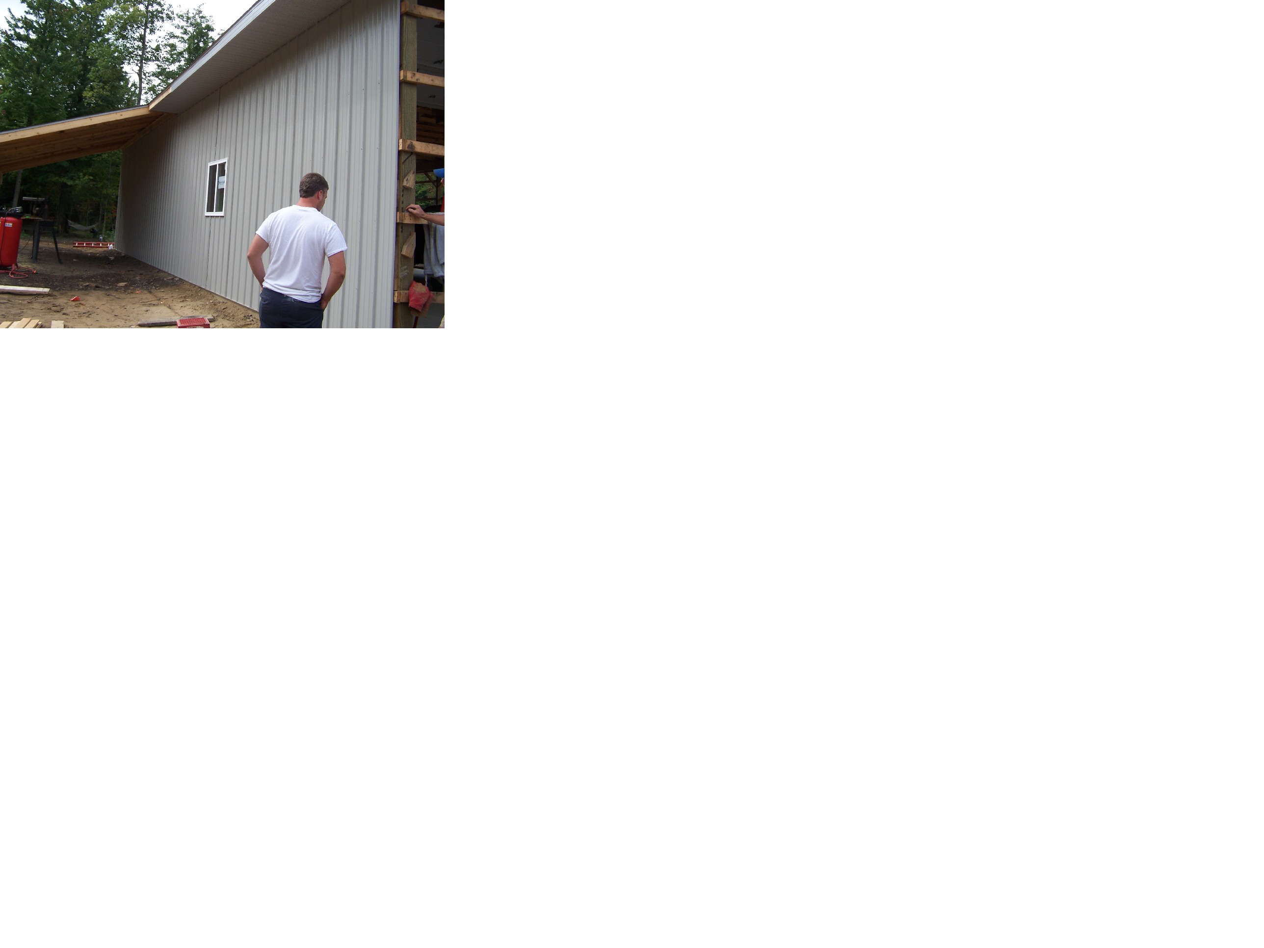

Here is the steel siding, I was real glad when that was done too.
