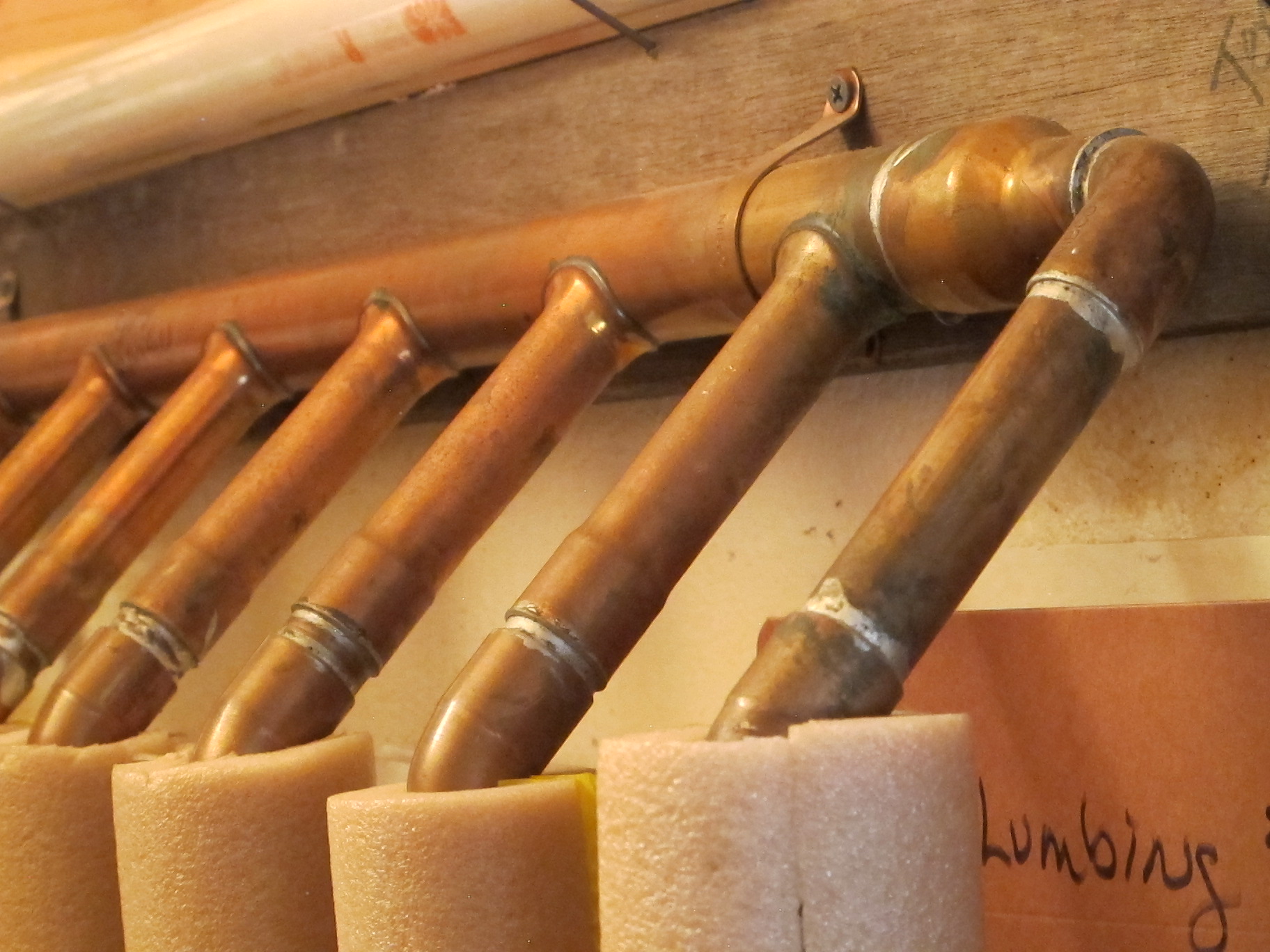

Ed, I count 5 pairs to your manifold ?? I should post a picture of my manifold, I had designed a fancy (expensive) 8 zone manifold for my PEX .... and then I asked an old plumber what he thought. He took one look at my design and said, "Son, you don't know what you are doing. Let me build your whole manifold from scratch. It will work better and cost less".
I took him up on it; he was right, and it is a thing of beauty.

As promised, here is a picture of the manifold my plumber built. All hand soldered.
The extra shutoffs allow any zone to be isolated or any thermostatic valve to be removed without affecting the rest of the system. Circulation is provided by a tiny Grunfos 3 speed pump (quiet), heat source is a 50 gallon HWH.

Yeah, I remember when the plumber brought the manifold over how I was just as blown away by the craftsmanship as well as slightly stunned by the number of valves he put in. But then he explained that he had built it like a plumber would build his own system - so that if any service was ever needed, any loop could be isolated, diagnosed and repaired without affecting the rest of the system. No need to drain or de-pressurize the whole system. And looked at that way, it sure makes sense.
The photo only shows a part of the valving. There is also a connection for periodically filtering or replacing the fluid. As well as a sub-loop for removing bubbles and to compensate for heat expansion. Plus connections in case I wanted to use a different heat source.
He got it right. It's been 12 years now, and the floor heat hasn't required any attention. I did filter the fluid once.
Those flanged connections he made up where each loop connects up to to the main cross manifold at the top of the picture had to have required some real craftsmanship to make them fit so nicely. There are 8 of those connections - all in a row, & all of them at exactly the same angle. The flanged solder joints are a marvel all by themselves. You could use that whole manifold as a straight edge. Perfect....Crazy....
