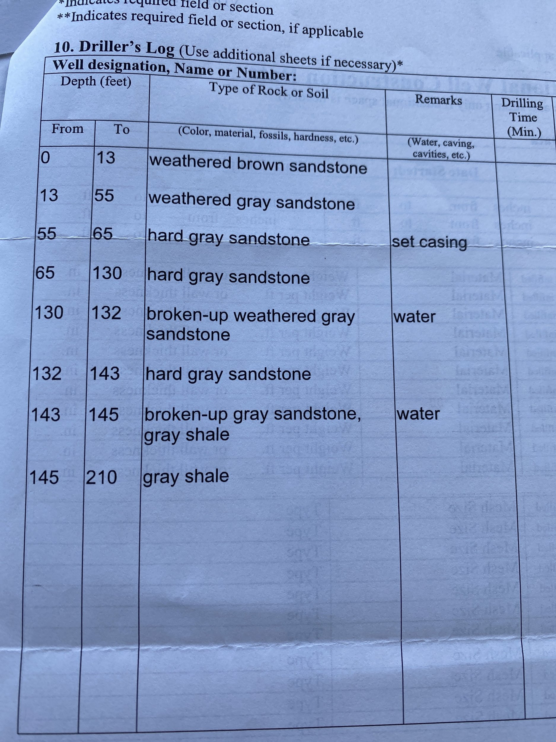

Back in 2018 when I had it drilled (Feb I believe). I talked to the driller and he said it would be $400 to run the line from well to the house. I don’t know if that was just labor or included the line. I don’t remember anything about the pump being discussed. I’s live to hit the easy button and have someone else donit but I am guessing I would be looking at $1,000 in labor costs and markup.
Also, i need to install two frost proof yard hydrants. Doing this myself is a pain but it also means I know how to fix it later on if something goes south.
I was planning on running the poly line and having it layed out place when the electric trench is dug, so that I can join up to that trench halfway to the house and drop it in the same hole.
Looking at the well report filed with health dept,
Well depth 210 feet
Borehole depth 65 feet
Depth to bedrock 55 feet
Hole size 10 inches 0-65 feet
6 inches 65-210 feet
Casing size 6 1/4 inch from +2 to 65
Material PVC SDR 27.6
Water zones from 130-132. 143-145
Pump test
Static water level 30 feet
Flow rate 30gpm
Drillers log
I’ll probably take this info with me to one of the recommended stores here and talk to them to get what I need to do this. Not happening today so I still have time to drive myself crazy with research.
