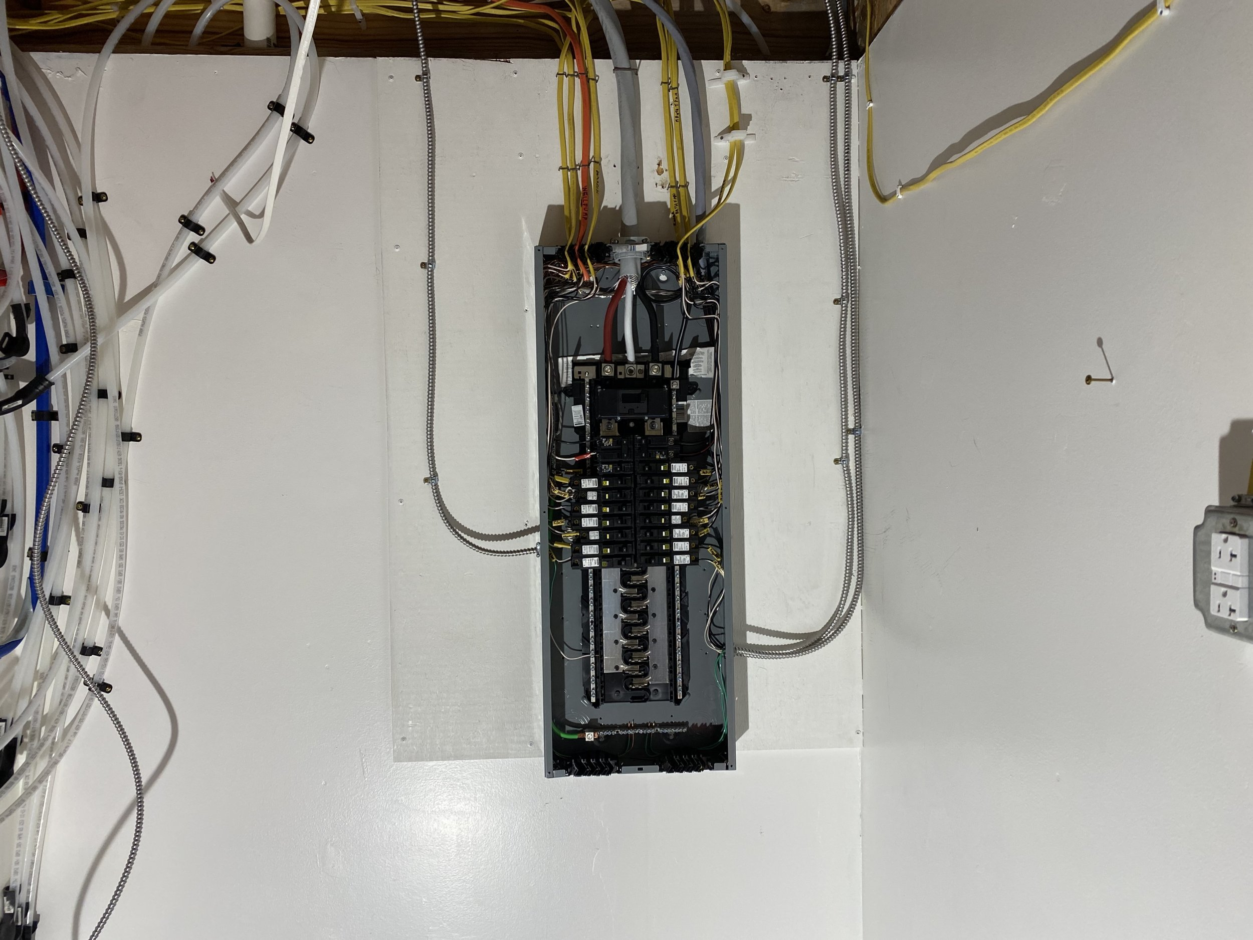

I used them quite a bit this weekend. Friday I was off and got a call that my Air conditioning equipment was at going to be delivered. By Tractor Trailer. Not possible. So I drove up to Fishersville with my trailer when I get there the manager says I need to take a look at some damage. Three pallets and all three were badly damaged. Holes in boxes and damaged condensers and line sets. I refused the entire order. 66 miles round trip. Spoke to them today and they are sending a whole new order. I put a pressure gauge on the Pex supply plumbing and spent a good part of yesterday and today finding and fixing leaks. I think I have it sorted out.
I also got the main panel wired up. I still have a few lines to put in in but I feel like I’m miles ahead
Of where I was.

The inspector might ask you to cover the wires coming up out of the top of the panel until they get into the joists. If so stick a couple 2x's there and scrap of OSB or plywood over the top of them to box it in. Use screws so you can get access later if needed.

Great work! Keep pushing.
That pex line situation looks, uh, interesting LOL.
