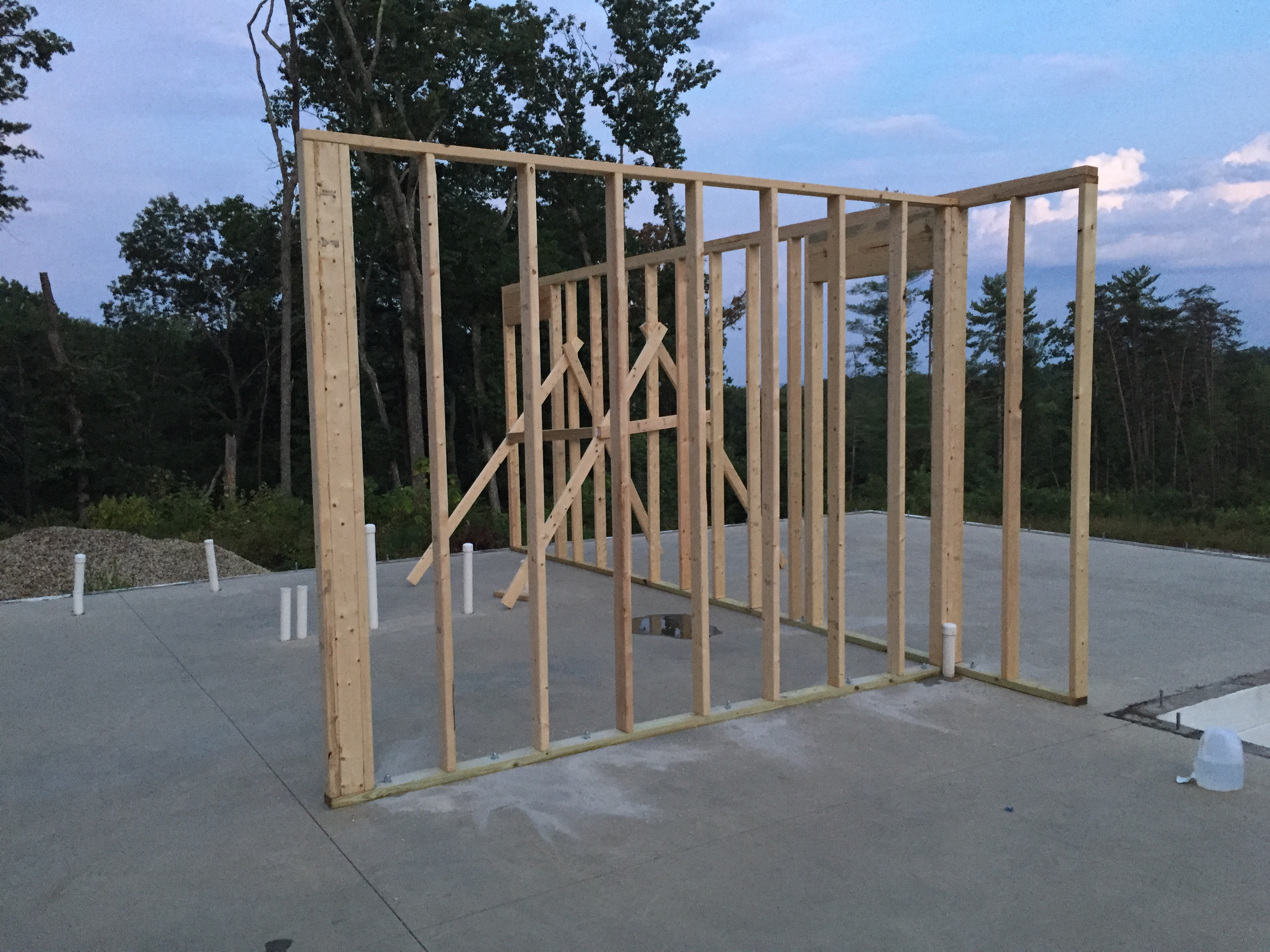

My house was designed by an architect. there are sheer walls on each side where it is stick built. They must be anchored to the slab with 5/8 inch anchor bolts, no more than 32" off center. I am following my plans. The rest of the walls will be attached to the floor with construction adhesive. That follows the building suggestion of the SIPs manufacturer. The foundation is a wide U-shape. The sides of it are conventional lumber (stick built) the center section is post and beam. All exterior walls and roof are SIPs.
Sounds typical and familiar. I'd do it in much the same way. First thing I would do is go back to the architect, tell him the problem, and ask him for an alternative anchoring scheme. It sounds like he is half way there already.

I drilled and anchored these two sheer walls yesterday. I had planned to build more but a thunderstorm had me hiding in my truck for several hours. The lines have survived. I have a few more holes to drill in the long wall and one more short wall to do and I will be finished with the drilling.

Bolts work. If the plan is for bolts, that's what should be done. Is construction adhesive allowed instead of bolts for Code anywhere in the country? My experience with Liquid Nails and Loctite is that you can peal it off of the concrete from the edge. It holds wood to wood really well, but I've never been impressed with how it holds wood to concrete.

I don't think we are talking about exterior walls. There shouldn't be any problem with bolting the exterior walls because you don't run the PEX that close to the edge of a slab. Normally you keep the PEX back a couple of feet from the edges of a slab. You want the heat inside the house, not wasting heat by heating the edges of the slab that are exposed to the outside temperature.

Bingo. And use polyurethane adhesive instead of plain old liquid nails. It'll stick...
