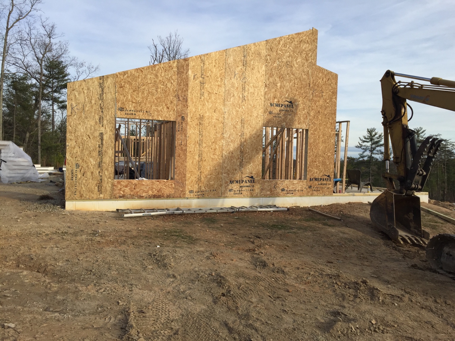

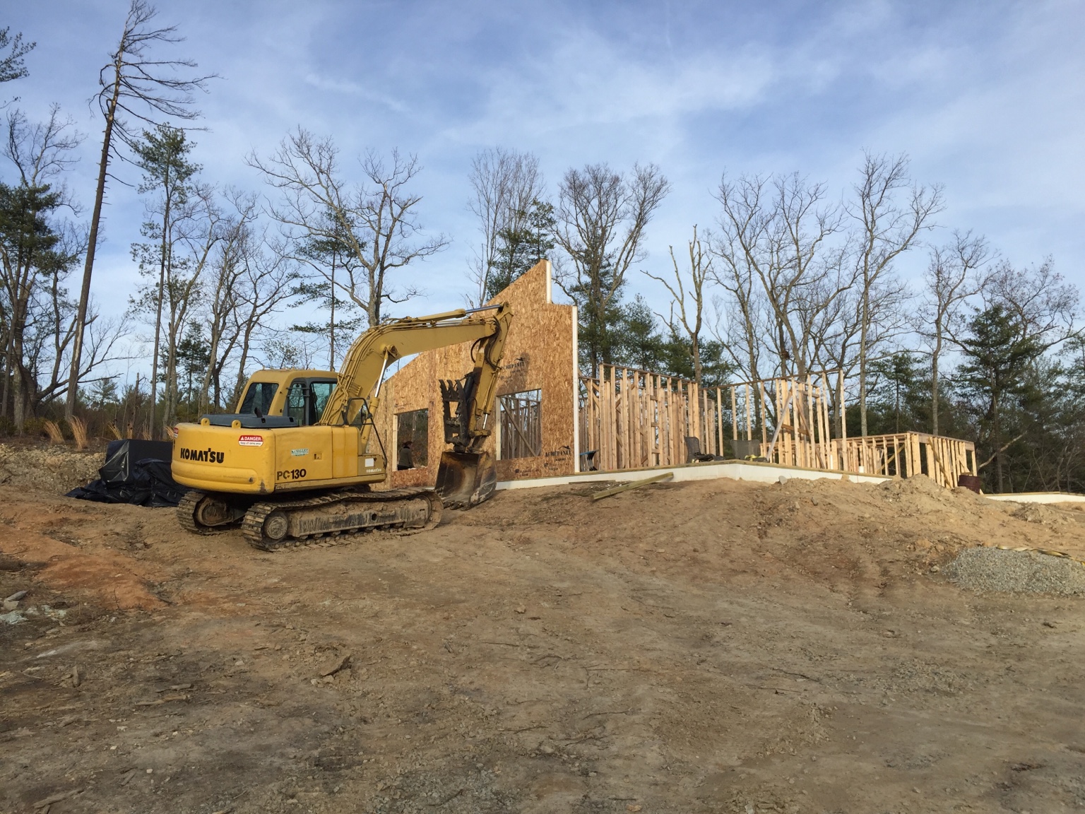

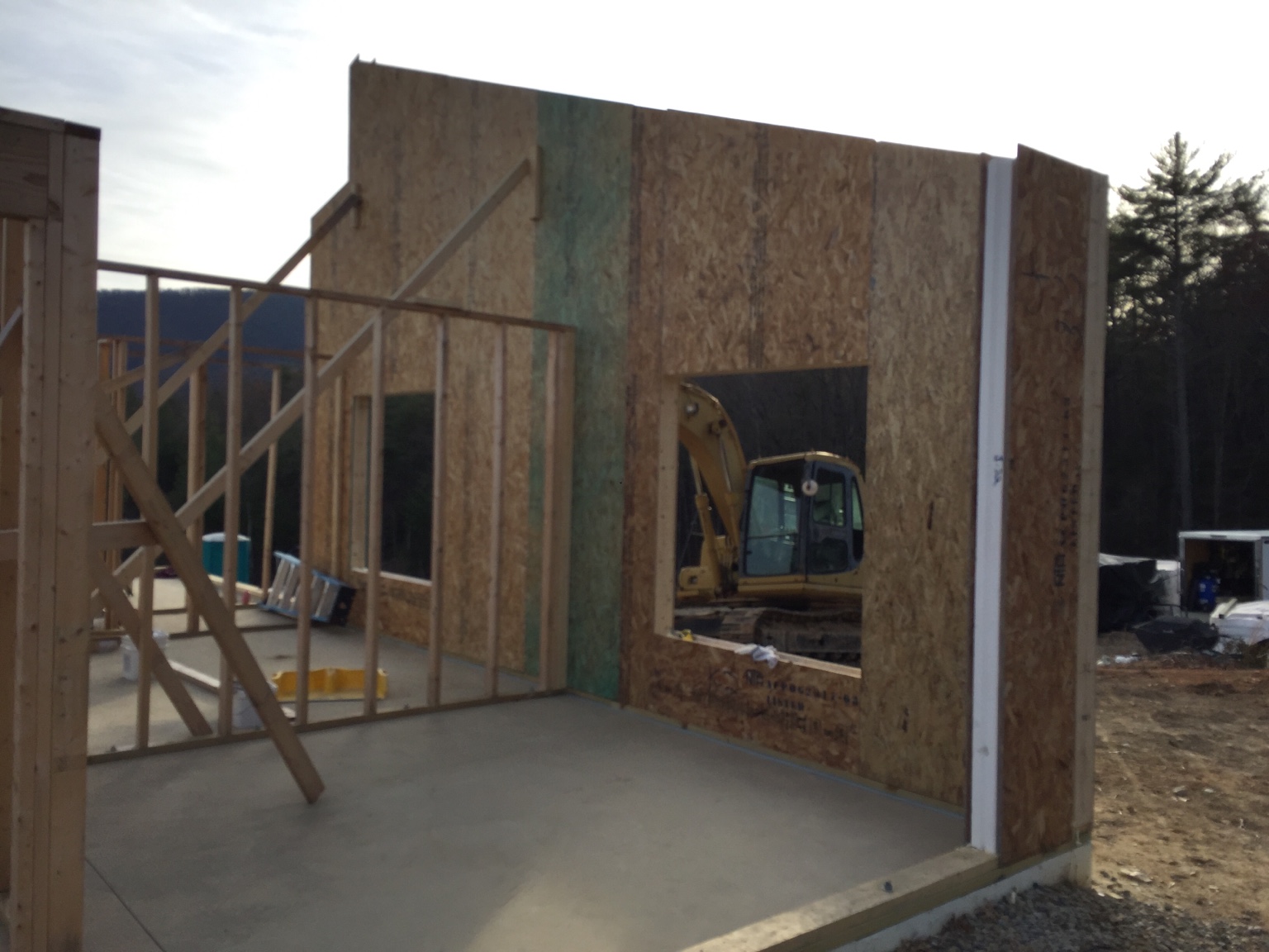

I apologize. I am a good week behind on videos. Editing is very time consuming. This weekend we began the panels. It was my wife, my son in law and myself. We used the excavator to lift panels into place. The learning curve is steep. We got 10 panels up in 2 days. I am off today but it is raining and I have to see a dentist about a tooth with an old root canal that isn’t doing well.
Here is the small wall we put up.

Hey You have enough going on that you don't need to worry about keeping me happy. Take your time, do a good job and worry about the editing later.
Thanks for the pictures though!
