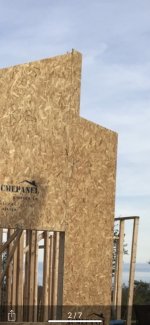

Also, if you look close, you can see that they made a mistake with the last panel that I put up. They cut both in the same direction And the should be in opposite directions. The roof slope should have continued all the way to the top. It is fixable but annoying.

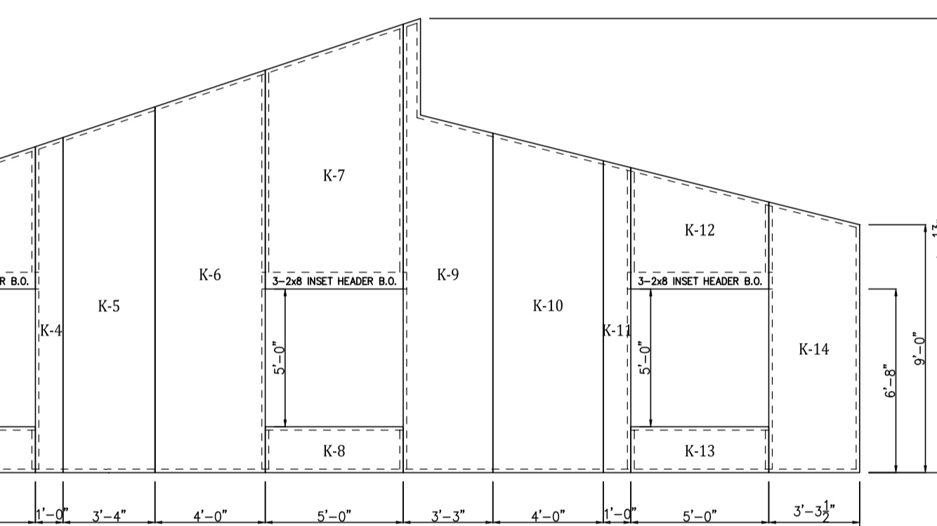

Just to give a little teaser on the house design. This is one of the sketch pictures from over a year ago....some changes have been made. There will be no garage underneath. And my wife said no way on the color.
Is the wall like that due to the original design?

No, the roof line has stayed the same thruout the entire process.
Then I don’t understand the mistake.

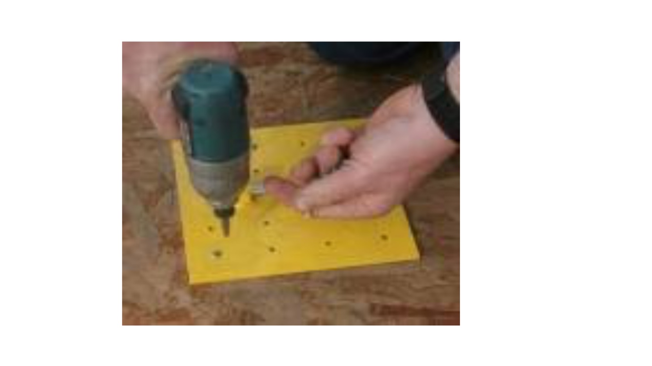

How do you fasten to the panel to lift them?

Im not sure how they managed to make that mistake. I imagine it is a CNC type system so someone probably typed in a value wrong.
Here is a picture from an older set of plans.
And you use lifting plates that you screw to the panel
