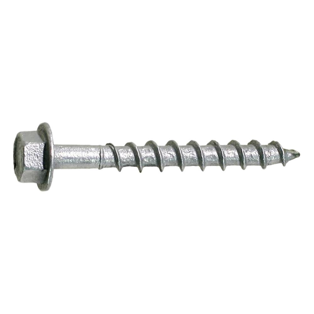

There are structural screws made specifically for hangers. Much easier to install than nails in some cases, but more expensive.
   / My Industrial Cabin Build #713
I believe that only nails have the 都hear strength for joist hangars.
Simpson has some screws that are acceptable for many types of hangers. But it needs to be confirmed -- I hear some building inspectors will not accept them even though the tech data is valid.

Not a great picture but here are some code-friendly Simpson screws I use interchangeably with nails in Simpson hangers (again, confirm with local building inspector first):
Screws to be careful about are the generic "deck" or "construction" screws, the ones you see with a star drive and green or tan paint. They are great screws and I use them a lot, but they will not pass for nails in most all cases. In some cases (pullout load) they are superior to nails, and I used them on roof purlins of a pole barn several times. For shear load they are OK but not rated like a framing nail. So be careful with those in any application where they are used.
I am in love with the new breed of structural lag screws like these GRK screws Lowes sells:
Many of these are rated for structural use and so much nicer than traditional lag bolts.

I use the Simpson screws for hangers. The biggest advantage is how easy they are to install, and even easier to take out and adjust if you have to. If you don't have a lot of experience installing joist hangers, I've found that it's easiest to install the joist first with the nail gun. Just toe nail it into place with one or two nails so it doesn't go anywhere. Get all the joists installed this way and make sure they are where they are supposed to be. Then go back and install the hangers. This is faster and you get better results.

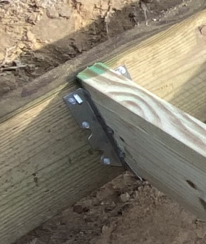

I also put hangers on later if I can. On my build that was a rainy day project.
And I built temp scaffolding on my build project, here’s a look ahead.
