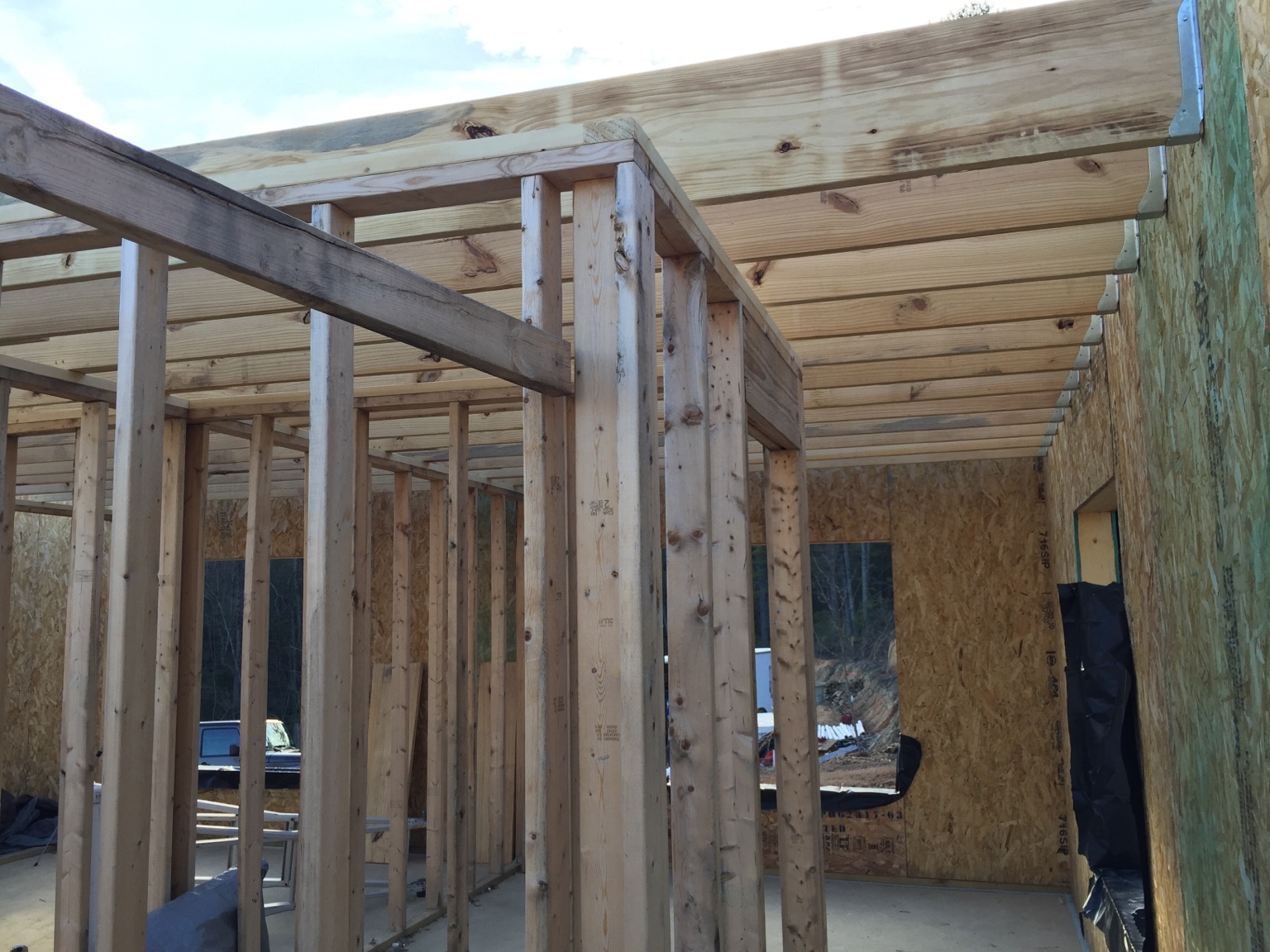

I was up last night reading code and å*µreen building best practices as I get ready to set my joist hangers. I have to make a tun to the hardware store now, because my supply of screws does not meet the specs for the joist hangers.
I borrowed a pneumatic nailer for the joist hangars and hurricane/uplift straps on my build. I think it was a Grip-Rite GR150. I purchased them a box of nails in return, money well spent, you will need ear protection as it is loud.

Thais is a perfect example of why I like TBN so much. Great information. I had already tracked down the simpson strong tie fasteners. I had to drive over the pass and into the valley to get them at home depot, because Lowes website said they didn’t have them in stock in Charlottesville. I already have a large box of 3/8x8 inch GRK screws that are being used to tie the posts into the panes that will set next to them. So I knew the GRK would probably do bit since the Simpsons are made for the hangers, that was the best solution
I had already ordered the heavy duty over the wall style hangers because these are being attached to the top of a panel. They attach to a 2x6 spline that is set into the top of the panel. This is a common application for SIPs houses, so I’m not breaking new ground here.

I bought the 1 1/2 inch screws, the linger screws, and simpson brand 16d nails, as well as some griprite brand “joist hanger” nails.
I like the long screws for the top side (face)entry thru osb into the 2x6 spline. I like the nails for the top entry downward thru the spline and I like the 1 1/2 inch screws for the lower face entry that attaches to the osb. I will try to take a picture today to illustrate what I am talking about.

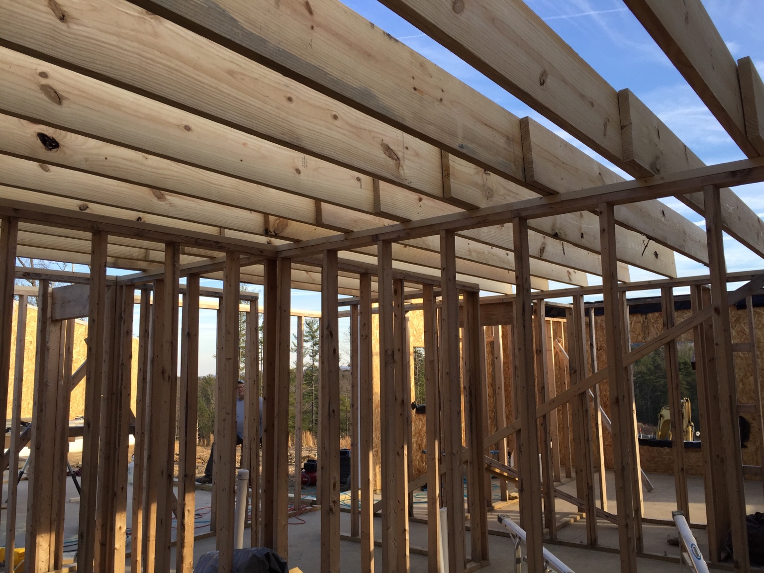

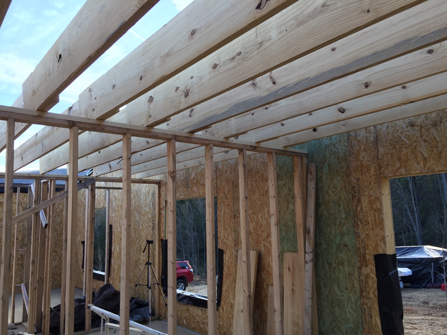

It was a pretty good weekend. My buddy George came up today and gave me a hand with the joists. We got a lot done. I still need to put in blocks but I toe nailed in the boards as well as joining them for overlap.

I was expecting a sloped ceiling over all of it. Are those 8 foot walls for all of your rooms?
