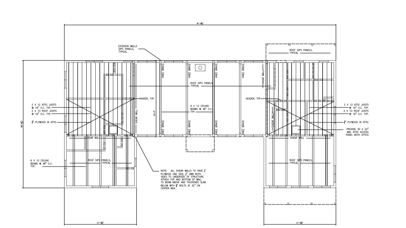

I was expecting a sloped ceiling over all of it. Are those 8 foot walls for all of your rooms?
Eddie, on the framed in areas there is 8 foot ceilings with a small storage area over them. My wife wanted an area to store Christmas stuff, etc. it will be conditioned space( heated and cooled). in the two front bedrooms, the ceilings slope , with 6x12 timbers. Supporting the roof panels.
