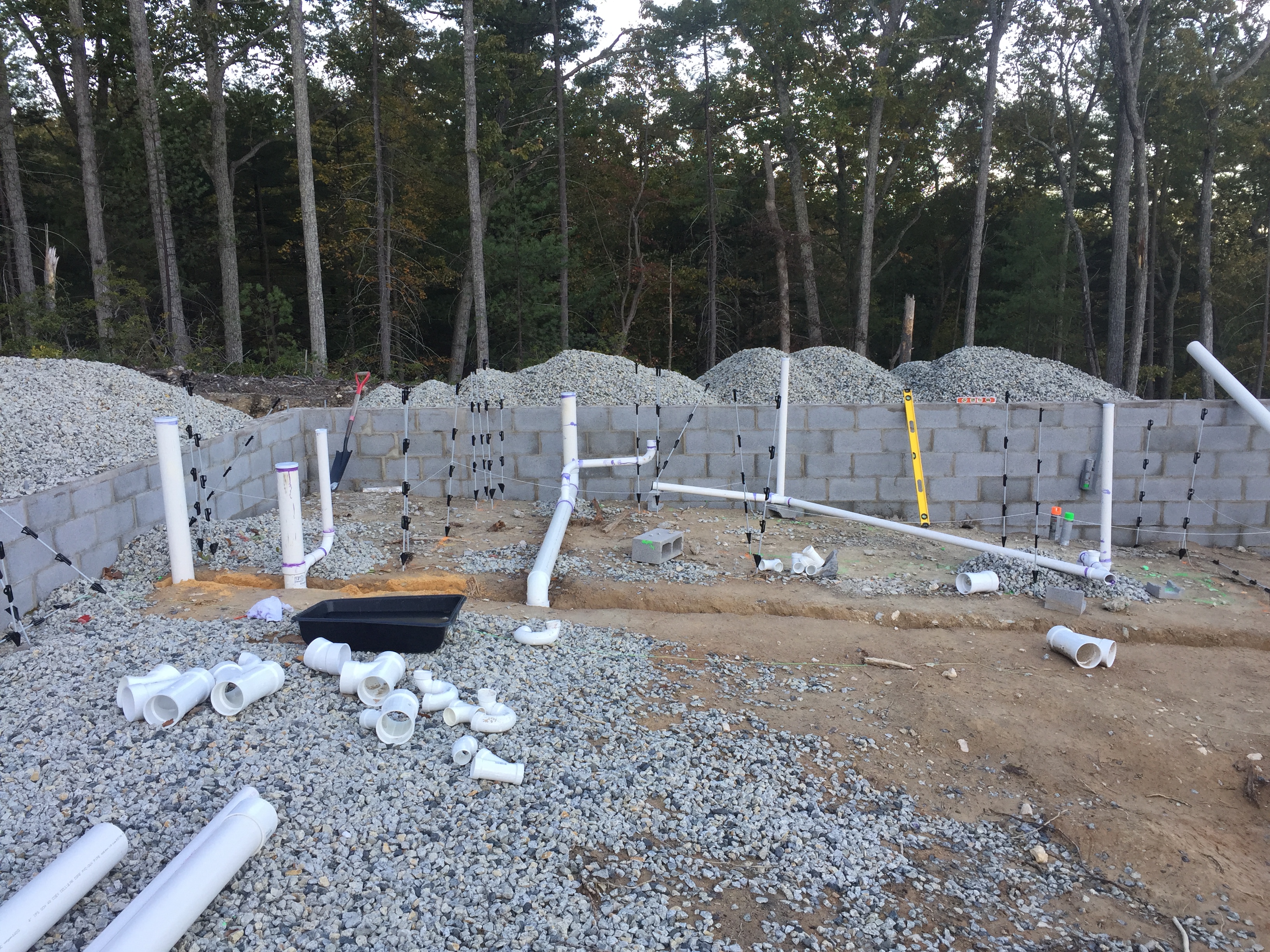

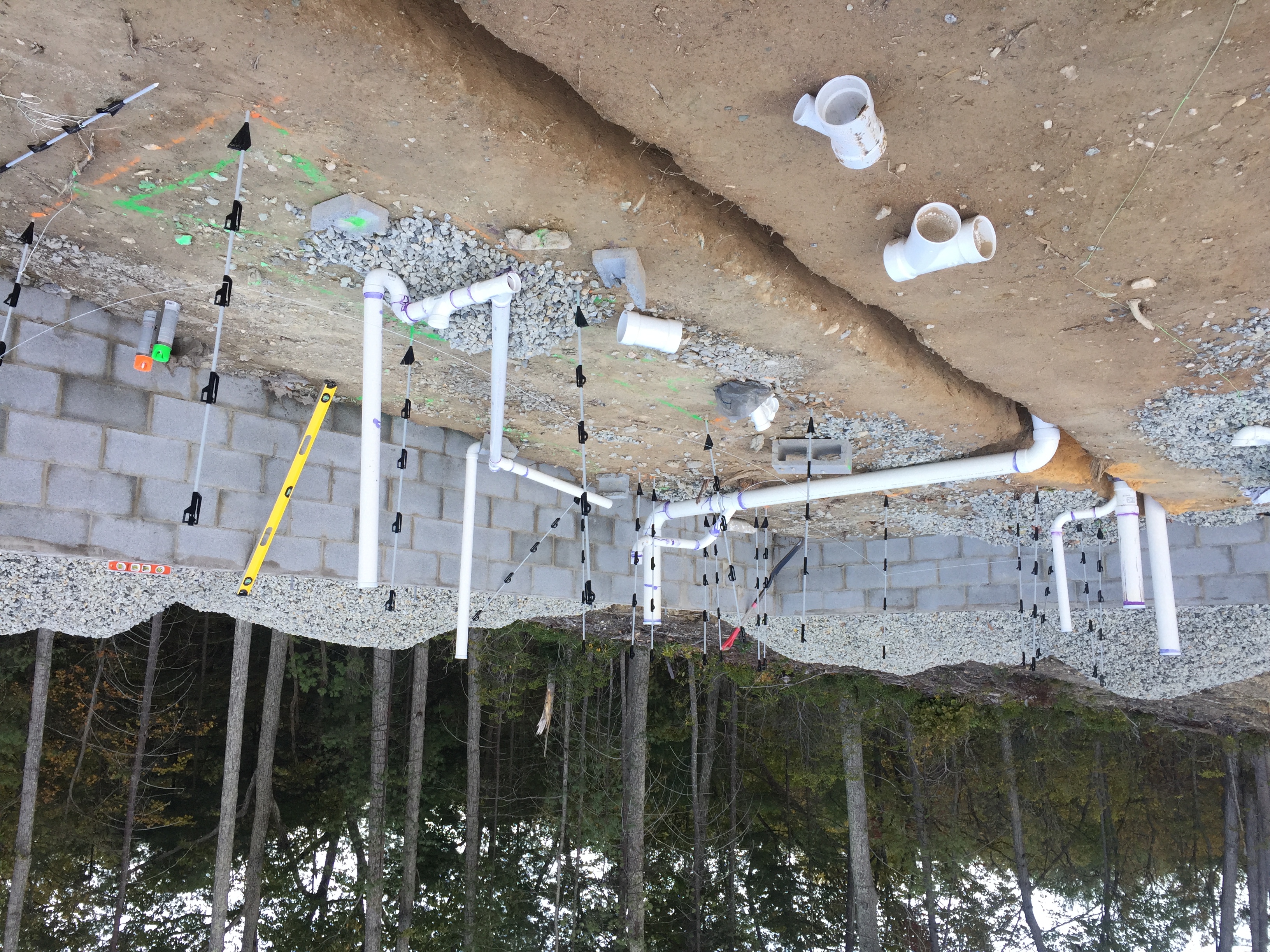

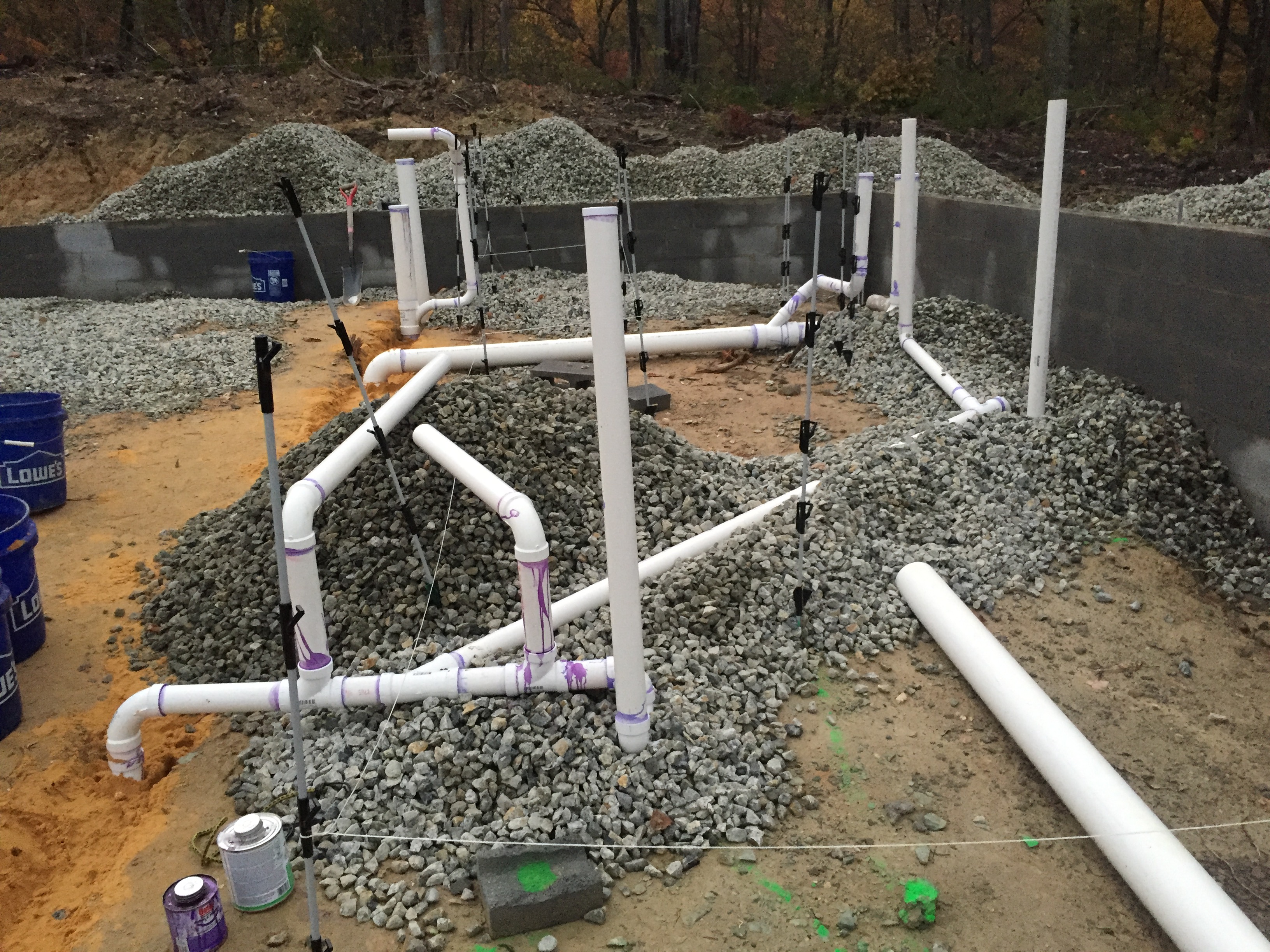

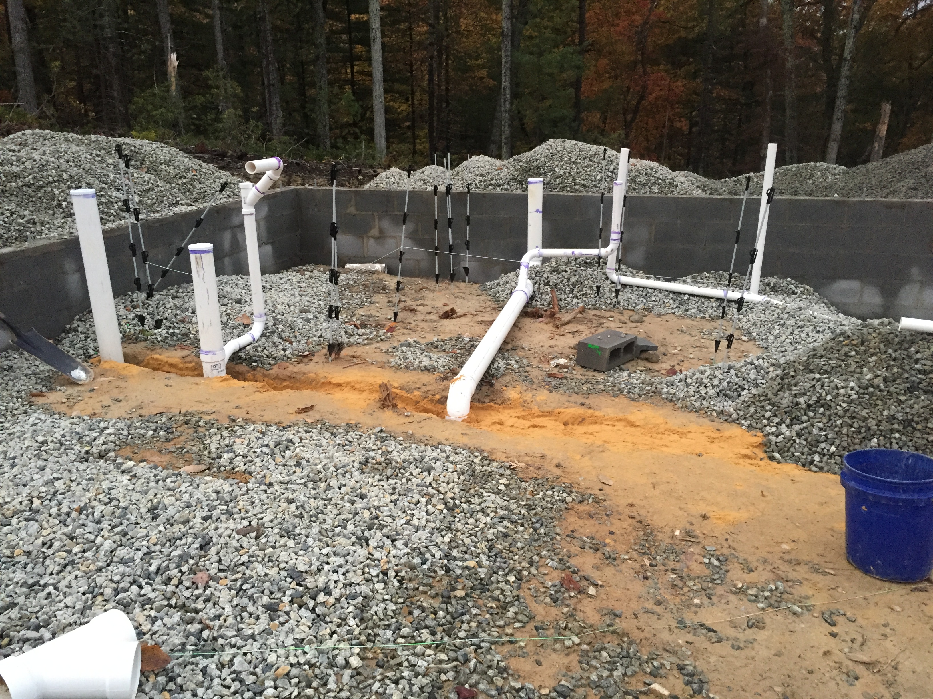

I took a couple days off and worked on the plumbing. I am not fast. We had a pretty big storm Sunday so all of Sunday was a loss, due to rain. IMG_7849.JPG
   / My Industrial Cabin Build #74
Is that 4 inch? Is that code there?
Nice seeing the purple primer, you'll never have to worry about it ever coming apart.
Drain lines are like art, there is just something about it that makes me happy when I see it.

I could use 3 inch but I opted to put in 4 inch for the waste lines from all three toilets, out. All the rest is 2 inch. I used the cleaner and primer and heavy duty cement. Hoping to never have to think about it again.

I'm taking my time and trying to prep each piece as best I possibly can. Like most things associated with the house it's all in the prep work. Digging the main trench to the right pitch and fitting the pipe pieces properly.
Because I knew I was going to lose a day to rain, I worked with a headlamp till 11 Saturday night. If the rain holds off this coming weekend I might finish.

I'm sure it will be fine, but the one step blue glue usually gives a stronger bond. I've never fixed a one step joint, but have repaired lots of two step joints done by others over the years. Basically the timing between applying the primer and the glue is critical and lots of people don't pay attention to it.
#79
I have never seen the blue, unless you are talking about the wet/dry medium strength cement. I have never used it. While I have been doing home repairs as well as some extensive remodel/flip jobs for years using the purple primer and cement, I went to the Otey website and watched some videos that they have there. They said to apply the cement while the primer is still wet, so that is what I have been doing. There are always multiple options when doing something like this and sometimes the hardest thing to do is pick a horse and ride it.
