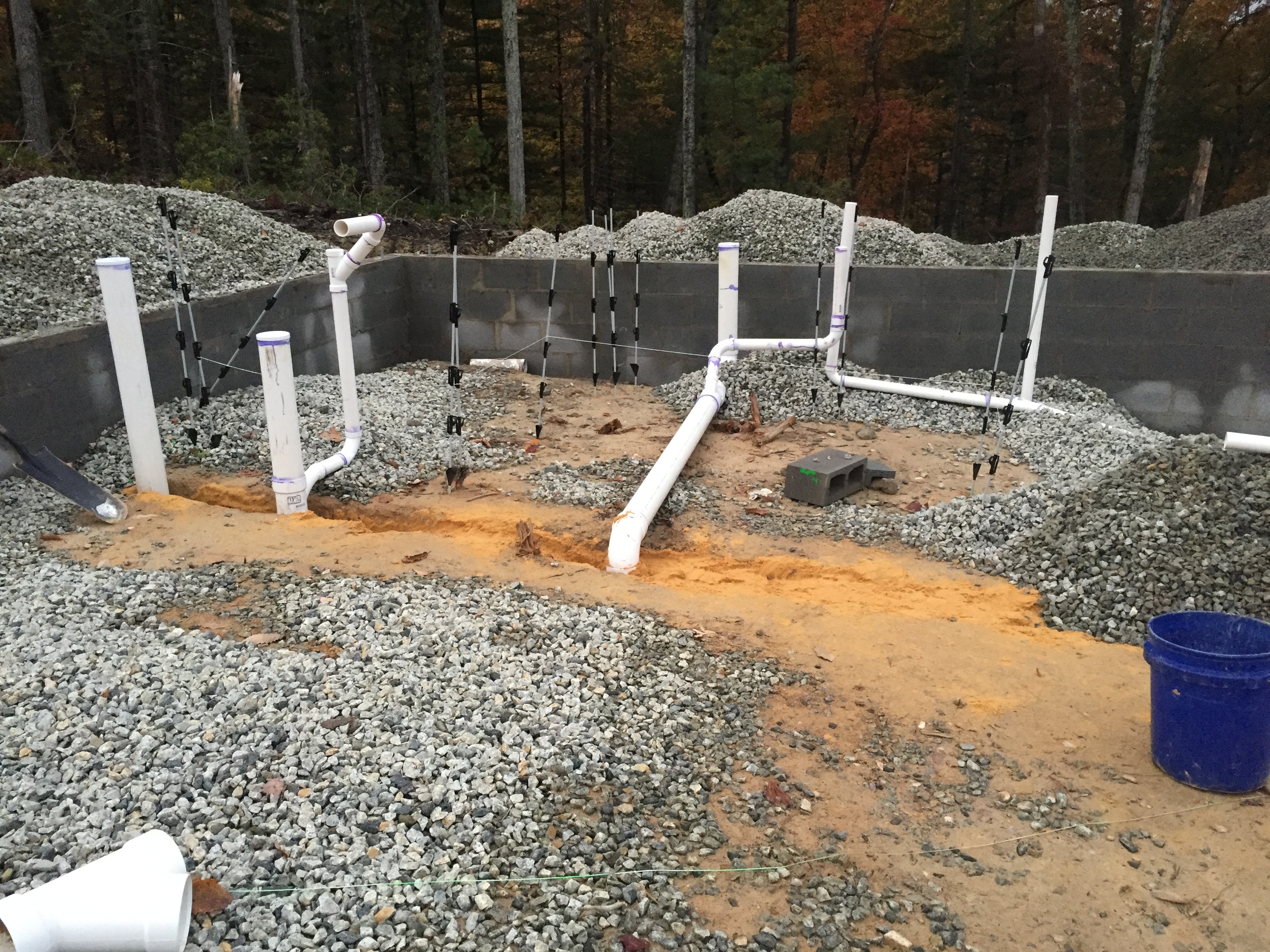

Is that a clean out coming off of your toilet vent line? I'm a huge fan of putting in as many as I can, but I never thought of putting one in behind the toilet. Are you doing your own framing too?
The pipe on the left is toilet. The second one is a cleanout with a wet vent coming out behind it that will handle drain for the sink that will sit over the cleanout and the vent pipe that comes straight down to it. Yes we are doing our own framing. My sone-in-law is a carpenter with many years of framing experience , so he will be helping us.

Wait, what am I seeing here? Are you going to fill that entire foundation with 57a? Like, 3 feet deep worth? Why.... did you make the main 4" drain lines so low? Or the floor height so high? I'm confused as heck. Nice progress though! Keep rockin! Lucky to have such a good helper. My wife didn't want to get her boots dirty when we built our place....
edit: oh, crawl space? I was assuming slab floor. nevermind. duh, haha

This is slab. I'm building in a hill about an 8-10% grade. The hill behind me is uneven. Slope increases from front left corner of house to rear right corner(SE to NW). I was already down 5 feet behind the house in the middle and quite frankly, I didn't dig as flat as I thought I had so when they came in to dig the footers they used a laser and I was off east to west. By a foot or so. I was using a string level.
It will be 100 tons of fill. The 4 inch pipe is dug in so low because the waste pipe exits the front of the house about 5 feet down. So I dug a trench that gave me a straight shot to the exit at 1/8 to 1/4 tick.
