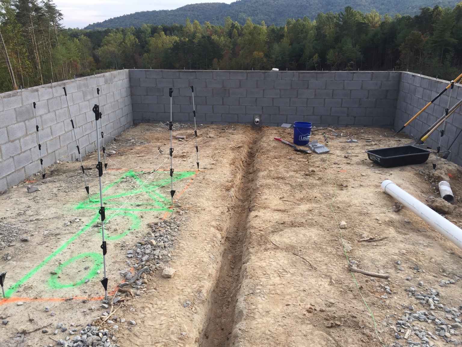

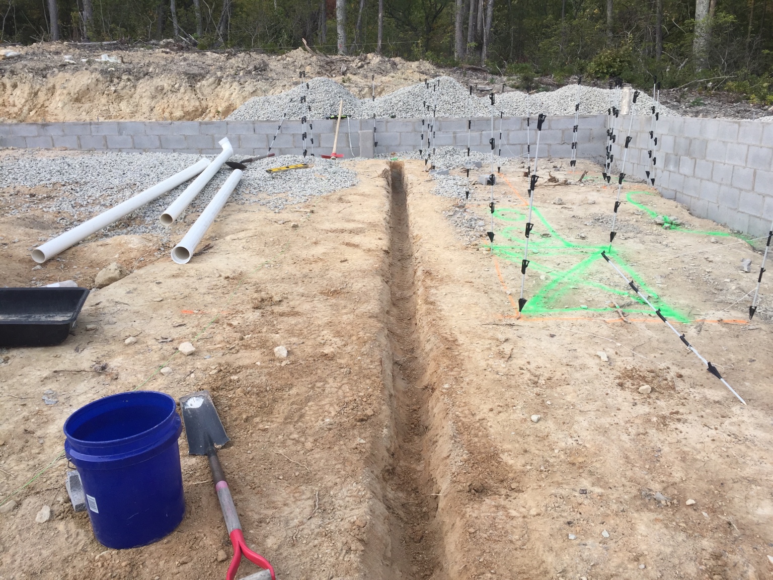

Today was digging the trench for the 4 inch pipe for the main waste line on the master bedroom side of the house. 36 feet long 16 inches deep at the upper side . Only a couple inches deep on the exit side( the ground slopes downward...this is a mountain). Lots of rock. Hand tools come to a quick halt against a 4 or 5 inch piece of quartz. My wife shoveled up the dirt and dumped it out of the foundation, away from the block and kept the area clean. I went slow and careful because I wanted to obtain and maintain 1/8 inch drop per foot. Tomorrow we will be dry fitting the pipe in with al the additional connections needed for the second toilet , shower, sink, bath, kitchen sink and boiler room drain. Those are all joining from above and do not require excavation. I am hoping the 104 tons of #57 I had delivered last week will be enough to fill the foundation.

It was 36 feet not yds. But I still had a double.
Looks like you are moving along nicely. Building on a slope so you don't have to dig as much is cheating. :laughing:
My own house is 88' long and I had to dig the entire length because the septic was on the south end and my mud room bath was on the north end.
Remember to take pictures of all the plumbing as you go, later on it might come in handy.
