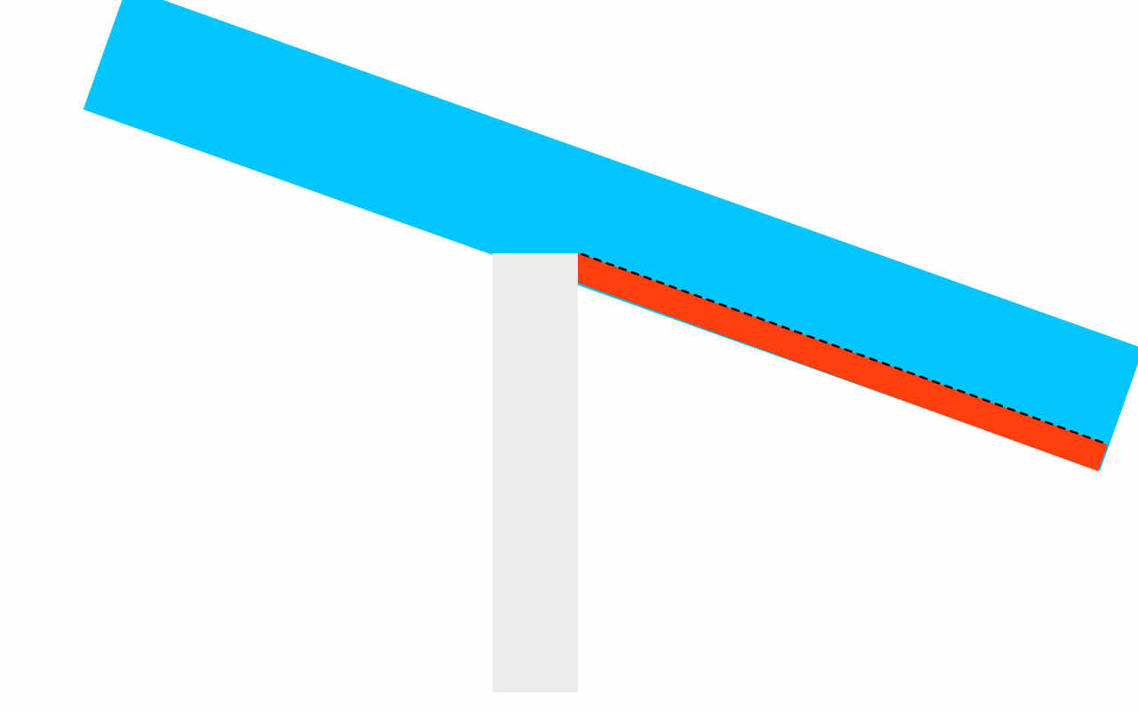

Are you planning to add a ledger or other support beneath the birdsmouth on your lower set of rafters, where they meet that knee wall? Or is the remaining supported grain height enough for that particular span? When you notch a birdsmouth, any grain below the notch is not supported any longer, and this reduces the effective height of the rafter. It's a non-issue for a birdsmouth near a rafter tail, since the unsupported grain is just poking out for soffit/fascia/etc. But when you notch a birdsmouth near the head of a rafter, you need to visualize the unsupported "hanging" grain and make sure it's not a structural issue.
I attached a sketch that will explain it better; the red area is the unsupported hanging grain.
Thank you for that explanation. Yes I am going to put it but I was only putting it, because it is code. I did not know why it was code and that explains it perfectly.

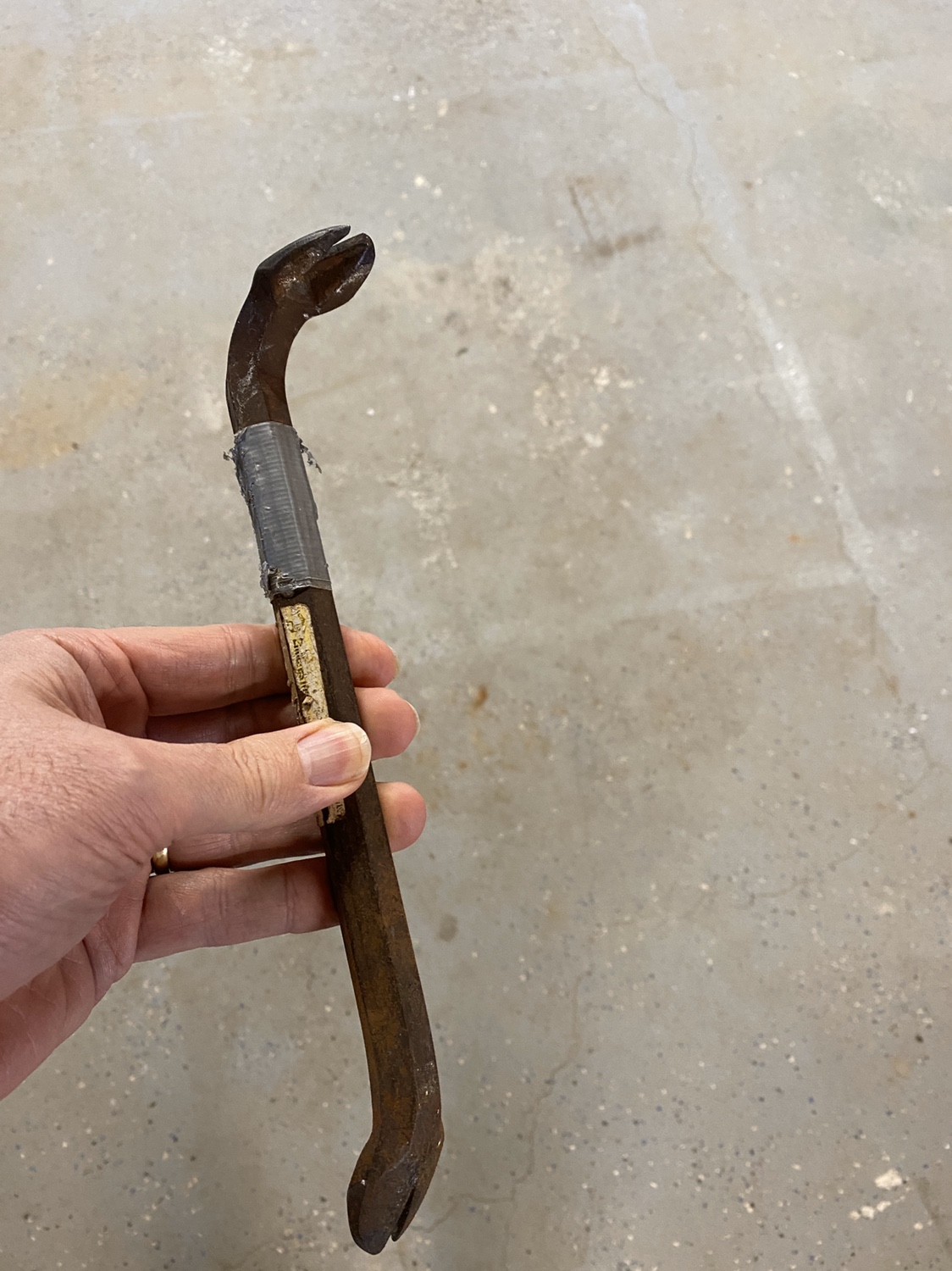

This bar is the best tool for getting under a nail head to pull a nail. Put it next to nail head and drive it under with a hammer, then pull.
The old cat's paw! Great tool to have in your toolbox, and old fashioned too. Very few people know about them nowadays.
