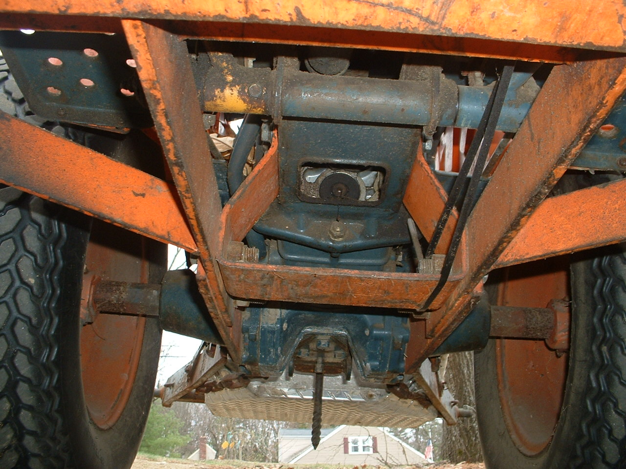

   / my kubota rebuild #53

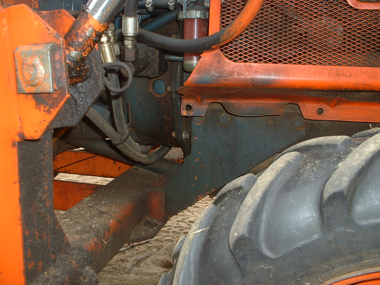

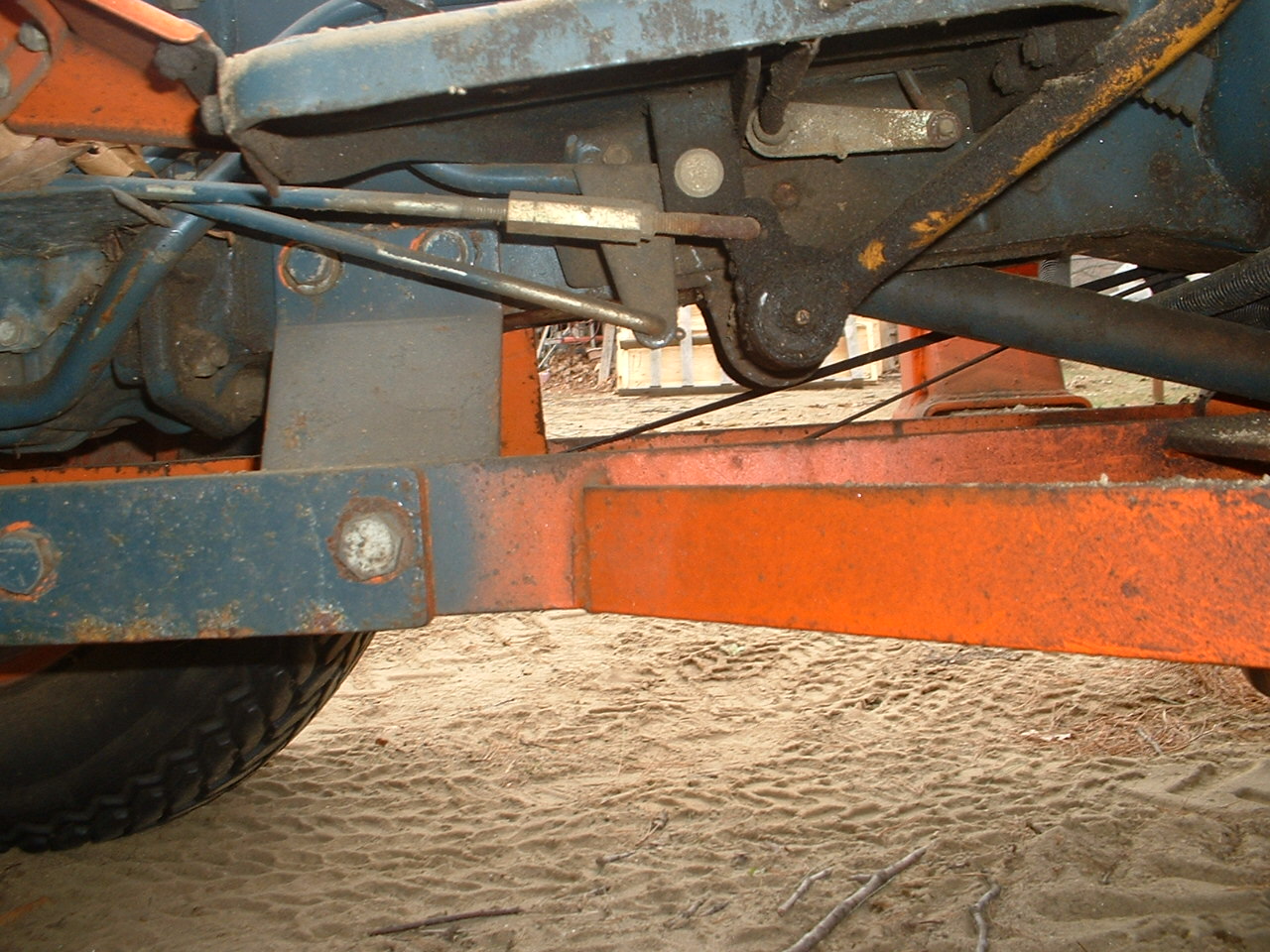

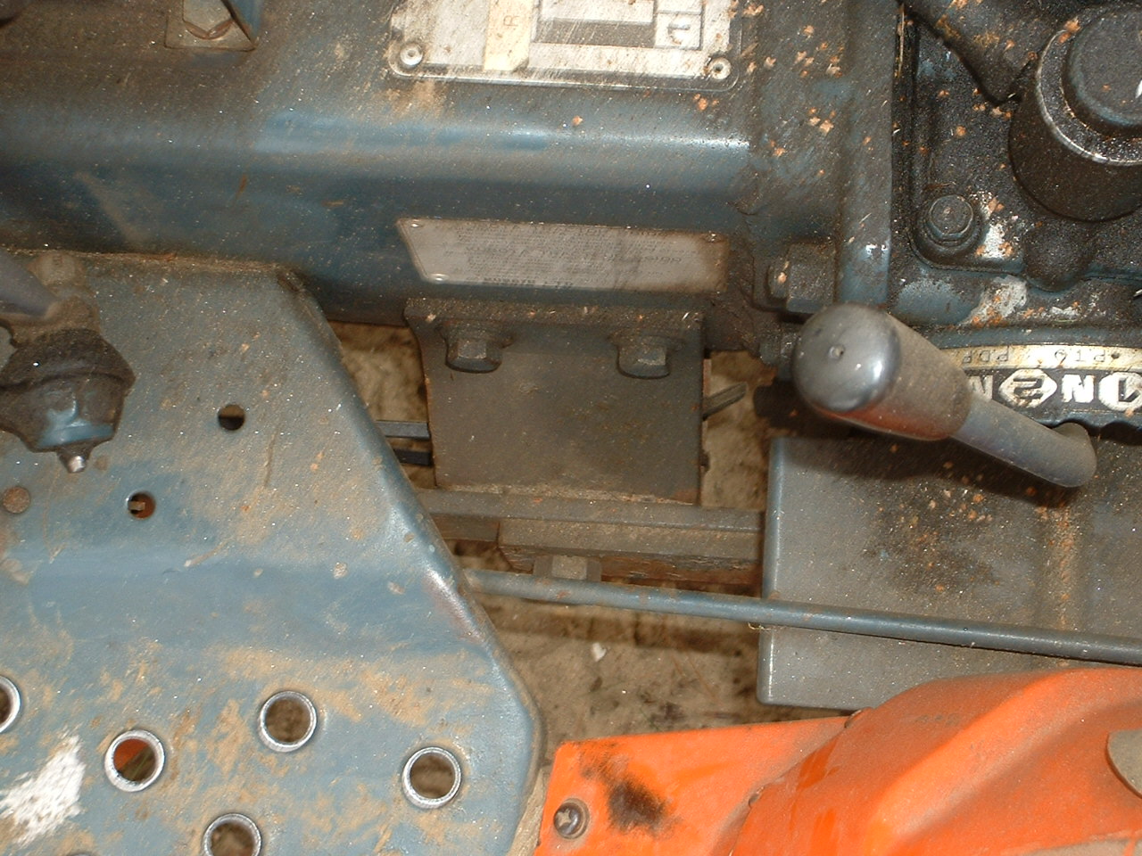

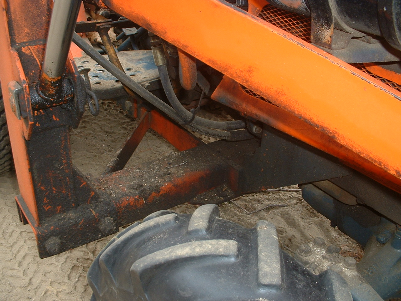

Hey Matt, how's things progressing? I didn't forget about getting subframe pictures. Here they are, hopefully give you some ideas. The bottom one is looking down from the seat area. You can see the horizontal pieces can separate here for ease of removal or splitting the tractor.

   / my kubota rebuild
#54
hey, thx for the pics!
those are going to be a really big help.
I have had other projects get in the way up until now, and am now ready to hit it again.
I will post up here with progress in the next few days
thx again

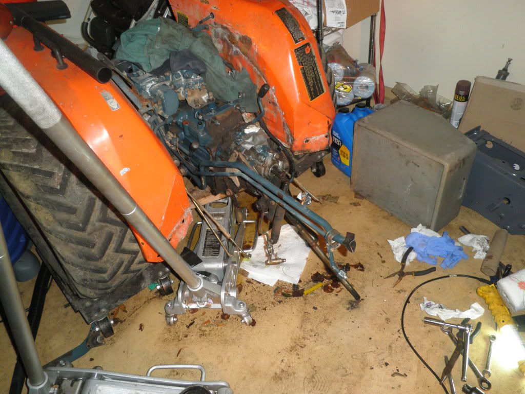

Ok, had a bit of a break from the tractor due to replacing a clutch :laughing: on my wifes DD, along with rear main seal, flywheel, etc....and then making another trip to our 10 acres up in the mountains of western NC...among other things.
so, back at it...
working to get the clutch cover the rest of the way off...it is still attached to the HST here, and I have some more linkages and such to detach...
here is a quick shot of the other side and the new pressure plate/clutch/etc...
more of stuff to take off before pulling clutch cover
here is the cover starting to come off...

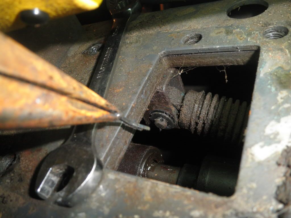

I had the bell housing bolted back up, but immediately noticed that the clutch arm felt a little off after the first press into the pressure plate by hand.
it didn't feel like I was actuating the clutch with the pedal.
everything seemed to move okay, but it didn't feel right.
I took a couple of video's after I re split the bell housing from the engine....
I'm perplexed by the oil seal spring that I found. I don't remember there being an oil seal in there?
I cannot be certain if the orientation of the throwout bearing is correct either.
is there anything else that I'm missing here?

okay, heard from someone on another forum that the throw out bearing was on backwards.
Like I said, I had no good picture of it installed in the factory service manual....if you can believe it.
Also, it doesn't seem to slide over the output shaft when going on the proper way?
that might be why I installed it backwards, as it slide on much more easily that way.
anyways, I pulled the clutch plate/pressure plate just to make certain all was well as it had sat for over a year in florida humidity and I didn't want to get it all back together and find it welded with rust.
