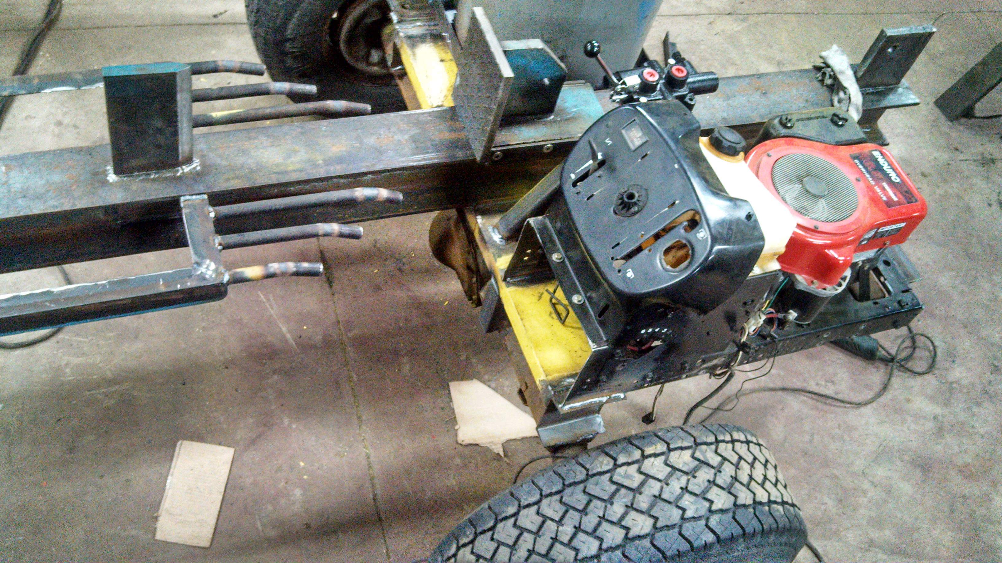

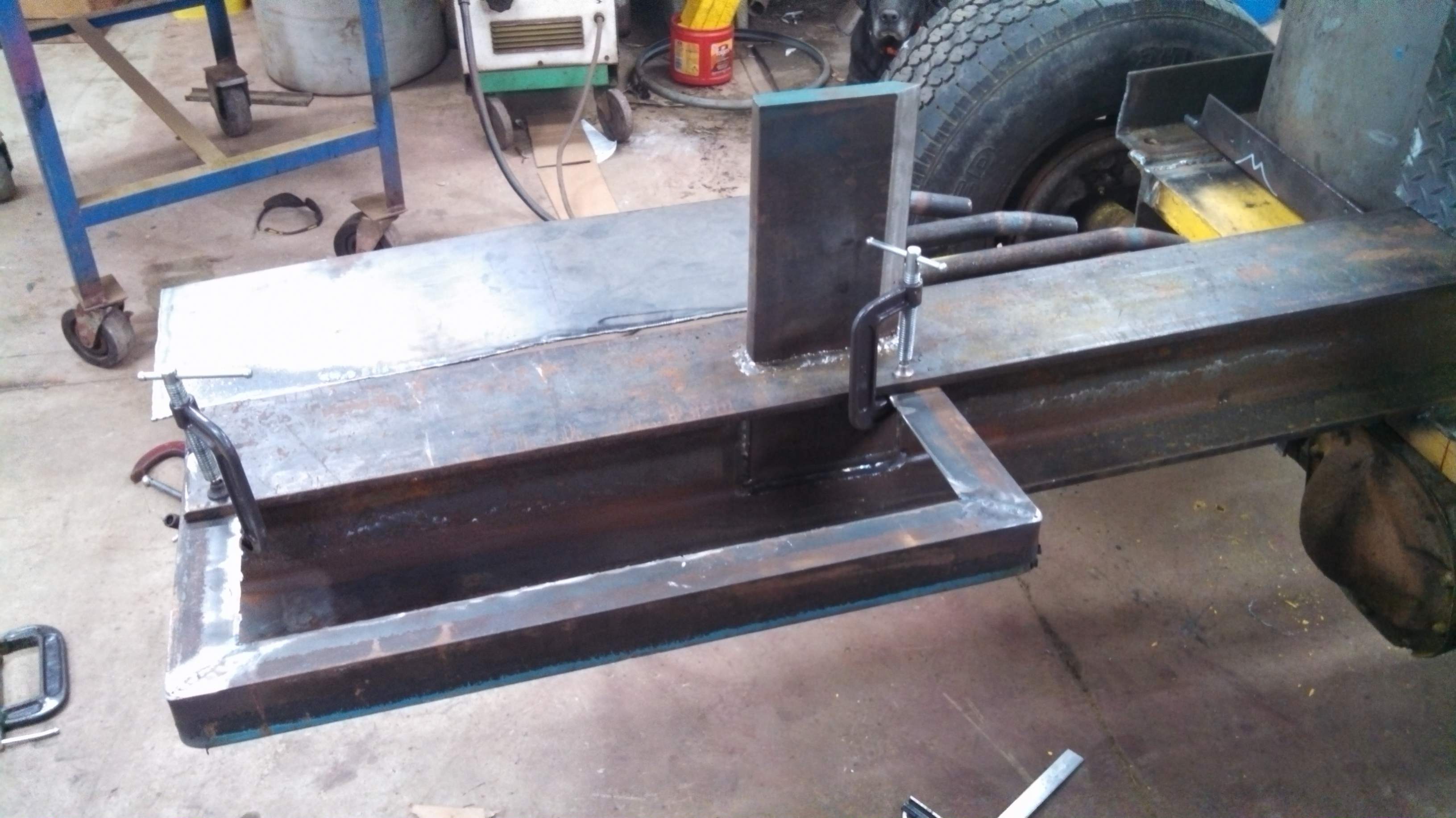

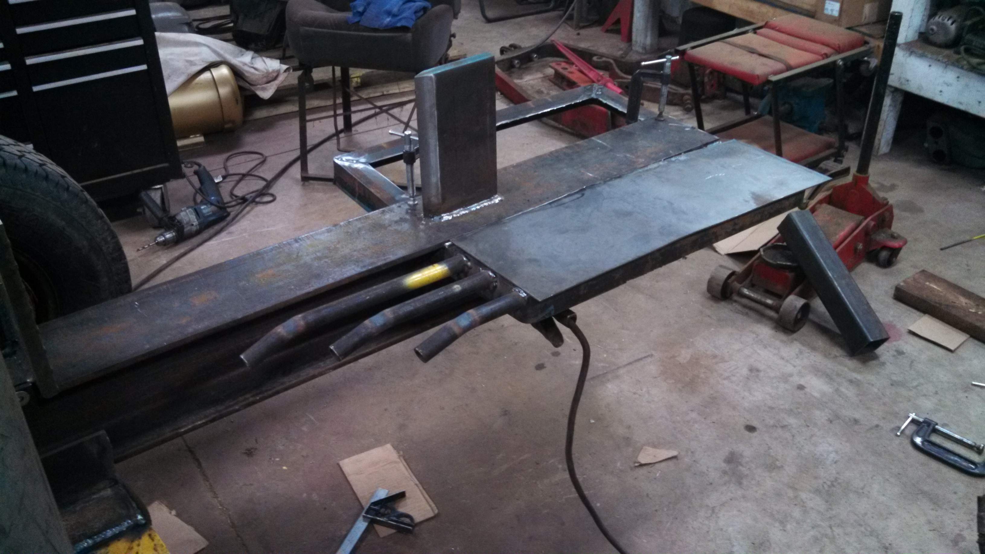

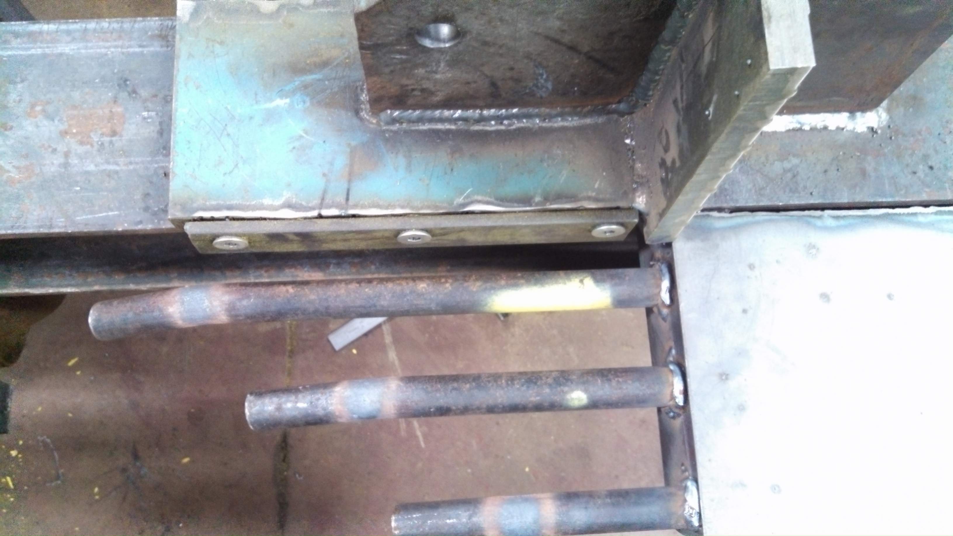

Looks good so far LD. Might consider putting angle iron on the wedge to help split apart the wood a little more. Strengthens it as well. This thing should e pretty quick with the 22 gal pump and 4" cyl. There is a company that provides this set up (Twist Eze?) They call it a "re-splitter" as it splits wood right quick. Return is quite fast for a hydraulic.
/ My LOGSPLITTER Build
#62
All done till hoses arrive. Except finding the key:mur: I ran across it last week cleaning up the shop and I put it up so it wouldnt get lost:laughing: Now I havent got a clue where...:confused2:
IMG_20140324_143156_145.jpgIMG_20140324_143206_329.jpgIMG_20140324_143226_999.jpgIMG_20140324_143239_656.jpg

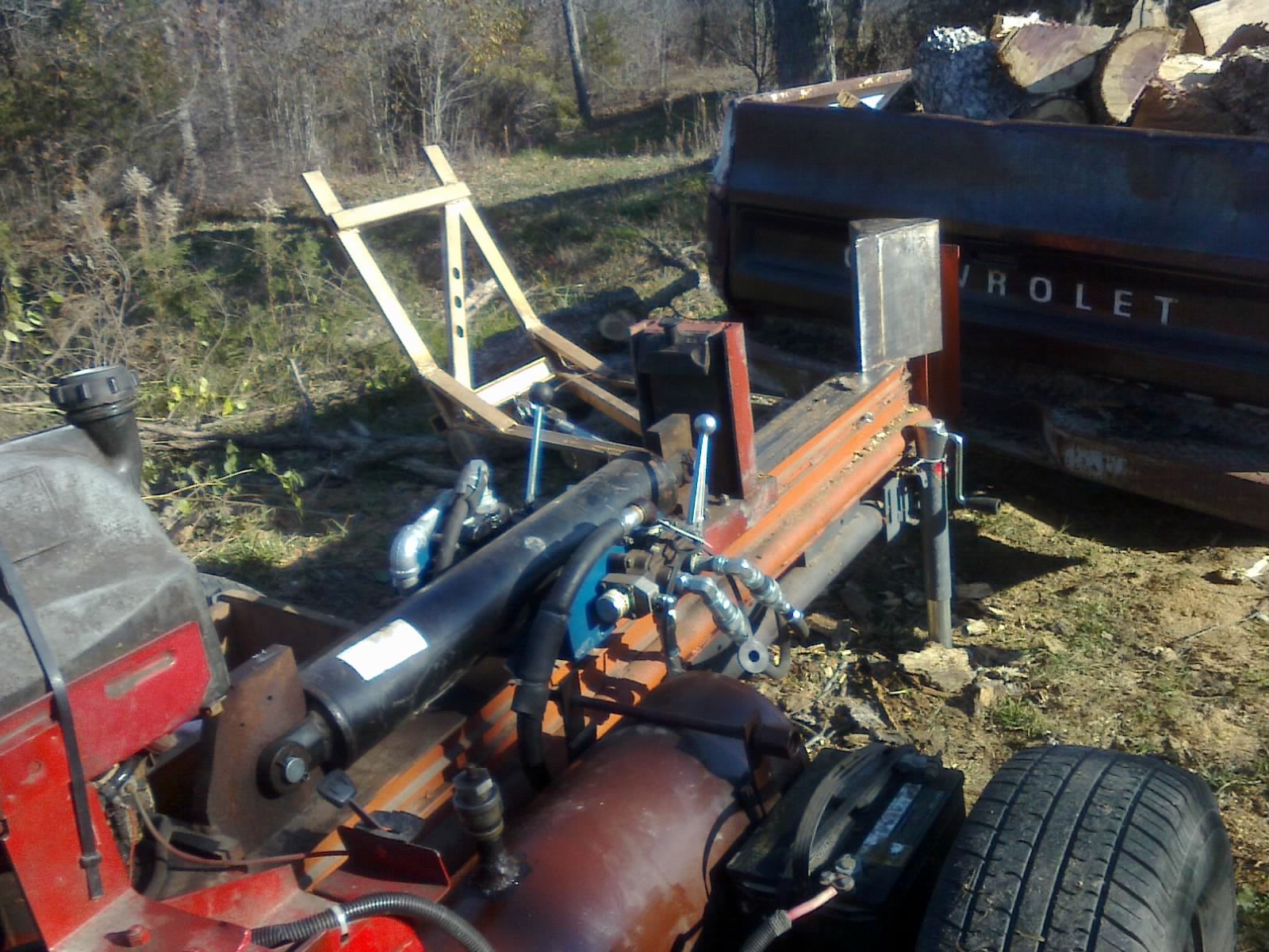

Got the hoses on last night so its officially a splitter now. I will look for the key for awhile again today. Then it may be getting a rewiring job...
IMG_20140324_190229_085.jpgIMG_20140324_190237_004.jpgIMG_20140324_190250_747.jpgIMG_20140324_190302_457.jpg
/ My LOGSPLITTER Build #65
Looks great! Just need some new paint on the wheels and a jack stand! :thumbsup:

All done and everything works. Cycle time is about 4.5 seconds out and 3.5 seconds back. Total of 8 seconds overall. I am happy with that.
I dont think the engine runs 3600 RPM, wish it did. But sounds like it is closer to 3k.
I have a video but I have no way to post it. No youtube account or whatnot. If anyone wants to see a video and has ability to post for me, shoot me a PM with your e-mail address and I can send it to you.
