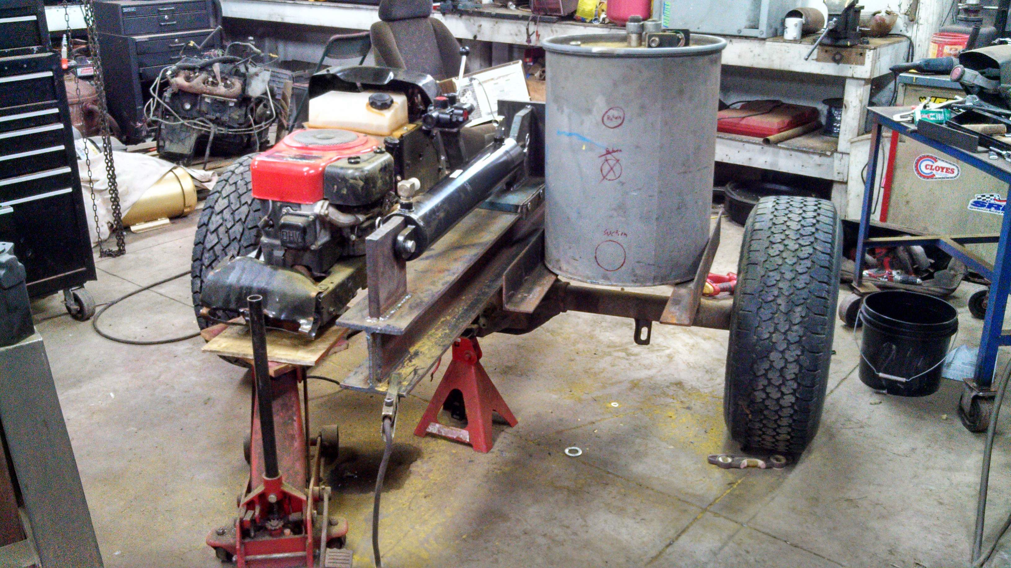

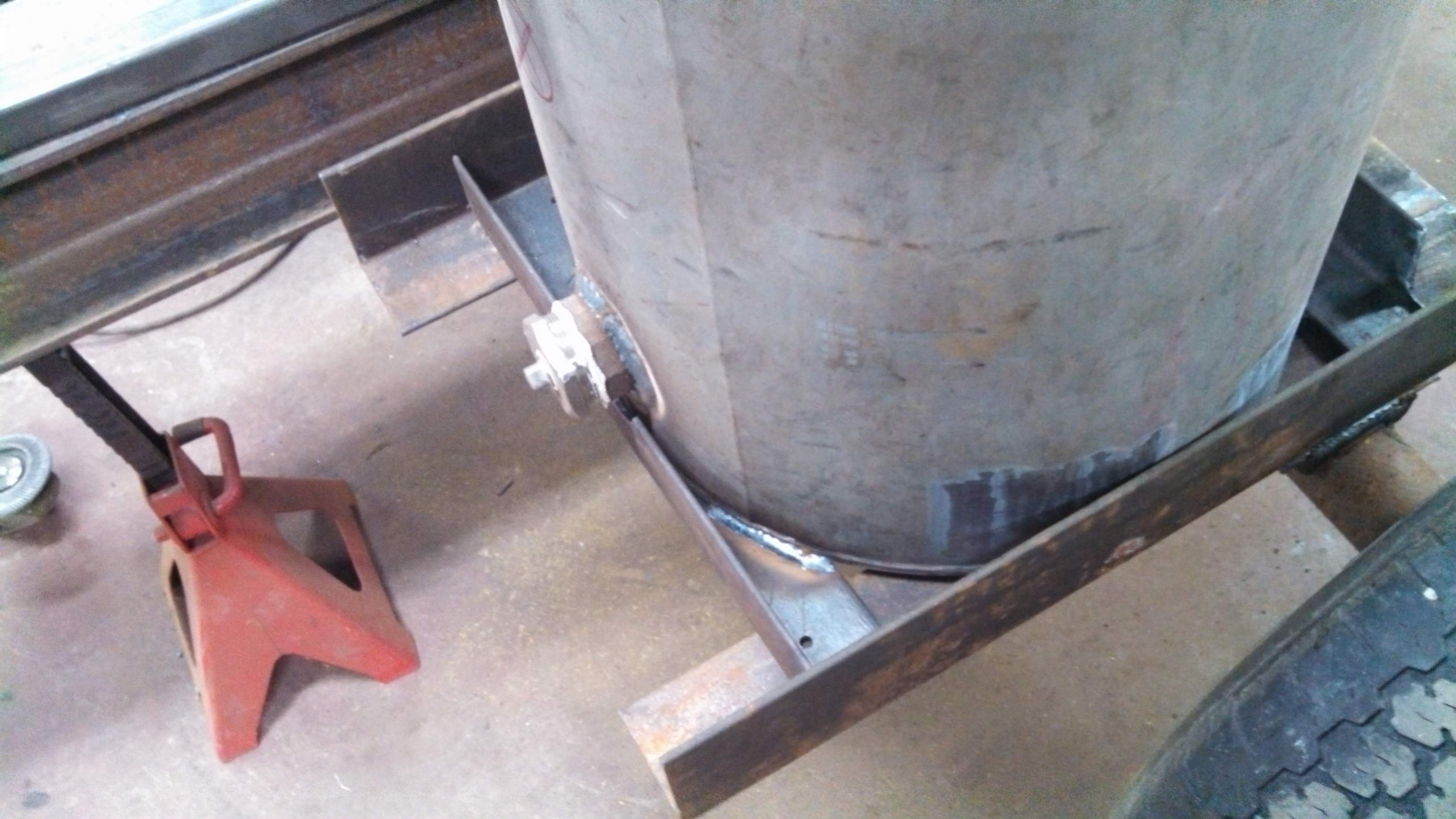

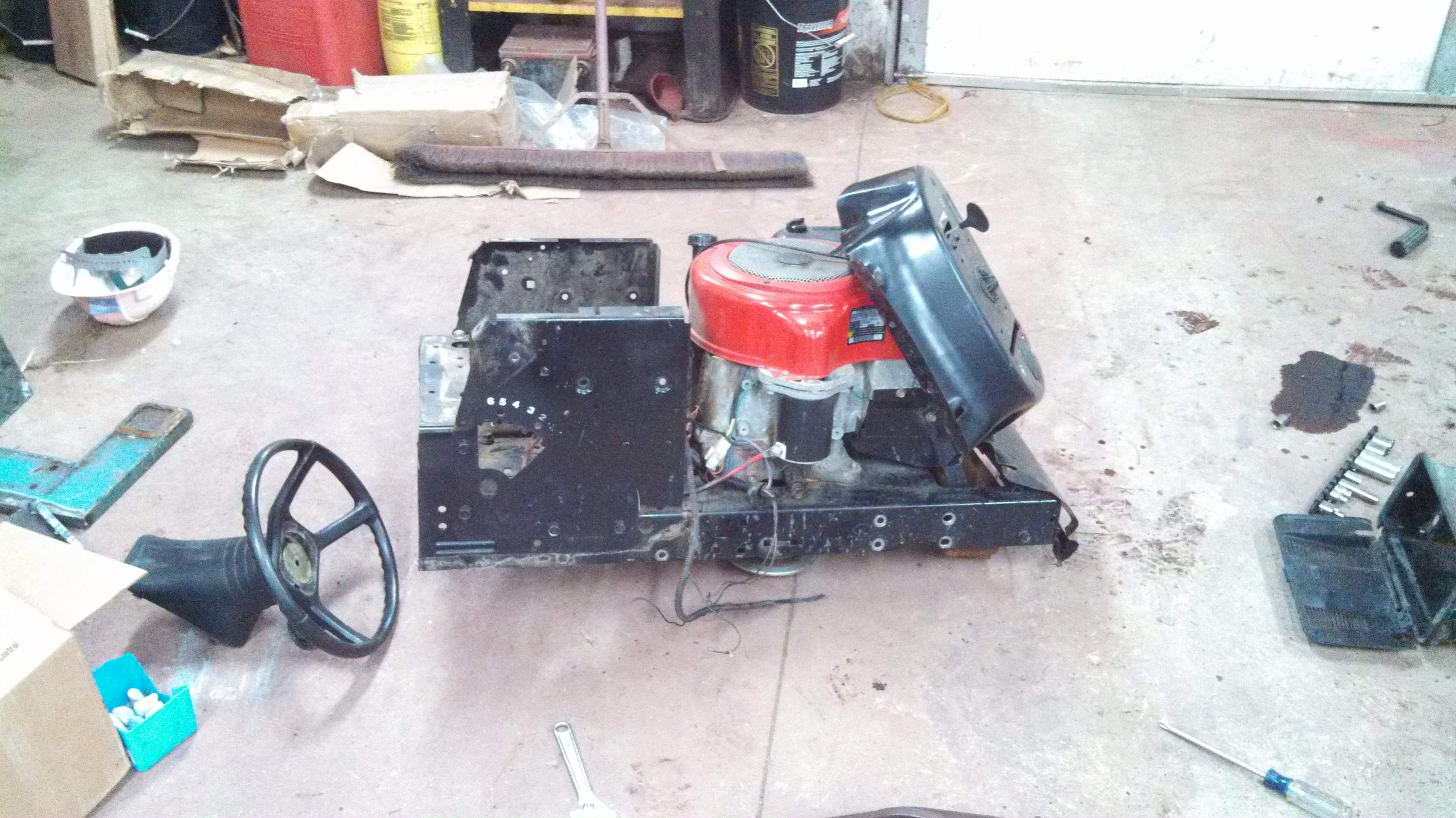

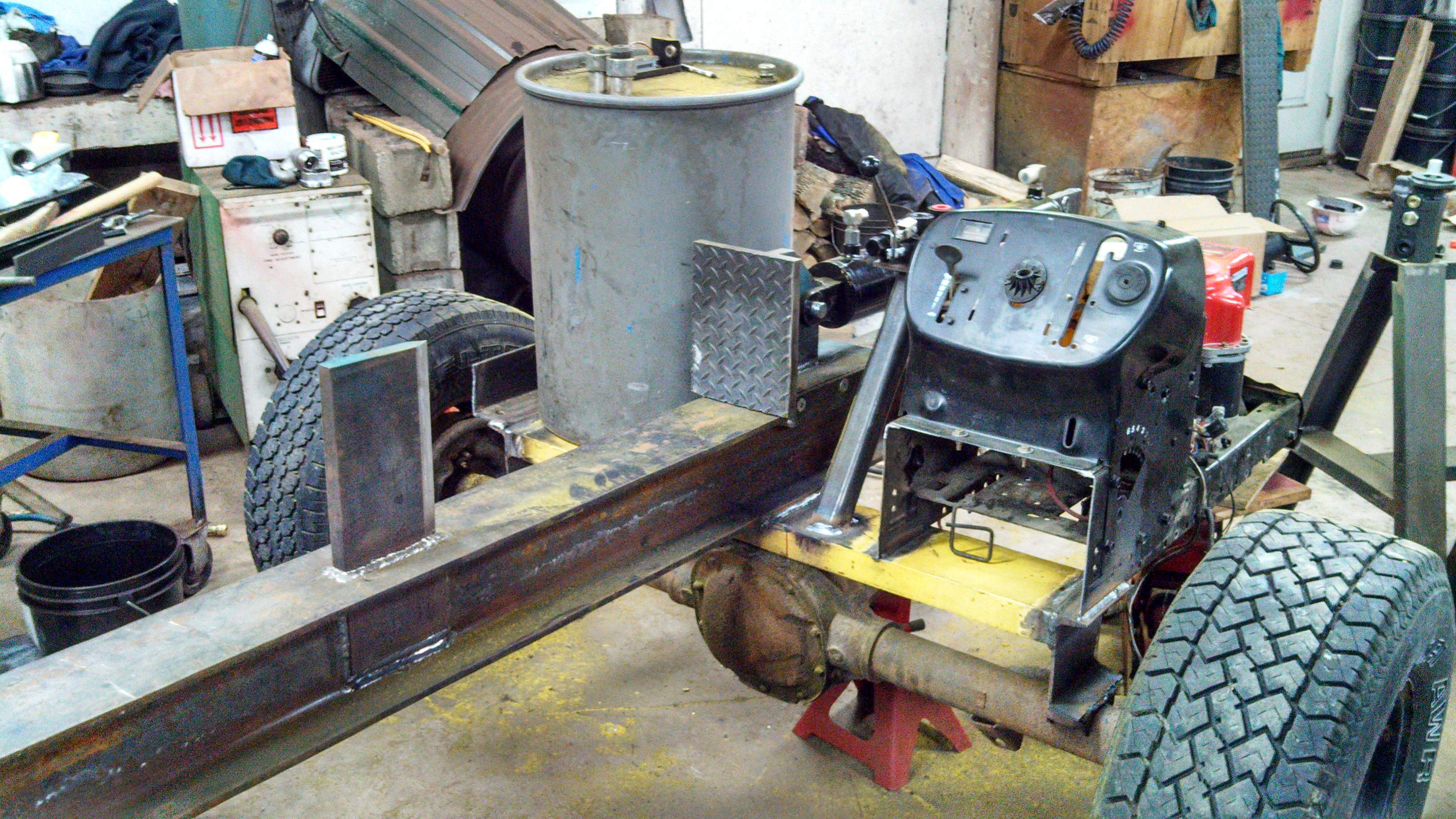

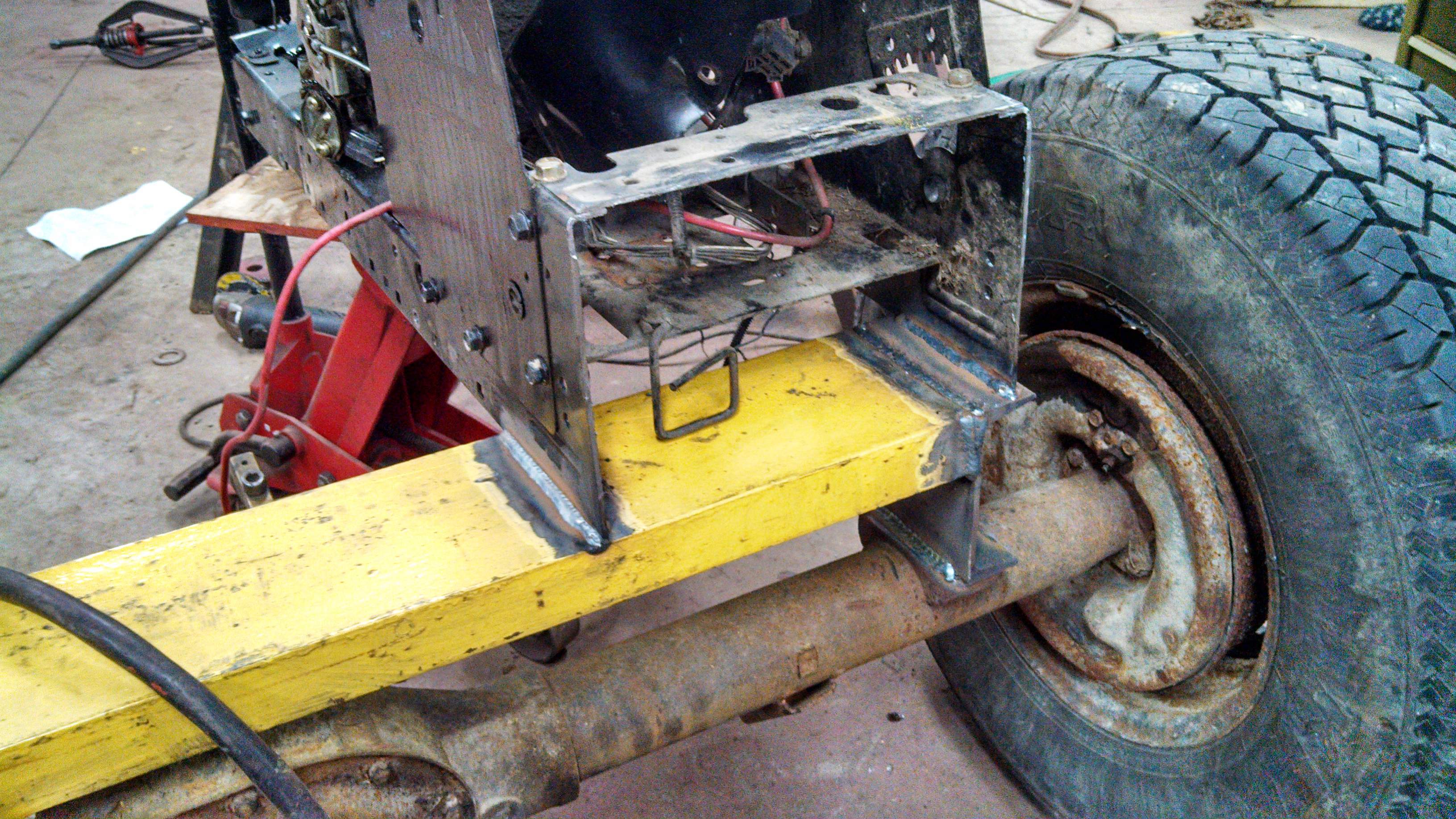

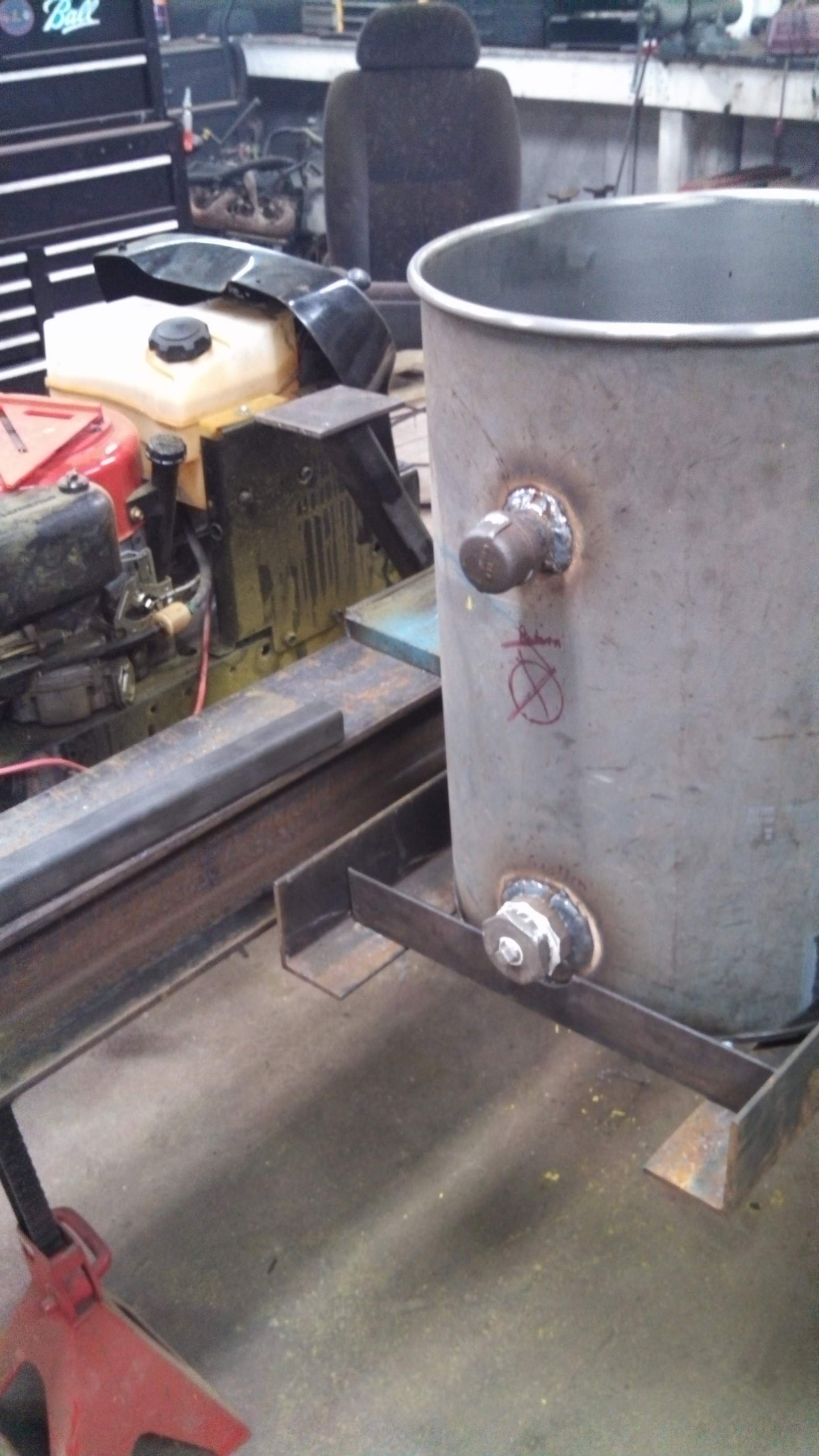

Anyhow, been working so only getting a few hours a day to devote to the splitter. But have gotten a little more done.
Here is the hitch and pump mounting plate.
I have two pieces bolted to the frame that the plate will be welded to. I will bolt the plate on the pump, align the coupling, and weld it to the bolted on pieces on the frame. That way it can be removed easier without taking the coupling loose from the top of the plate up in a tight area.
   / My LOGSPLITTER Build
#50

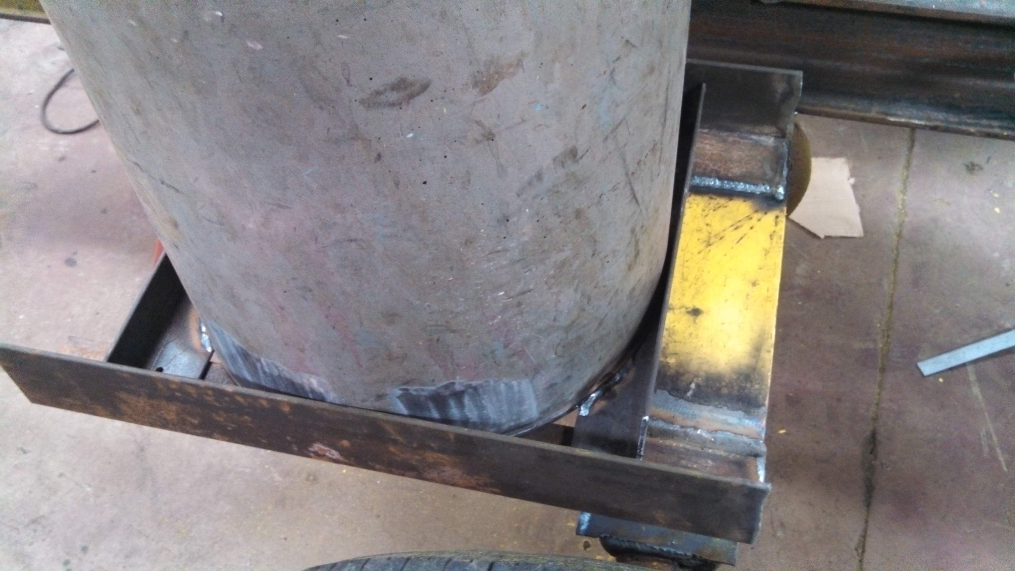

And I also got the tables finished
#51
Hydraulic hoses havent showed up yet. So thats looking like monday. As is the jack.
Other than that, I got maybe an hour left putting the pump plate on, and then I need to remove the brakes from the truck axle. (one is hanging up).
So hopefully when I get home from work in the morning, I can get that done and shoot some primer before I nap. Then when I get up shoot some color. By the time hydraulic hoses and jack get here, paint should be dry and only a hour or so throwing them on and Im ready to split...:thumbsup:

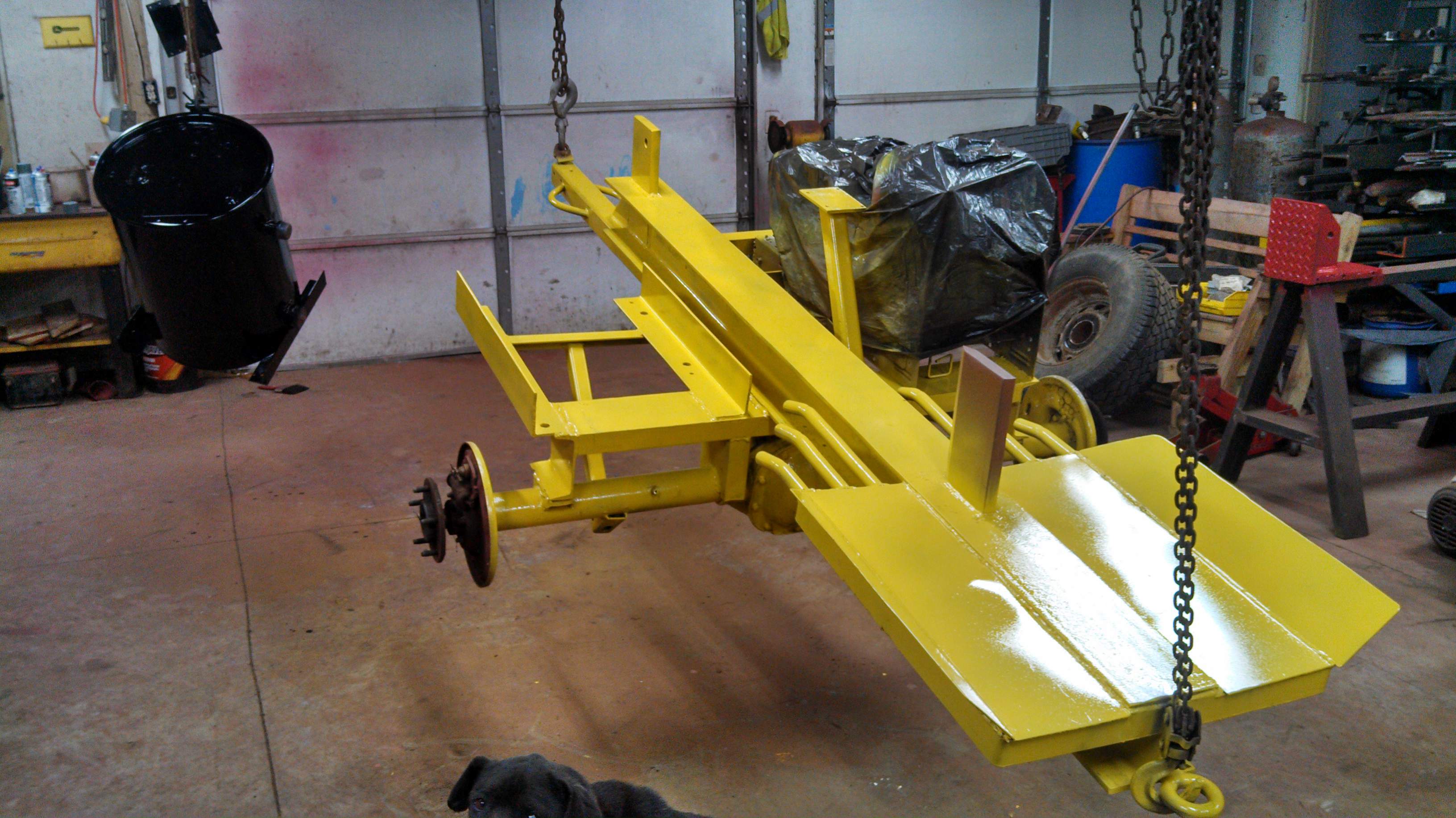

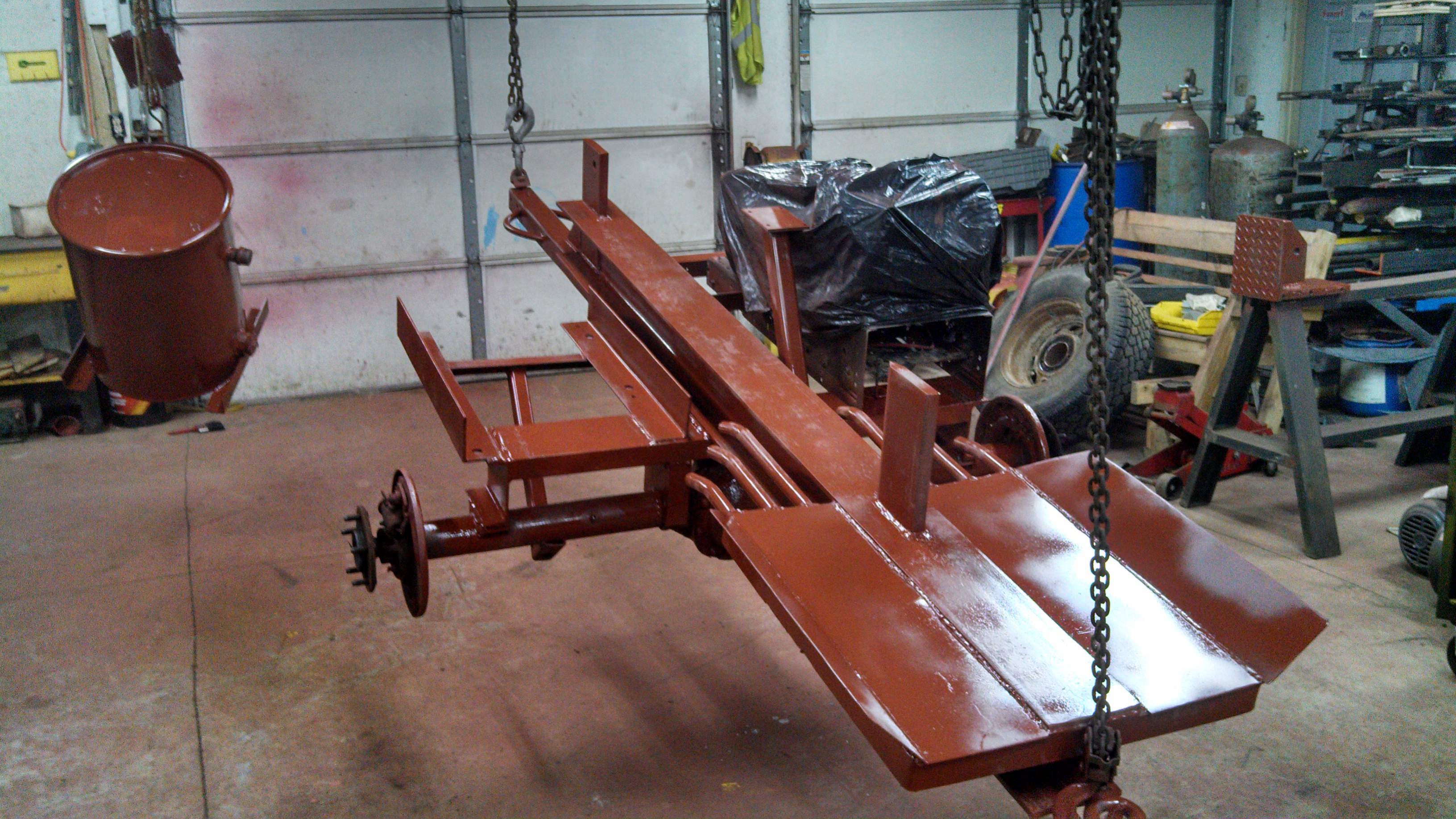

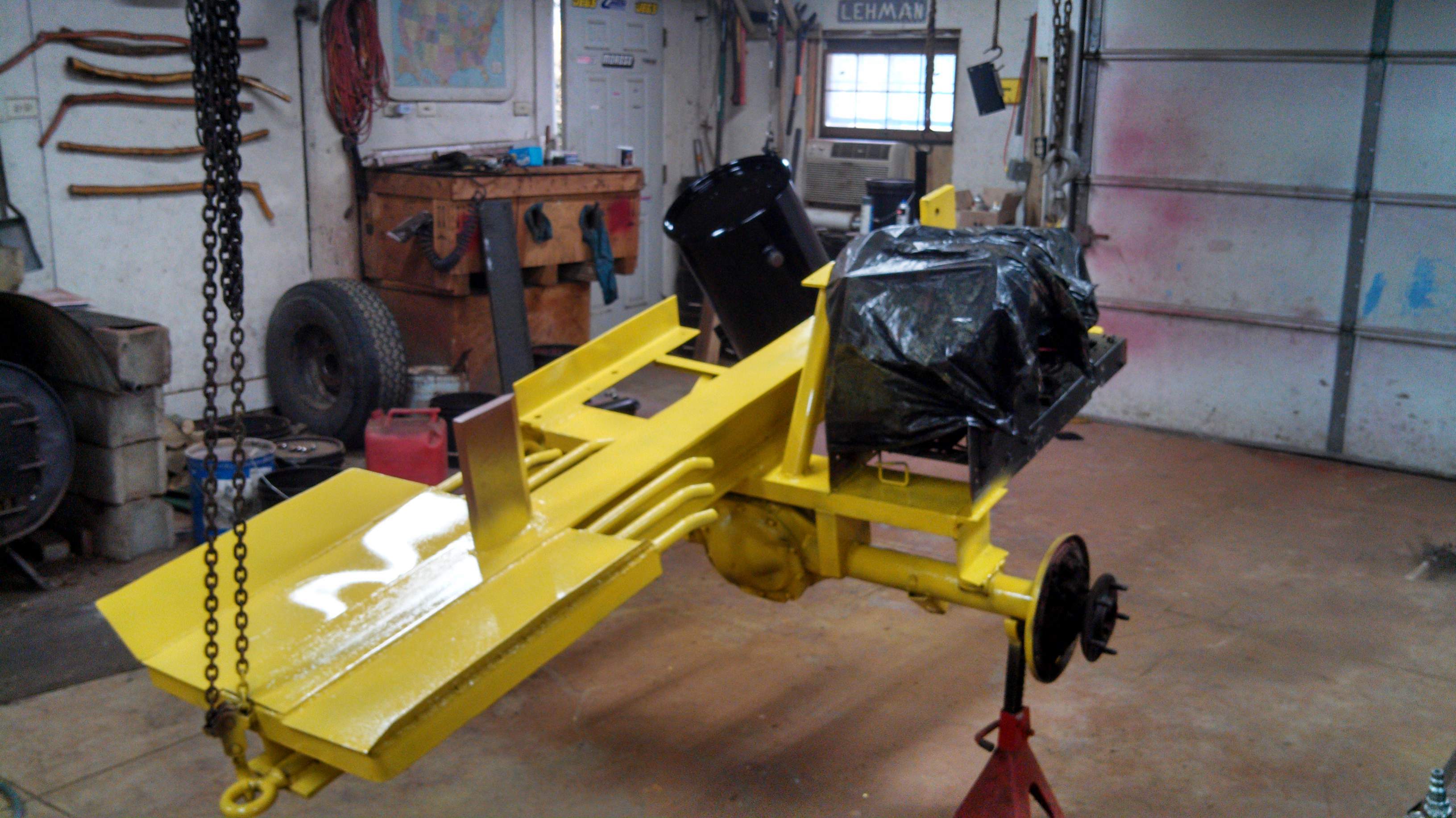

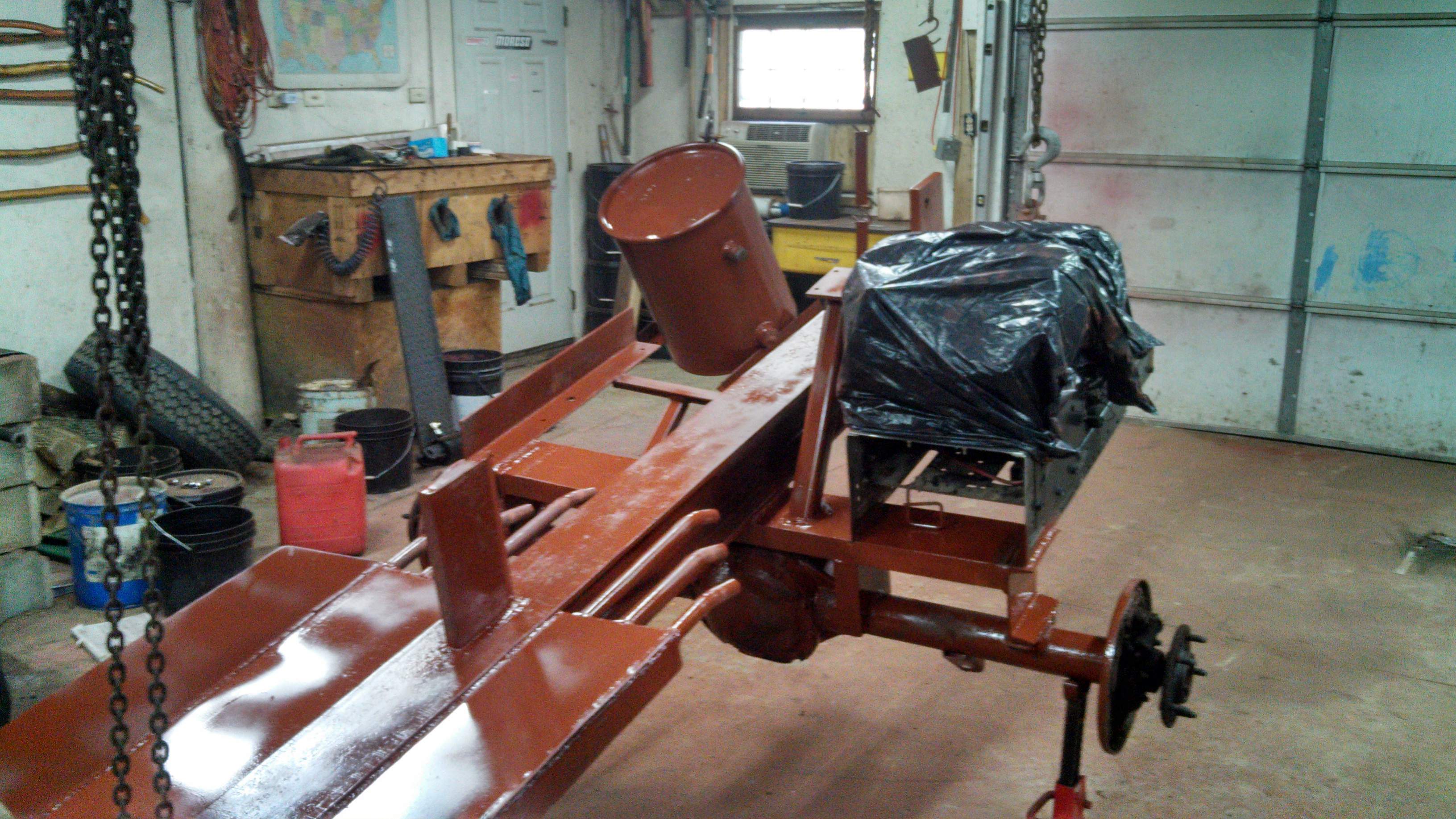

Got the paint on yesterday:
Primed:
And painted

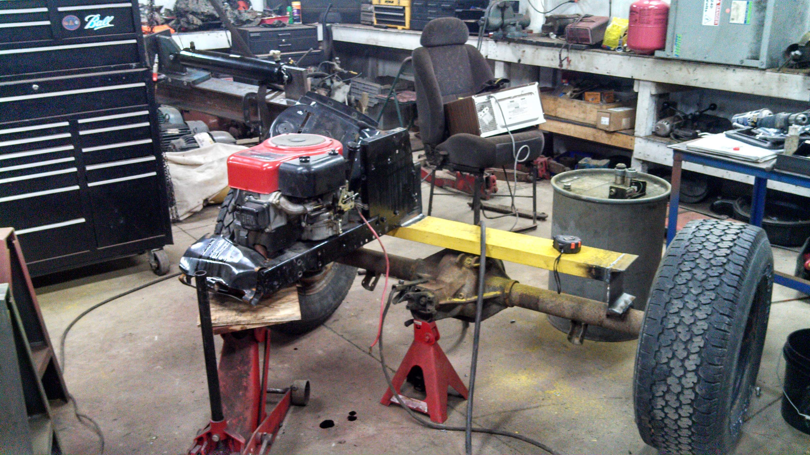

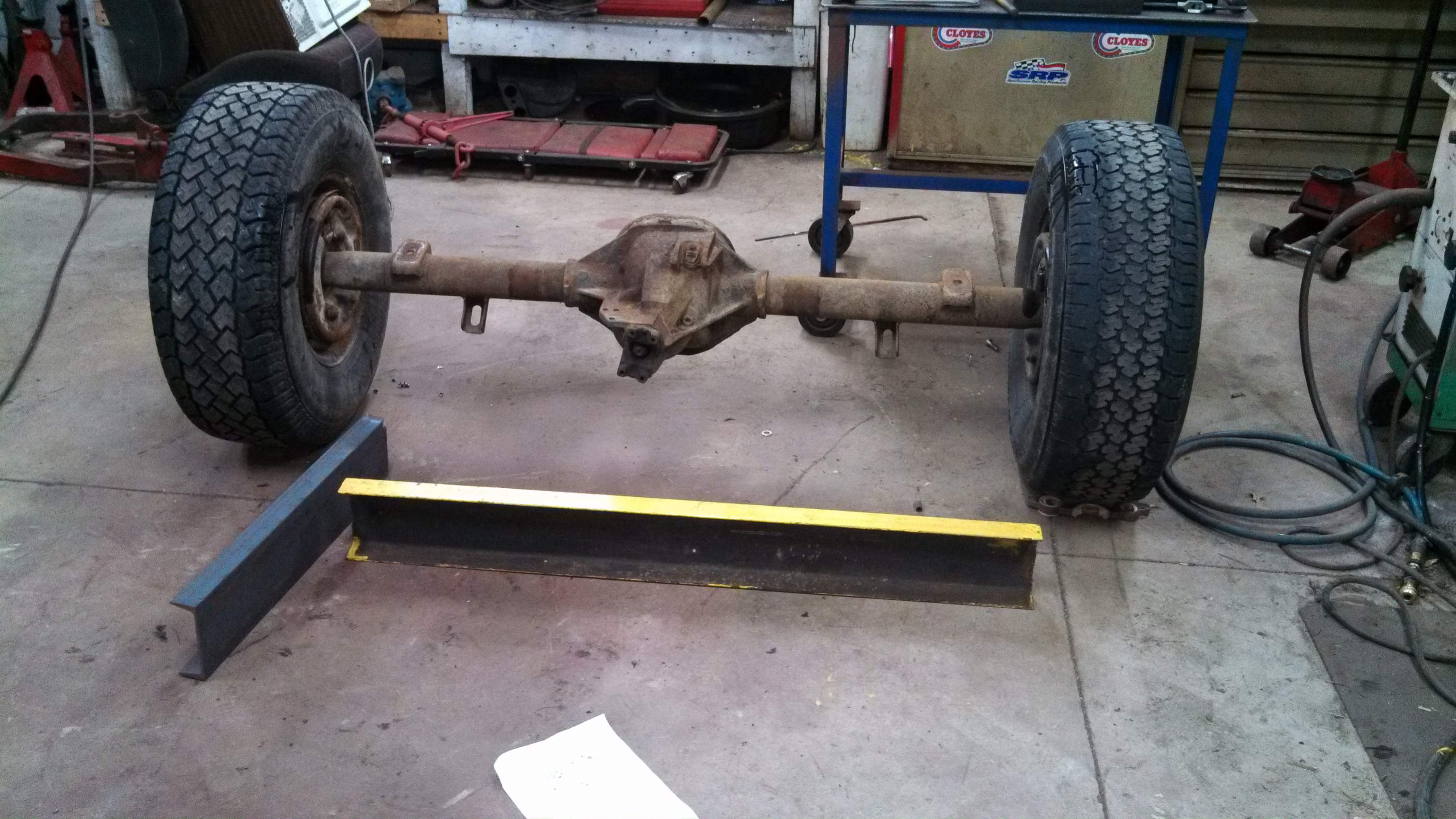

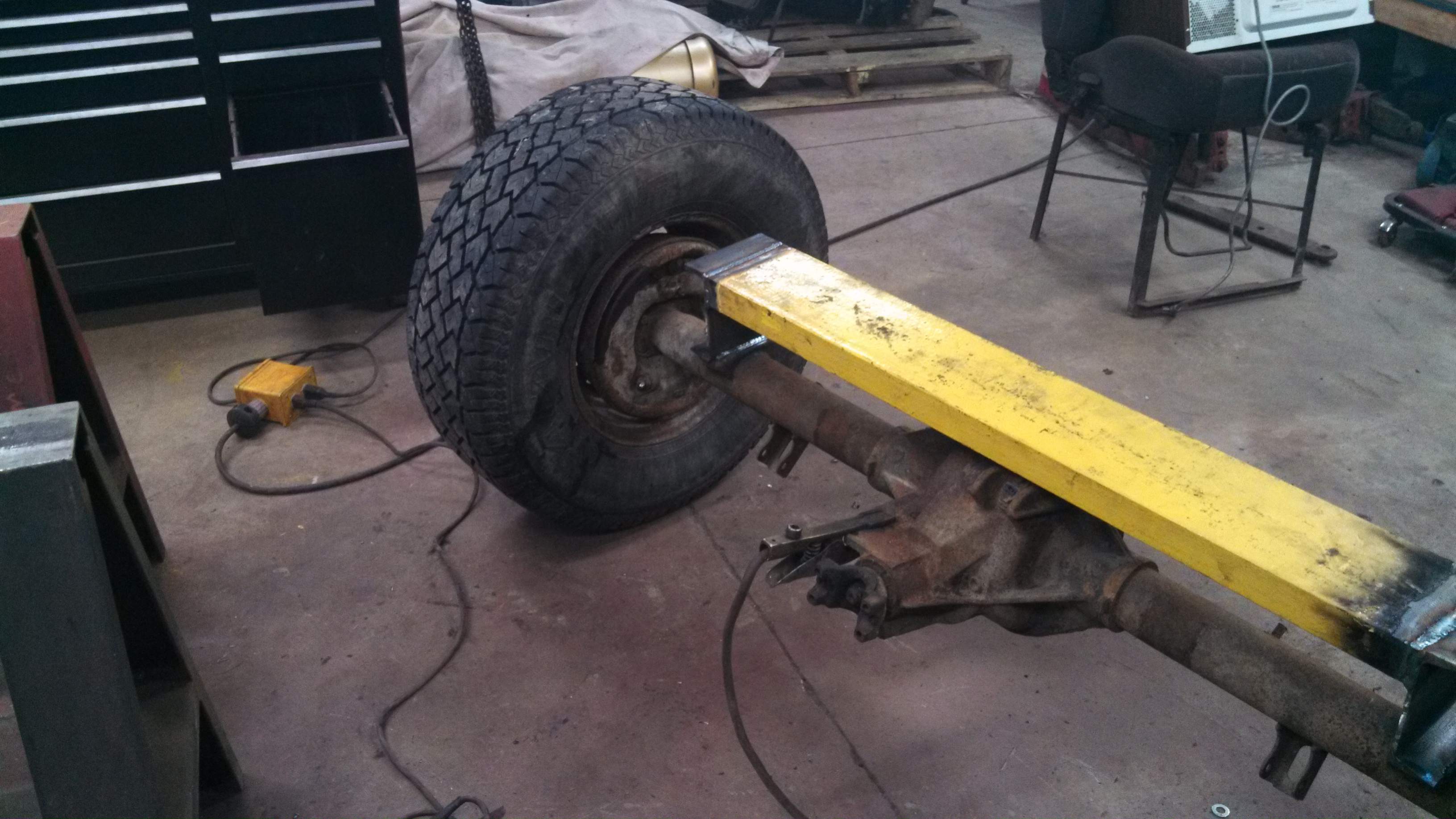

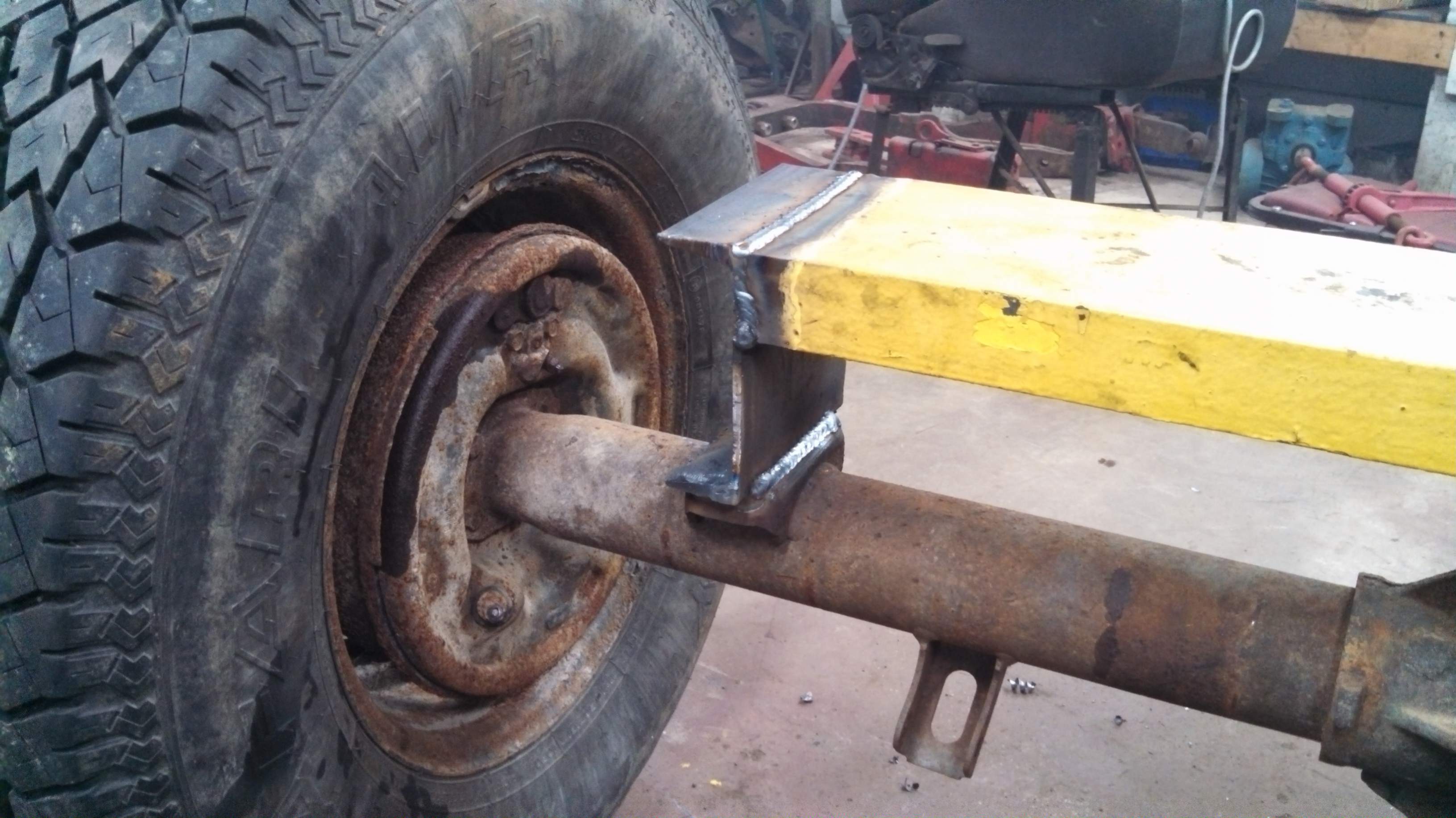

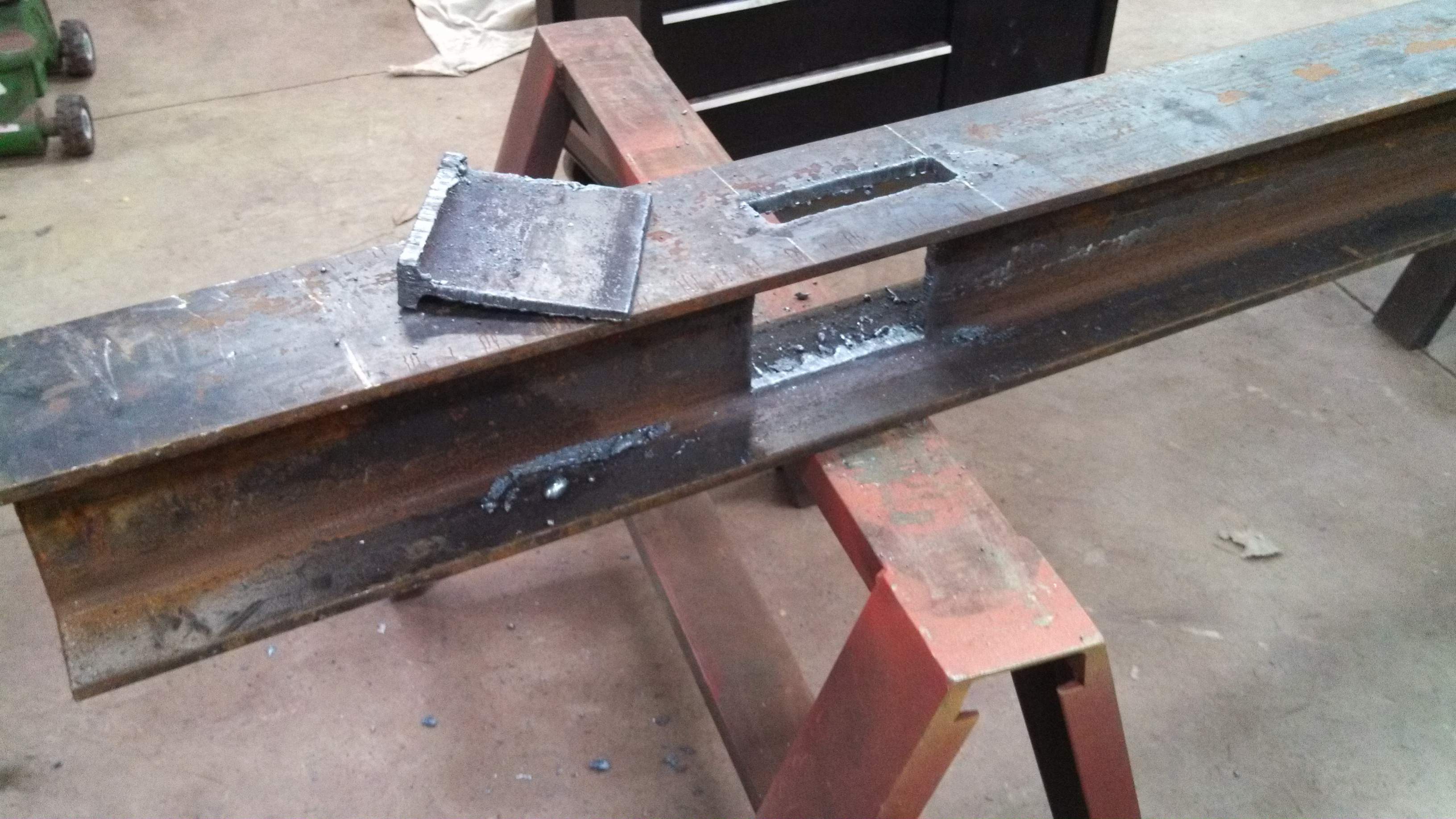

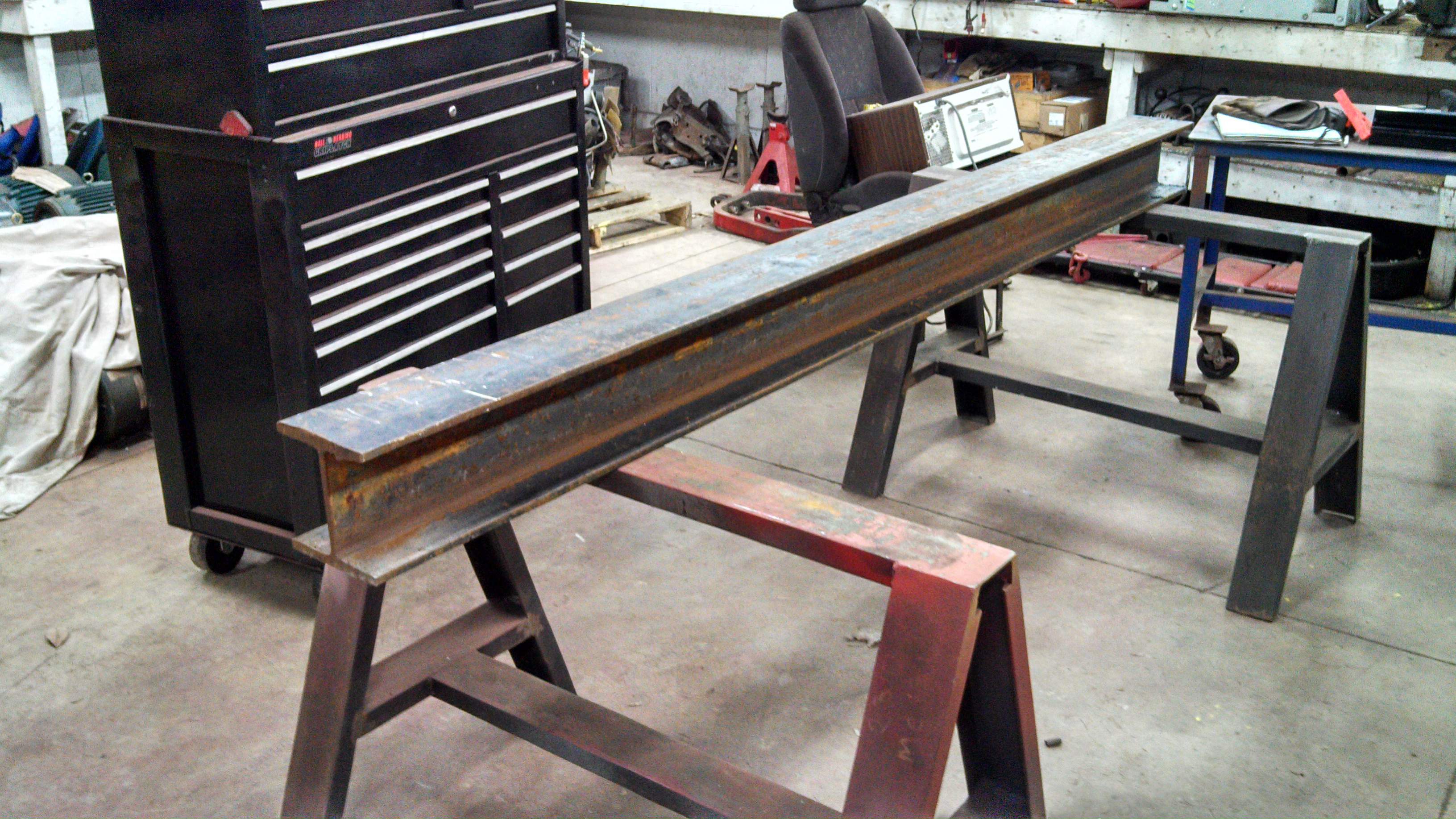

Over the past few months I have started a few threads and asked lots of questions about building my splitter.
Well, I am underway now. Cylinder, valve, pump, filter, and suction strainer should be delivered today. I already have steel, beam, tank, motor, and an axle to use. Will get hoses made once I get things assembled and figure exactally what I need.
This will likely take me a few weeks, but will keep things updated as I go.

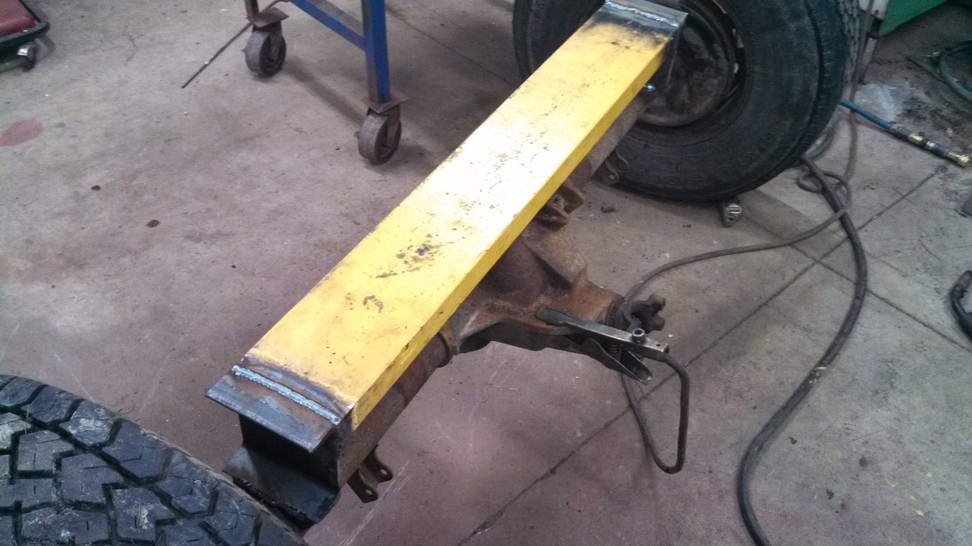

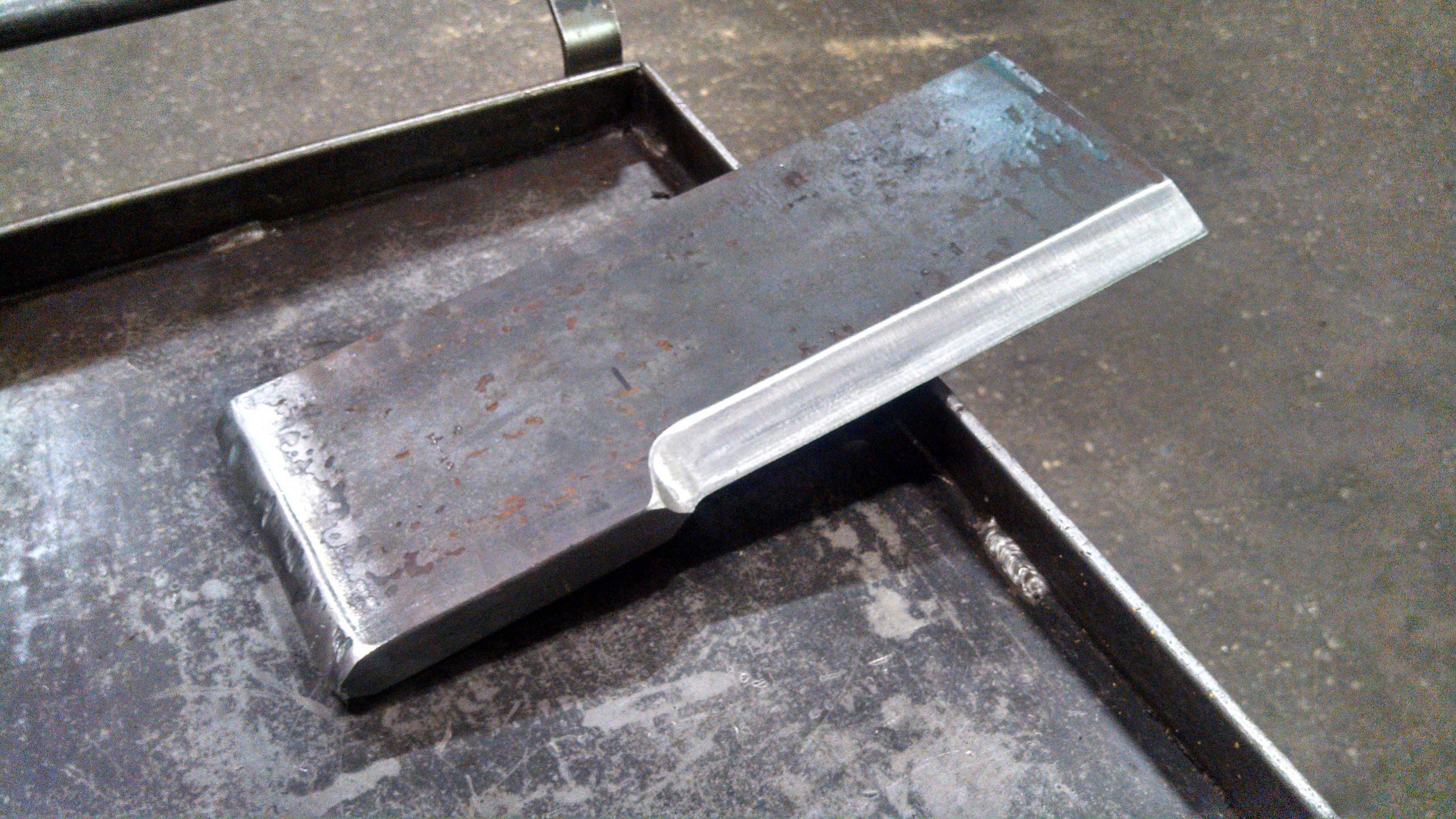

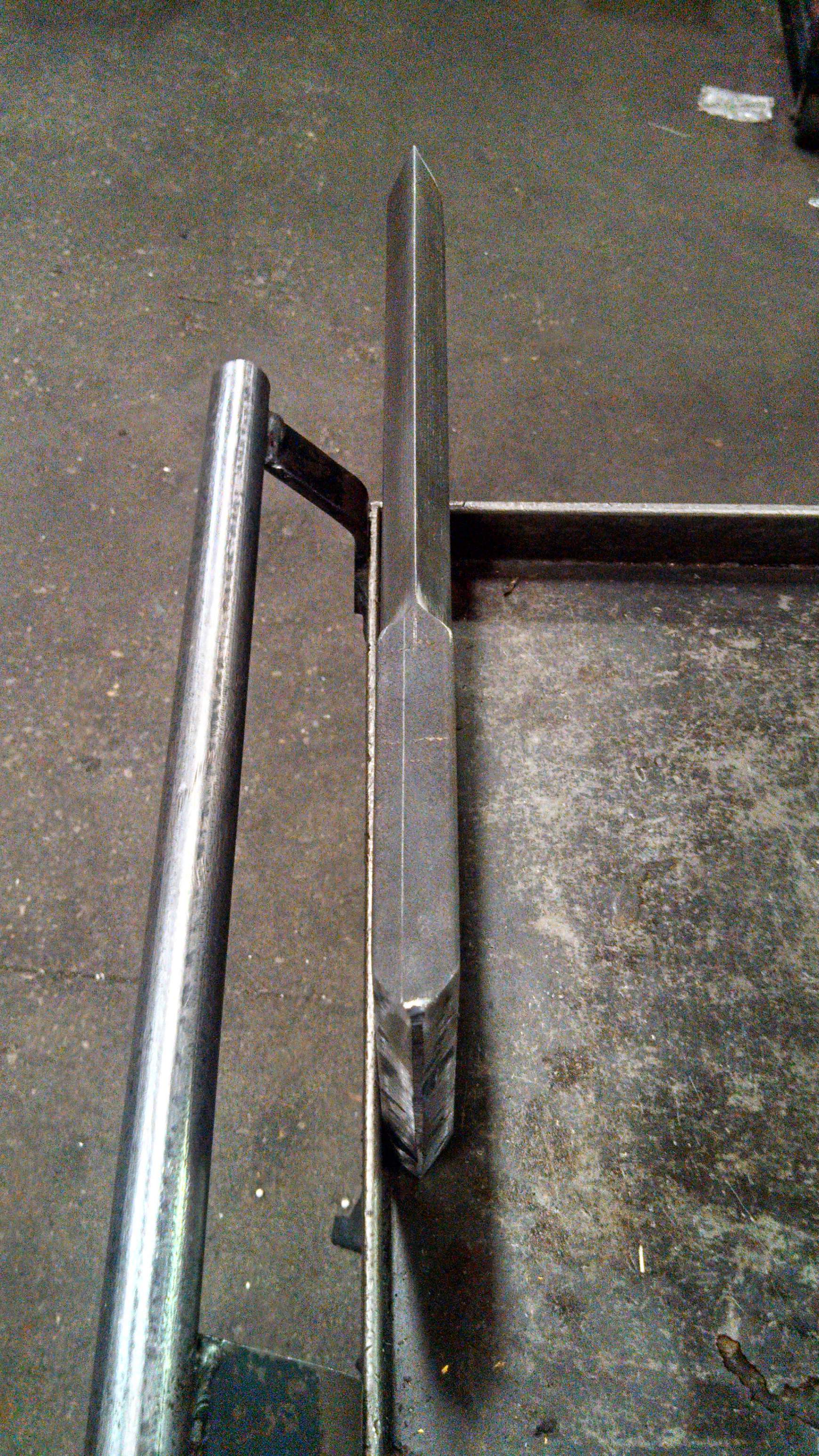

Here is some shots of the wedge and beam. I took shieldarc's idea for how to attach. And I left the beam long for a good secure point for attaching the table.
Here is the wedge and beam.
View attachment 365687View attachment 365688View attachment 365689View attachment 365690
Really nice metal working. In the building of mine I started out with a piece of 3/8" sharpened steel for the wedge (like yours but not as pretty a machining job), cutter or what you choose to call it. I found that the cutter sliced the logs, like a butcher knife slices meat, rather than popped them open.
At the time I was running a shorter cylinder and that obviously hampered success as I ran out of travel before I had the log split. I then added a wedge as pictured on my post and by the 4th iteration I had what worked really well. The wedge is back from the leading edge to give the point time to get into the log and start the splitting process then after about an inch or so of that, the wedge forces the log to separate by expanding about 15 or so degrees on both sides. Once I added the 24" stroke cylinder it was a walk in the park.
On the question of 2 stage pumps and speed, the literature supplied with mine, which seems to be a popular model made for the purpose, said that the pump changes stages internally by pressure relief valves and as the wedge engages the log and the pressure builds up, the pressure relief valve in the pump automatically diverts the fluid to the high pressure stage. With that said, I doubt that velocity of the fluid would keep you from getting the benefit of the 2nd stage. Personal opinion but makes sense to me.
