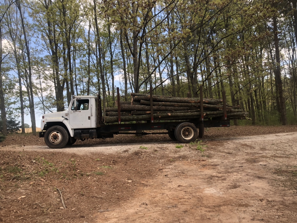

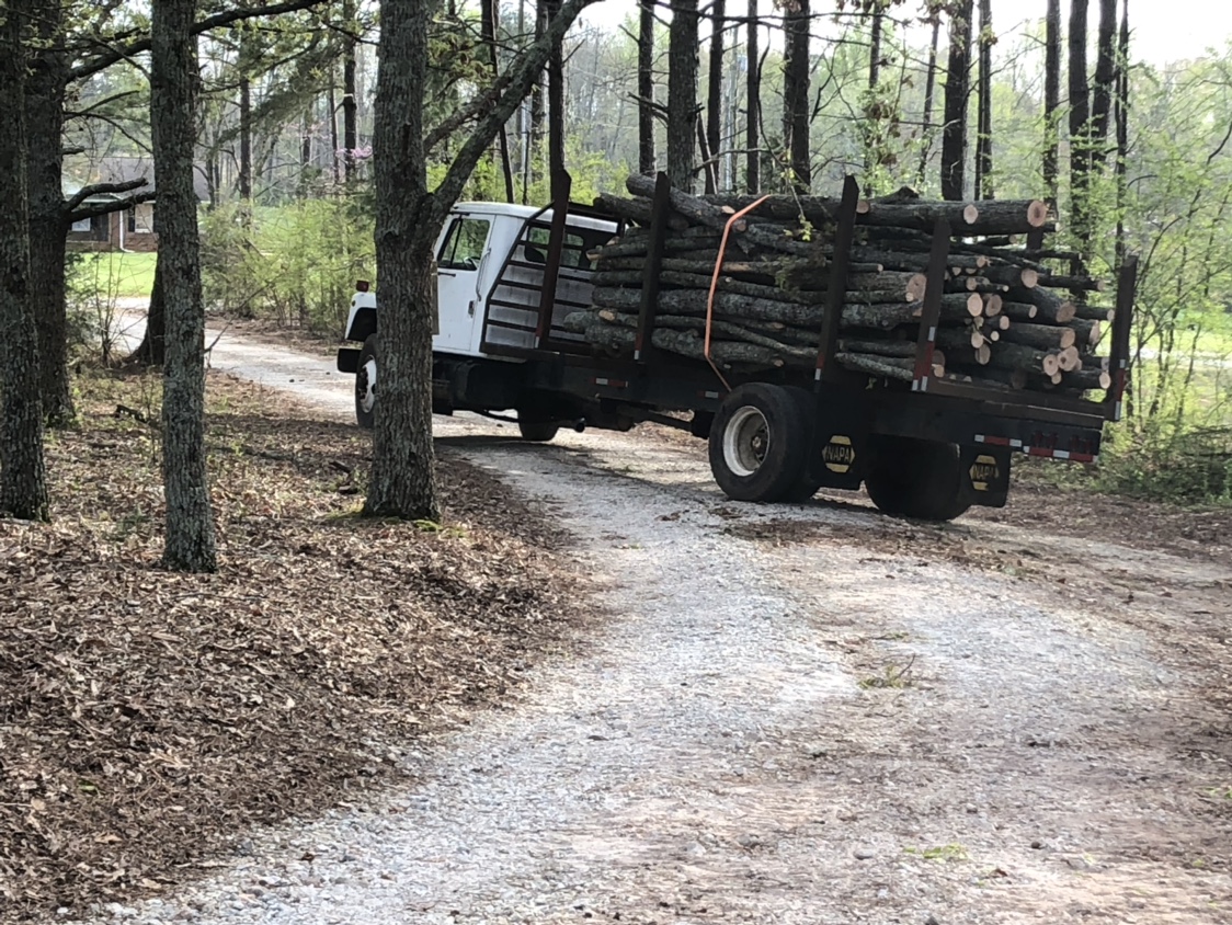

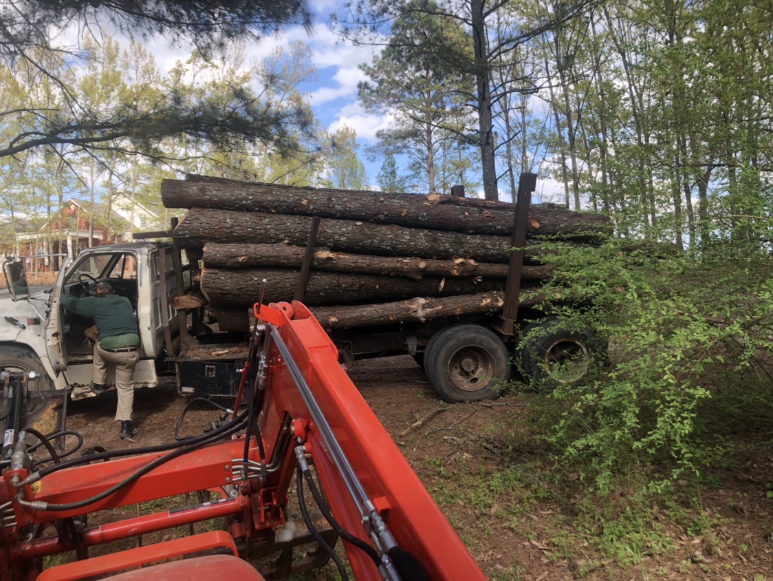

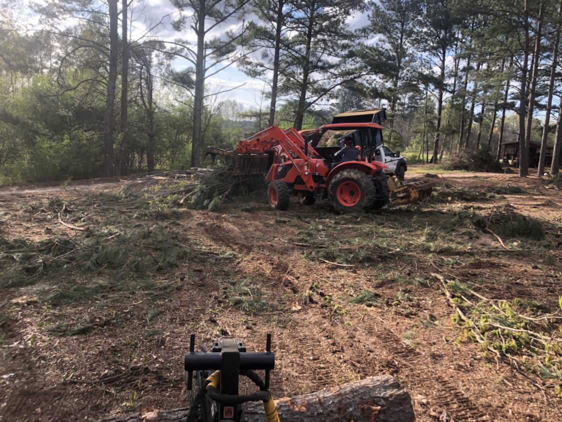

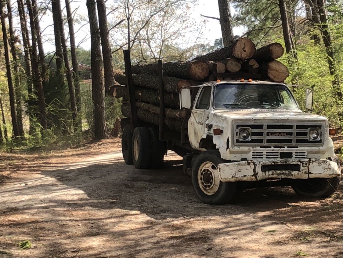

I was ridiculed for buying a M7060HD-12 to use for tree work.
You can稚 load a log truck or Pulpwood truck or your chip truck with a Farm tractor.
View attachment 598358View attachment 598359
Ok.
It also does pretty good when loading pine tops into the Chipper.
I use mine for tree work also. Grapple loads logs onto dump trailer and the Woodland Mills 8" chipper handles all the smaller stuff. If there are any stumps to grind I use my PTO Stump grinder. I can haul everything mentioned at one time in a 16' gooseneck dump trailer. Unload at site, do job and haul off chips, logs etc and then return and load up and go. I may be a bit slower than a larger crew with more equipment but with my setup 2 of us can do pretty much anything that a large crew with several trucks trailer and pieces of equipment can do. My unique setup is very versatile and every customer has been pleased and impressed. This setup would not be idea in a more urban environment but most of my work is suburban or rural.
