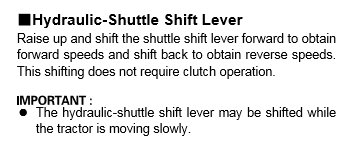

Here's the only relevant instructions from the M7060 owner's manual. And the videos I've seen on-line show the tractor being operated that way. NO clutch being used when using the shuttle shift lever forward and reverse. It is an abrupt change - I've used mine that way when using the front end loader - but I wonder. Is using the clutch each time you move the shuttle shift lever from forward to reverse and then back again causing more wear than if the clutch is not used?

Any power shuttle is generally using a wet clutch. They are generally beefier than a dry clutch, but still wear & wear faster when operating at higher RPM. Generally they will clutch fine at high RPMs, just rougher & more wear
A GST (at least the 30 & 40 series Ls) has a dry clutch operated by the clutch pedal & a separate wet clutch (possibly 2) for the shuttle & GST shifting. The wet clutches are going to be stronger & more durable if the timing works for you. In the half day I spent operating a relative's L3?30 GST I never got the timing when moving piles of brush. I defaulted to the drug clutch & pedal as I wasnt comfortable with the delays & timing on the shuttle clutch. I'm sure I'd get use to it after a day or 2 though. But no matter how you slice it, it isnt as precise or easy as a HST for really tight work. It is more efficient for power transmission though.

My understanding of the Hyd Shuttle on my 9540 is that it's one hyd wet clutch. To change direction the hand lever is employed. To simply stop/start movement the foot pedal is used.
I use the hand shuttle if I'm operating at low rpm. I use the hand lever to change direction and use the pedal to soften the engagement if operating at high rpm.
