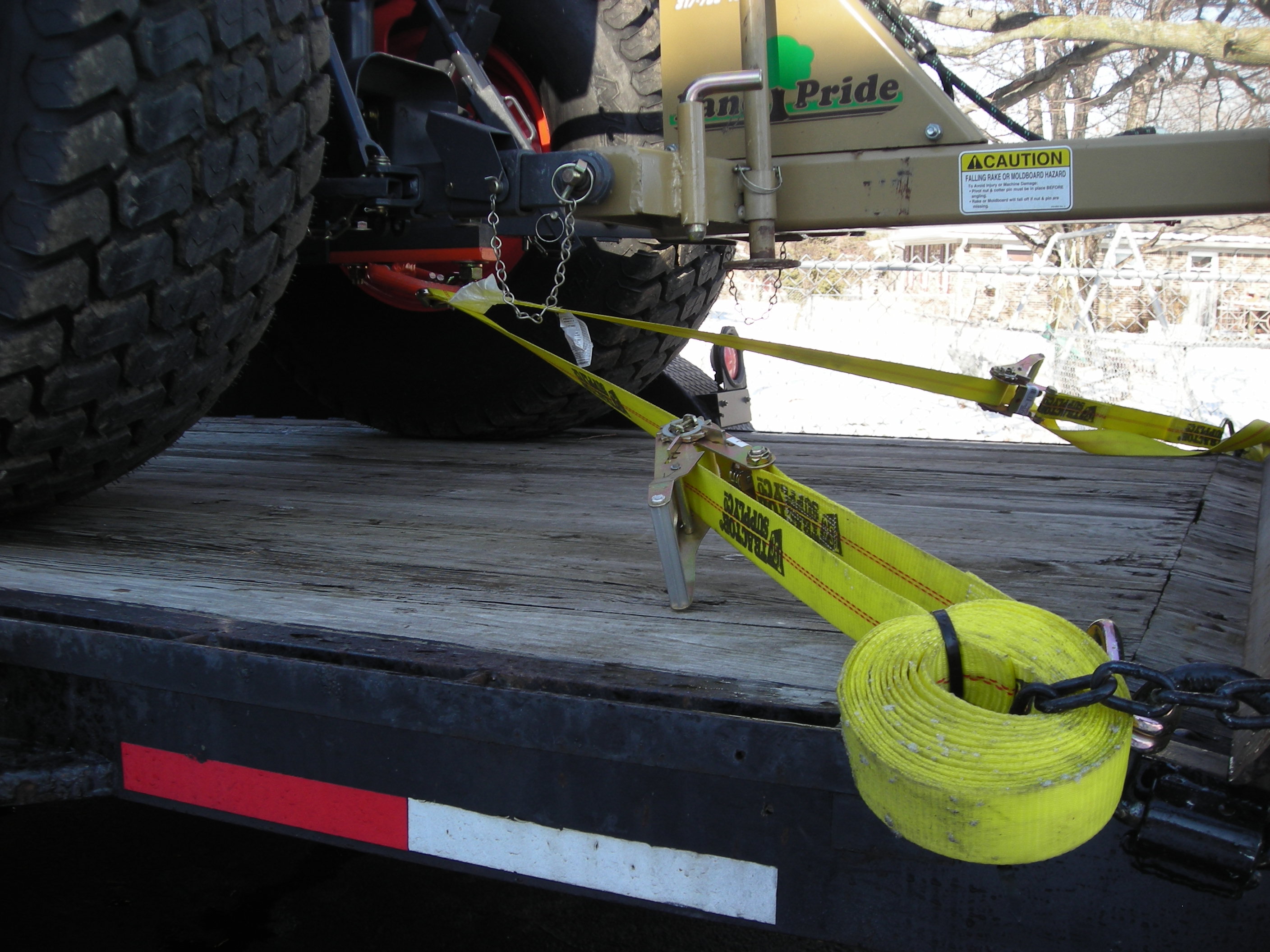

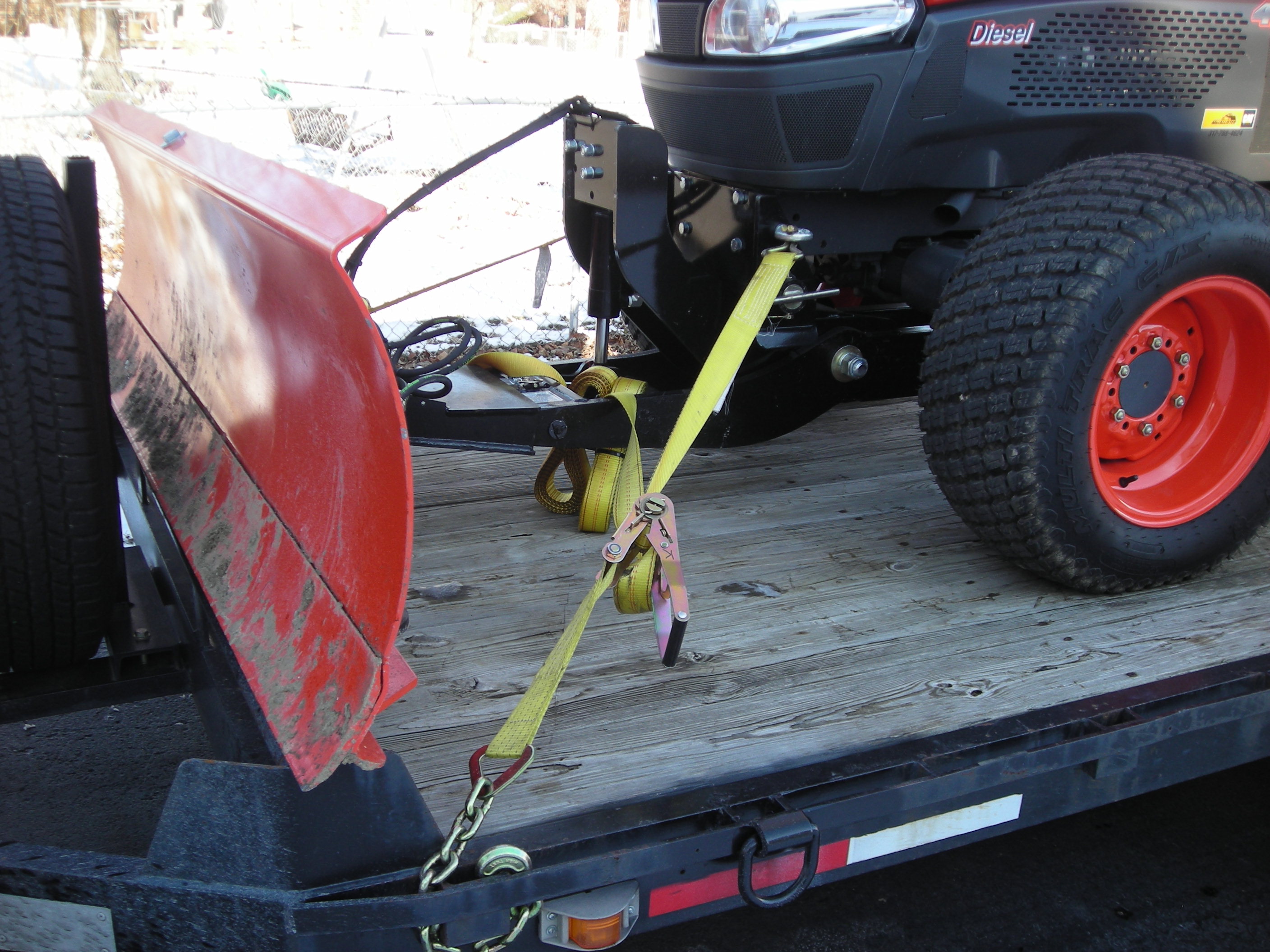

What do you hook to the eyebolt for a tiedown? The eye looks quite small as I use 3/8 chain. BTW, I wish I had a front blade for mine............:ashamed:
2" strap with hook. Philip.

Thanks for the pics. I thought that was what you would be using..........I use 3/8 chain and no straps..........

You could always add shackels to the eye bolts to loop the chain and grab hook around. I just hate seeing the paint scrapped off of his new grill guard by that chain. The rust will grow now. Philip.

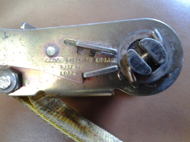

Not trying to be the safety police but ratchet straps are supposed to be closed to latch them.
Why would that make a difference? At least three wraps on the roller and tight on the cam has always served me well. Philip.

It latches them so they cant come loose, look at how they are made.

That just looks like a stop to me, no locking function evident. There is no load on the strap, so your cam is not engaged. Not sure how that would effect it, I will check tonight as well. If that is a better way I sure do want to do it. Thanks. Philip.
