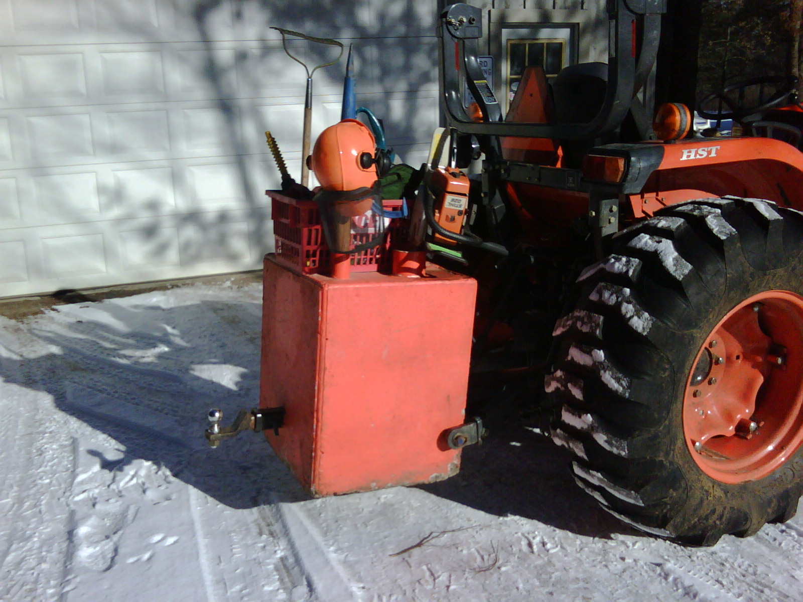

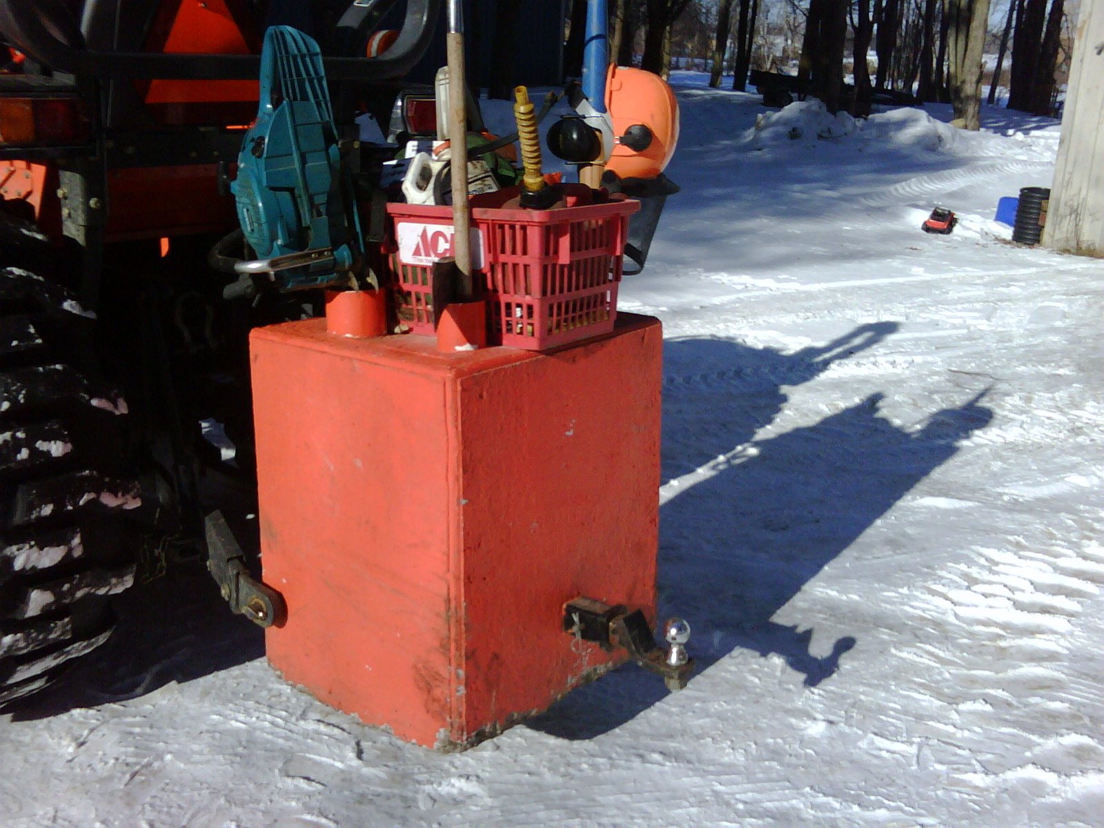

This is what I did for ballast. I didn't like the look of a barrel filled with concrete, but that's just my taste. I constructed a form and inserted my catagory 2 bar and welded in the trailer receiver so I could at least pull a trailer with it. I also welded 2-2" angle iron back to back at an angle to receive the 3rd member with a pin. I also stuck in 2-3" pvc pieces with drain holes in the bottom along with 2-2" pieces which is great to haul the saws and tools back into the woods. There is just enough room for the basket in between as pictured to haul the chains, gas, oil, and whatever I can fit in it. It will stay there all day and not come out. It ends up being 1300 # which is just enough to keep my tail on the ground along with my tires loaded when I max out my loader. All in all in works great for me and is very easy to drop anywhere and hook back up if I need to.

Nice, looks like you've got the whole outfit on there. I never know where to put all that stuff when getting firewood out, it ends up all over the ground. Thanks for the ideas.
