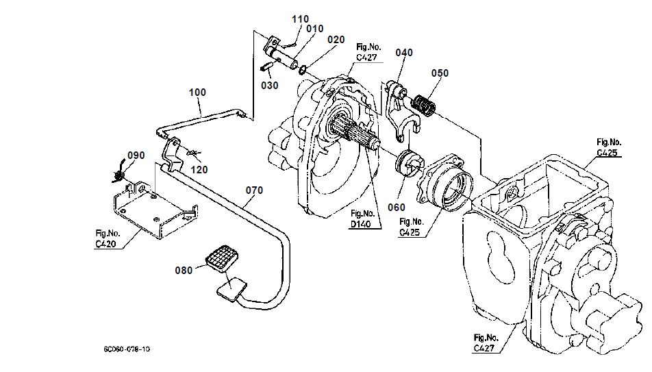

I'm not saying the 7800 is a bad tractor. Mine obviously has some issues I need to figure out though and based on my experience with it and now comparing it with others I wouldnt make it my first choice again. I'm not happy to say that but it is what it is. So far just looking at it I can see the linkage is not on par with the other b series I've put my eyeballs on. I WILL upgrade this linkage once the warranty is out. The problem i see with it is for starters where the linkage goes through the figure c420 in the picture. if you look under the seat you'll see this is just a notch in the metal with a bent chunk of metal "pinching" the linkage in there. It looks like it will pinch in tighter the harder you have to push it. The foot lever section is long with no real gussets or mounts to support it before that pinched spot. The final lever near number 110 is short and offers little leverage. I think I can improve on this linkage set up for starters. My locker has never worked or felt like the aforementioned b2150, nor does it feel like any of the other b tractors I checked out today and I think this linkage is at least part of the problem. I think theres more to it but i really do think this can be improved for starters.
With crbr's posting of the schematic and your very excellent description of the problem I now have something to look at on my tractor. This is a very good post. A lot of wisdom in very few words. I learned something today.

The linkage I think has been a big portion of my problems. Push yours by hand once and see how hard it is to actually make it go all the way down. now next time your near a kubota dealer stop and press down a locker on a b3030 or any other b series they have there and let us know what ya think. Mine takes alot to make it go all the way down and since its placed in a manor that makes it difficult to always apply the needed pressure on it I've probably not had it not fully engaged at times. Mine doesnt give you that positive engagement feel the old b2150 did and like the other b series likely do. I dont know for certain though if mine is or is not any harder to press than any other 7800.
/ b7800 locker problems #23
Actually the diff lock pedal on my B3200 is pretty dang hard to push all the way down as well. I have to keep all of my weight on it with that foot to really engage it as far as it will go. I might look at increasing the leverage ratio on the little arm that goes into the trans as you mentioned.

You guys should try mine! I would give a shiny nickel or 2 even to have what you guys have! I'm going to get a scale of some type and measure how much pressure it takes to engage it. Obviously, when you do push the pedal if the locker components arnt lined up it may not engage so in that case dont force it or you may bend something. All the new ones I looked at on the dealers lot were smooth like butter compared to mine. The one obvious difference between them and mine is the linkage, I dont know if theres any difference on the internals.

We'll I talked to kubota about this linkage stuff. talked to jeremy in service at the california number listed with their warranty info. He was very helpful and got back to me right away. He checked with engineering who said the early b3200's had the same... or maybe he said similiar linkage as mine. The brandy new ones on the lot were the ones i was looking at and they are really slick. Felt like the old unbreakable 2150. He did say the new linkage will work on the early 3200's and the b7800. If you have a machine under warranty i wouldnt mess with modifying the linkage myself. I would consider upgrading to this new linkage though if it doesnt affect your warranty and you do use your locker often. I'm pretty sure the "crappy" linkage was the majority of my problems and once its gone I can expect real kubota reliability. I'm starting to feel so much better about this machine now that were getting somewhere. I wish i would of looked into it better the first time around.

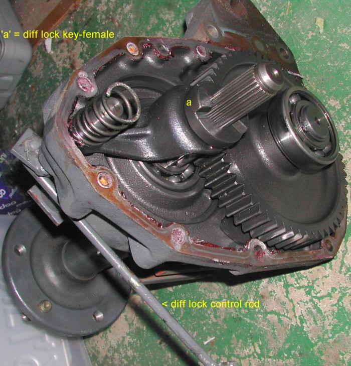

Well, CAPT, I hope you prevail in you warranty dispute. It certainly seems
to be covered.
The diff lock from my B21 looks very similar internally, as does the linkage.
There was virtually no wear detectable in this unit with 2350 hours, but
there is no telling if the previous owner used DL. My JD, on the other hand,
used inferior materials for the diff lock, and it had lots of wear.

Thanks for the picture! its going to come in handy tomorrow when I talk to the service rep. I looked at mine today at the shop, they finished the tear down, I guess they did it assuming it will be covered?? Anyway my shift fork is VERY worn. Its chewed way back in and it looks like its only allowing the locker to engage maybe 1/8th of an inch at the very most. Still need to determine why this happen but again, were making more progress. And now the best news so far, kubota sales department gave me a credit for the troubles I've been having and Pristows made me a super duper deal on a new L3400. So after I talk to the service rep tomorrow and inform him he WILL be fixing my 7800, no more BS, I'll be purchasing me a new l3400.
