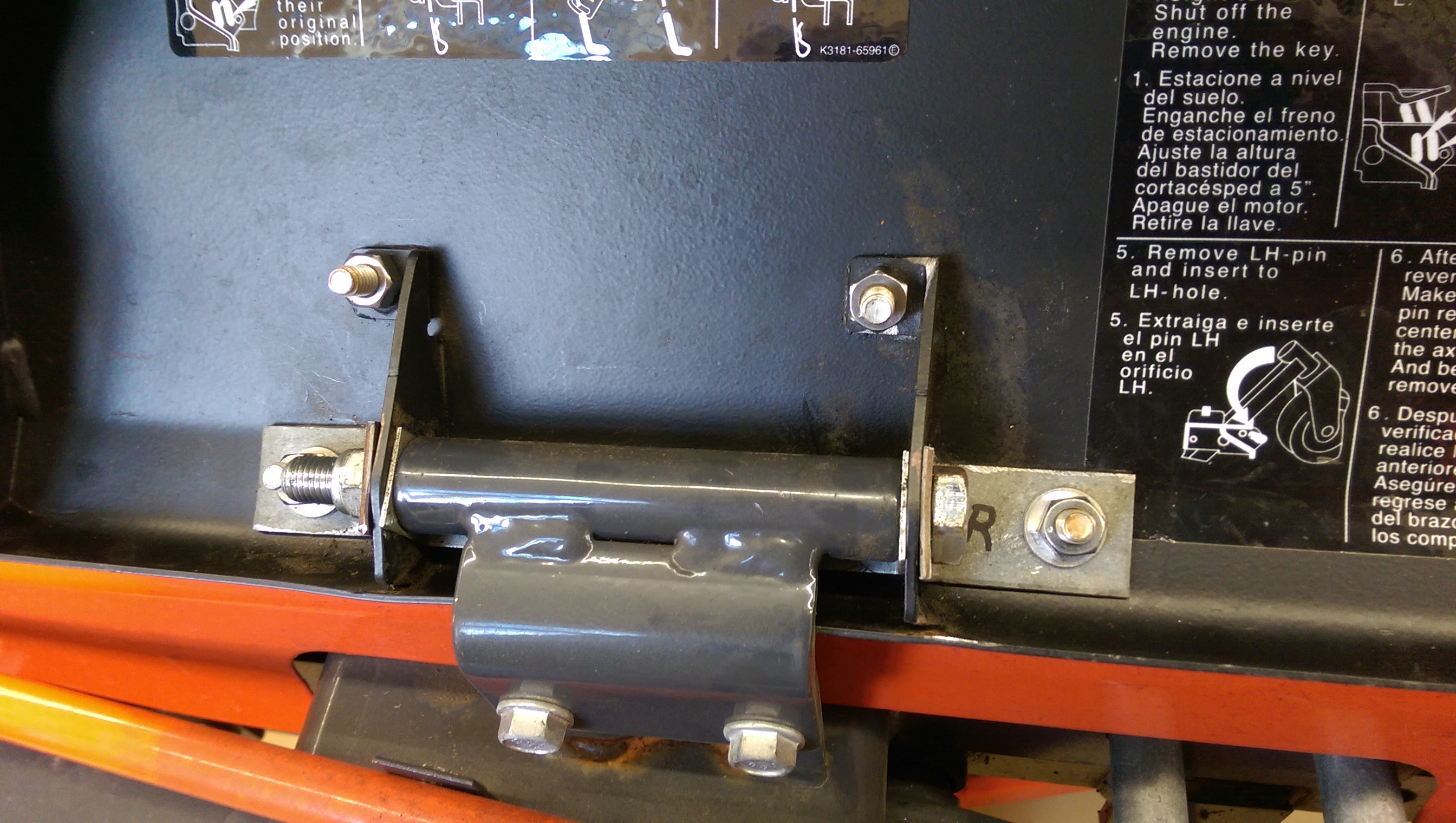

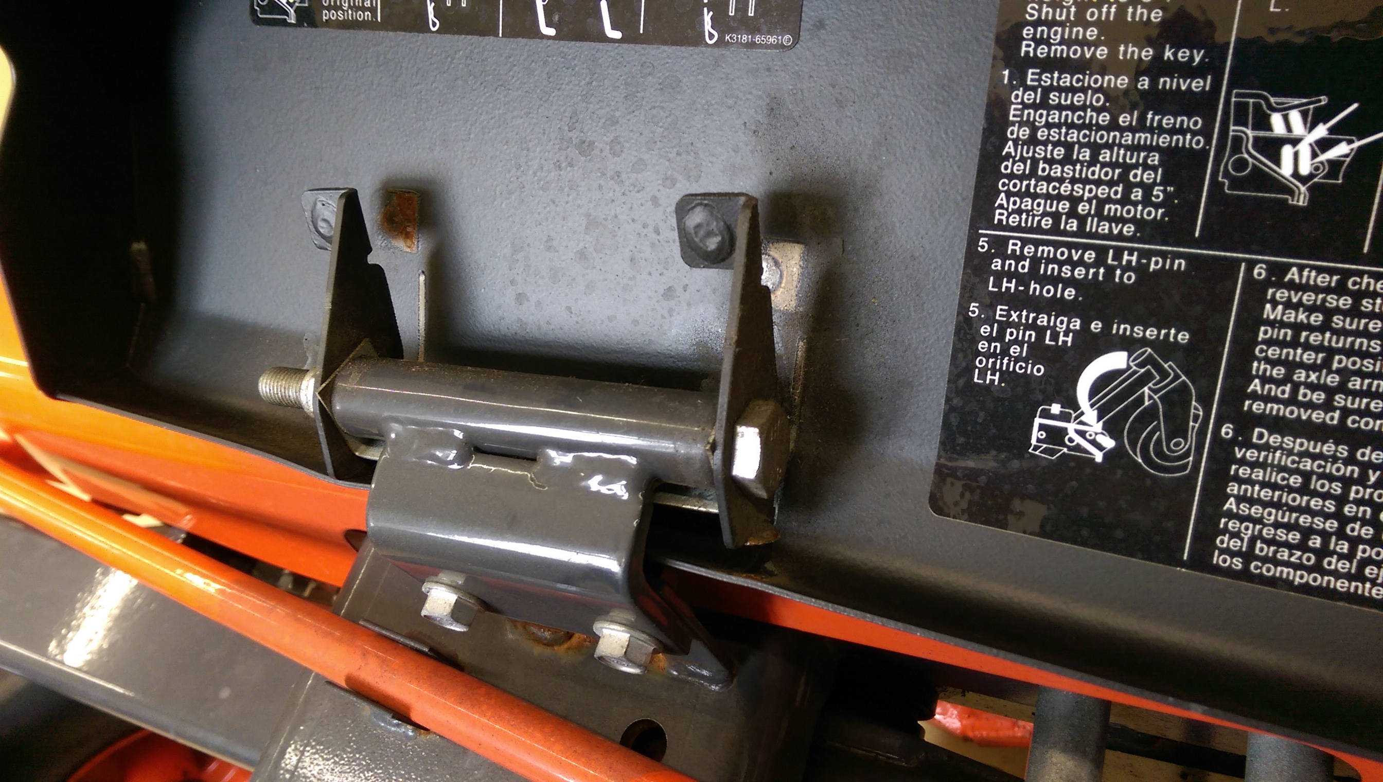

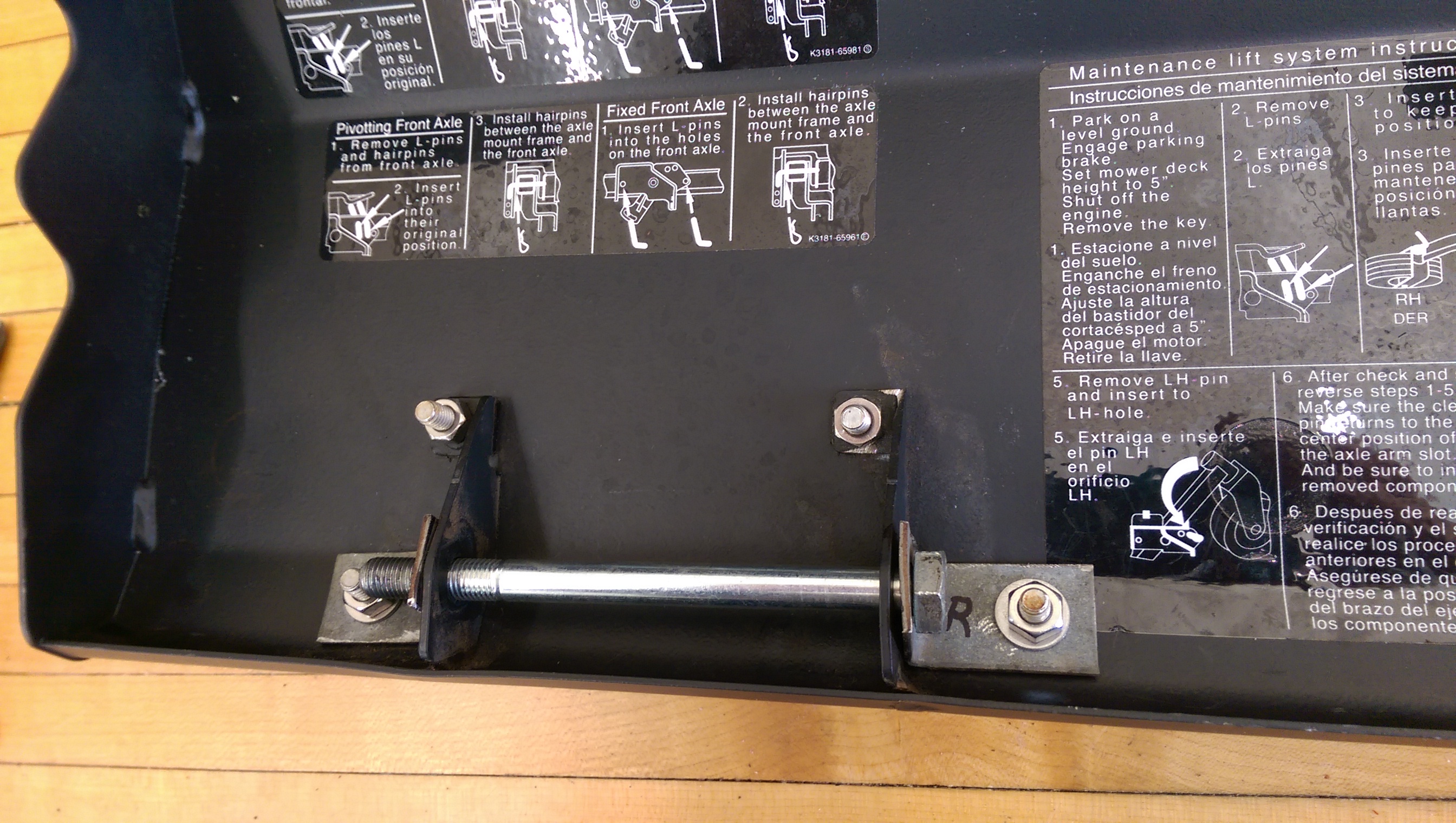

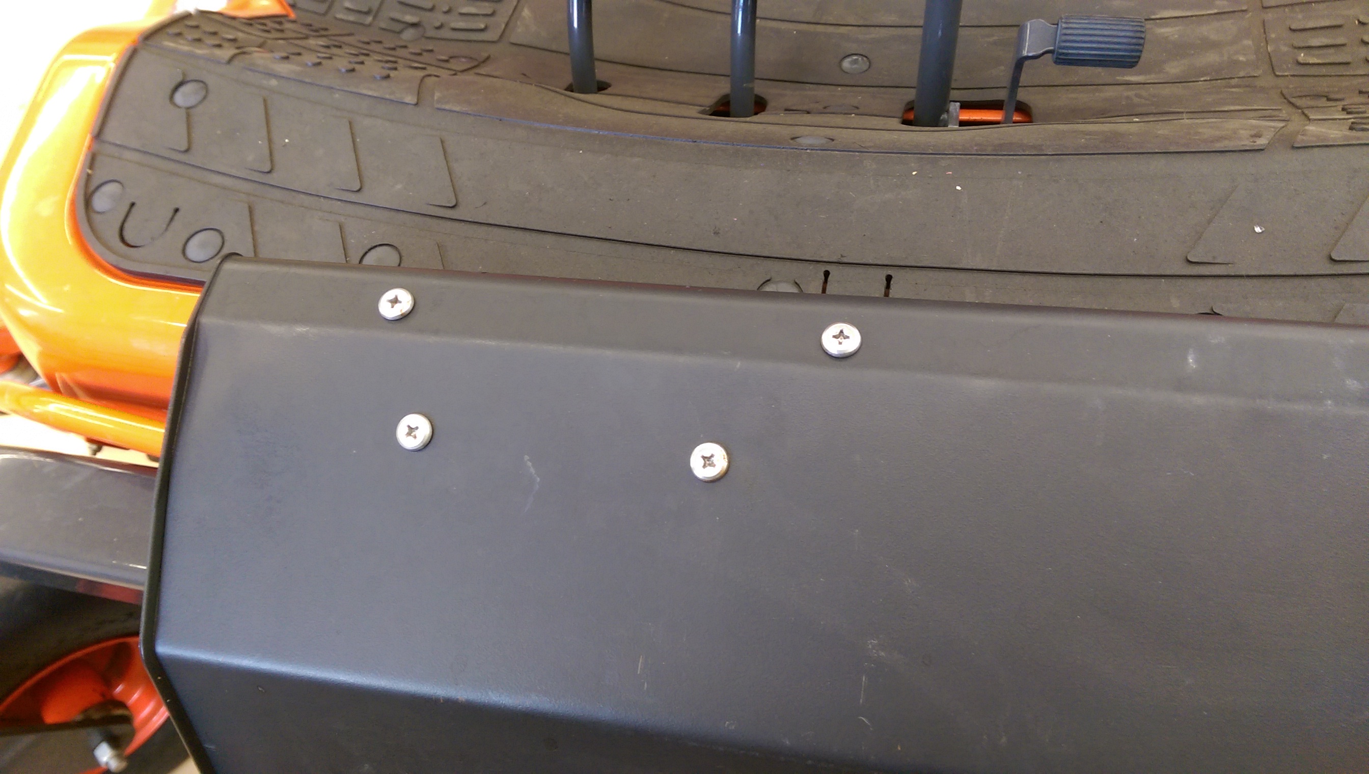

The spot welds under the front cover snapped within the first 10 hours of usage.
Drilled them out and replaced with stainless bolts.
