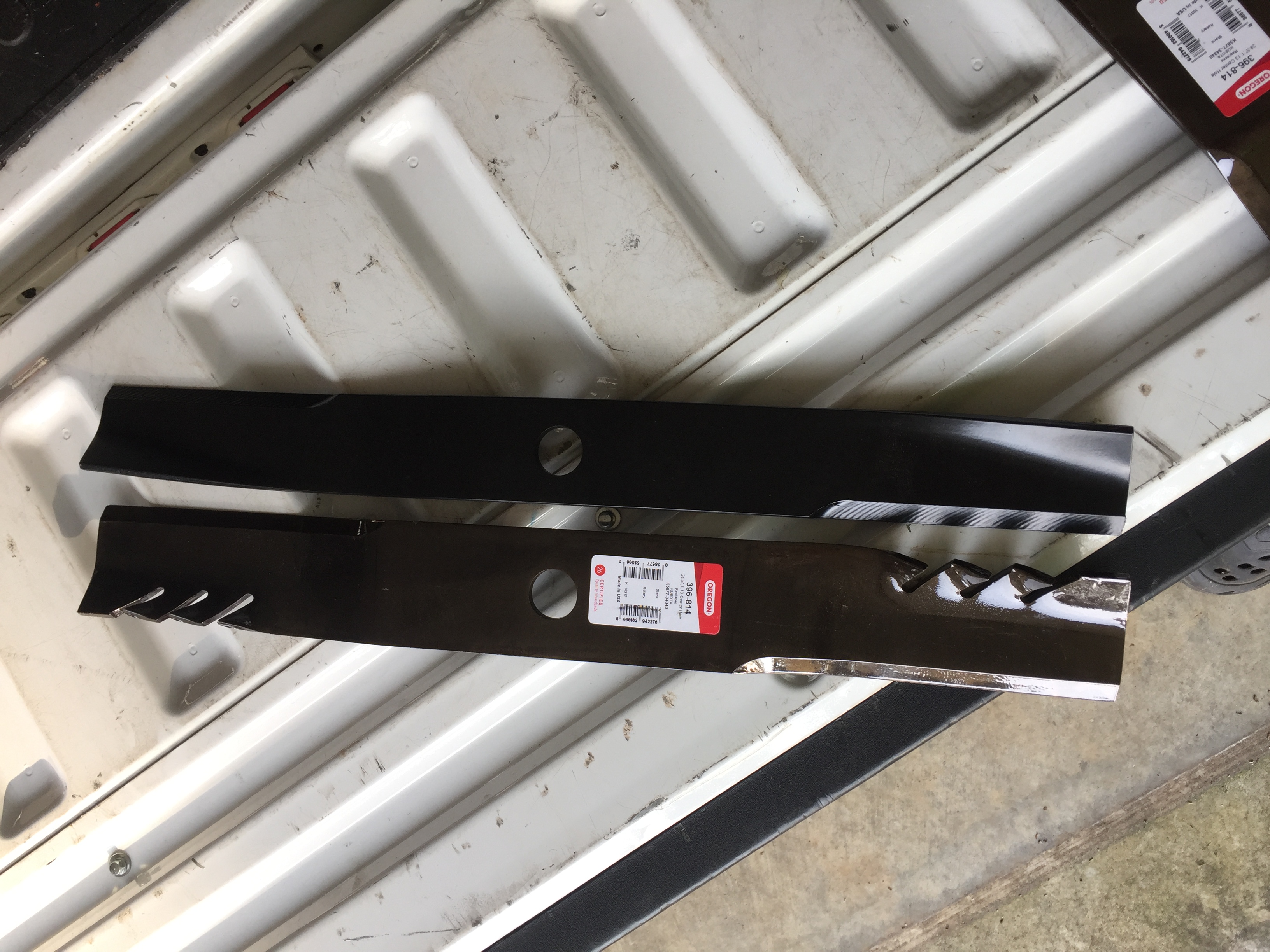

Brown Truck just dropped off my Oregon Gator Blades :D
They cut great. Leaves a light windrow in center cutting Thick 8" Grass.
I Didn't have any normal height grass to cut lol
They have about 1.5" longer cutting edge than OEM blades which is good & the cutting edge is completely flat which I like.
The stock Kubota blades are kindly curled up.
   / My New Kubota ZD1211 Mower #84
1/2" wider & Heavier than stock with 1.5" longer sharpened edge :D

Yep post #83
#87
Yep post #83
Doh! Didn’t read carefully. Sorry!
Glad you’re pleased.
