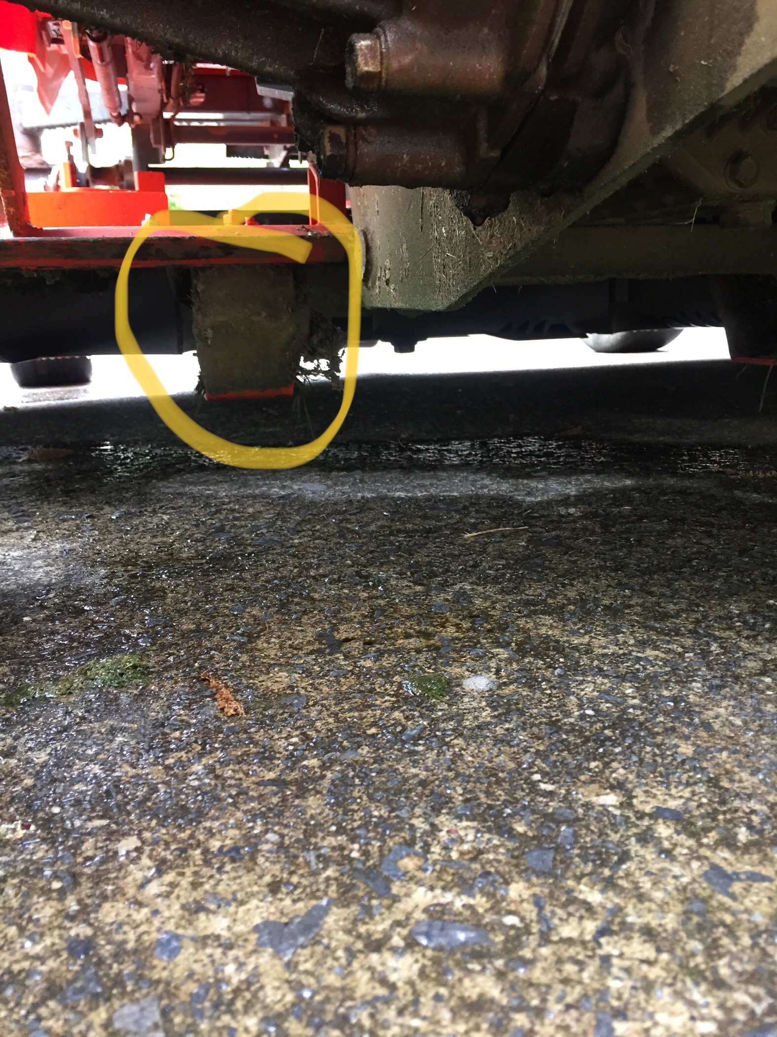

I cut all 3 of them completely off today & it's a lot better :D
I haven’t looked at mine. Is it possible to just remove them so they can be re-installed?
   / My New Kubota ZD1211 Mower #102
I haven't looked at mine. Is it possible to just remove them so they can be re-installed?
Yes Sir, their bolted on across the back of deck on the ZD mowers.
I think the F series mower decks has metal shields bolted on instead of rubber.

Did you ever remove them? I hate the windrowing that my 72'' RD leaves... on the front yard
   / My New Kubota ZD1211 Mower #108
I first cut the rubber flaps off, then unbolted & removed them later.
Flipped the metal guards upside down & bolted them back on w/o rubber flaps.
It made a huge difference dispersing clippings a lot more evenly.
