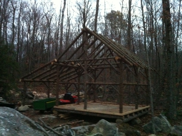

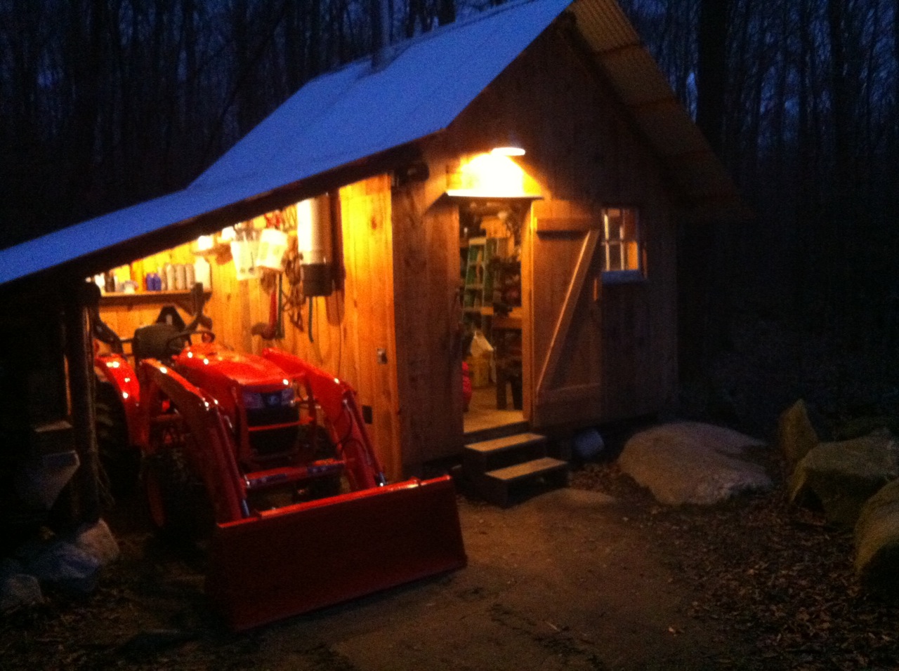

Glassback, I like your shed and lean to, nice. I need a lean to addition like that.
   / My new L3301 #23
Hi ChrisVi Congrats on your new tractor as well!
Yup, mine does the same. I believe it's what you think it is, an electric fuel supply pump that pressurizes the common rail to send fuel to the electronic injectors. I'm sure someone here can tell you if that's exactly right or not.
Thanks coldfingers! I framed it using trees from the property and nailed it together with steel rod. It was a fun build. Should be a pict here if I attached it right:
