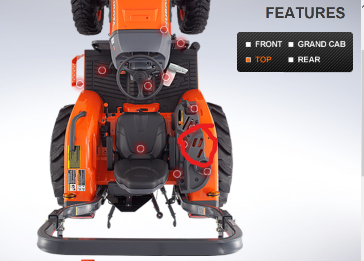

John or Stu,
My dealer said they are currently looking at the instructions for the 3 rear remotes for my l5460.
Here's an excerpt of his email
This is the order of slots. The two parallel slots are positions one and two. Number one being closest to the operator. Position 3 is one above. The rear remotes plug-ins are stacked 1 to 3 from top to bottom. It looks like you can mix and match the remote valves but you can稚, for example, tie lever one to remote plug-in three. They must stay in order.
I can find pics of older rear remote levers, but not on the lxx60 so I am not quite visualizing it esp if levers are different lengths.
This is the only pic I have been able to find (without levers) and I don't remember the details when I was at the dealers. I am guessing the circled area is the new slots for levers.
Since the lever position determines the rear coupler position, my first thought is to put the non floater valve lever (the other two are for floats mostly for TnT) in the position easiest to get to and just deal with the positions of the rear couplers by hose routing.
Are the levers the same length?
Also I guess the operator would normally be turned to the rear a bit so see what is being adjusted so that might affect which lever is the most convenient.
I would guess #1 or maybe #3 would be easiest to operate blindly but without sitting at the machine with the levers installed I don't know what would work out best esp when turned to the rear.
Any suggestions on which you would choose as the easiest lever for you to operate?
edit: the dealer tells me he likes the #3 position the best for the non float rear valve when he sits at the tractor. I guess I'll just go with what he thinks best given they are at that stage and I can't get in there for a day or two to make up my own mind.
