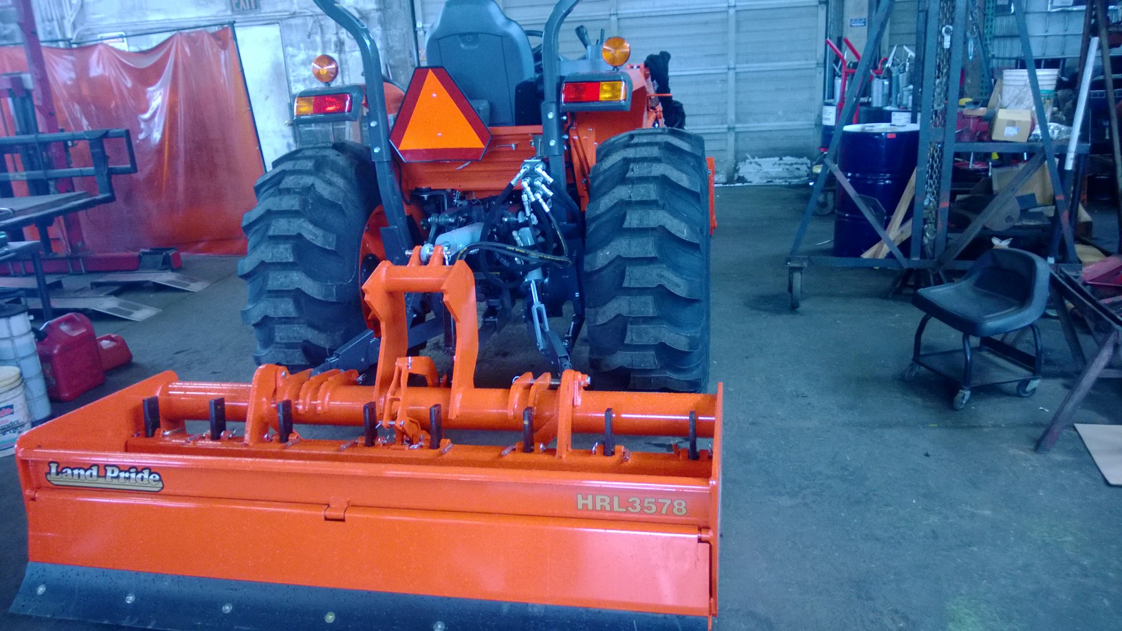

Very nice machine, I think you are really going to love that box scraper.:thumbsup:
   / My new L4060 HSTC pics! #68
I would have preferred black cylinders on the TNT not gray but no biggie of course.
Thanks, I am glad I ponied up for a little more tractor than I had originally aimed for.
And I think I'll love the hydra BB, too. Will be using the heck out of it for quite a while on the new property so it will earn it's keep.
The BB is an expensive booger, but it's pretty impressive in real life.

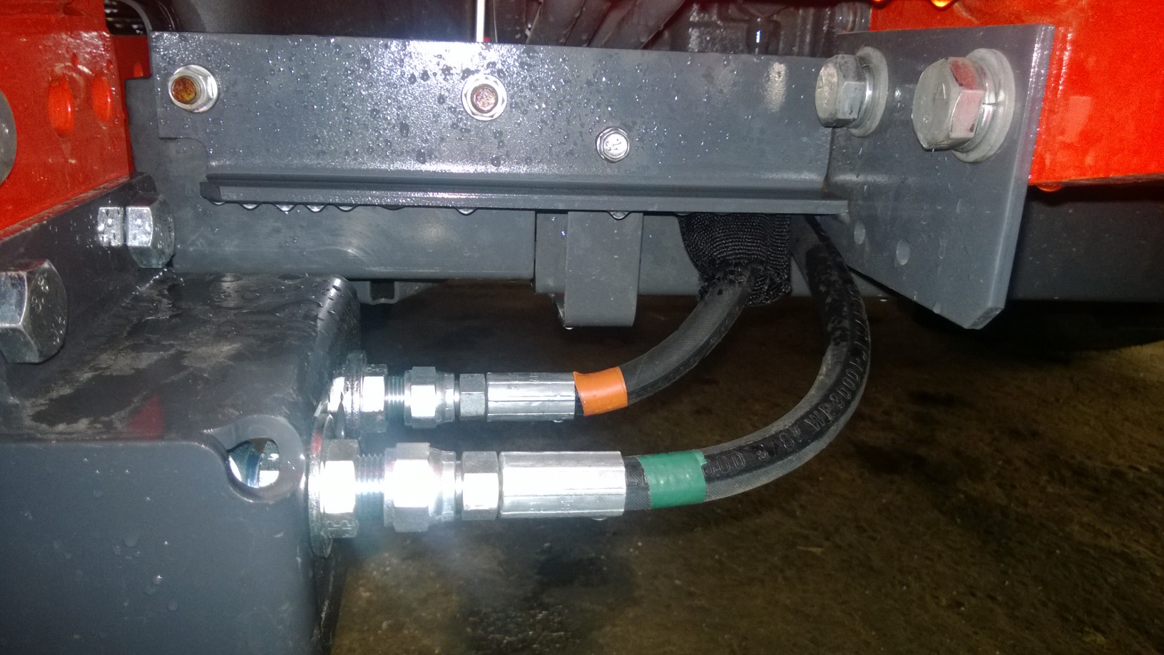

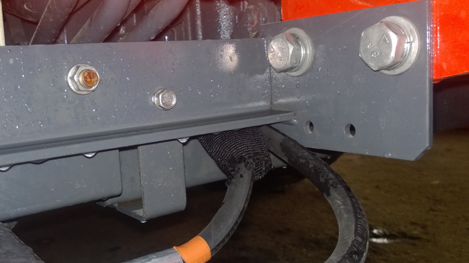

Pic of tractor at dealer this morning. Scheduled for delivery Monday.
second pic (crummy pic, poor light and cellphone) is of 3rd function valve hoses. Dealer is going to try to fab an angle plate that bolts to the "block" where the hard hoses become soft (on left in pic), and over to plate on right that already has a couple holes in it.
That pic looks below the tractor towards the back. John has some better pics, but this one shows the holes in the right bracket.
Third pic a little closer.
So no changes to tractor that cannot be undone. I will report how it goes.

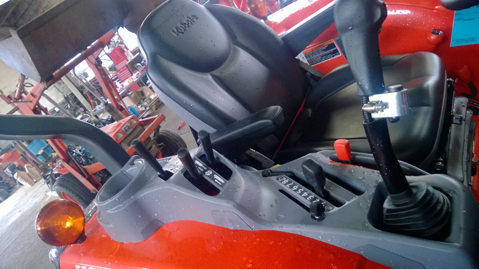

Fourth pic is new third function button. Seems an awkward place for a button, will need to figure out something better. Stu, John, is this where the dealer put your new 3rd function button?
Bill,
That button is just for turning the third function hydraulics on or off. You also have a toggle switch on the inside of the loader lever for actuating the third function. That's how you'll operate an attachment like a Grapple. On mine it's left to open, right to close. A little time and it'll be instinctive.
