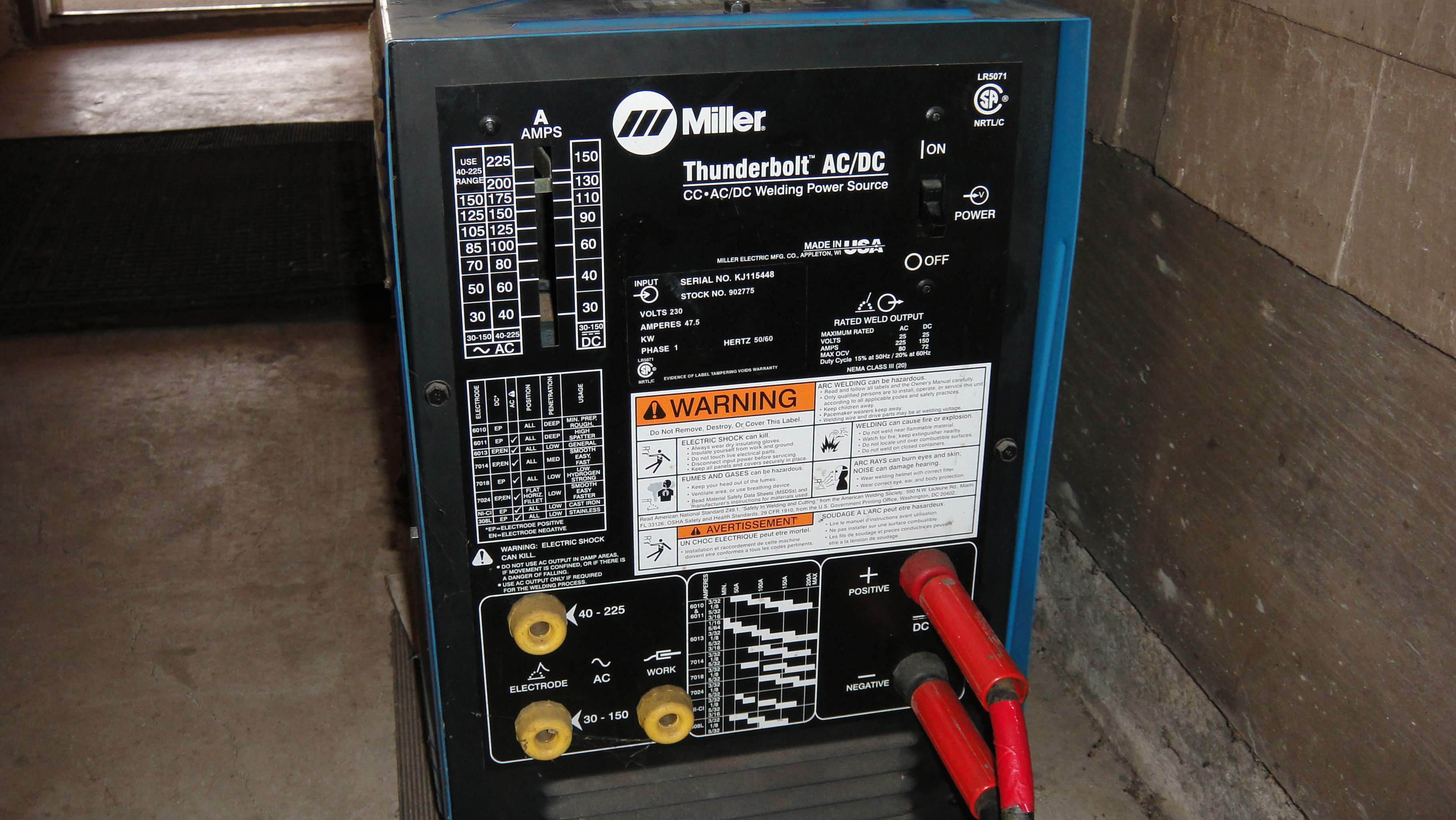

I don't believe it's an inverter, just old school thunderbolt. Not sure what the CC means.
And I stated 170 amps dc, that was wrong obviously, since this machine only goes to 150 dc, I notice I'm usually up there right near the limit, never needed 150 yet, but just below, around 140 amps probably. 3/16" to 1/2"
JB

CC means constant current.
I'd try another brand of rod. And, what little 7014 I've run, it took me about 15-seconds to realize I needed to use more angle to the rod. Just about like 6013, around 30-degrees.

Is it a drag rod like 7018? I will give them another try.
I see by the chart pictured of the front of my welder, that 7014 is listed as med penetration and 7018 as low.
I thought 7018 was the industry standard for structural work ??
