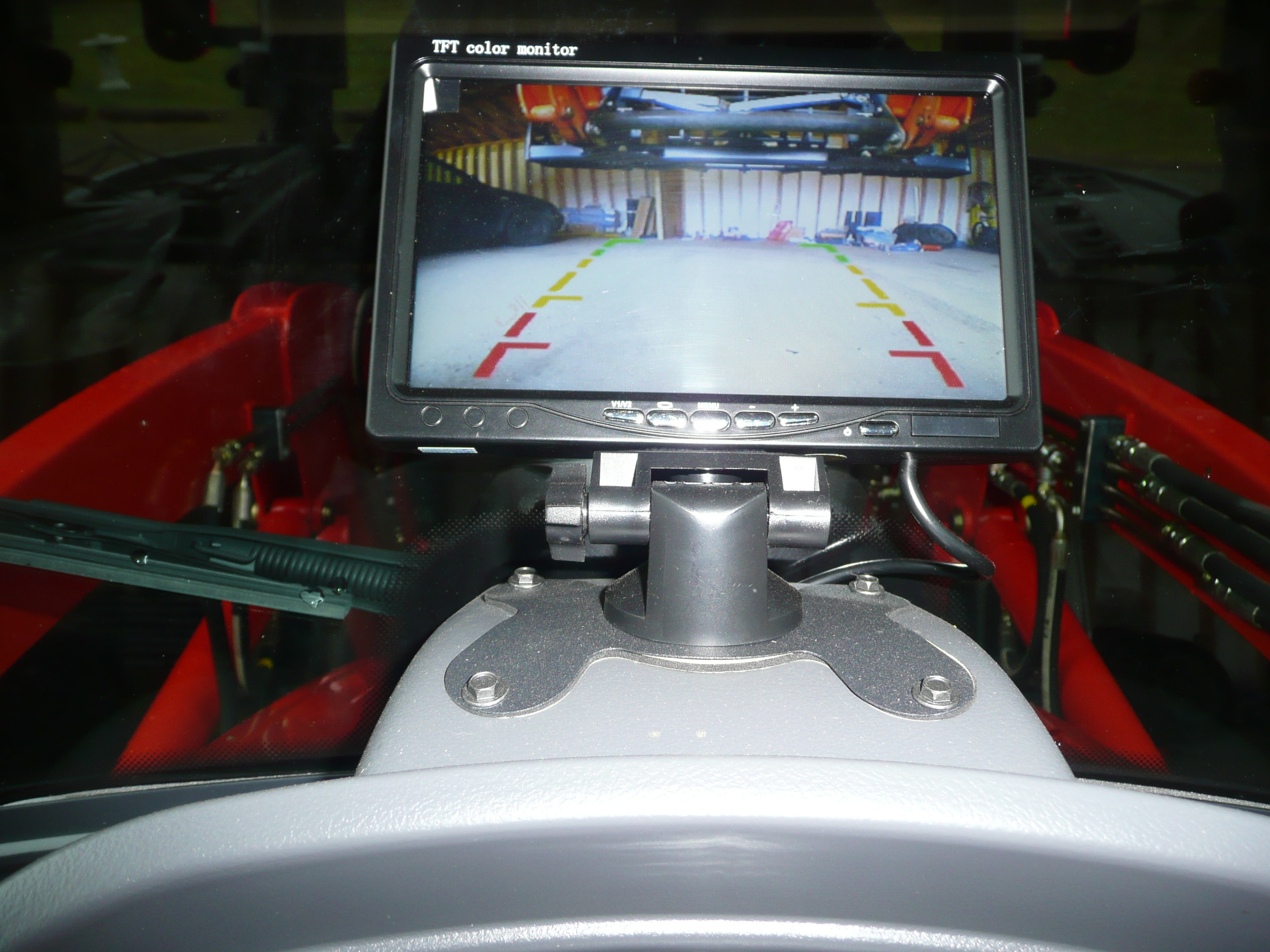

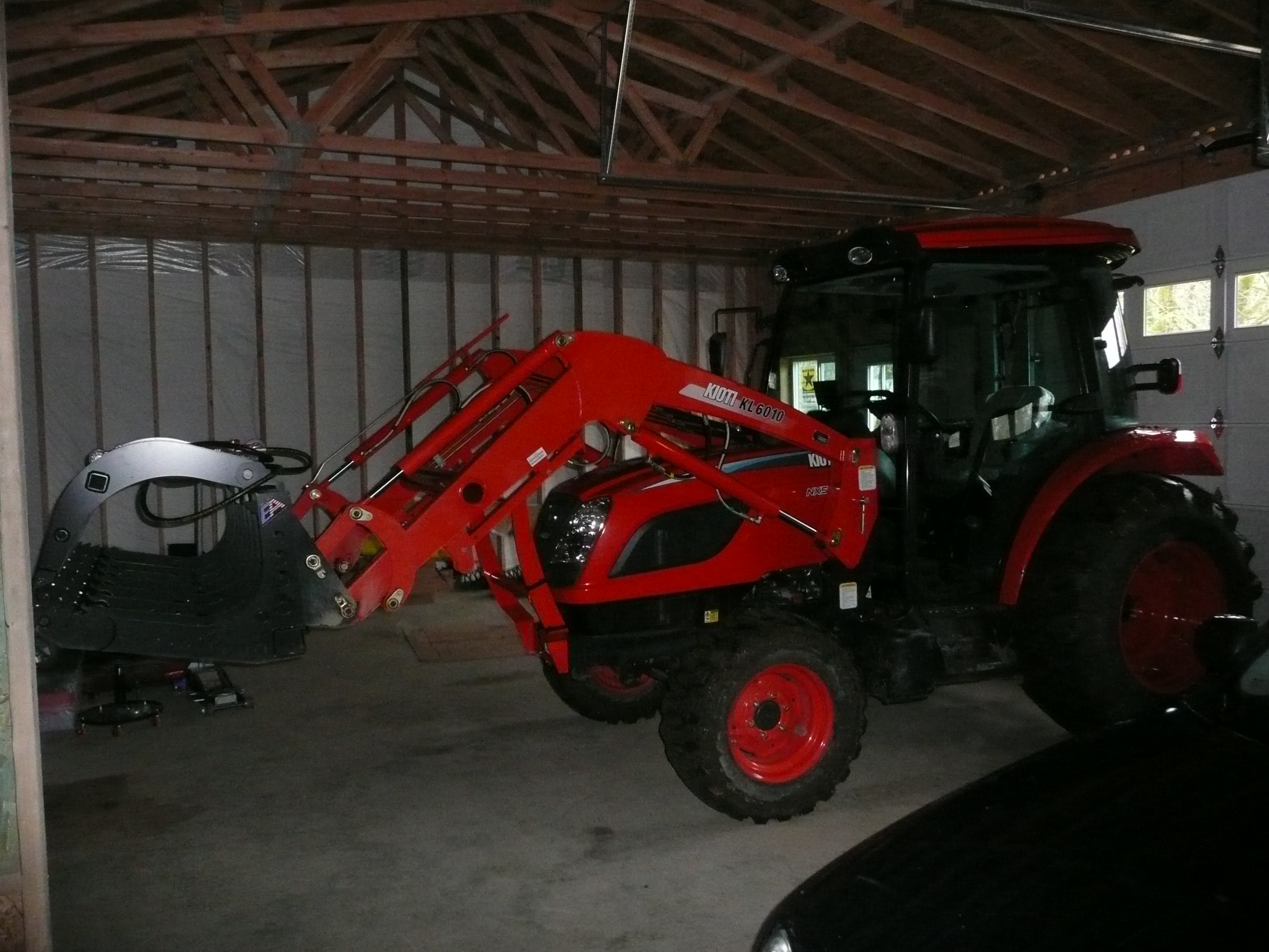

Finally got a chance to start plumbing for the grapple.
This was the first time I've driven the tractor in to the new garage. I thought the view in the monitor looked kind of cool so I took a picture while entering (camera is on a magnetic mount and is attached just under the brush guard's bottom plate):
Picture showing off the side profile of the grapple:
