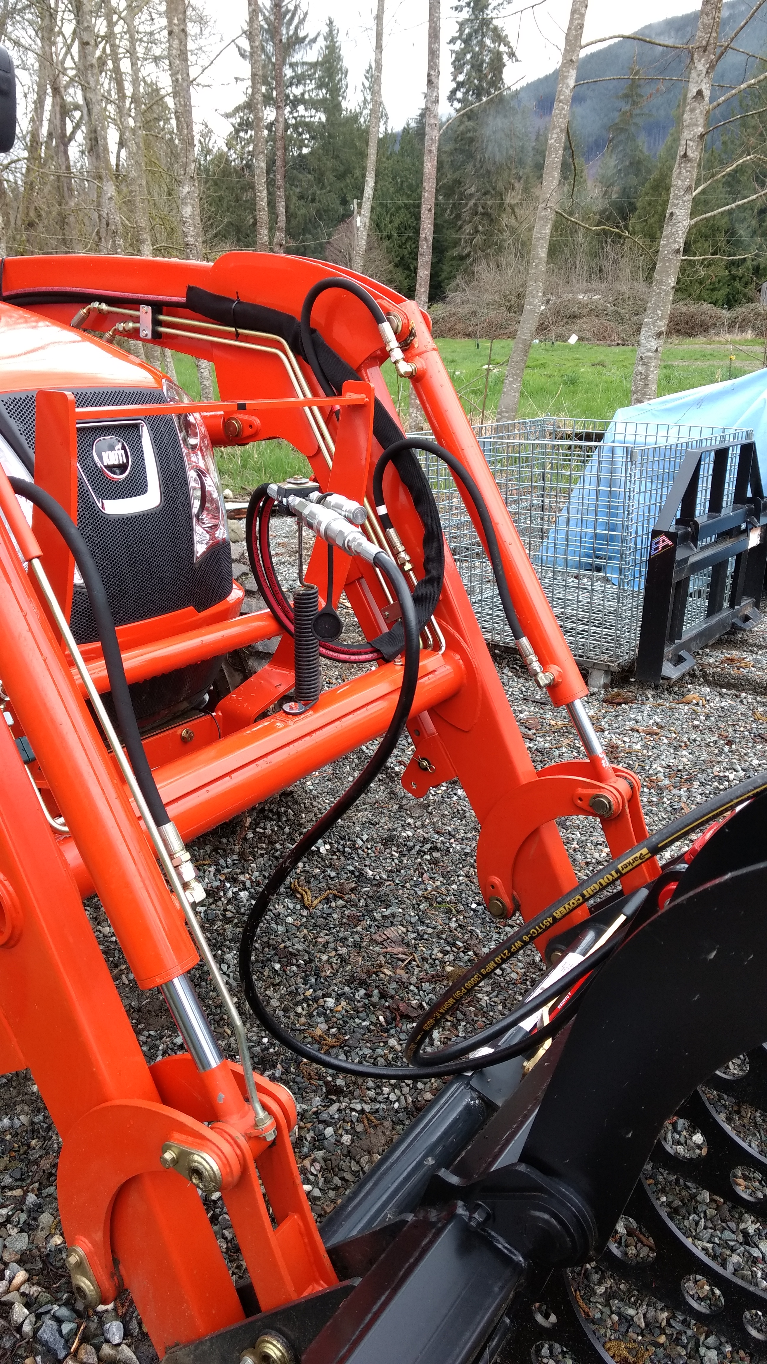

Threepoint, yeah, I need to grab a picture (can't do right now).
I briefly thought about mounting the HS on the grapple but thought that it's supposed to go on the tractor.:confused3: The hoses on the grapple are 1/2" and the HS won't, I don't think, accommodate that size.
The 3/8" hoses from the tractor reach just about 1/2' to and along the torque tube. If I lift the hoses up and hold them above the toque tube (to match the height of the HS) then I can reach a little past mid point on the torque tube/middle of the tractor.
I was aiming only to mount one HS (why I only bought one), but when scratching my head over this earlier today I was wondering whether I should have gotten two of them (and mounted one on the grapple).
There are studs on the torque tube that are for affixing the protective cover (for the hard lines). They are too short to use as is, but I had thought about the possibility of using a rod connector. Not sure if that stud would be sturdy enough. I was kind of angling in this direction but don't think it'll work. Kind of leaves only welding on that mount piece (that comes with the HS): positive is that the cover is readily removable and easy to take to a welding shop.

OK! I corresponded with Jeremy from EA and got some clarification. The two-lid grapples get the hose saver in order to properly protect the hoses coming between the lids. He said that the single lids don't have that issue and that the hose saver should be mounted in the middle of the loader's torque tube. I should use the 3/8" clamp, he says, because you don't have to tighten it down as hard in order to hold: on the 3/8" line I'm sure this is a no-brainer; I'd asked more so for the possibility of clamping the 1/2" hoses coming off the grapple. I'm contemplating on whether I can just drill and bolt to the protective plate of whether to have the stand base welded to that protective plate: I suspect that bolting might be an issue in that the bolt head would either not fit due to the hard lines or that it would possibly rub against the hard lines. It'll likely take me a while to get around to this because I'm juggling a ton of other (higher priority) things right now: I do want to get this loose end tied up!
   / My NX5510H
#214
Got the torque tube piece painted and reinstalled along with the hose saver. Need to play around with how the hoses sit: need to have the hoses run more parallel to the torque tube- have it twisted a bit just to work on things. I have a bulkhead connector adapter in there and that makes things a bit bulky: hose saver is clamping on them. Not sure if l will take them out or whether I'll build an adapter that I'll then use to connect to the hose saver.
I'm not having much success getting the couplers connected. I've done all the normal things to relieve pressure (even loosening up a fitting!), but the female adapter on the grapple side (from EA) just won't cooperate. I have a higher quality female adapter on the tractor side (from Discount Hydraulics) and that one works fine.

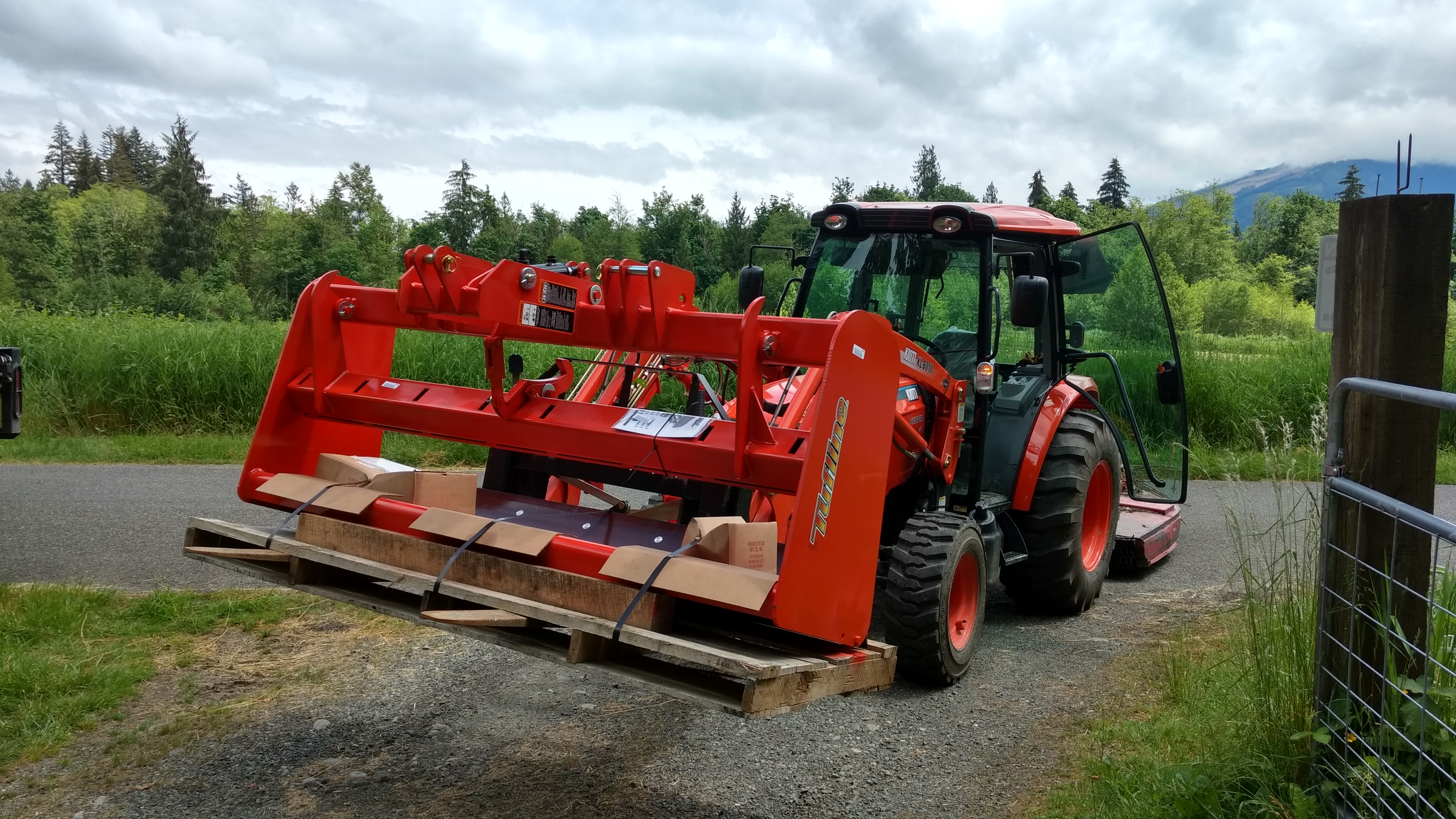

Back in the saddle! Did some mowing with my "new" bush hog, but the tail wheel bracket broke (had been patched, and, apparently, not very well in which case with little strain the thing gave way- currently at the welder's being re-welded/strengthened). Several dry days strung together so I was finally able to get back to hauling material. Here's a shot I took going down the road, monitor viewing the rear is captured:

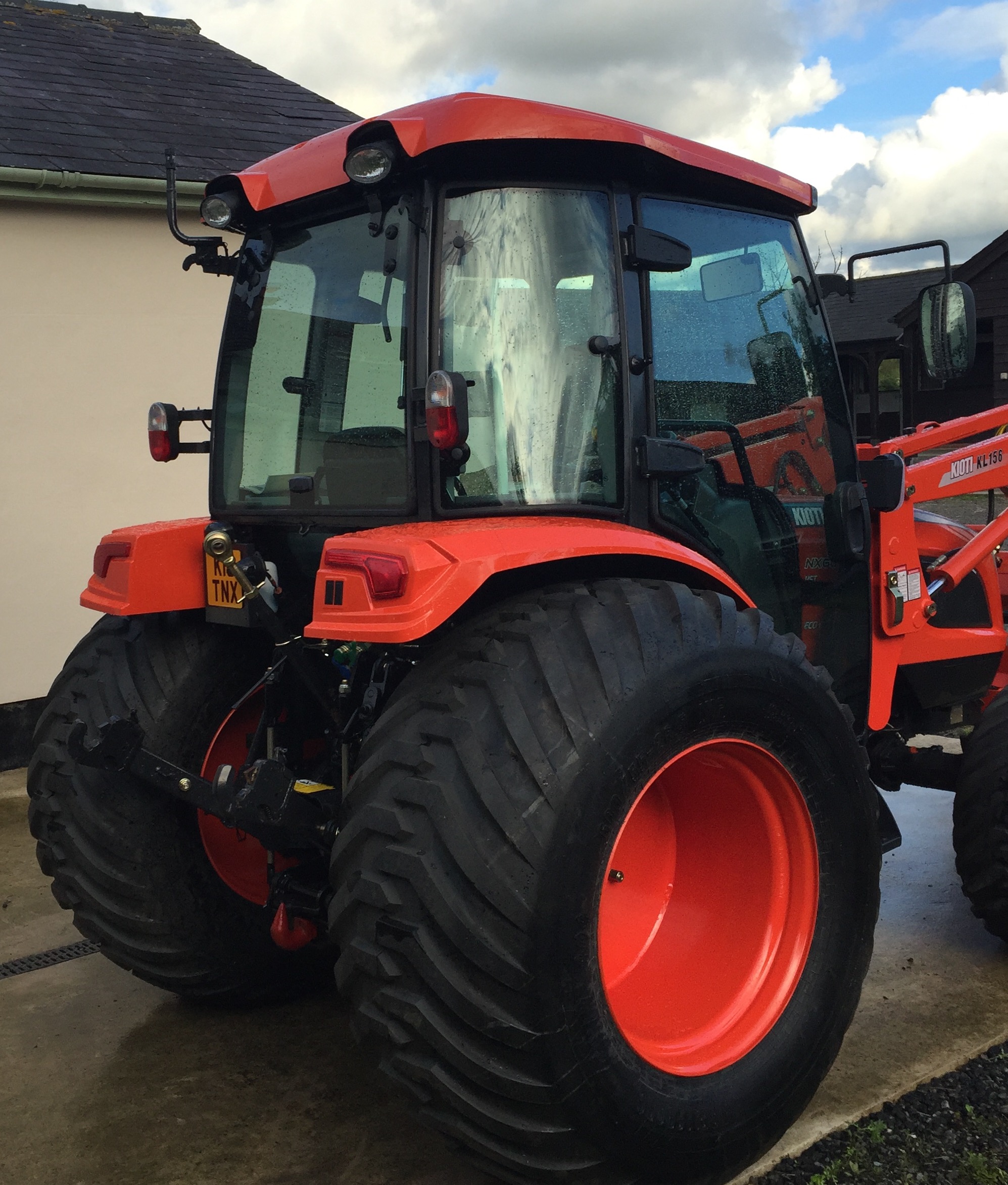

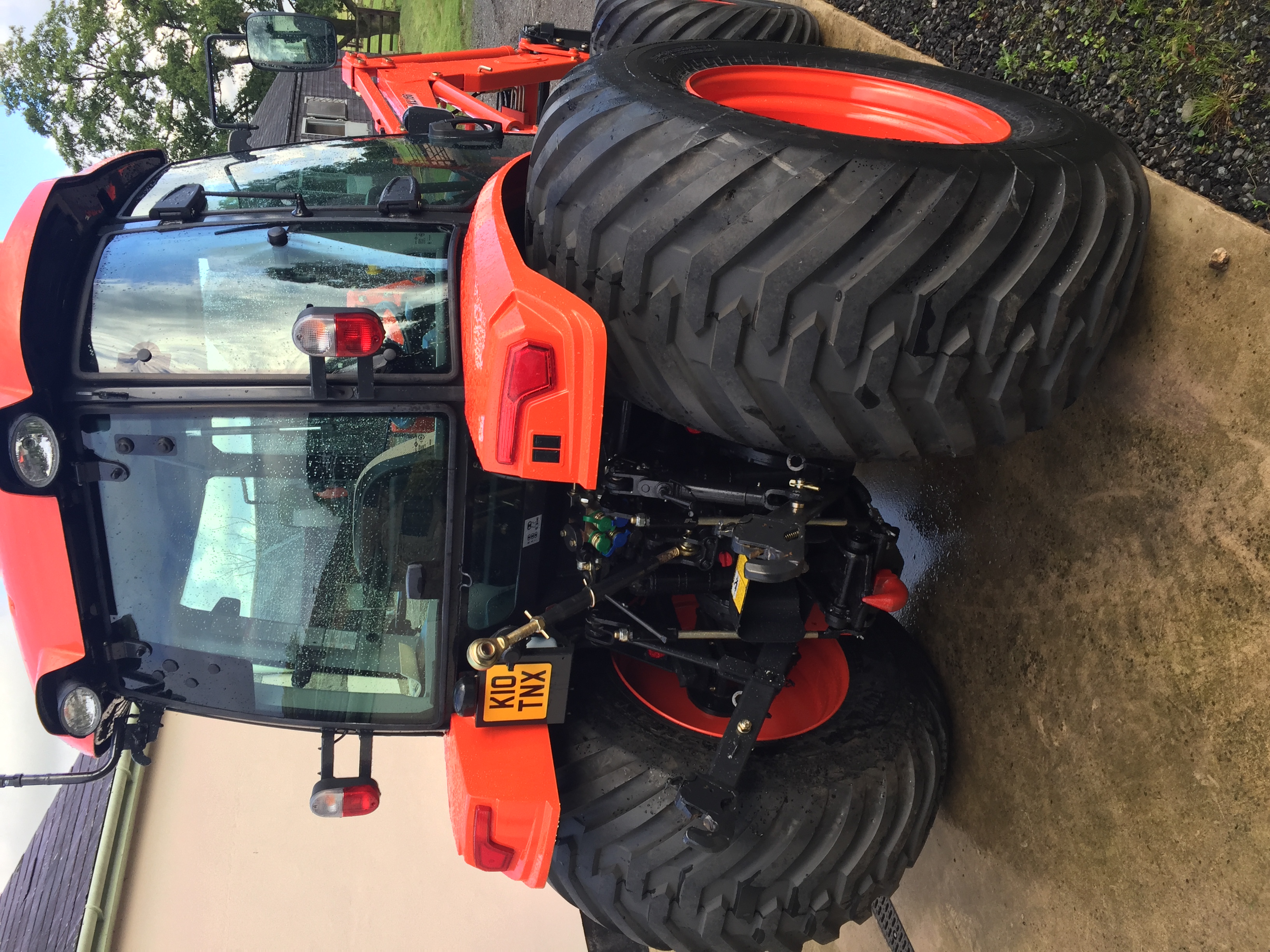

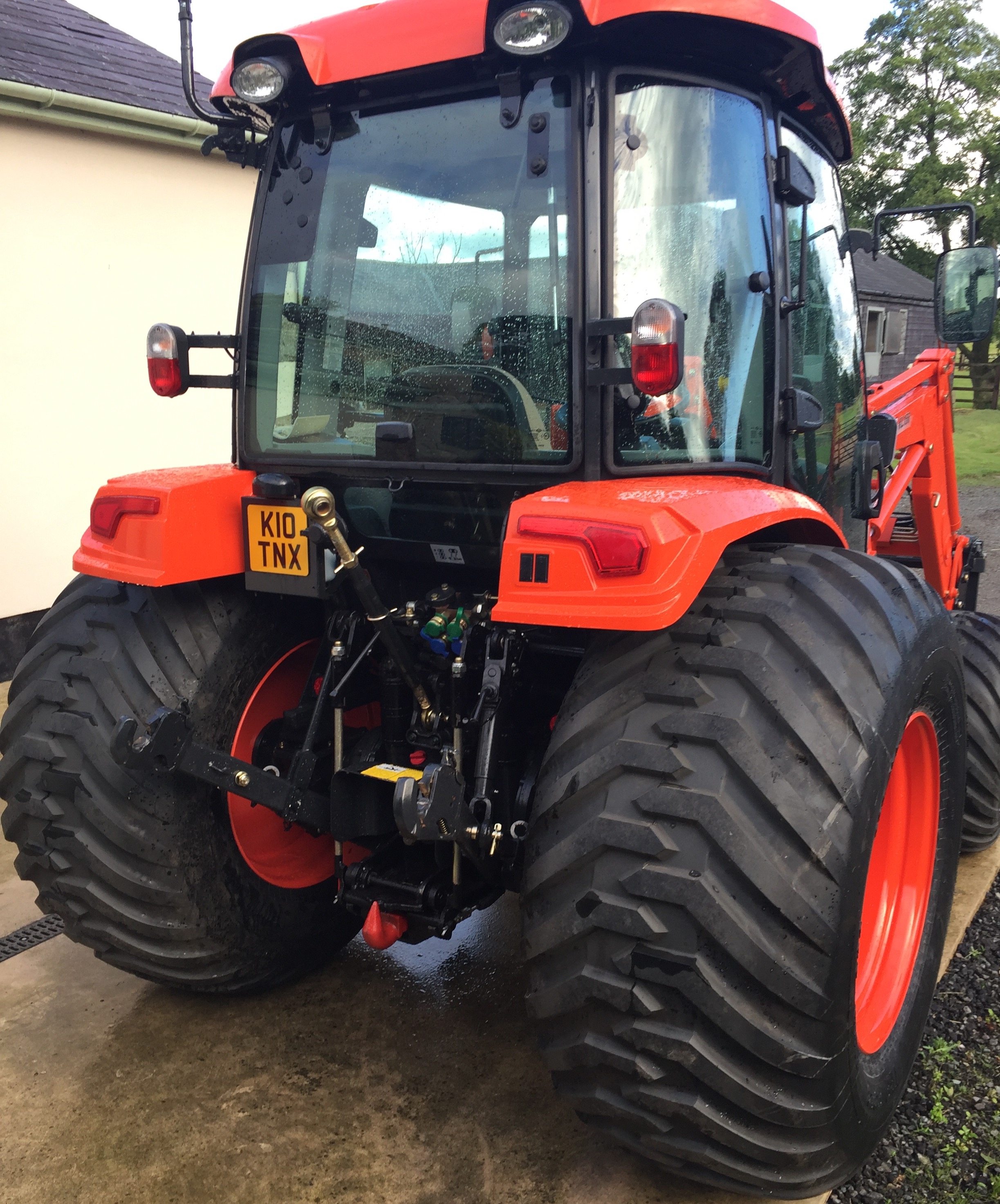

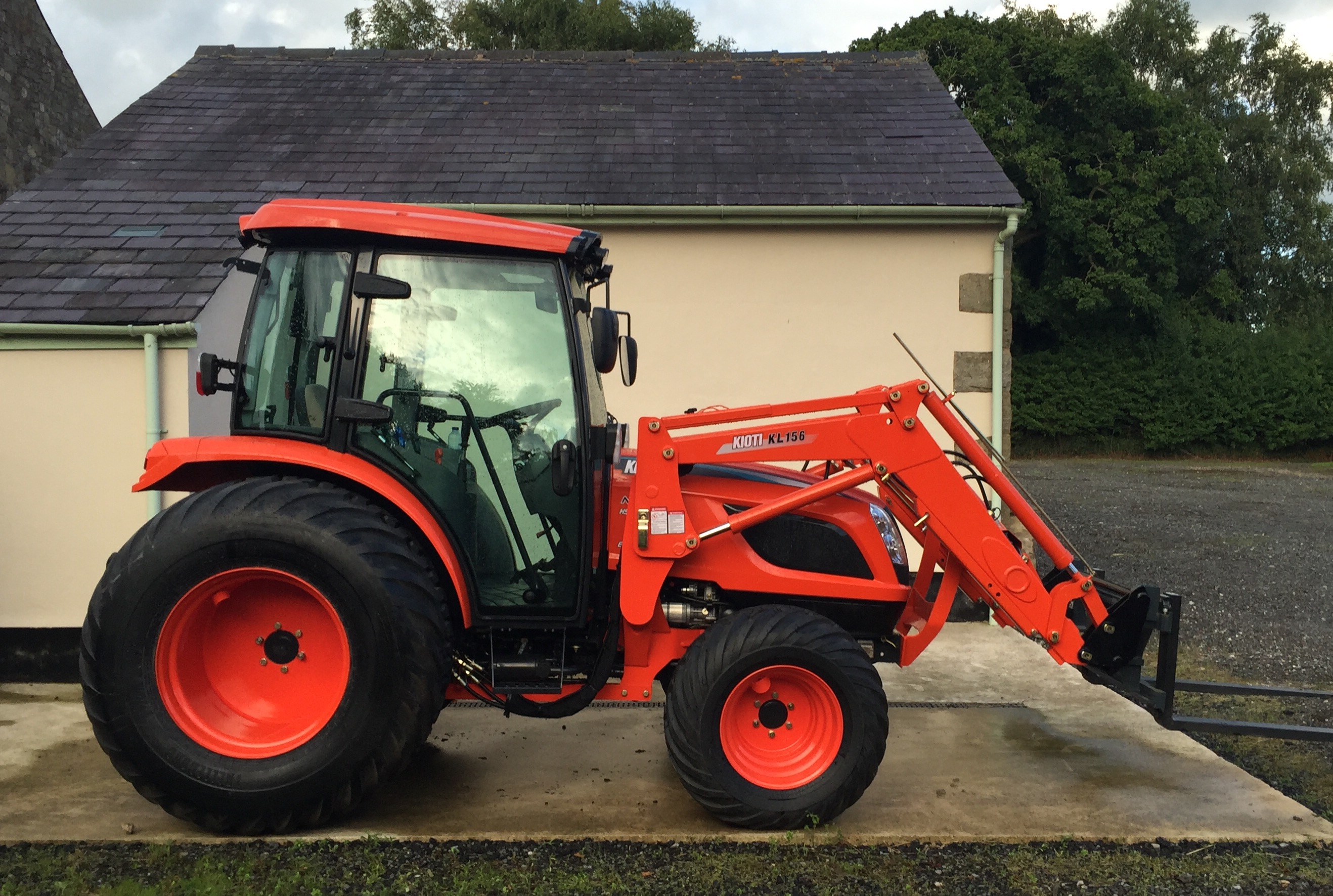

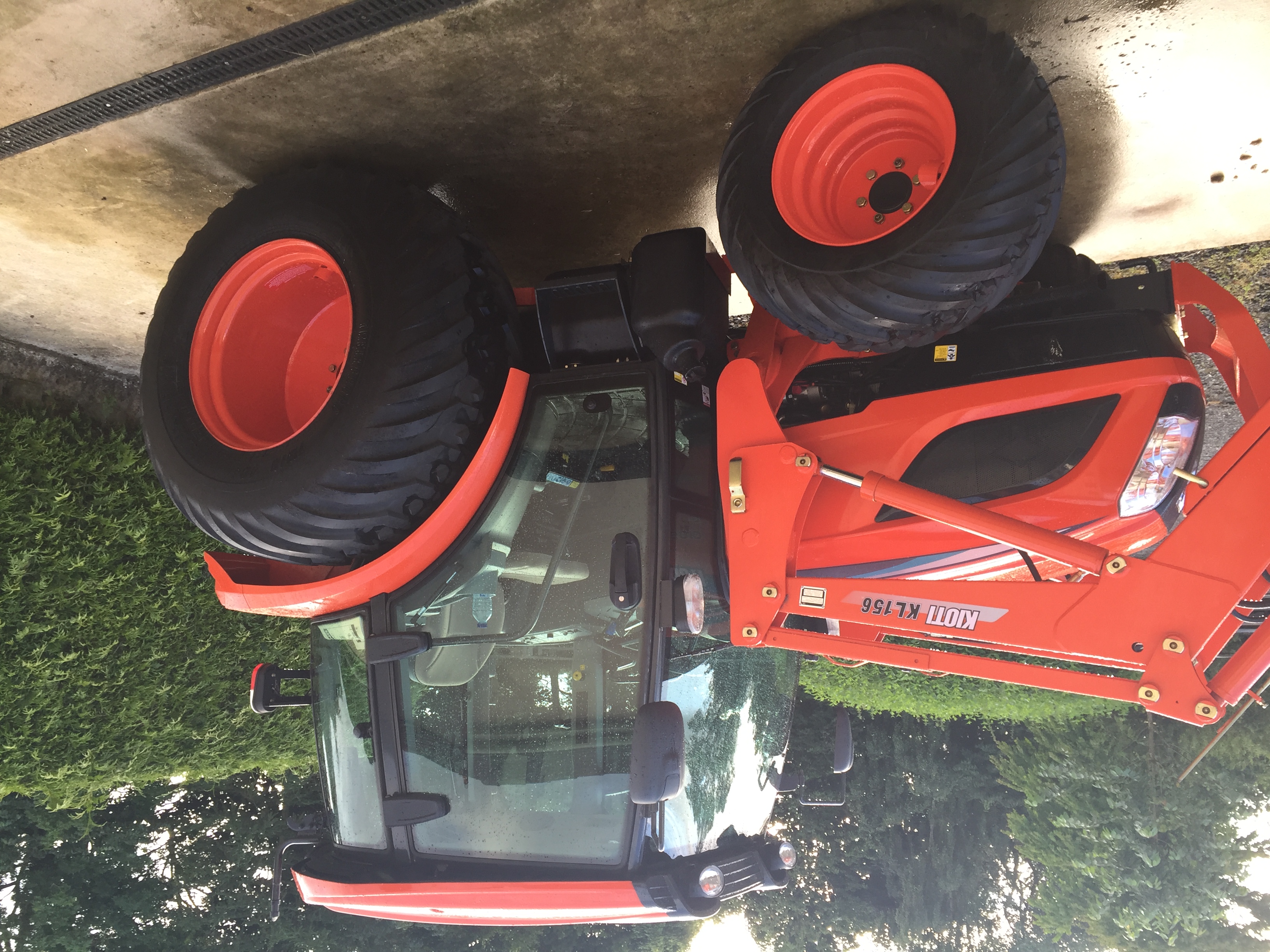

Share a photo of your tires some time.
Just realised I never did this Eric...
Here's four pictures:
Sadly she's not so clean now.. These were taken the day the tractor was delivered..

FINALLY got my box blade!
84" Tufline. I was going to go a bit smaller/narrower, but realized that the wheels were set out on my tractor, in which case with an 84" unit I won't have as much sticking out as I'd initially feared. This, IMO, was the best deal that was out there. Not that I'm banking on it, but this may be QH compatible. The scarifiers are pretty cheap, not replaceable tips. I'm not really digging into a lot of hard ground so maybe they'll hold up: I've only broken one scarifier on my five-footer on the B7800 (my folly).
Might be a while before I get this set up and start using it. Need to focus on getting a new PTO shaft for the bush hog.
