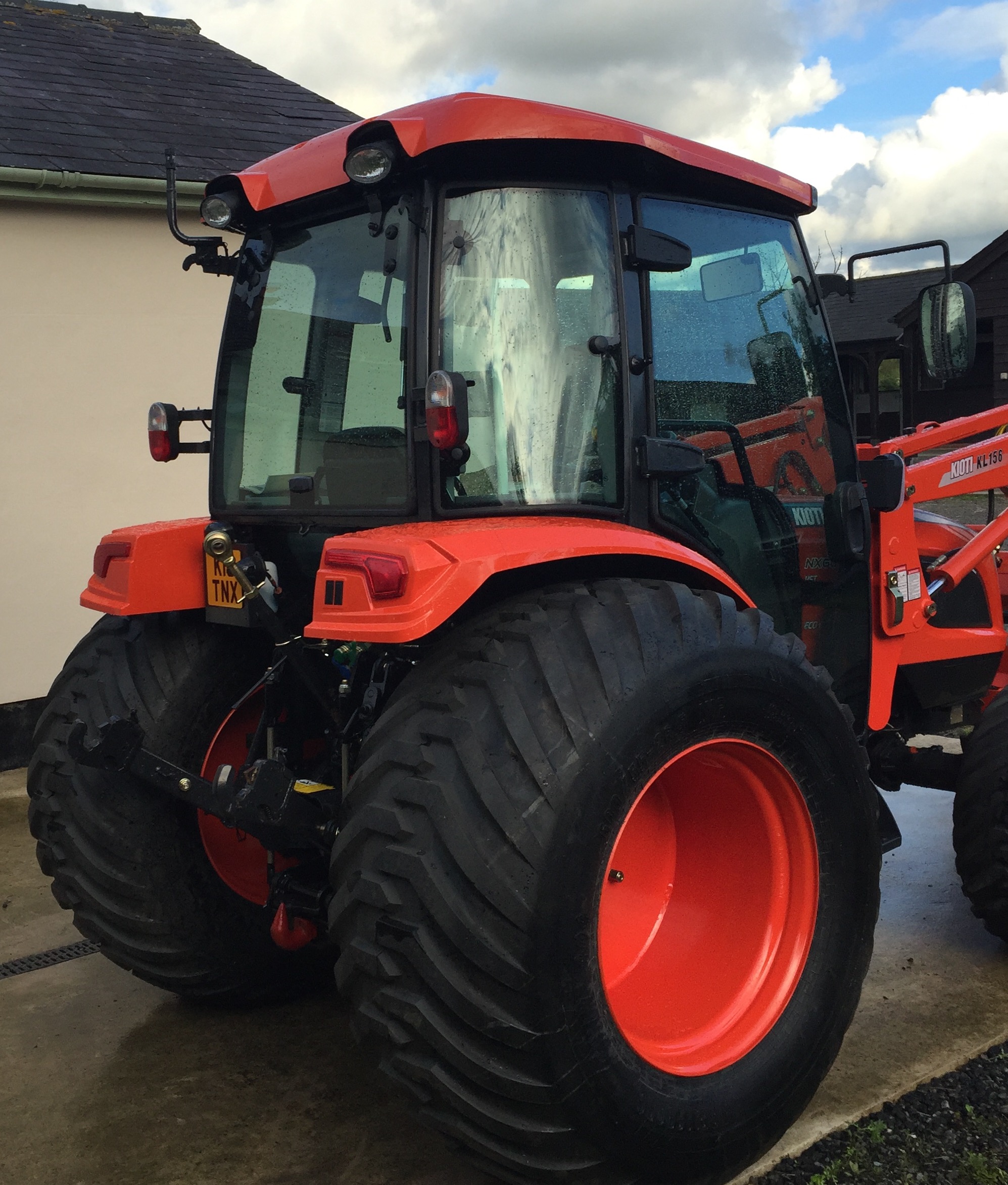

Here's a video of the troublesome door (note the gap at the bottom and that there's no gap at the top; when latched the top is scrunched a bit while the bottom is barely touching the cab frame):
[video]https://www.dropbox.com/s/lv9ck8zh1w8qlaj/VID_20171125_140155755.mp4[/video]
For comparison here's the right side (closes fully via door rail/handle; even gap up and down):
[video]https://www.dropbox.com/s/55kzclpsi1ntz3q/VID_20171125_140240992.mp4[/video]

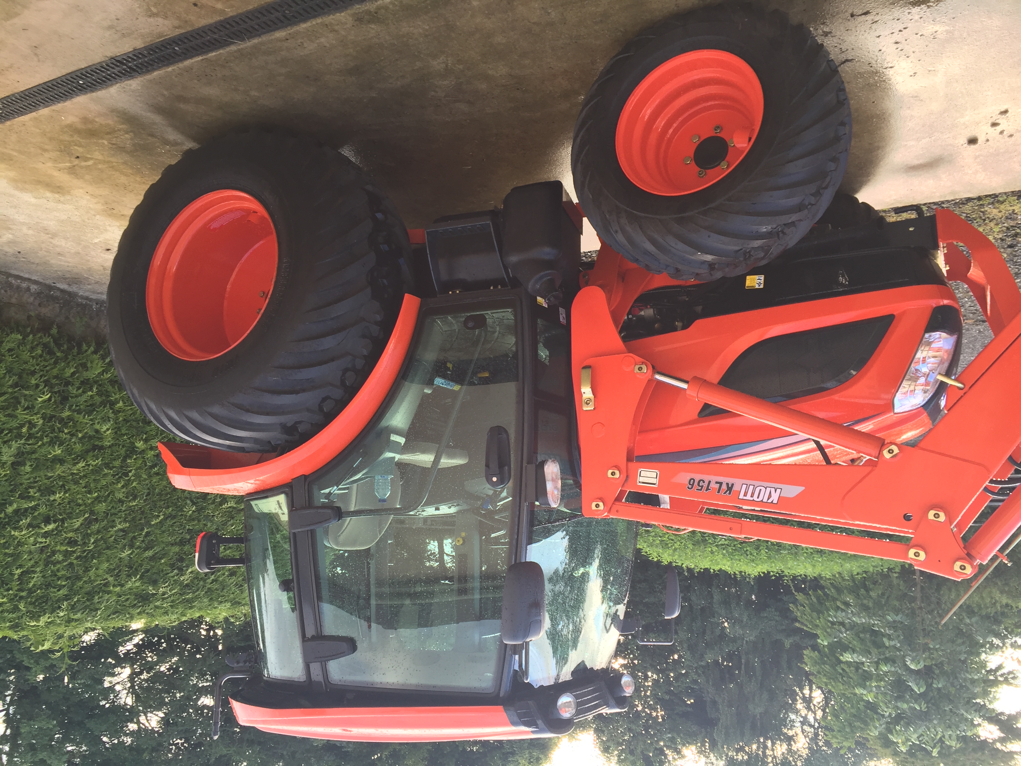

Love the tractor, who makes those tires,do they have a specific name?

An update on the door...
Discovered that the E-clip on the upper hinge pin was missing and that the pin had crept up a bit resulting in a hinge being a bit misaligned. I pushed the pin down and door is a little better, though I believe that there's still some distortion going on: it certainly doesn't close like it did when new. As mentioned, I'm just going to have to live with some of these things.
