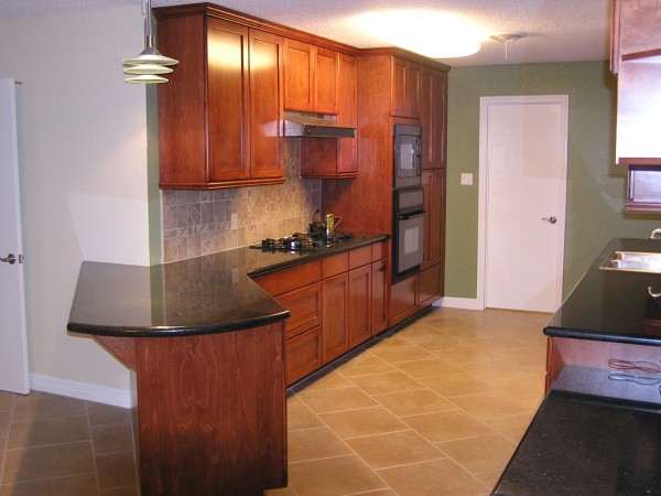

The homeowners helped out and did some stuff themselves. They also made some expensive changes during the build that affected the overall price. Then they found themselves short on cash and had to cut corners on some items that really hurt them. Insualtion in the ceiling isn't what it should be and the shingles are standard 3 tab. Money managment went from free spending at the beginning, to returning $200 door knobs for $50 ones. In the end, we used materials from the surplus stoor that turned out OK, but not what they really wanted. After putting on crown moulding and a few details with tile, it came out pretty good.
I built that house for $65 a foot.

It amazes me the enormous spread that materials can cost. And I'm talking similar types of materials. As I said before, Hardi planking in Colorado is less than half of what it is here and yet 2x8 T&G is less money here.:confused: Just two examples.

Eddie,
I want oak in my kitchen also. Very nice work. I also like the bar supports.:cool:

Eddie,
I liked the kitchen. Do you know the reason that typical cabinets do not go to the ceiling. We are rebuilding our kitchen, will be building custom cabinets, and are questioning why not to build to the ceiling.
I am 6'8", so accessibility is not an issue.
Is there any other reason, except accessibility?
Thanks for y'alls insight.
Chris

Premade wall cabinets come in two heights, 30 inche and 42 inch. The 42 inch cabinets go to the ceiling on a home with 8foot walls. The thing is that there is 18 inches from the top of the counter to the bottom of the wall cabinet. On custom jobs, there are no rules.
The most common reason that I hear for 30 inch cabinets over 42 inch models is that the top of the cabinet never gets used. The bigger cabinets cost a little more too. Back in California, where I'm from, 42 inch was more common, but here in Texas, it's 30 inch. Maybe it's a regional thing, but the smaller cabinets make the kitchen look bigger. It also creates a display area above he cabinet.
Eddie

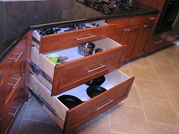

Had to rebuild ours recently due to flood ....I designed the new cabinets and had a guy build 'em then helped him do the install. Note the size of the pot drawers and just to the left of them - deep towel drawers.
