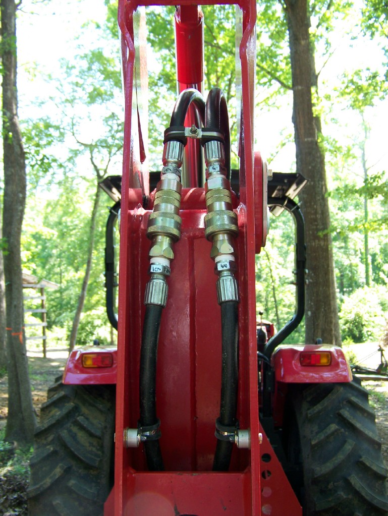

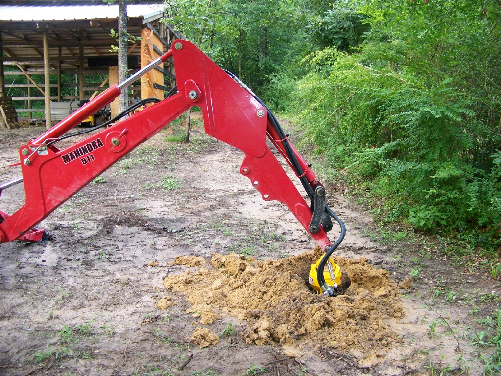

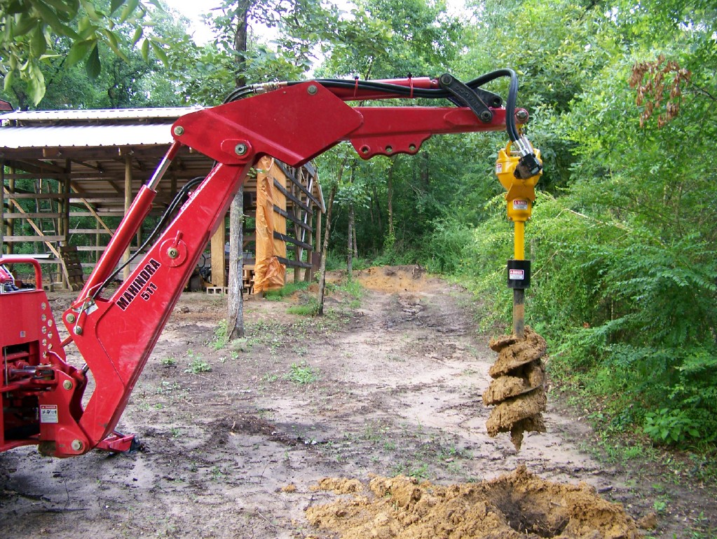

I'm very interested in this PHD you set up. Anymore info ?
bindian said:
I got a Danuser Hydrulic PHD that I modified to fit on my new backhoe.
   / My pole barn...a solo affair
#35
Willl said:
Awesome looking barn Brandi.
Will,
Thanks for the barn comment. :) I would be glad to explain my PHD. :D I modified the swivel knuckle that came with the PHD to fit my BH where the bucket attaches. I installed quick disconnects on the bucket cylinder lines. I remove the bucket and mount the swivel knuckle and motor, then hook up the auger bit. Then I can use the BH's bucket curl lever to run the auger in forward or reverse from the seat. :cool: It came with a 9 & 12 inch auger and an auger extension for around $1800. The welding and machine work on the swivel knuckle was about $130. The line cutting and swaging fittings was around $20. The quick disconnects came from Grainer and cost around $56. I went with these as they were way better quality over what TSC had on hand.
Hopefully next time I post photos, it will be from Photobucket.;)
hugs, Brandi

Now that I've got that off my chest, that PHD mod is great. I wish I'd thought of that a bunch of years ago when I punched a few hundred holes in my old place. The normal PHD I used tried to kill me on a daily basis & I don't think any of the holes were exactly where I wanted them or particularly straight either...

I'm very impressed with your post hole digger. If I had it to do all over again, hydraulic is the only way to go, and attaching it to your hoe stick is brilliant. I've seen them on trackhoes, but never thought about doing the same thing on a backhoe.
Thanks for posting the pictures of it. I LIKE IT ALLOT!!!

Does the PHD dangle while your transporting? Or can it be folded up against the arm?

Okay, I'm flattered. :) ;) The PHD as it gets deeper, wants to angle a little. But a little wiggle of the control lever and it is straight. Unlike a 3PH digger that requires you moving the tractor. I used to rebuild wrecked helicopters. :cool: I made all kinds of sheetmetal parts for them.

The auger can be laid almost flat on the floor of the trailer. It would lay flat if I would have added more distance where the swivel knuckle was welded up. It just hangs and swivels when the tractor is moving. It has a heavy spring that helps, but the weight of the 12 auger stops a lot of swing. It plumbs by itself when the tractor is not moving. :cool:
