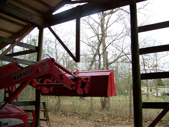

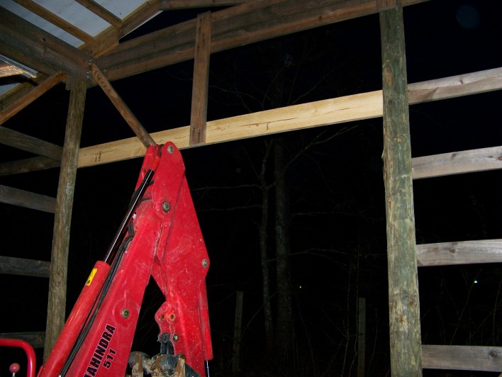

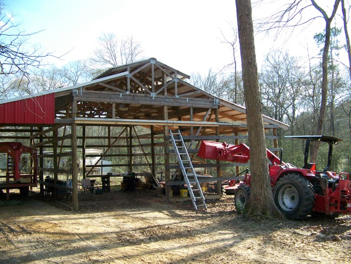

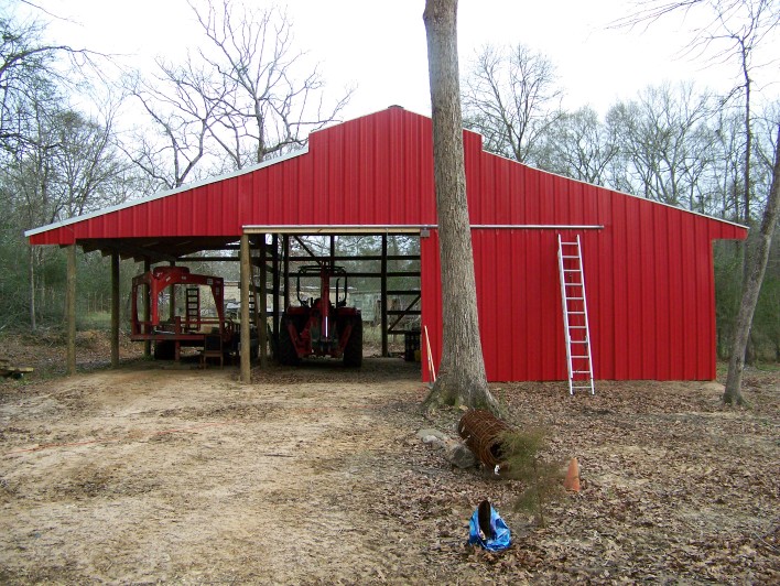

After almost a year of not working on the barn:( to allow my finger, hand and elbow to heal from surgery:eek:, I started installing the siding and door rails.:) I took a week off to go to the World Ag. Expo in Tulare, CA., but instead I stayed home to work on the barn.:cool: Here are the latest photos. The first one shows the 24 feet of door rails installed. The 2nd photo shows my invaluable Big RED Beast help mate and elevator/work platform. The 3rd photo shows all the siding minus the trim on the front side of the barn. The 4th and 5th photos show the back door header being raised (for the canopy) so I can drive the Mahindra all the way thru. It will be doubled up 2x8s for the 20 feet of sliding door rail.

   / My pole barn...a solo affair #58
Brandi,
Good to hear your back to working on your barn!!!!!!! It's looking awesome and will only get better with all that siding on it.
I'm looking forward to seeing your pictures and following your progress.
Eddie

Nice looking barn Brandi.
I do have one question though. What ever happened to the old Ford 3055?
