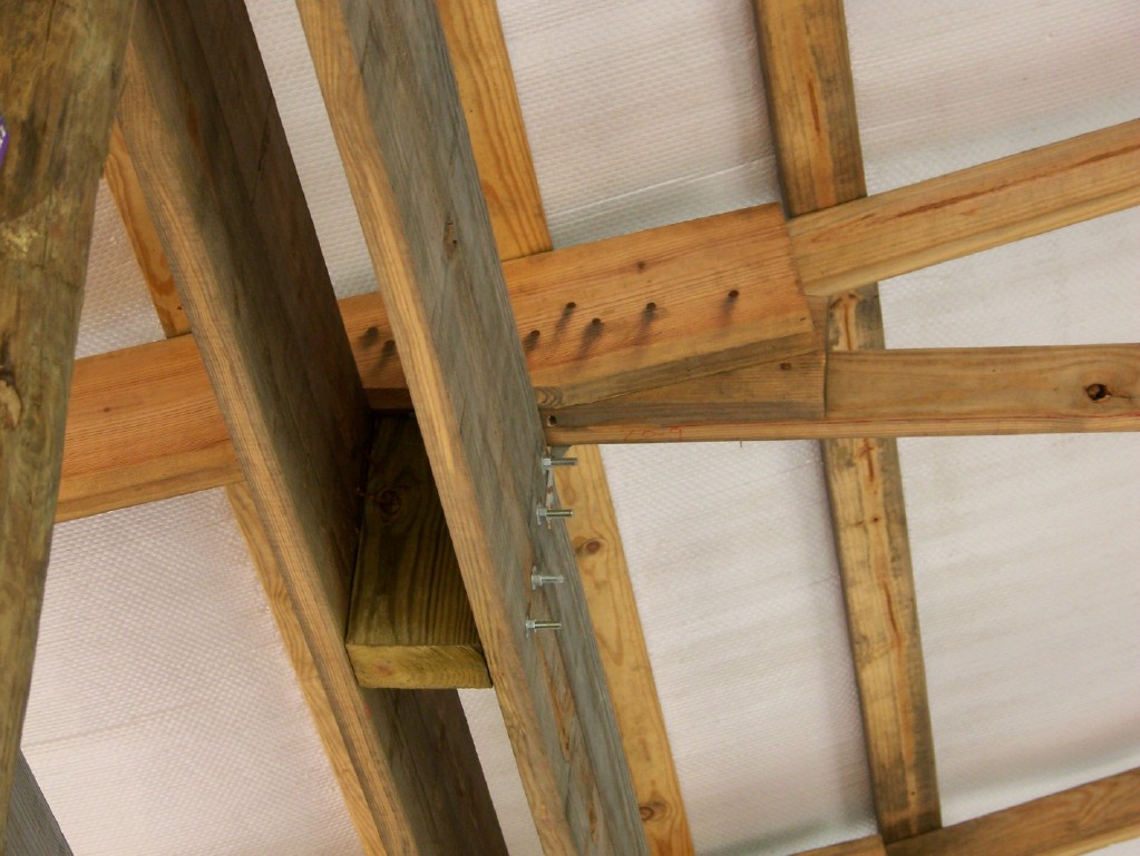

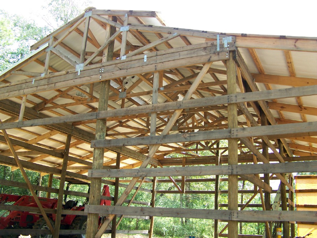

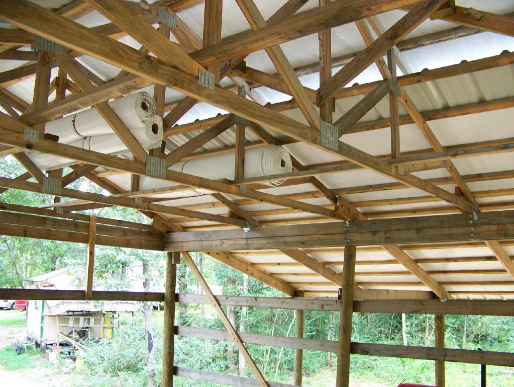

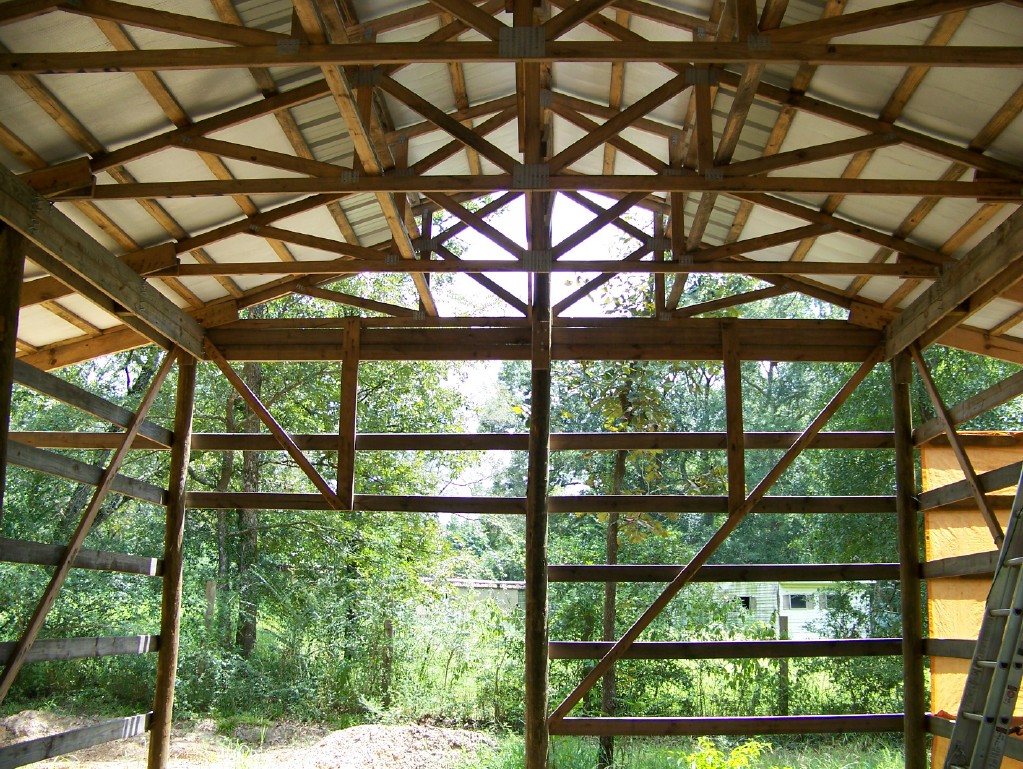

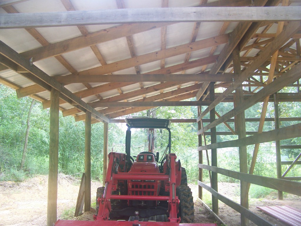

I took some inside photos of my barn today. I almost forgot. :eek: The first photo shows the 12 foot wide trailer or tractor shed. The second photo shows the shed rafters tying into the truss. The 3rd photo is best I could take of the trusses. The 4th shows the end truss with the vent. The 5th is of the beam detail with 4x6 spacer. The last photo is up inside near the bottom of the truss. :)

Thanks for those photos, Brandi. In looking at your construction, it's sure obvious that the header at the top of your poles is not going anywhere. You shot nails to hold it in place and then came back and put carriage bolts all the way through with nuts. I think most construction would have just used lagbolts, but you took the time to go the extra bit. The structure looks overbuilt and that's great for strength in windstorms.:)
Theres a lot of detail that isn't obvious until you study your pictures a bit. I like the way you tied the trusses together too. Also, you can go back and add screen, louvers, or even vents that could be opened in the summer and closed down in the winter if needed.
When you do your slab, are you going to put down poly to keep moisture down? I've come to appreciate just how much moisture moves up through concrete if you don't. Anything metal will rust quickly if you lay it on a concrete floor that doesn't have a moisture barrier under it. At least that is what I've found in my garage at my house. I didn't seal it with poly before pouring the slab and now I sure wish I had.
Thanks again for the pictures.:cool:

I blame it all on my Dad. :) He taught it all to me. :D He was an Aggie. He made a portable picnic table out of 2 X 12s. Oh yeah, I will be adding the moisture barrier. I used to work in a hangar in the late 70s that didn't have a moisture barrier in the concrete. It sweated so bad, if our electric screwdrivers had a nick in the cord...we would get a shock. :eek:
hugs, Brandi

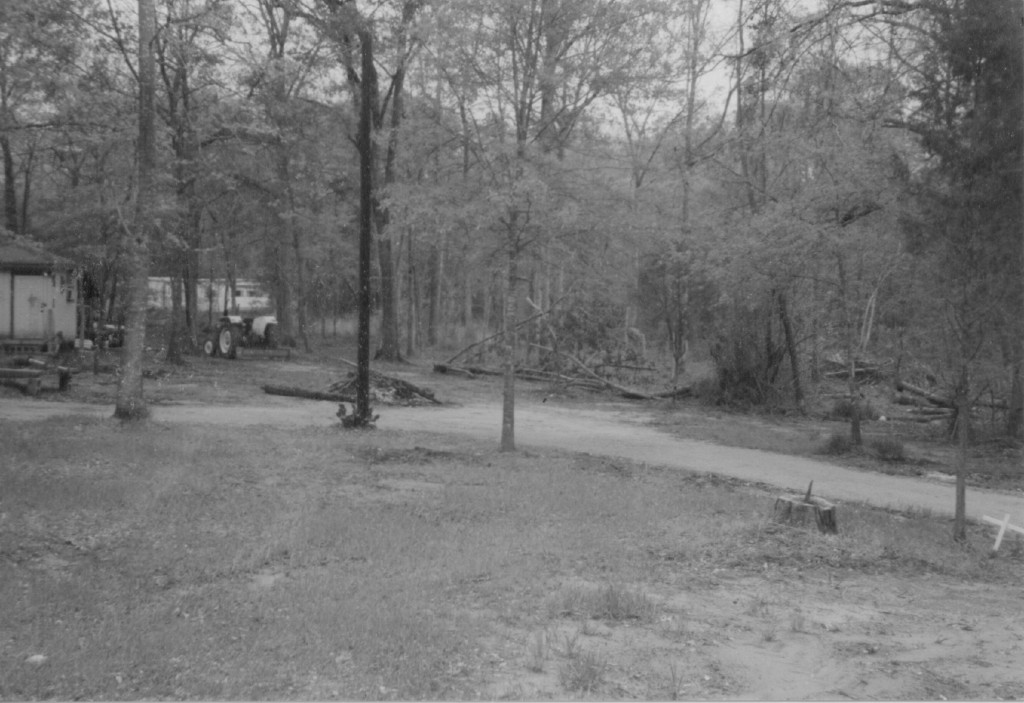

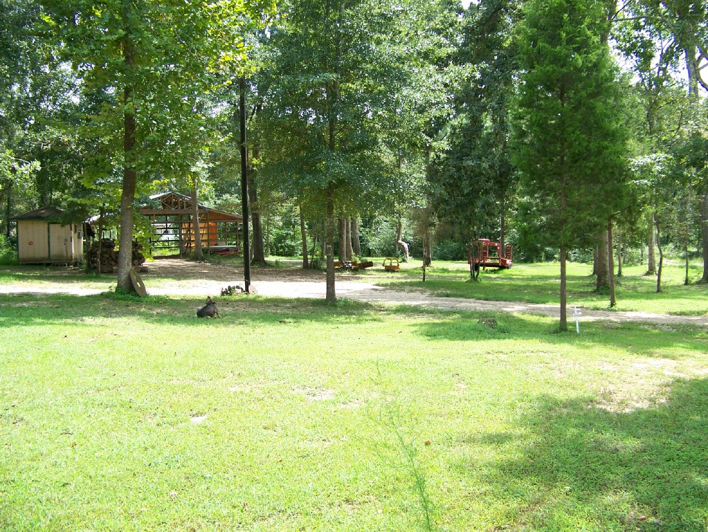

Here are two photos, before and after. What the land looked like after the loggers left their mess and what it looks like with the barn now. That is a Ford 3055 with a KK 6 ft BB in the before photo. She was 54 horsepower. An awesome tractor for 2WD, no FEL and armstrong power steering.:)
hugs, Brandi
