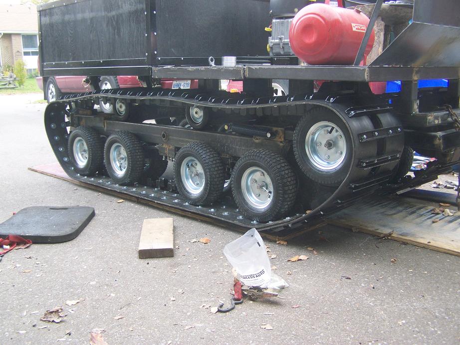

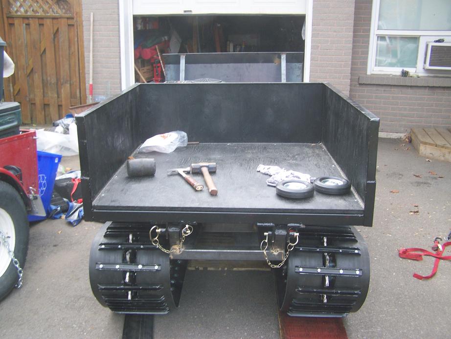

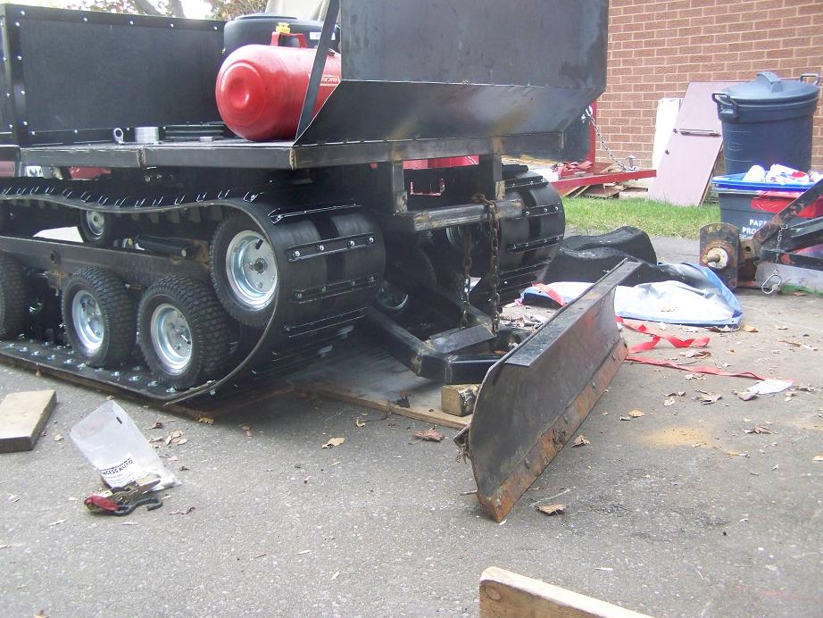

#117
Okay, mocking up the idlers so had to put the tracks on. Determined that my track tensioners are not strong enough. Afraid stronger ones will require beefing up the front wheels.
