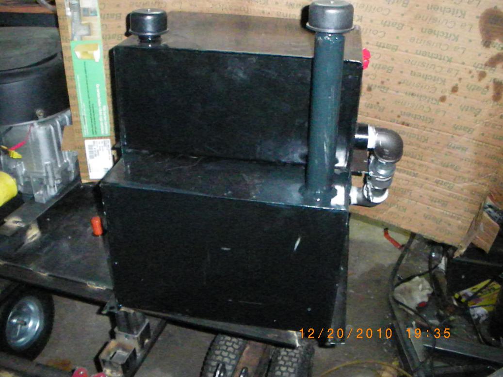

Hoping to speed things up while I have some time off over the Holidays. Heeding the Hydraulics advise but not wanting to go as far as carrying 400lbs of Hydraulic fluid, I have mated a 5 gallon and 10 gallon tank together. With the weight of tank this will still add 200 lbs. I extended the vent so will have two vents. Also I took a 7 gallon portable air tank and converted into a gas tank. When I noticed that the tank had a 2003 expiry date (probably had it for 20 years) the deal was sealed. It turns out that there was zero rust in the tank and should be a good strong unit.
