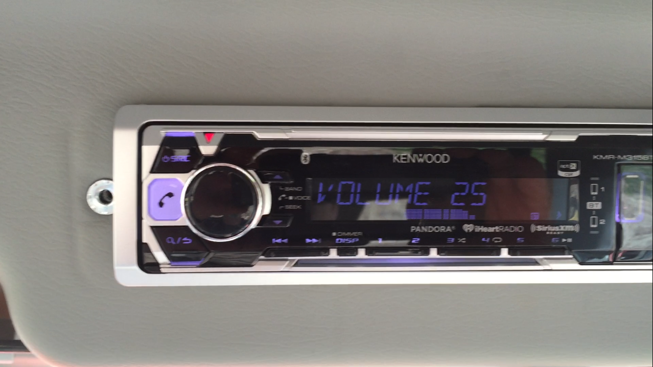

It was too wet today to do very much, so I went to Crutchfield and picked up a stereo and an Adapter. Since my wife has more seat time in the tractor than me and probably will for a while, It is her Mother's day gift. She loves her music. It wasn't hard to put in with the two piece screw caps they have although, I would describe the metal sleeve that came with the Kenwood marine radio I bought, as flimsy. It works well and sounds pretty good with the stock speakers.

That's my next addition, a radio. Would you know what type of adapter is needed? Would it fit other radio brands also ?

BlueToy, the part number for the radio adapter is 70-7712. The brand is Metra
Metra 7-7712 Receiver Wiring Harness Connect a new car stereo in select 1995-24 Acura, Honda, and Isuzu vehicles at Crutchfield.com
It fit perfectly. total installation time for me, sitting in my truck to wire in the harness, then moving to the tractor was about an hour and 20 minutes.

Thank you, for the link to the connector. I was hoping it would be a simple plug in and done, did you plug it into the radio and then have to wire it up to the factory harness? I've never put in a radio before, but with the proper schematic, I'd give it a try.
You wire the colors on the harness to the colors on the radio the just snap the connector into the connector in the tractor. It is quite easy. There will be 2 wires on the harmess that don't get used. I put wire nuts on them just to keep them covered. But the connectors in the tractor side of the clip Probly didn't make contact with those anyway. Putting the thin metal sleeve into to opening was the biggest difficulty as mine was a little flimsy.
