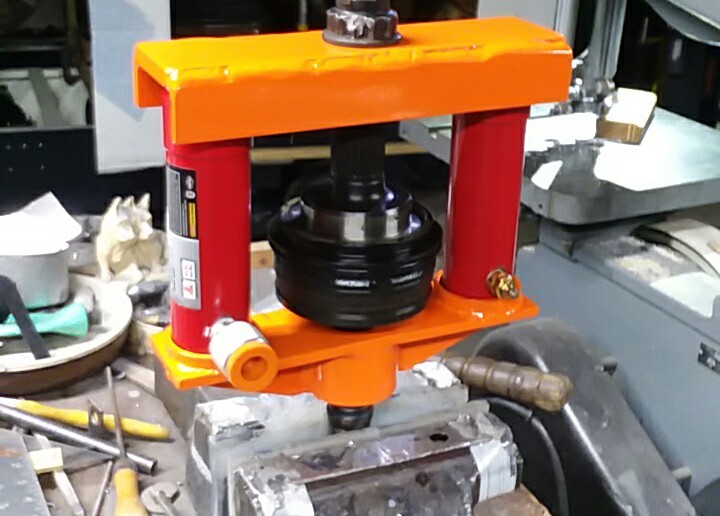

In other developments, I could not get the outboard CV joint apart. I feel I need to so I can check trueness in my lathe when I weld the shortened halves together. A vendor who specializes in rebuilt and custom axles says they will come apart grudgingly. I built the following mini press to pull it apart. I'm waiting for the HP hoses and fittings so I can connect it to my Porta-Power.
