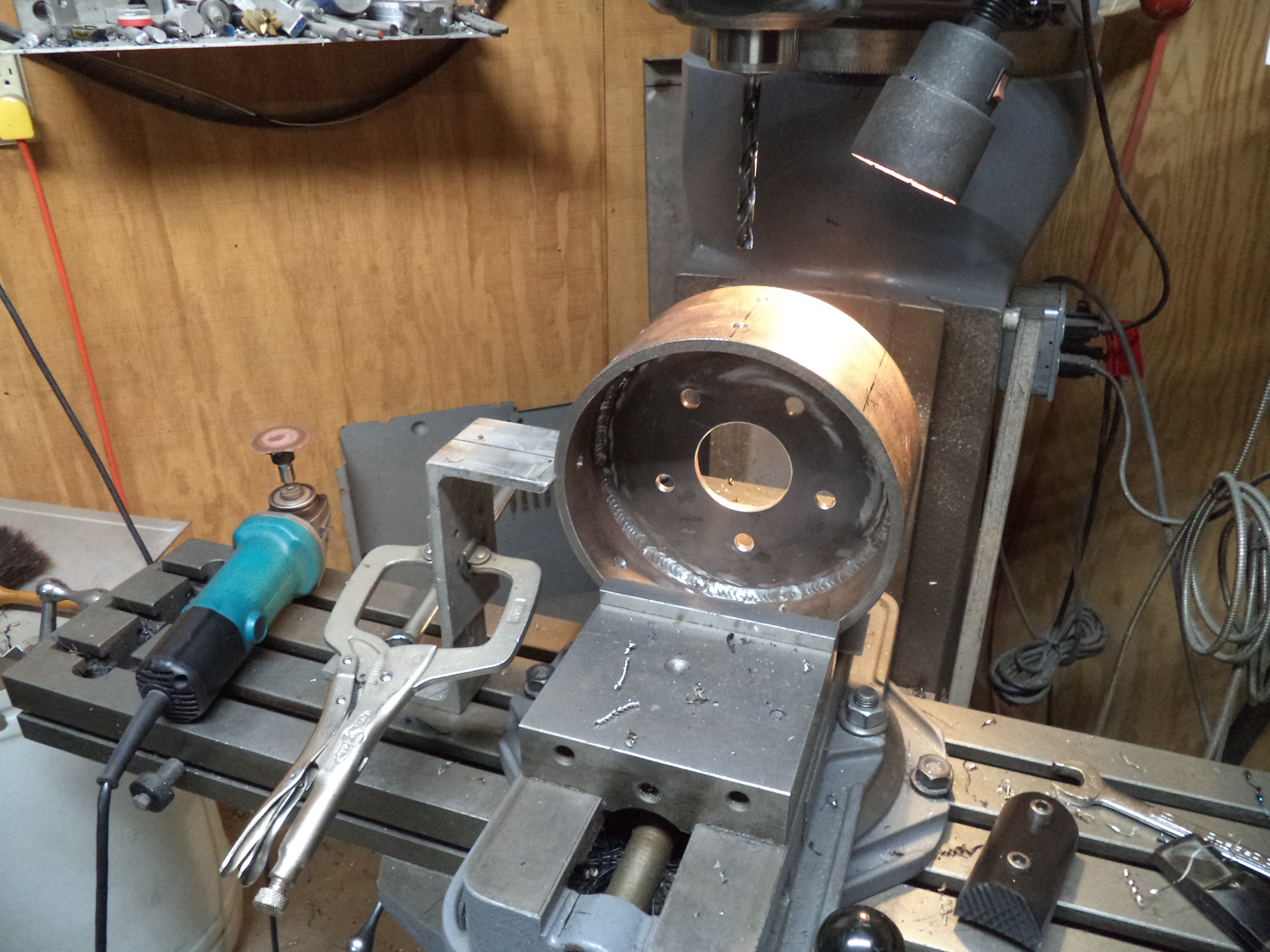

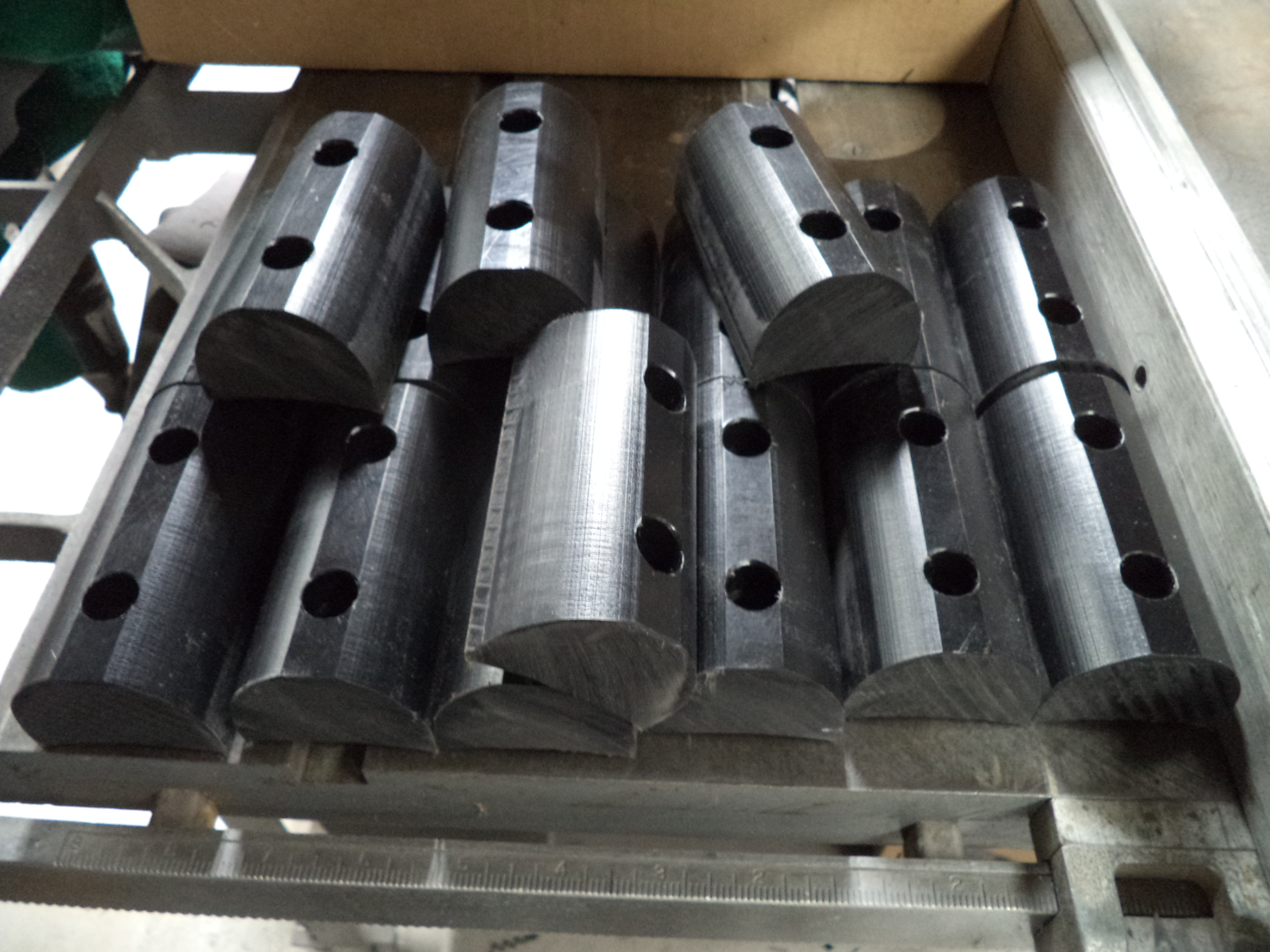

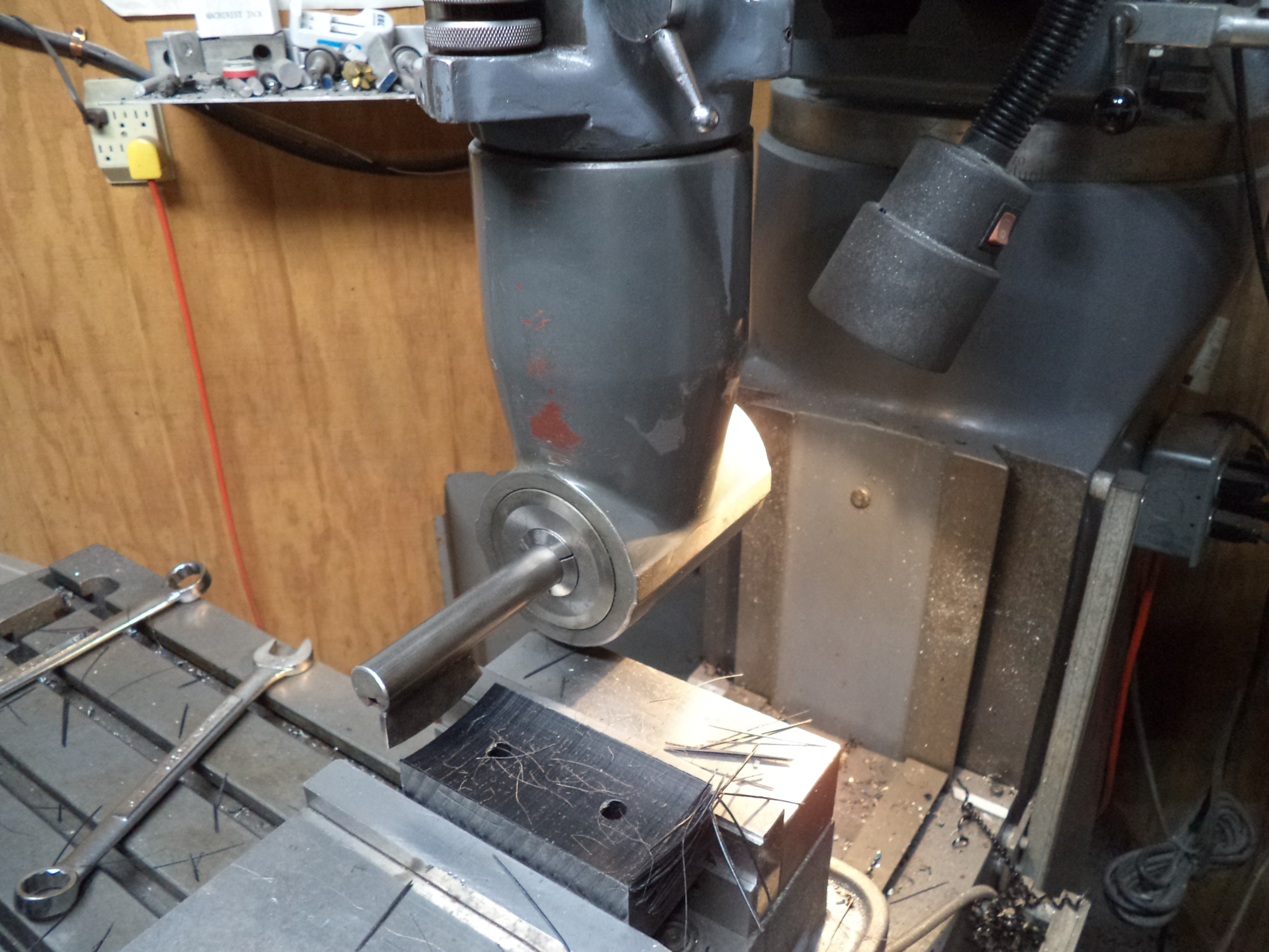

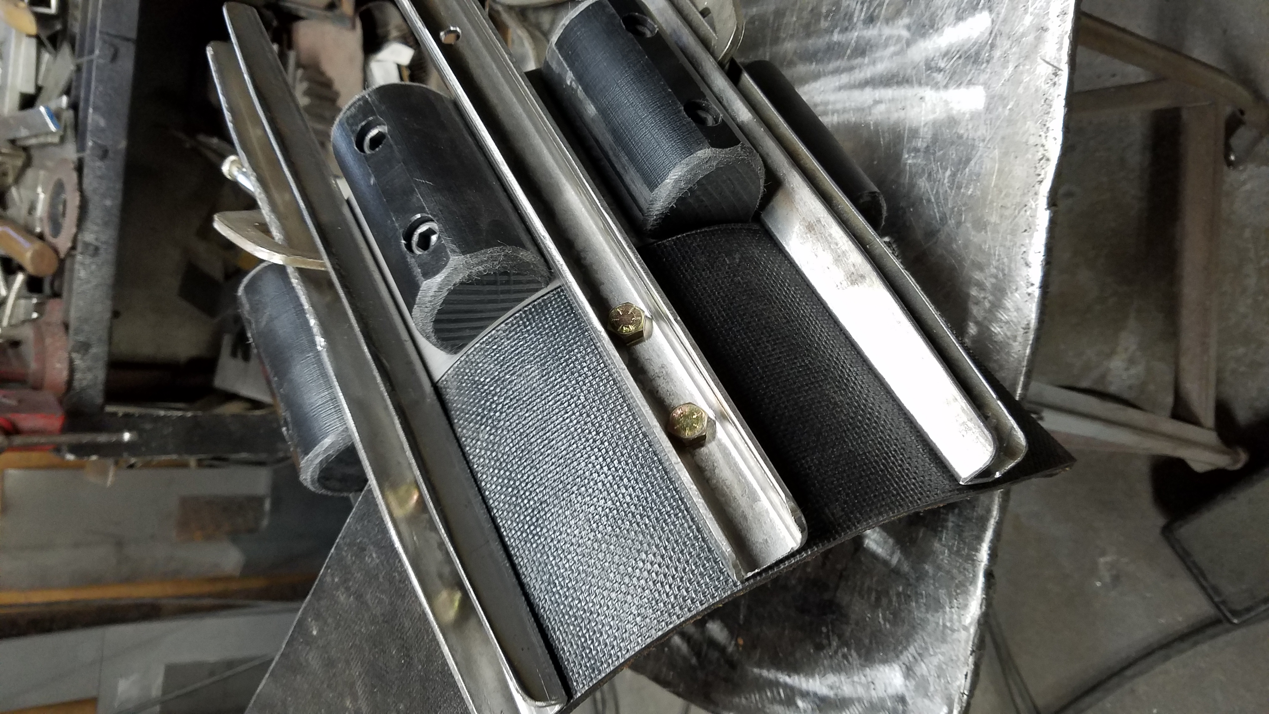

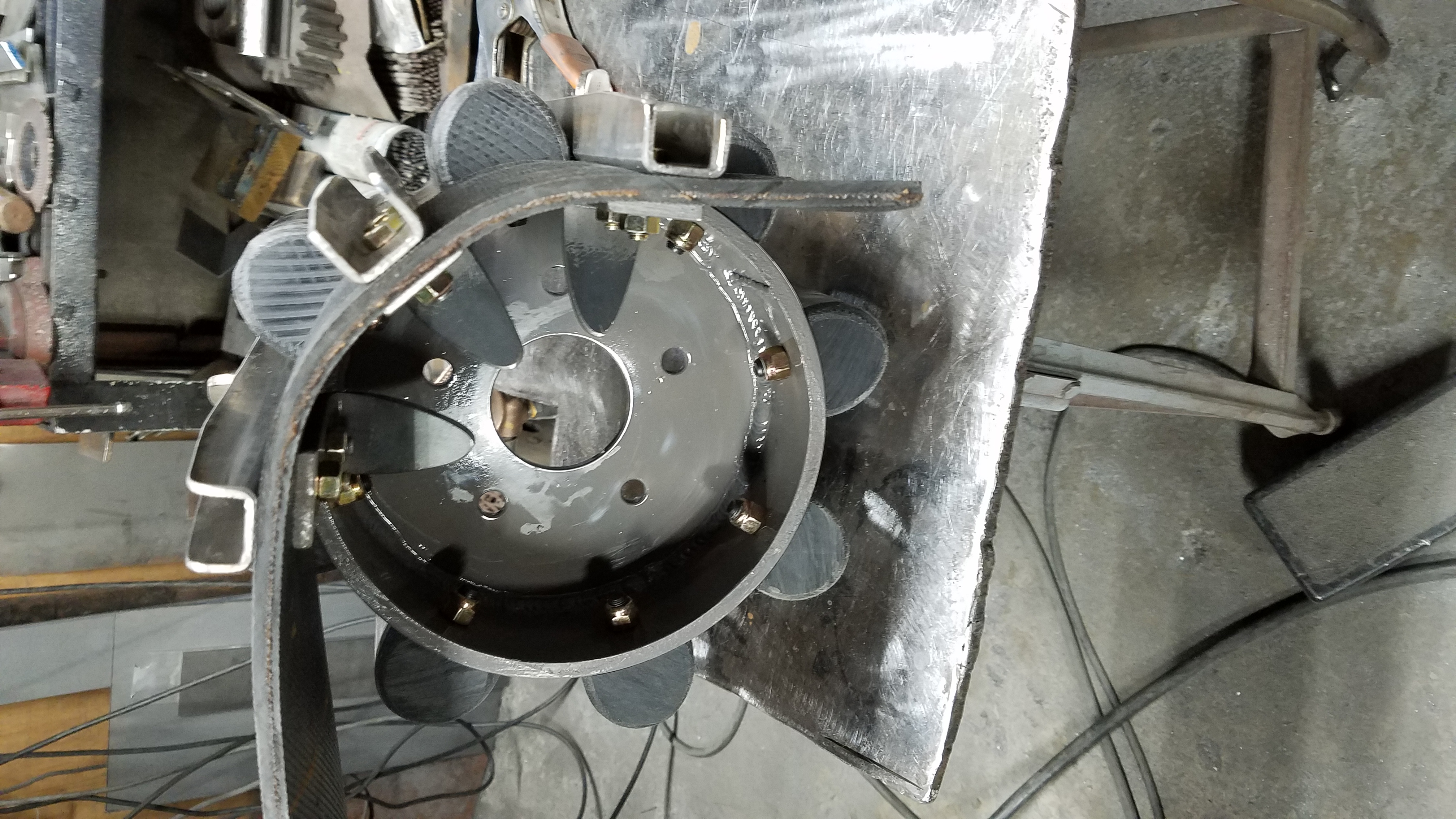

Today, I machined the (16) drive sprocket teeth and drilled the holes in the drive for the mounting bolts. The teeth are made from Tivar. Here's my machining setups:
Tomorrow, I hope to start work on the driveshaft.

Nice machinery. Nice work. Did you post a picture of the tracks this meshes with?
   / My Senior design project - a "Swamp Thing" tracked vehicle clone
#126
-> the very first post in this thread has a photo of the overall design with the tracks.

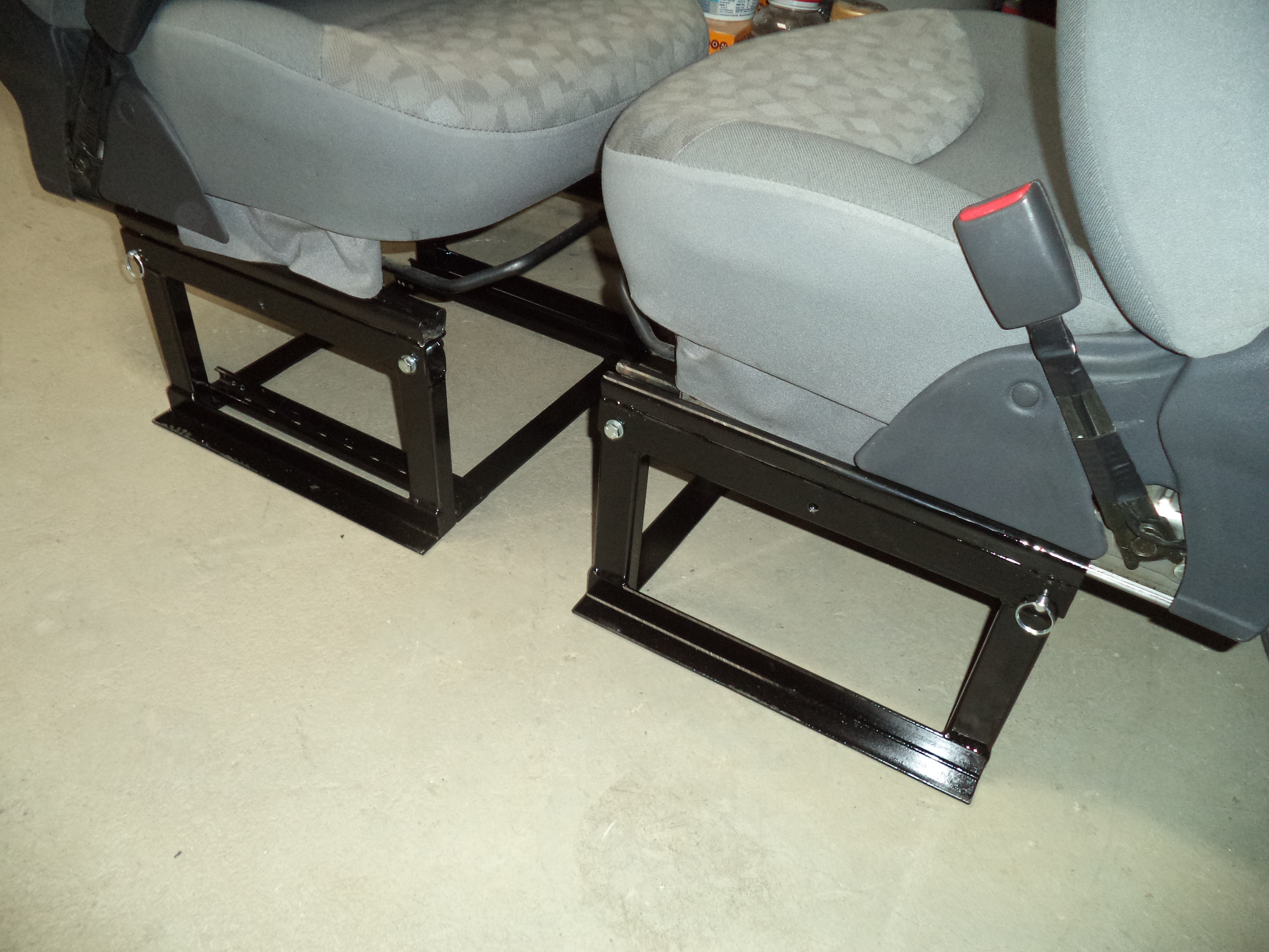

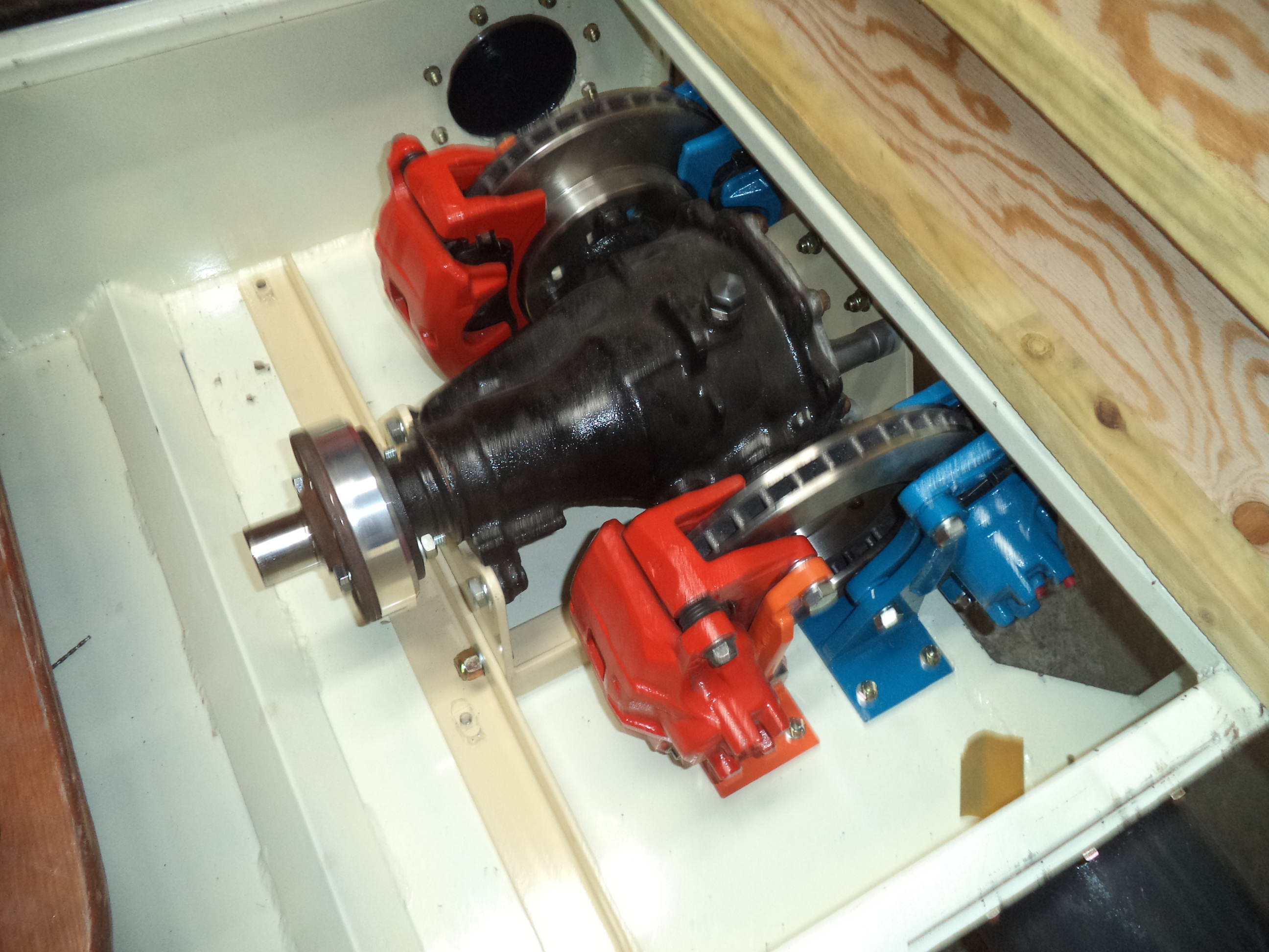

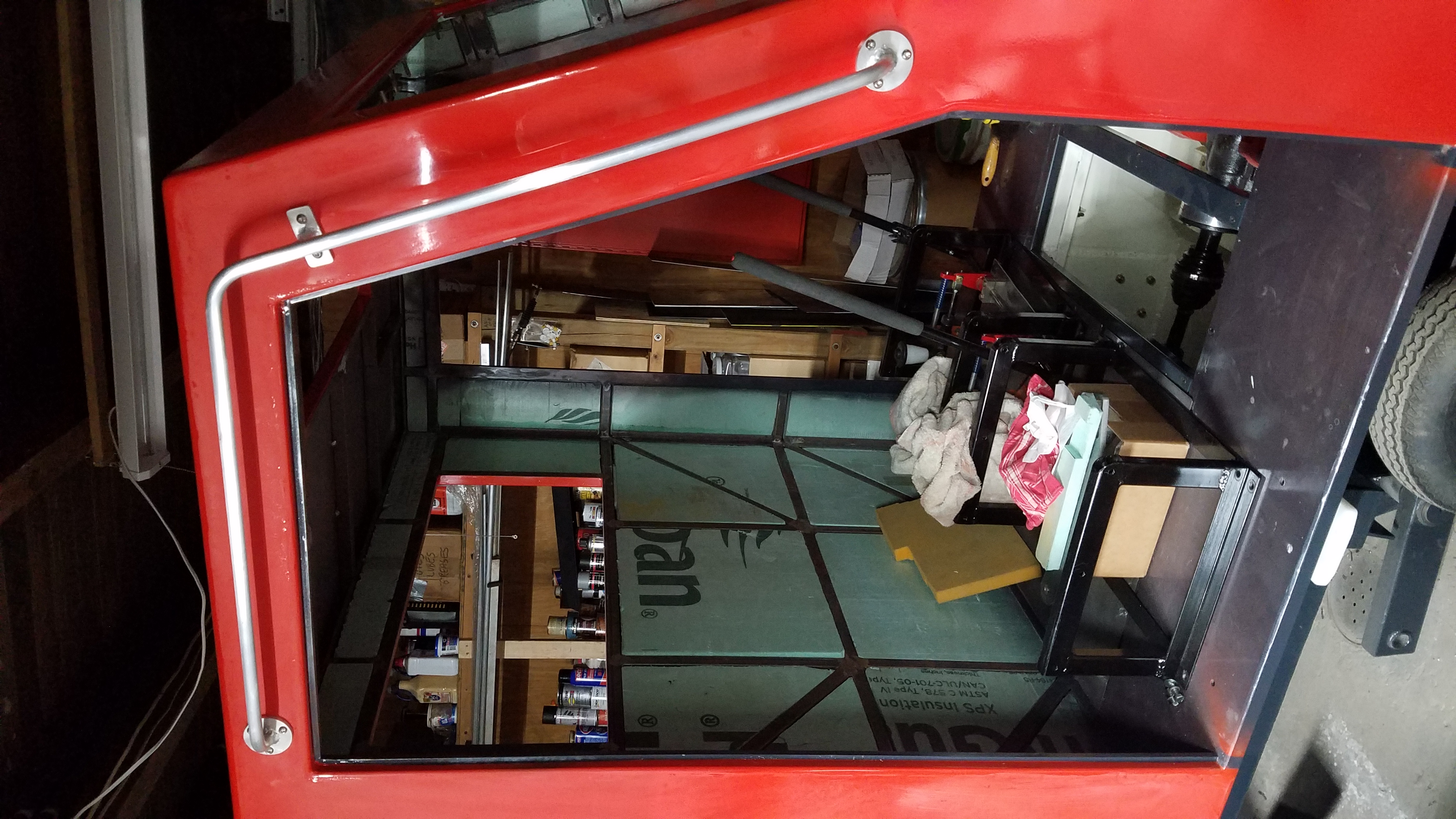

A little bit of progress has been made. I have the red service brake calipers installed and the seat frames are done. I'm working on welding up the cab frame this week.

I plan to use the OEM Rav4 half axles coming off the forward Rav4 diff and shorten them myself. If they break, I can buy stronger custom axles that will fit perfectly. As for the driveshaft, I will use an OEM Echo half axle, cut it and weld it to a piece of pipe cut to my needed length. I can buy a custom driveshaft if needed later. Let's see how it drives first before spending extra bux.
